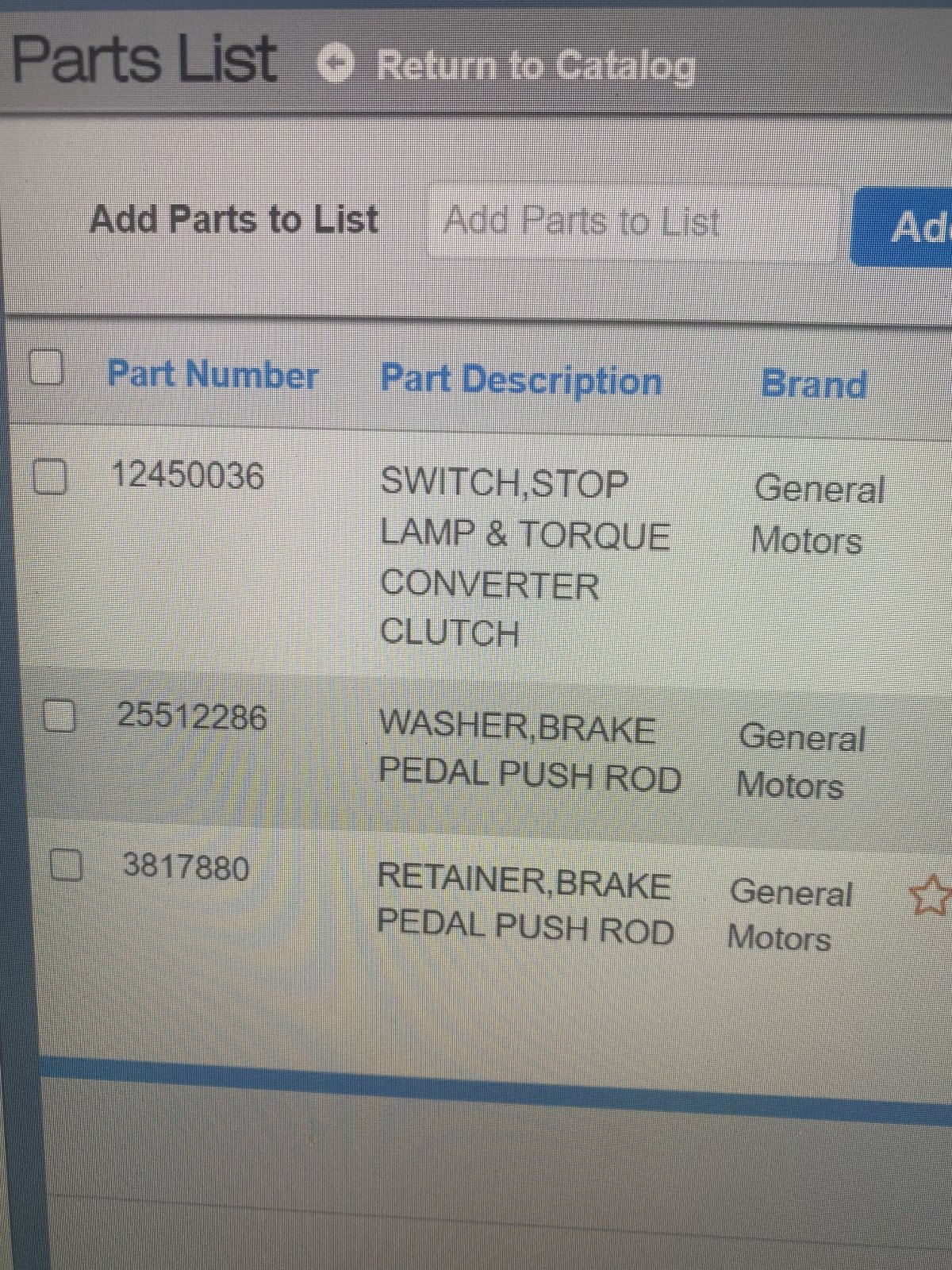

Here are the part numbers for the missing brake switch, and the brake pedal retainer and a squishy washer that helps line up everything. The retainer for the clutch master line, isn’t serviceable. You may find it aftermarket though.

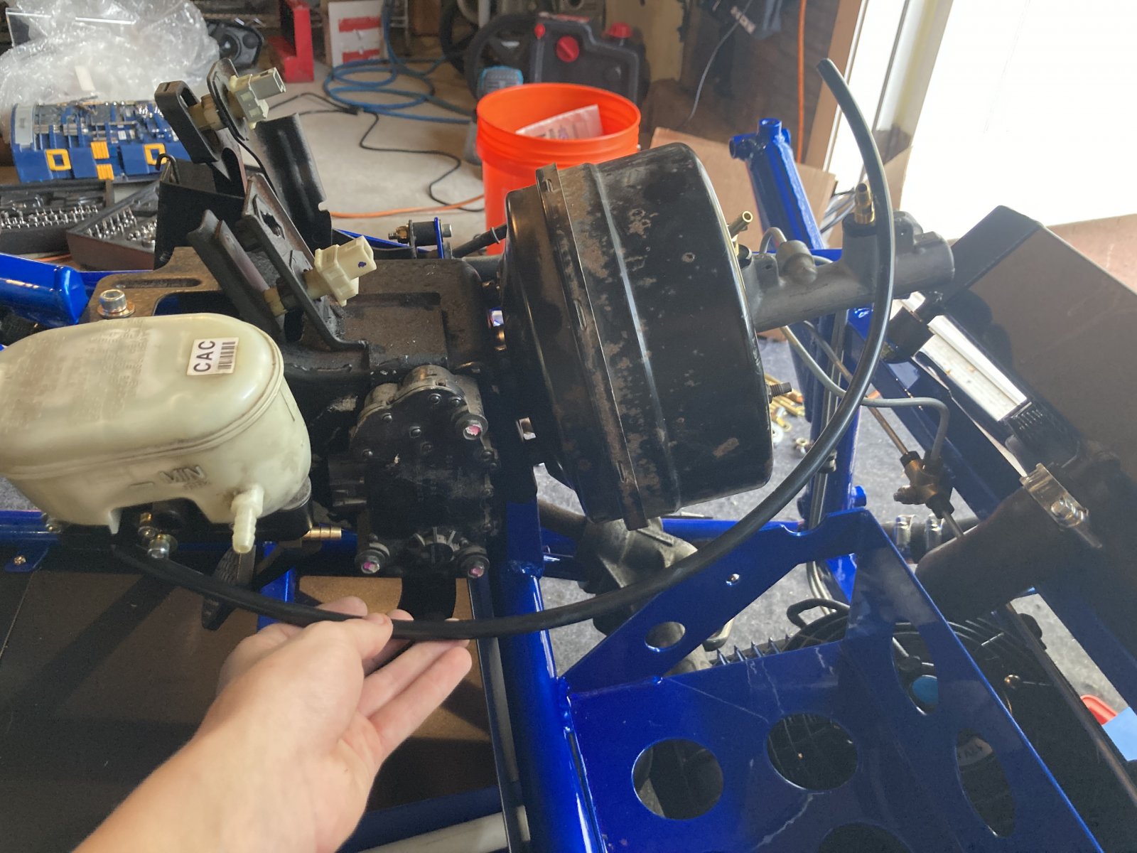

The only thing I did was partially install the brake reservoir relocation kit:

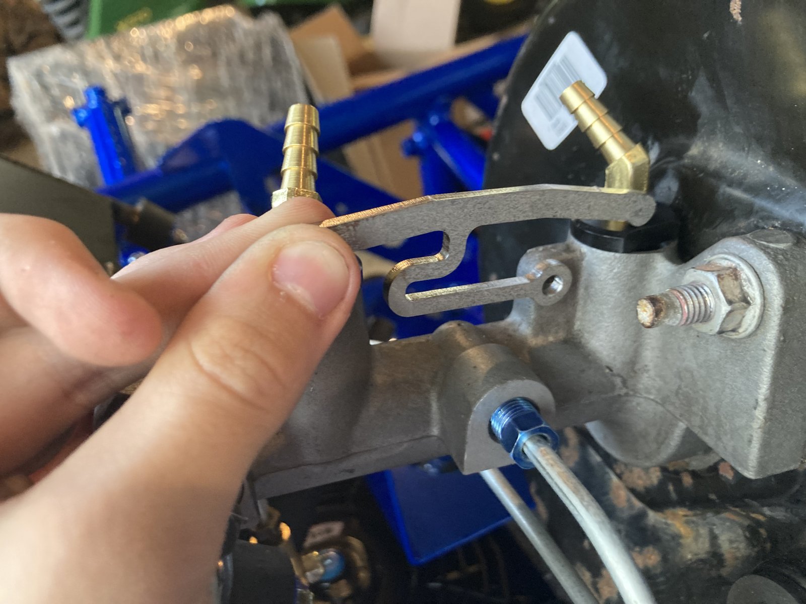

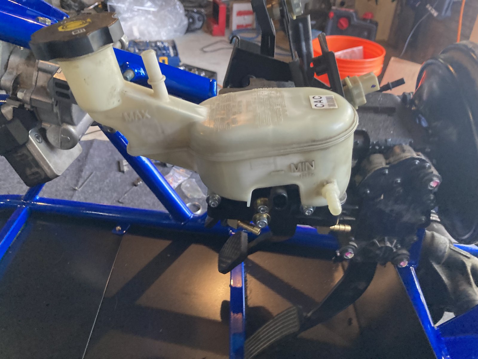

Where does this attach and what is it used for:
35968
I don't think df gave me enough tubing to reach from both ends of the relocation kit. I used the other 4 feet of this for the fuel line thing:
35969
Where do I order more? I looked online and found a few different results from what was marked on the actual tubing but I wasn't sure if they were the right thing. Should I email DF and ask for some more tubing or am I doing something wrong?

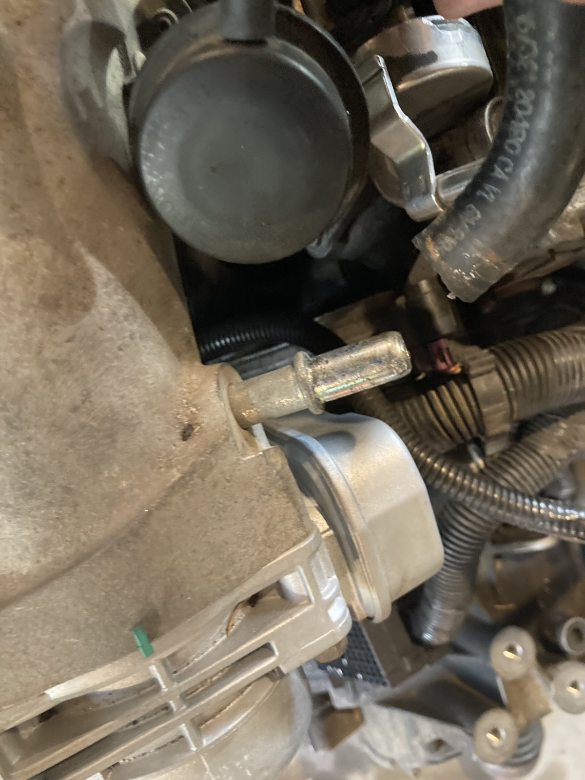

Is this the vacuum port for the brake booster line?
35970
The line seems to fit over it decently well just not sure if thats the right one.

I was also short brake line. I called DF and they shipped out more. It’s hard to tell if that nipple is the vacuum port or the emissions stuff.
Is that nipple in the valve cover or the intake? Brake should go to the intake where it will see vacuum after the throttle is closed. Of course yours is a a Frankenstein so may not be as simple.
K
That is right after the throttle body and right near the intake. I think its the right place.

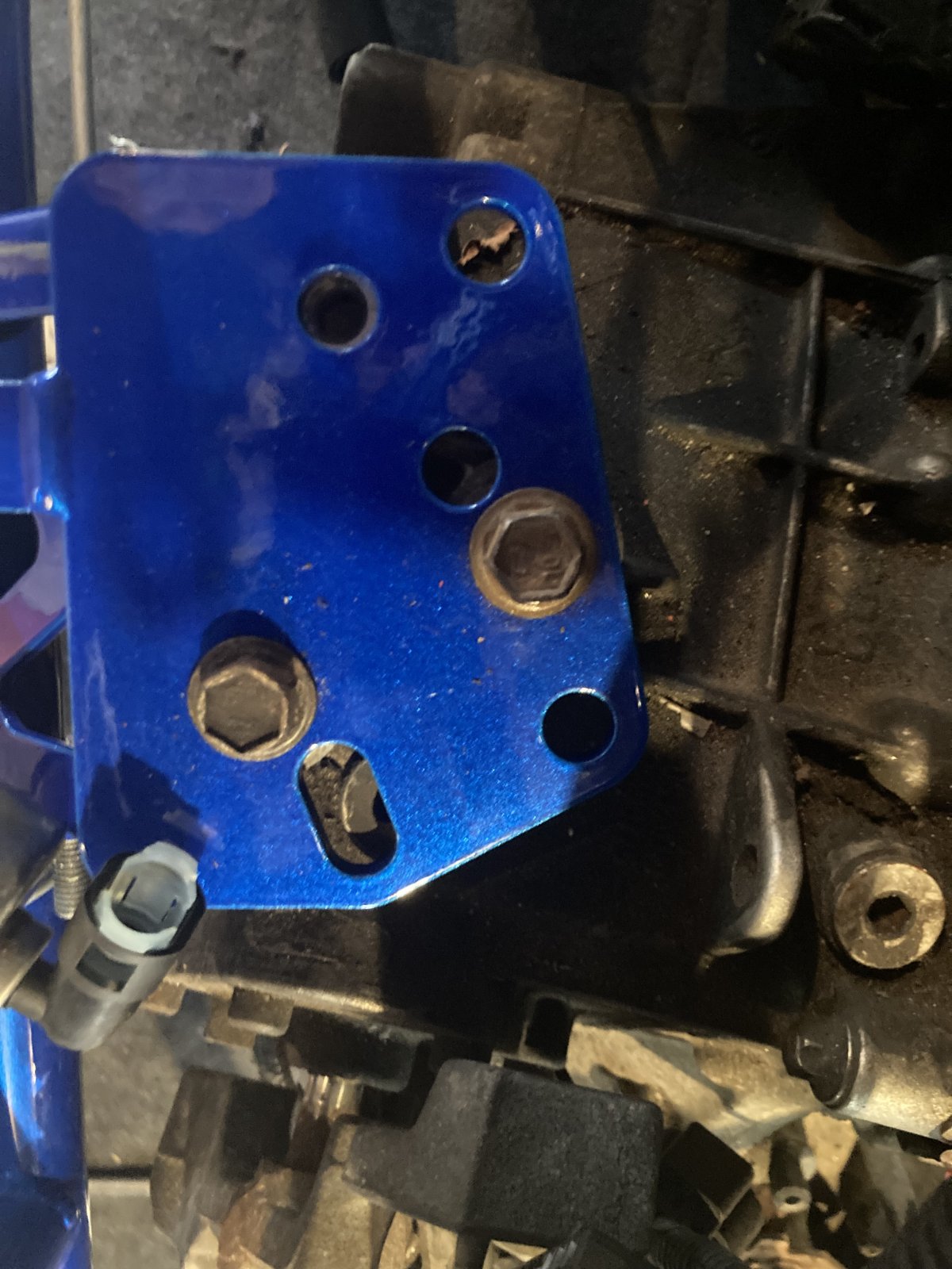

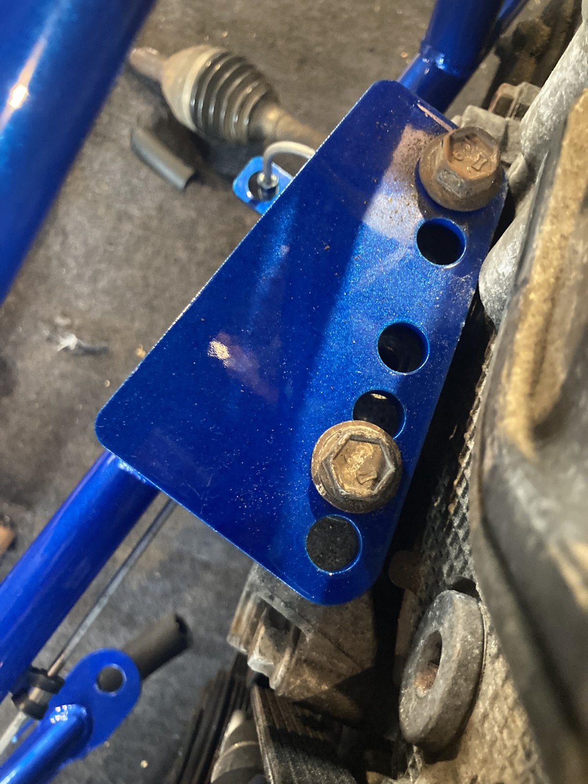

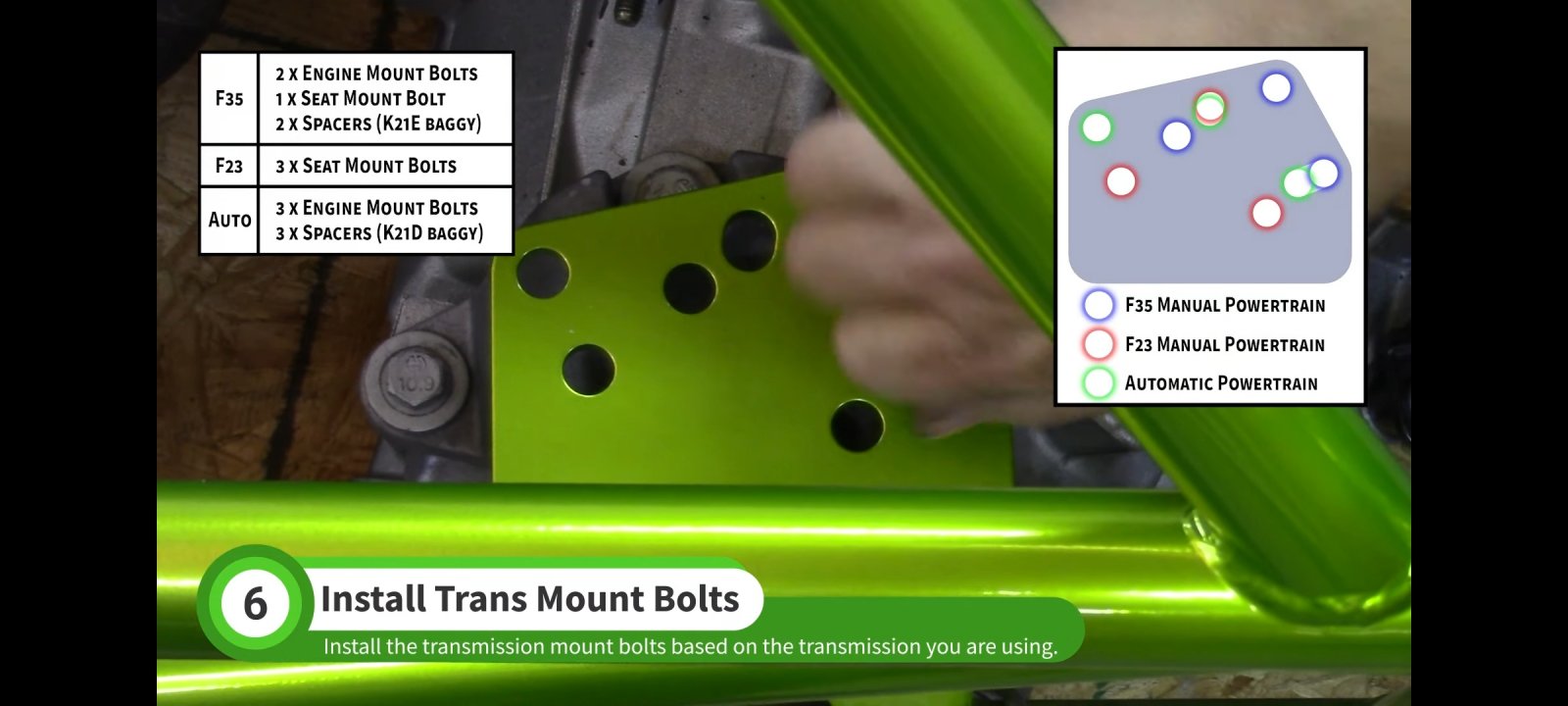

Are these the correct bolts for the engine mount? I feel like they aren't:
36376
36377
Do I need to use the transmission mount spacers? The engine seems to mount without them.

Did your donor run and drive before disassembly? If so, I wouldn't get too hung up on mounting the engine and connecting everything. There isn't anything that should cause immediate catastrophic failure of the engine, so as long as everything is put back where it should be it should fire up for you. If not, that's what the forum is for!
jennam
There’s several bolt patterns on the chassis mounts. Use the ones that line up when the engine is straight. Seems like mine has two bolts in one side and three in the other.
You’re definitely looking at the project the right way. It’s just a list of tasks. Do a couple today, and a couple tomorrow, then a few more the following day and you’ll have a completed toy in no time
K

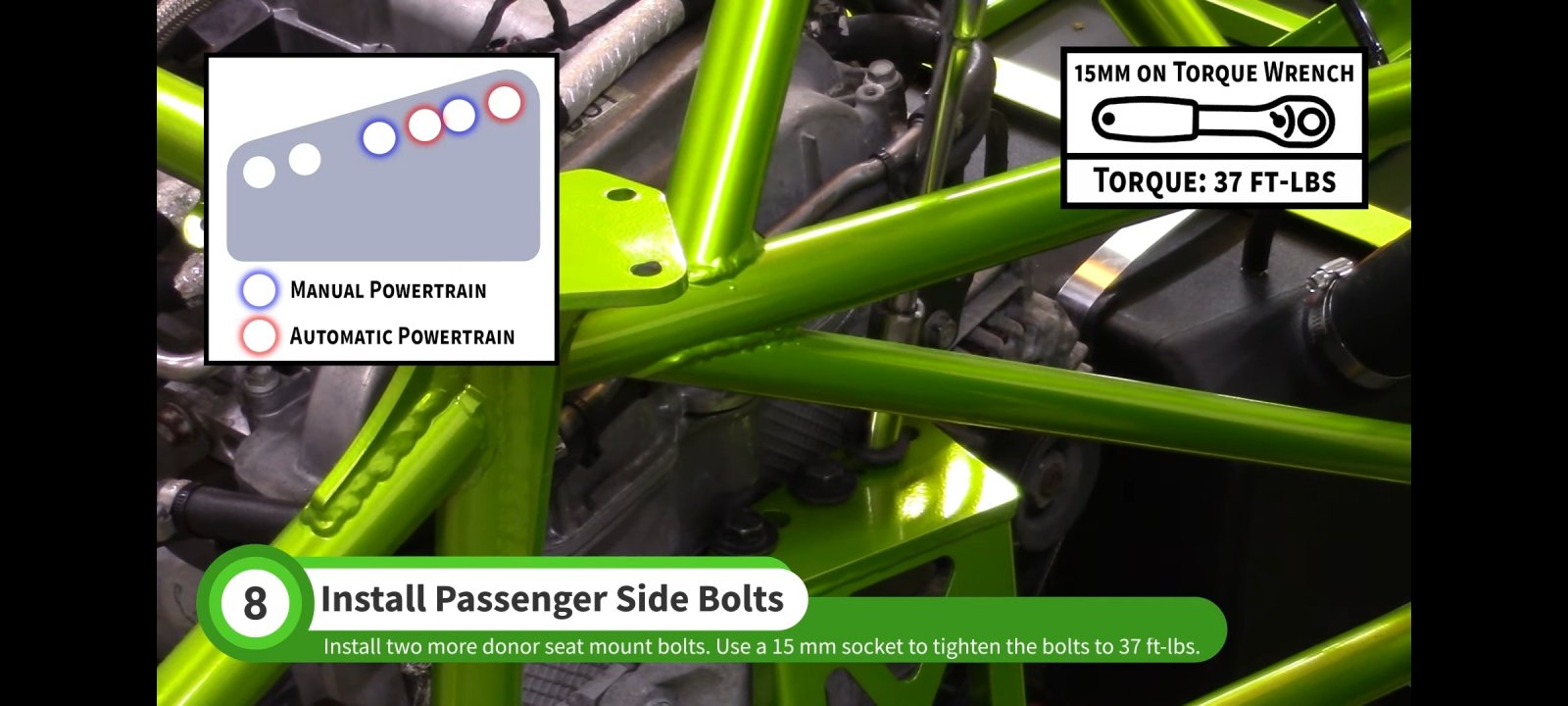

Thanks for the replies. I am pretty sure that I got the actual bolt pattern correct but I am unsure if those are the correct bolts. I know they are supposed to be seatbelt bolts but I can't tell and was wondering if anyone was able to identify them
Mahkoi
For the passenger/ engine side I didn't have the seat belt bolts because my donor had the seats pulled already before I got it. I just spun a thread chaser the on donor mount bolts for the engine then cut 6 threads off (i think it was 6, its been a while), tapered the edge on the bench grinder and removed the chaser to clean up the threads. I don't remember which bolts I used for the trans side.
K
Sounds like quite a bit of work. I may just end up ordering some seat mount bolts.
