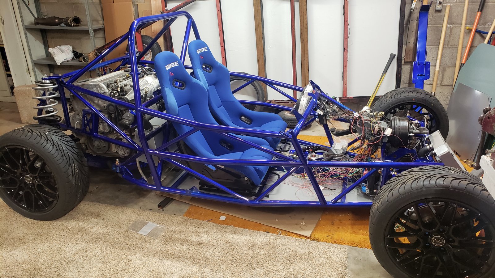

Hey guys! My name is Kyle Stevens. I'm from Southern Utah and it's a pleasure to be part of the community. Last October I hooked up the Harbor Freight flat bed to the Ford Escape and headed down to Texas to pick up my order. I've stayed reletively quiet on the forums, but I've made quite a bit of progress with the help of some private advice from people/friends like Captain Frank, Canyon B. and Ross.
The Build
This has been a pretty big undertaking for me as my first serious car project. I use to have a VW sandrail I got running a few years back with some carb cleaning and valve adjustments but nothing like this. I'm really "green" to all of this, so bear with me. Hell, I didn't even know the difference between a radiator and an intercooler. I still don't know what the EVAP system does; I just know I got rid of it. :p As far as the wiring and electronics of everything, I can read a wiring diagram well enough, but I definitely made some mistakes along the way that I just couldn't seem to track down. My instrument cluster is behaving strangely and my VATS light is on and won't clear by the traditional methods. I purchased an HP Tuner and credits to disable VATS, so now I can start the vehicle by arcing the starter relay. It idles great, and the throttle response is great. The key won't start the vehicle (it will shut it off), so I'll have to do some more digging there or bypass whatever is stopping it from reaching the relay. The guages on the instrument cluster still aren't working, but I'm pretty sure the obd2 reader is showing values for the tachometer and speedometer (I'll verify this later tonight).

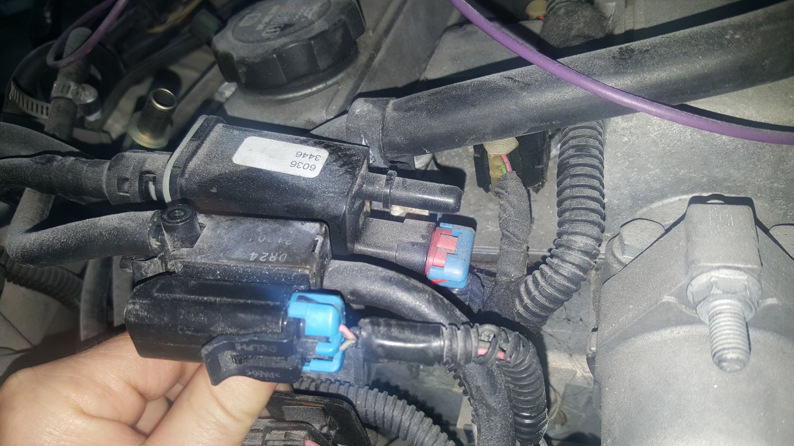

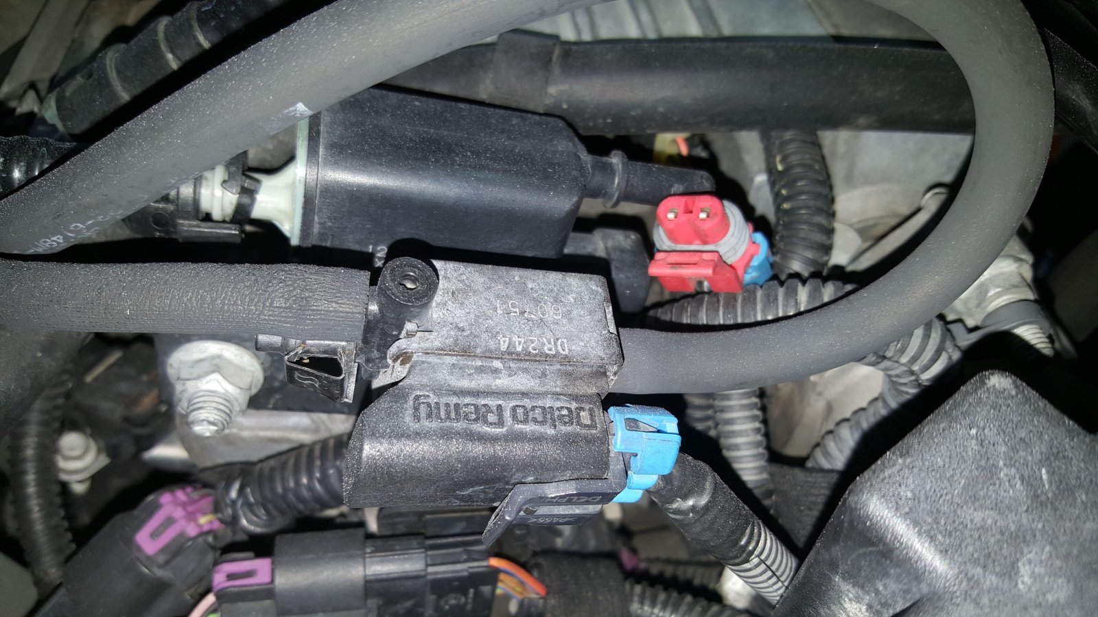

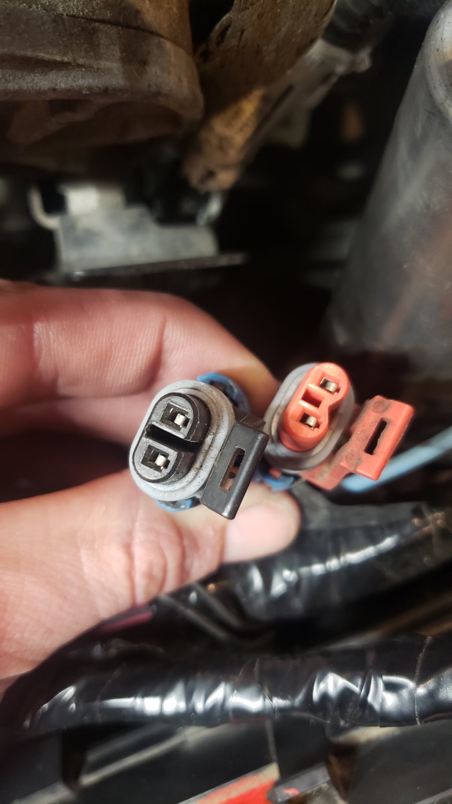

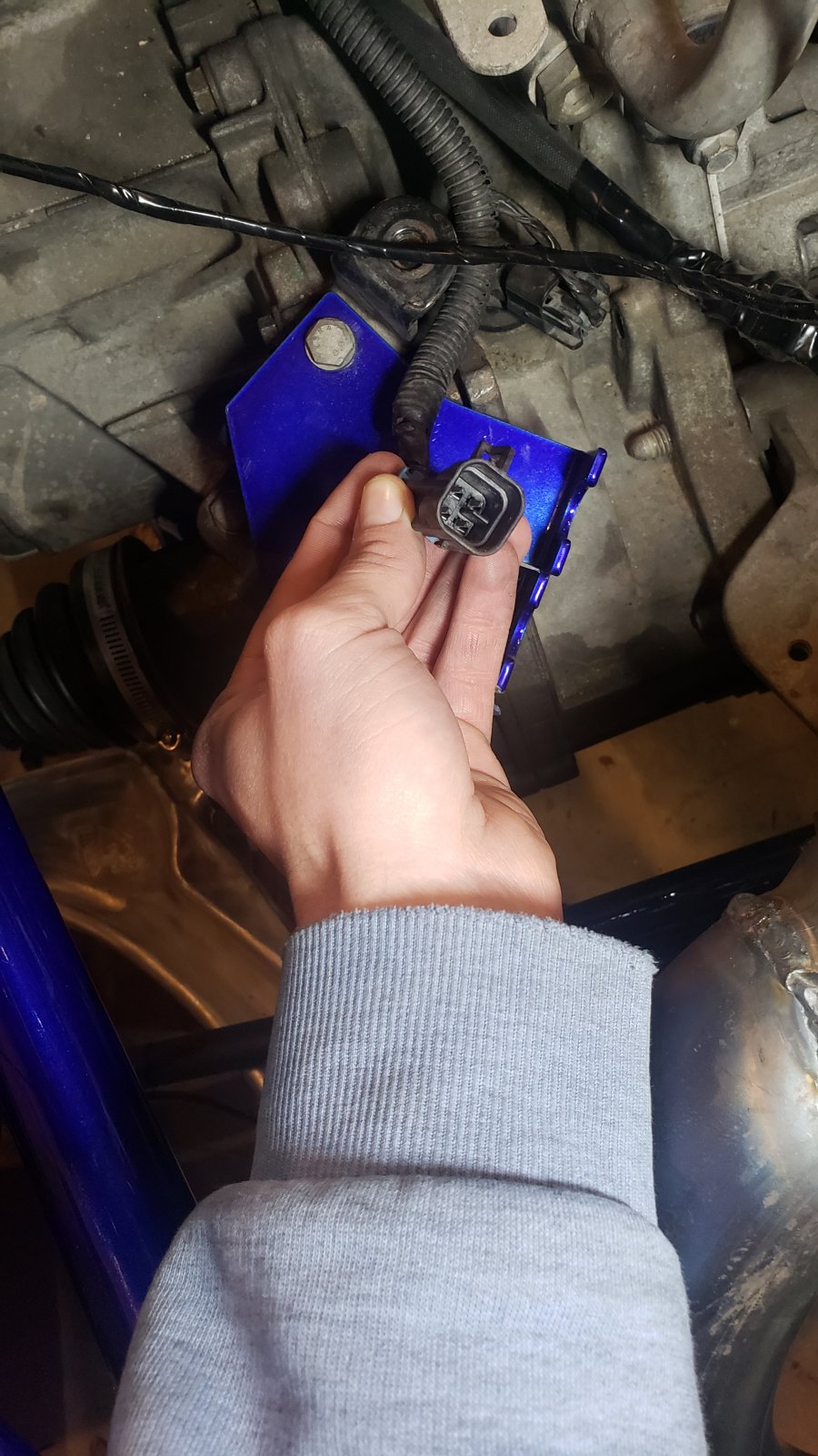

1. This pair of connectors: I'm pretty sure the blue goes to the bypass valve solenoid. As for the red one, it is pretty unique shape, but I can't seem to find a place for it. They are part of the engine harness, and they branch off the line from the big purple connector under the fuse box. (sorry I can't remember the wire colors. I'll check later today if no one recognizes them)

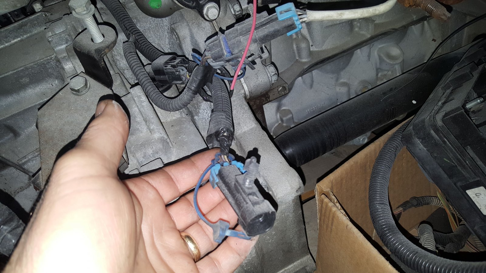

2. This connector: it sits next to where the shifting linkage hooks up it has 4 prongs.

3. Ambient air sensor can go anywhere that is not in heated air, like behind the radiator or inside the engine bay.
4. Are you not using the Cobalt reservoir? If not, tie the two wires together to simulate the reservoir sensor with a full tank.
Towerdog
Top black plug should be your coolant tank.
Bottom 4 pin is the second O2 sensor.
Orange... Still thinking.. Evap thingy. Not needed
I think this may be them.
Leave the red one unplugged. It is for emissions.
The other, blue, black, gray, controls your supercharger, you will need it.
Towerdog
Lonny is correct (of course) I did not unplug the black one on the SC but it is a match for the coolant tank that is in the main harness.

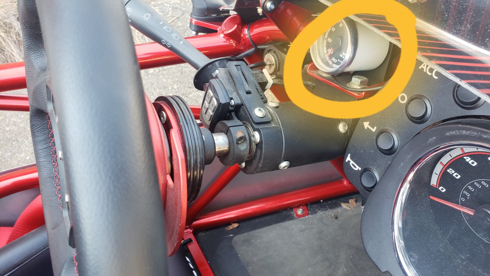

Was my kit supposed to come with this little boost guage bracket or is that something I make myself?
