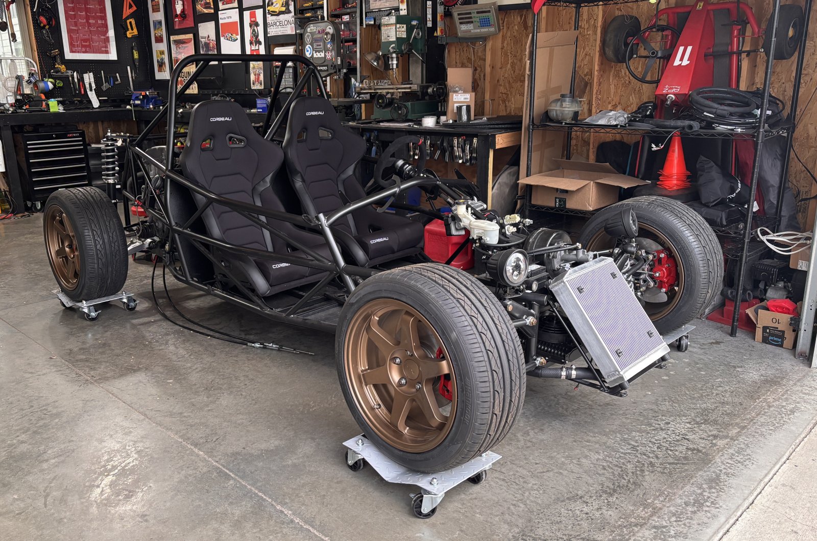

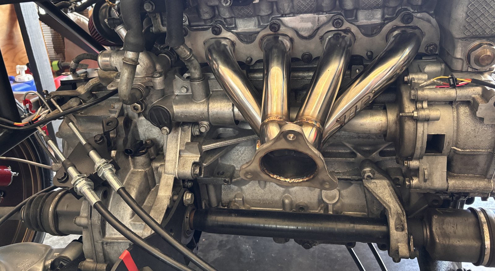

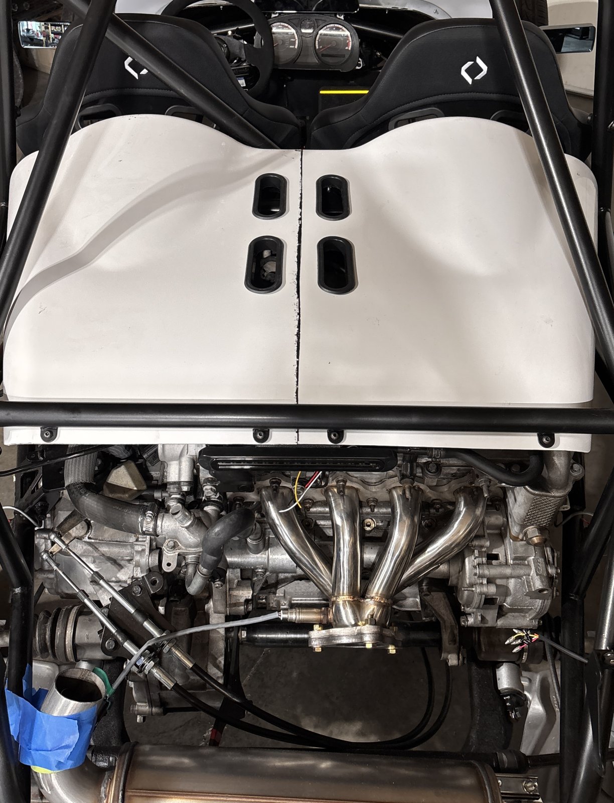

Got tons done with Dad’s help. Got stainless headers and now have to start figuring out how to get the double exit muffler to fit.
Exhaust question. Will the computer be confused without a catalytic converter in the system?

Update:
Shouldn’t be a problem. Only “issue” I had was throwing a code for the 2nd o2 sensor. The bank 1 sensor 2 codes and all evap codes can be turned off in HP Tuners if you have / plan on getting it.

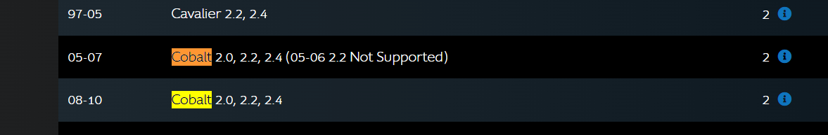

OK good news! I haven't heard of the HP Tuners until just now. Looks like it plugs into the OBD port? I prefer simple tech whenever possible. Is there a bare bones/cheap version that will just do the code delete and not have all the phone connectivity, analytics, etc?

HPT only has 1 version
Best thing to do is find a tuner to do it for you.
Traé
Thanks. I love bronze wheels too. Gonna go for a 60's Ferrari look.
You don’t have to use the full function of the MPVI, but it will be a wonderful device to have for data logging and tuning…if you want to go down that road. I was putting off getting one for awhile and finally bit the bullet and purchased one. I have not heard of a simpler device that has the ability to turn off DTCs.
52427
There is a chance that someone with older software would have to modify the tune since the newer version of the editor program has removed some of the ability to make emissions related changes. I don't know if the DTC's are included.

I was able to remove emissions DTCs with the newest software but had to take HP Tuners’ “Advanced Parameters Training” to unlock that ability.

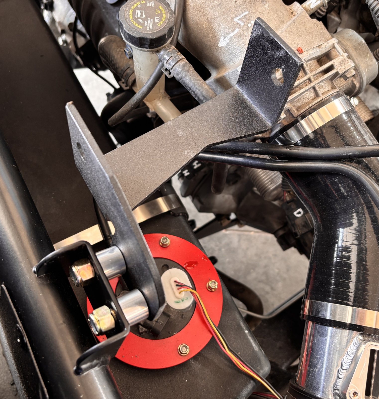

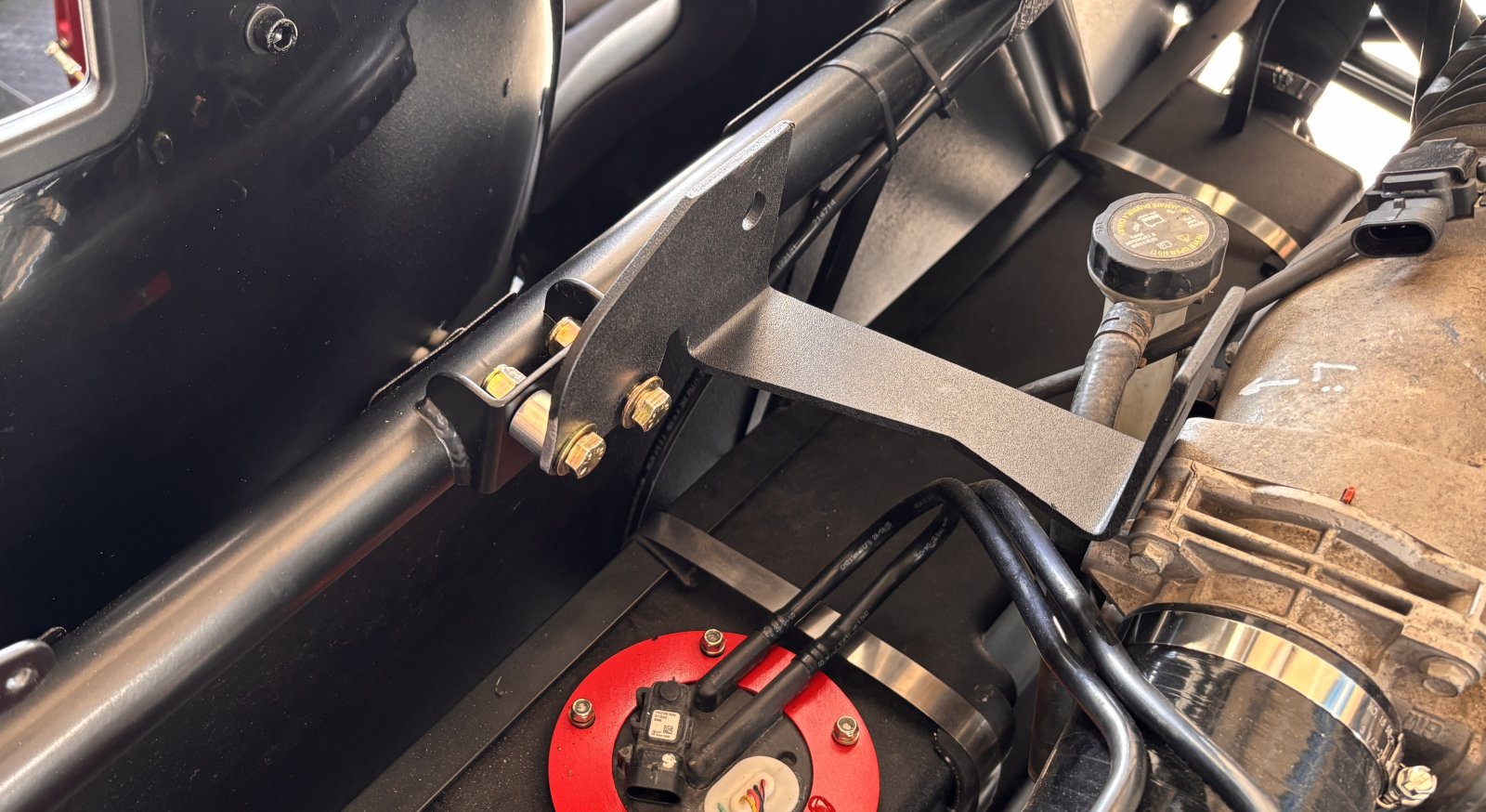

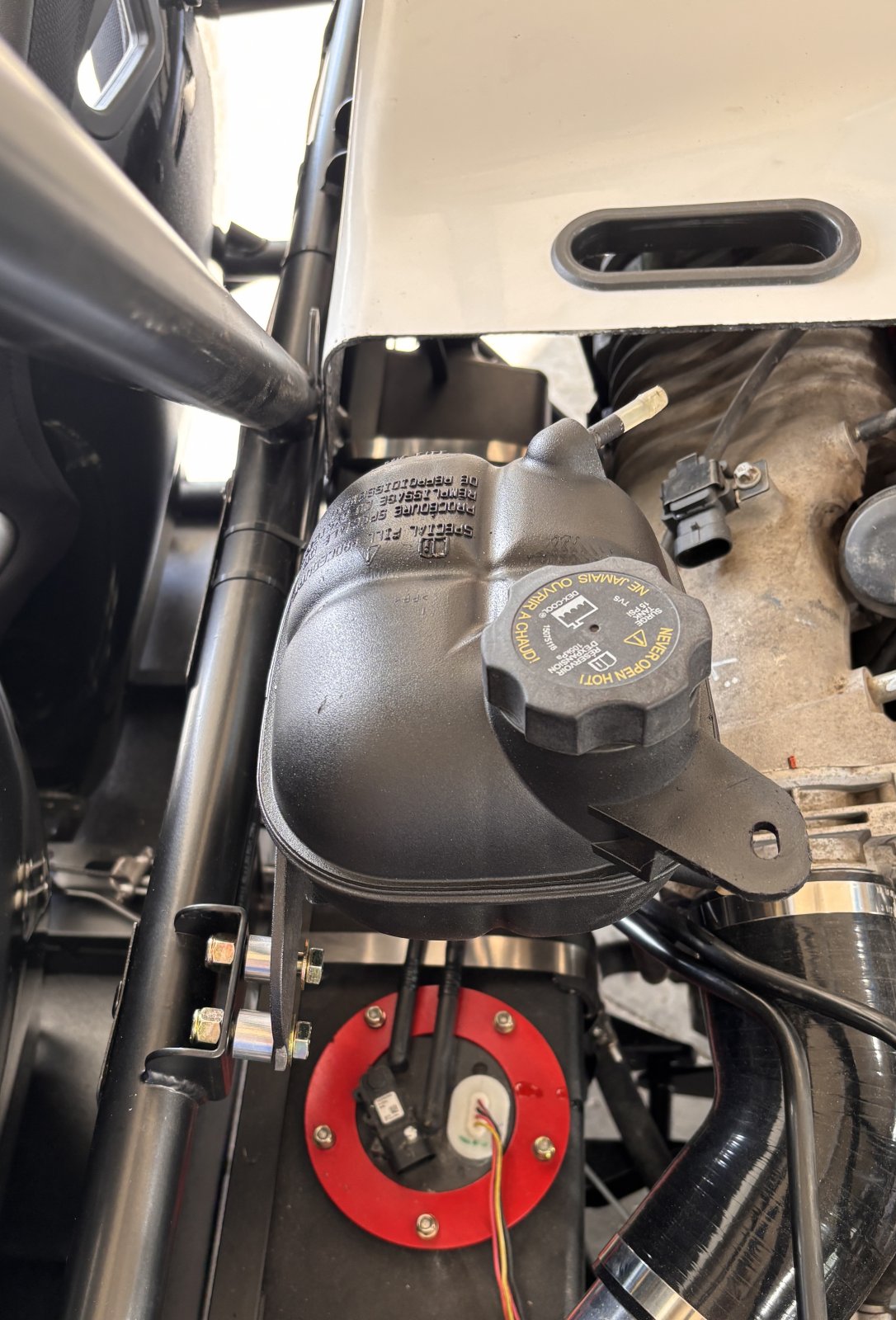

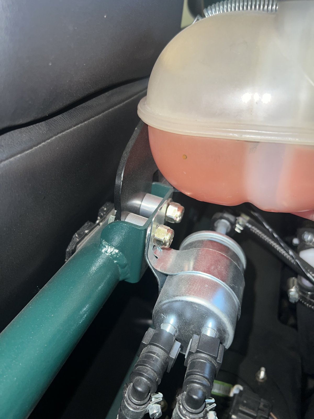

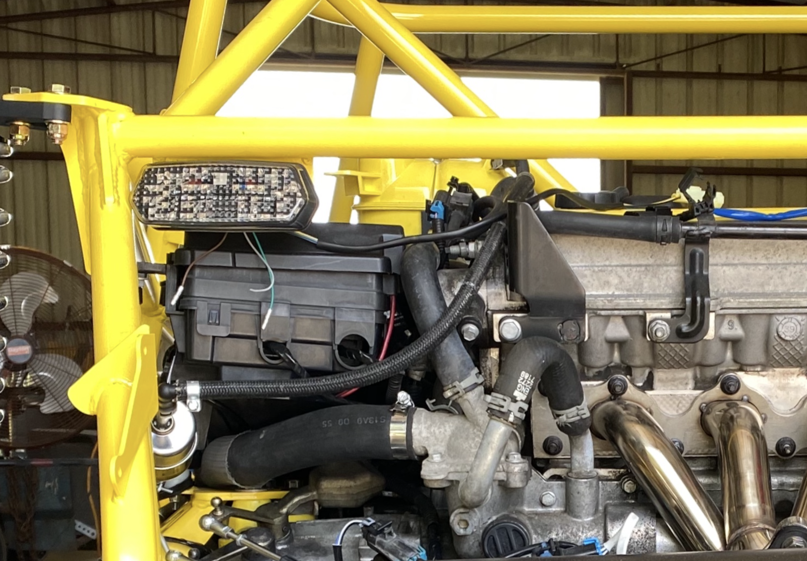

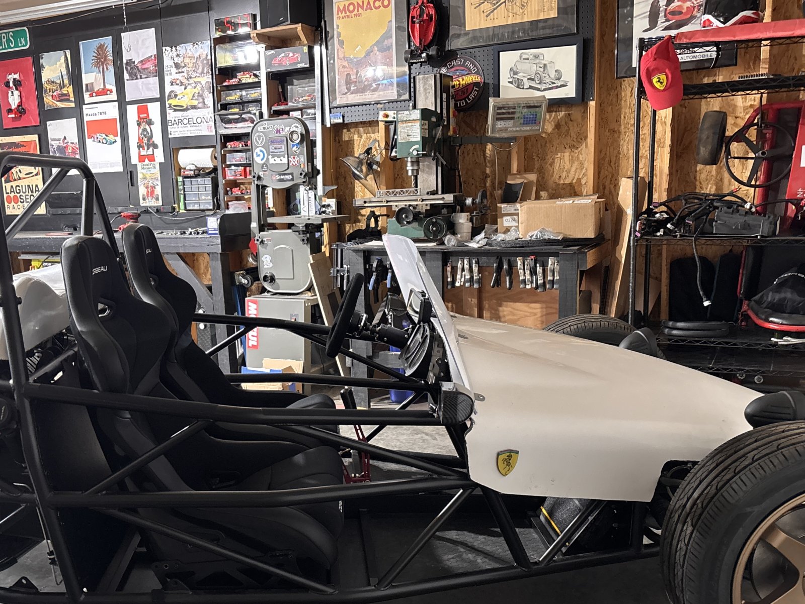

My latest issue is that I can’t figure out how the coolant tank is installed. Saw a vid of how one guy did it, but if I do it that way I can’t get the engine cover on. This was my latest attempt. Man I wish there were instructions. I’m now in “figure it out” land.
I have my spacer towards the seat. Since yours is pushed out towards the rear of the car, it might be causing it to hit the hump on the engine cover.

Markm
I have the wife’s with the spacers towards the engine like you but it’s N/A. The engine cover may fit without the spacers or maybe use a washer or two?
L
Thanks for your help y'all. I ended up mounting to the back side of the bracket with no spacers but had to grind off some of the plastic on the tank to make it fit under the engine cover.
