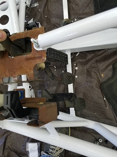

I mocked up the pedals in the Goblin, and noticed that the gas/brake pedals are about 4" farther from the steering wheel, in the Goblin than in the Cobalt. I guess it is a more "lie down" seating position. Also the clutch pedal is now about 1.5" forward from it's Cobalt position, so now all the pedals form a diagonal line instead of being straight across. Guess I could put a 1.5" block on the brake, and a 3.5" block on the gas... but I will try the car this way before I attempt re-engineering it.

Yes, the clutch is separate from the brake and gas pedal box.
I don't know of a metal clutch pedal, but maybe someone makes an aftermarket one. You could fabricate one if you wanted...
Here is a thread on the pedals. Pictures are there too.
