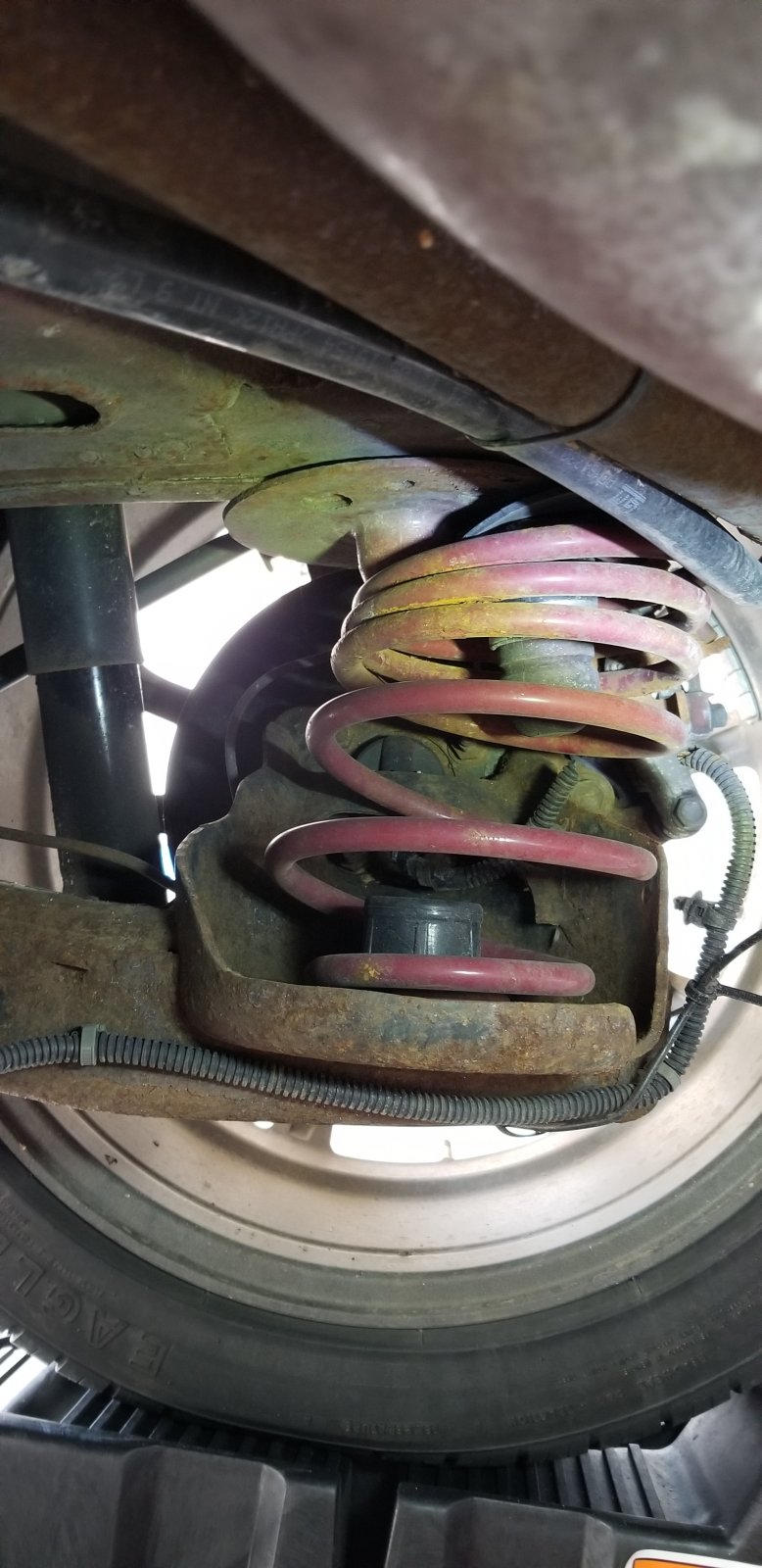

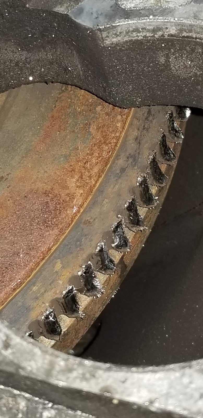

This is the build log for Goblin #480. It’s a 2006 Cobalt SS/SC with about 143,000 miles on it. I needed a donor that drove well as I learned to drive manual with it. This thing is a real racecar: aftermarket steering wheel at a 45 degree angle, only red lights on the interior, underglow, unless dual 12” subwoofers in the back. Previous owner was a 16 year old who could have it “until he got a speeding ticket”. Guess how long that takes a 16 year old in a supercharged, tuned “racecar”. Sold with a ‘bad starter’, immediately changed the starter, flywheel, clutch, master cylinder due to the flywheel missing about a quarter of the teeth. Also the lowered springs on the rear kept jumping out. Never heard of that before. I did find 87 quarters under the backseat though, so that helps make up for it.

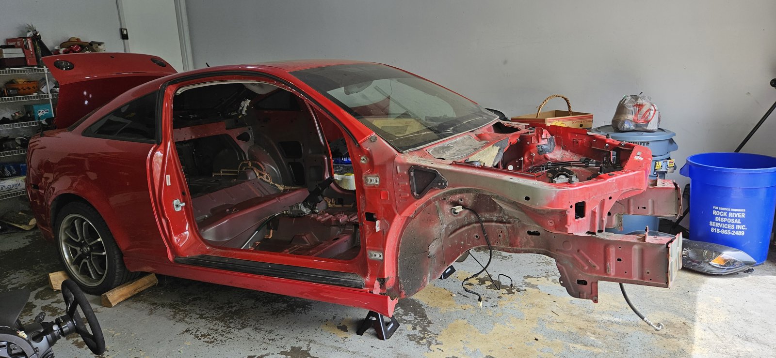

Teardown started memorial day weekend, finished up this week. Overall it went very smooth just following the videos. There’s a few differences but they’re all very manageable. Thankfully the only bolts I had to cut were on the exhaust. The gas tank is out so the donor is done, I need to get the donor taken away to free the garage up before my frame comes back from powdercoating next week.

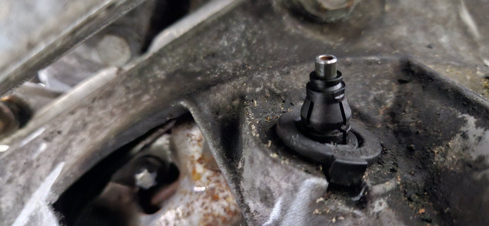

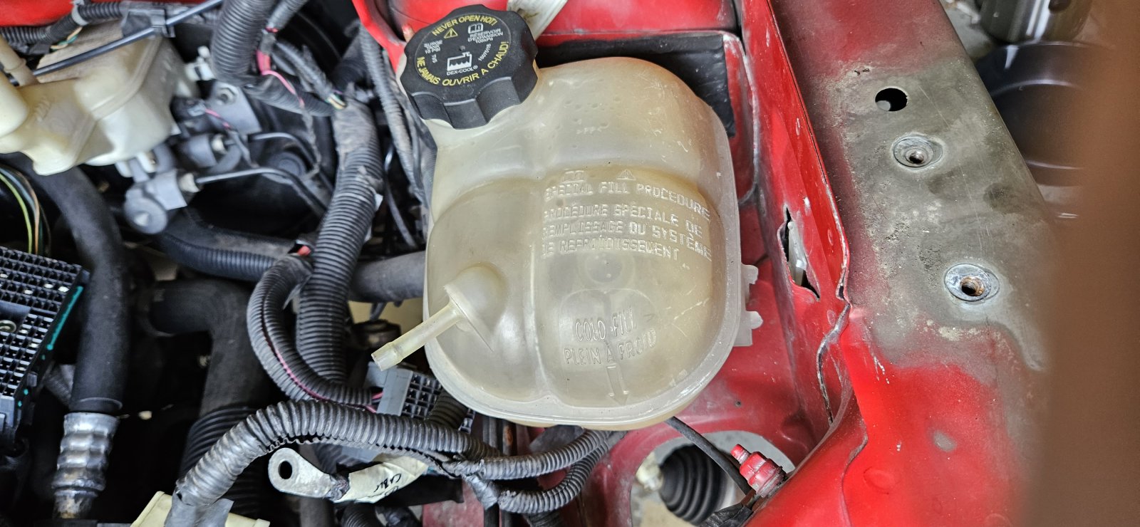

The clip on the back of the coolant tank was broken. It looks like this is also used on the goblin, so I believe need to replace it.

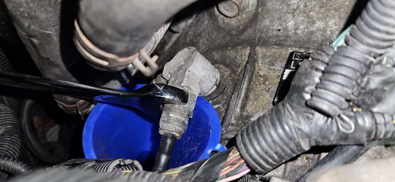

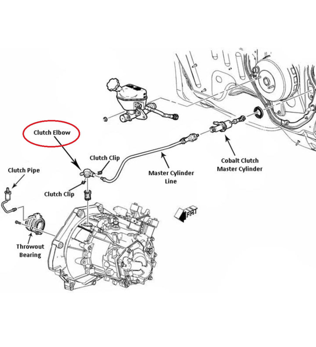

I tried my damnedest to remove this line without breaking anything, but the elbow popped off anyways. I think this is the “clutch elbow” from the drawing attached. So did I damage it, or the connection it’s attached to, and can I repair it without going inside the transmission?
Finally, when I removed the steering wheel, the plastic where the turn signal/wiper shafts are mounted did not come off with the wheel. I’m struggling to see how to remove it now without breaking it. Is this plastic reused or can I destroy it?
Coolant reservoir: I don't think that clip is a big deal anymore. The mount was updated a while back: http://dfkitcar.com/forum/index.php?threads/we-need-updated-videos.2120/post-40623
Clutch elbow: the black piece poking out from the bellhousing now is one end of the clutch pipe that goes from the slave cylinder to the elbow, and the elbow is also the bleeder. If your elbow is good, you might be able to re-aim the clutch pipe and reinstall the clutch elbow. There's a cup-looking seal/o-ring deal that likes to stay inside the elbow; to minimize the chance of leaks, it should be on the clutch pipe before you install the elbow, not inside the elbow. Then again, if your clutch pipe is really tweaked, then yes, you would probably have to pull the trans to realign. There's an access port in the bellhousing with a black plastic cover, but I can't recall that it would get you access to the clutch pipe.

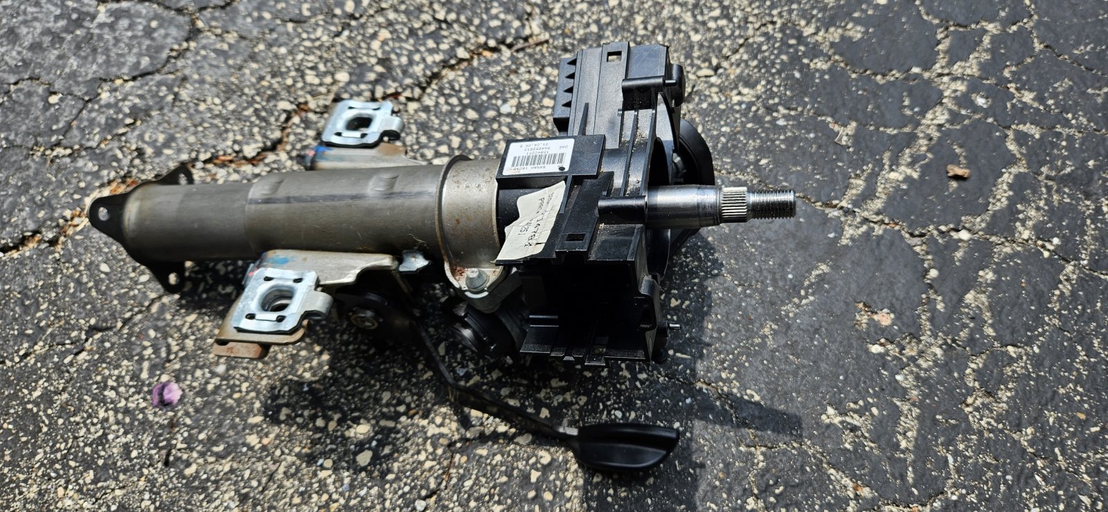

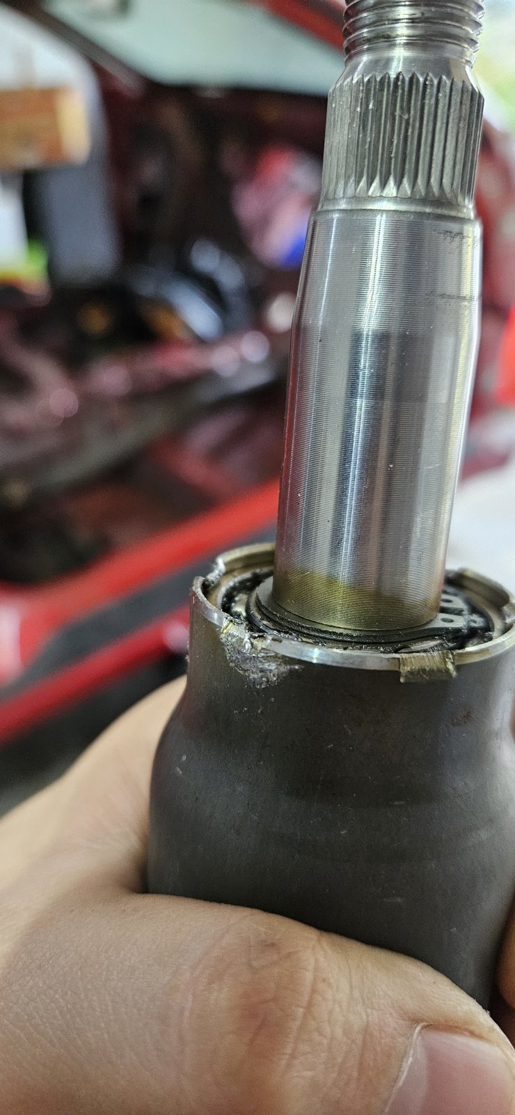

I'm still working on disassembling the steering column. I'm having a hell of a time bending the bearing retainer stakes out of the way. The video makes it look so easy... Any tips? I feel like I'm just mangling the metal and taking chunks out of my hand when it slips.
I don’t remember but does removing the retainer ring allow the shaft to get out of the way? If so you can use a hammer and punch to knock the tangs back.
Sluggonaut
I remember it being much more difficult than what Lonny makes it look like in the video. I can relate to the hand chunk comment too.
Everything was harder than what Lonnie made it look on the videos. Not saying it was hard overall, just he breezed through it all. My hardest thing he made look super easy was hammering the steering wheel off the steering shafts.
