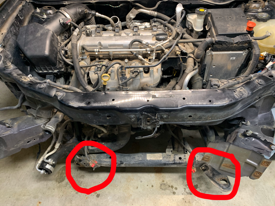

Started to tear into the Colbalt today since I took the day off work. Once I got the radiator and AC condenser off noticed the 2 brackets circled are bent. Are they needed to bolt to the Goblin chassis? Car was in a front end wreck.
