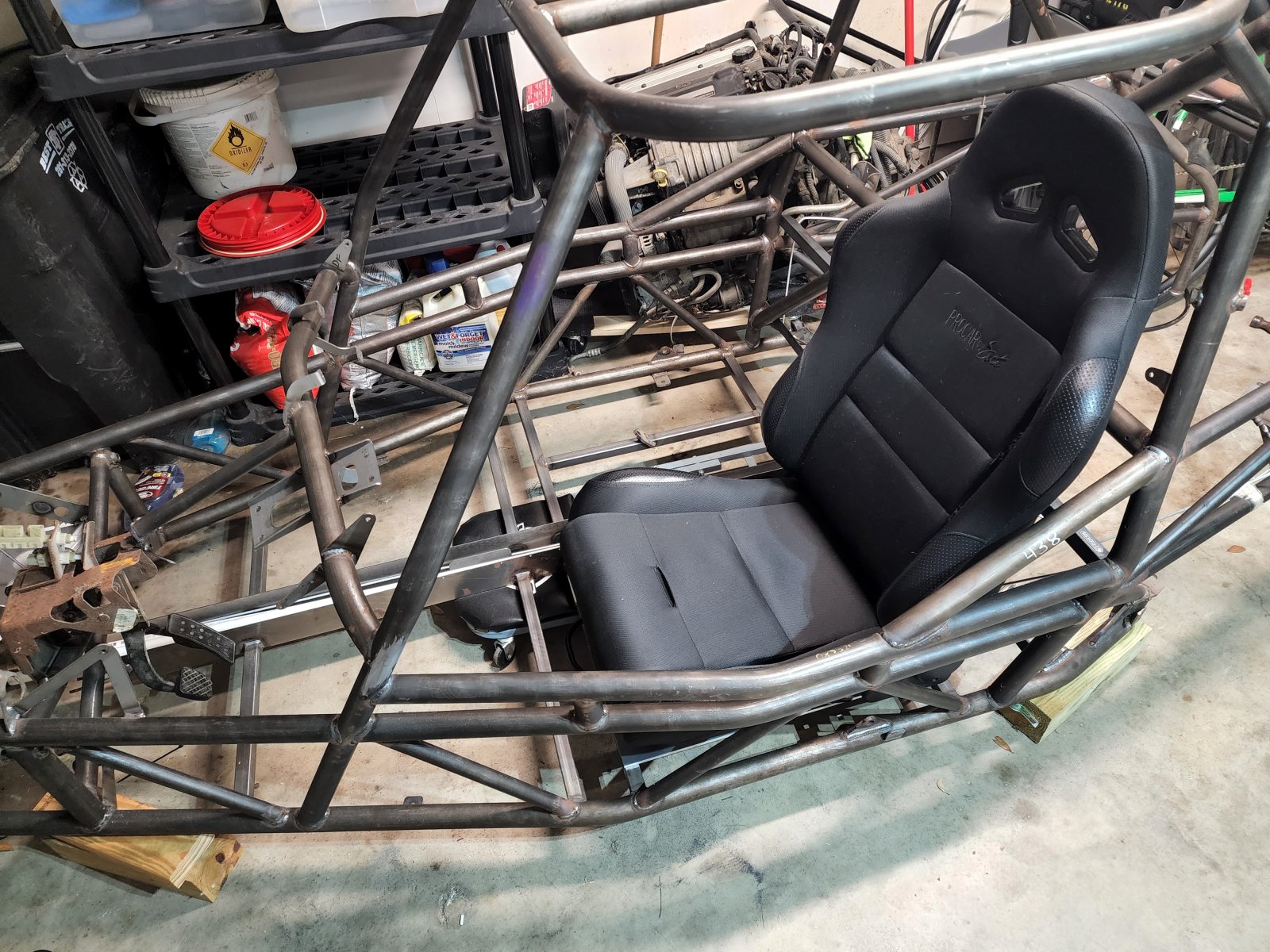

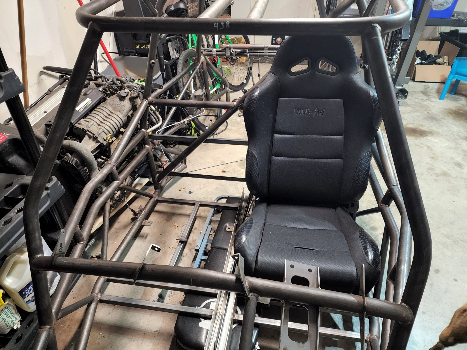

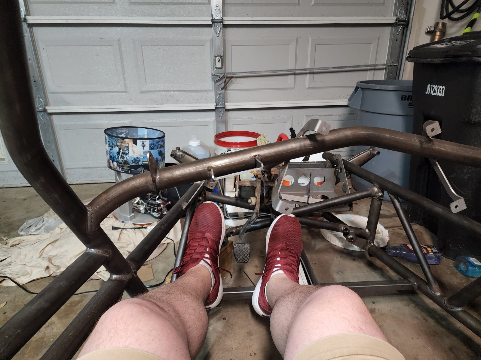

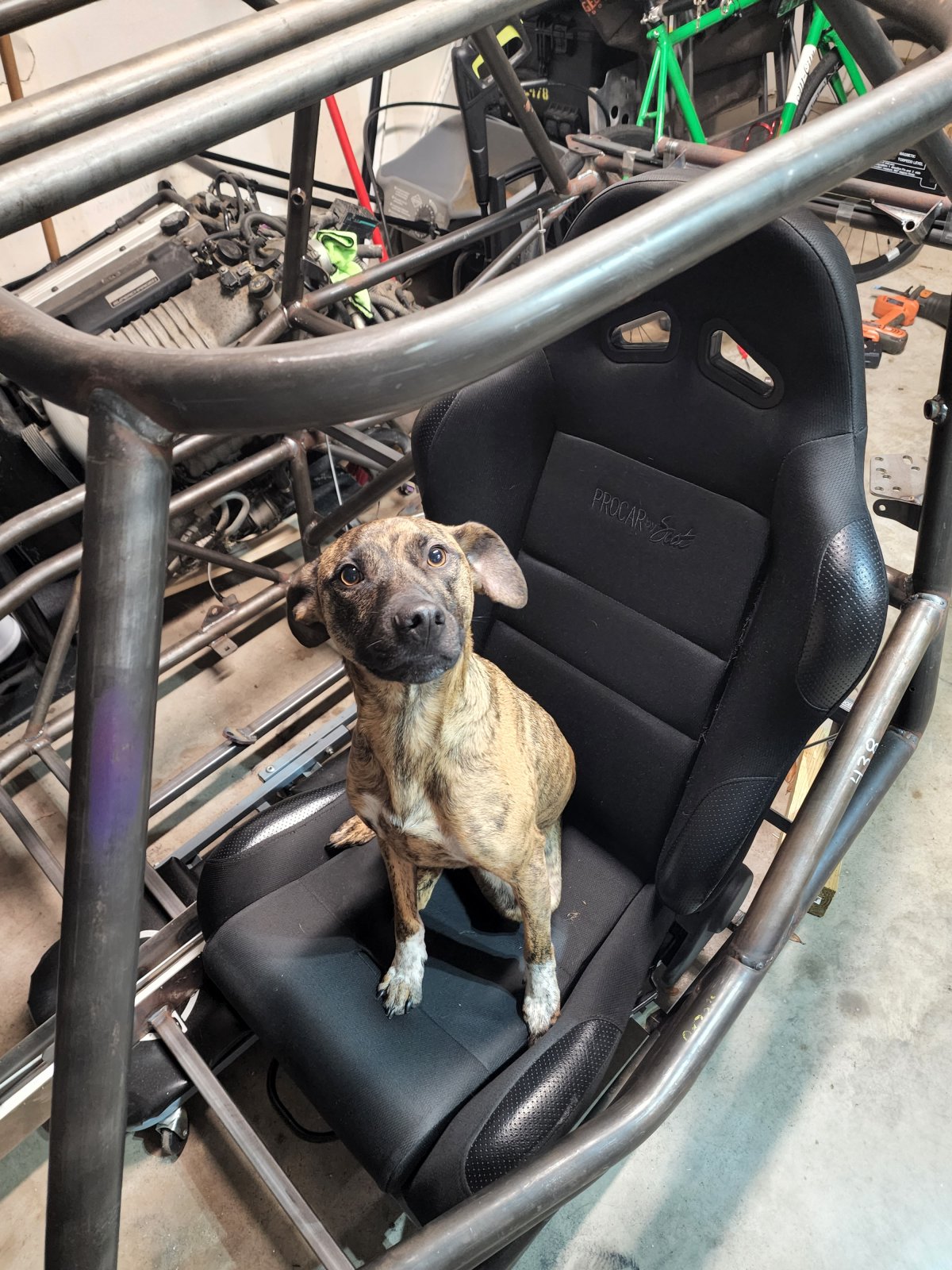

More progress tonight. Got the seat mounting figured out and mocked up. I'll take the plates to work tomorrow and machine the mounting holes.
It appears I'm not the only one ready to go for a drive!

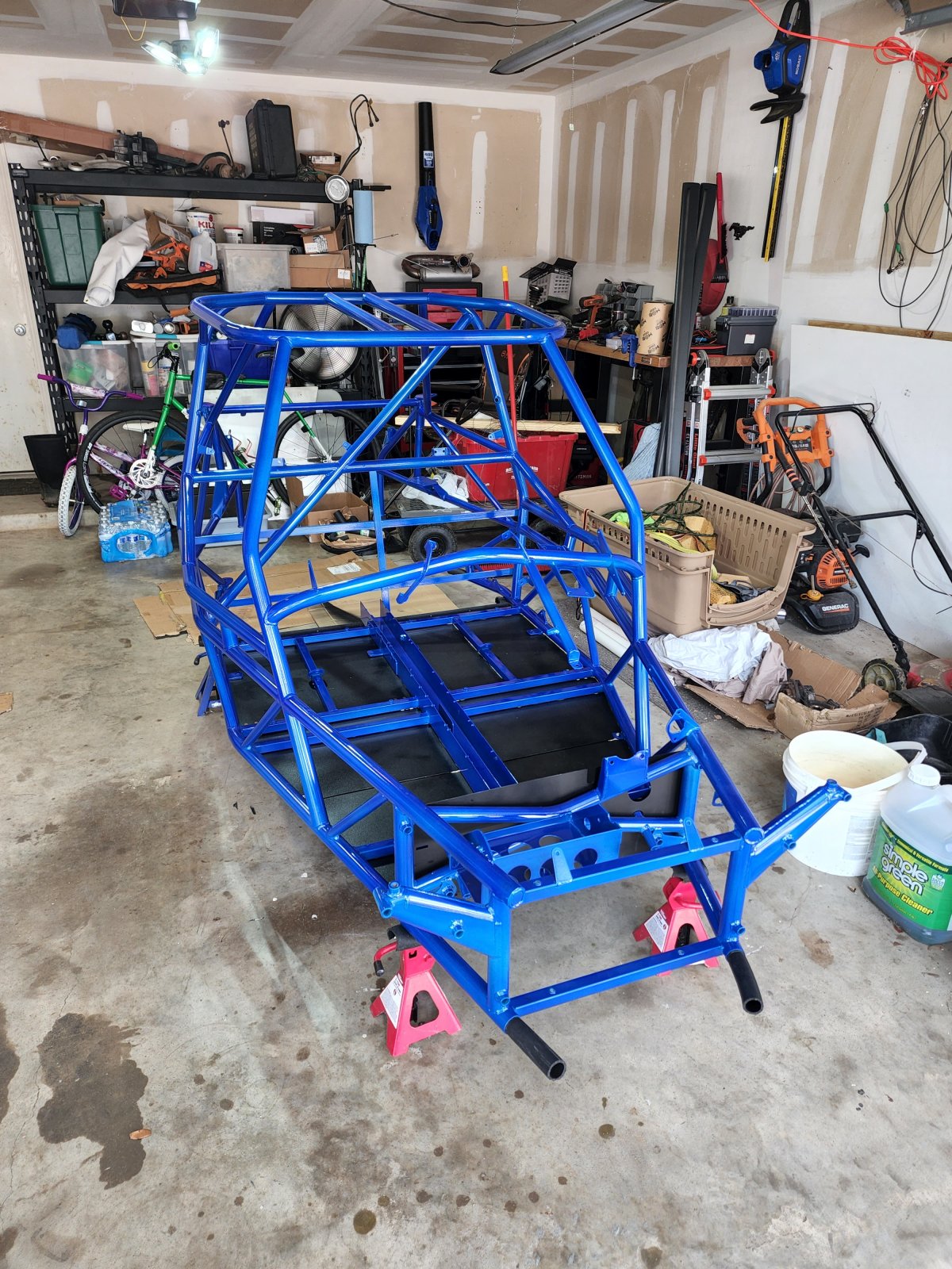

I've been slowly chipping away at things. The wiring harness is finished aside from fully wrapping everything. I'll do that after I get the engine running. The frame is ready for powdercoat and will be dropped off in a week or two when they have room.
Feels like I'm starting to make real progress now. Excited to get the frame back and start bolting parts on!

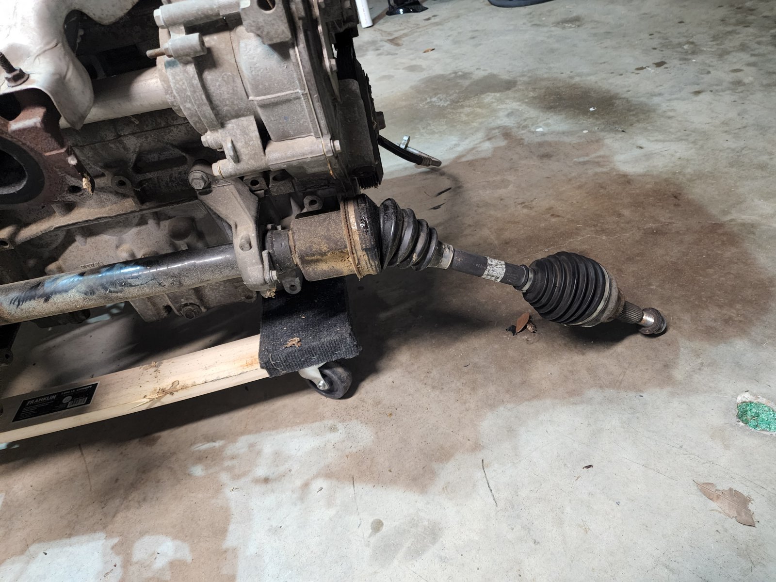

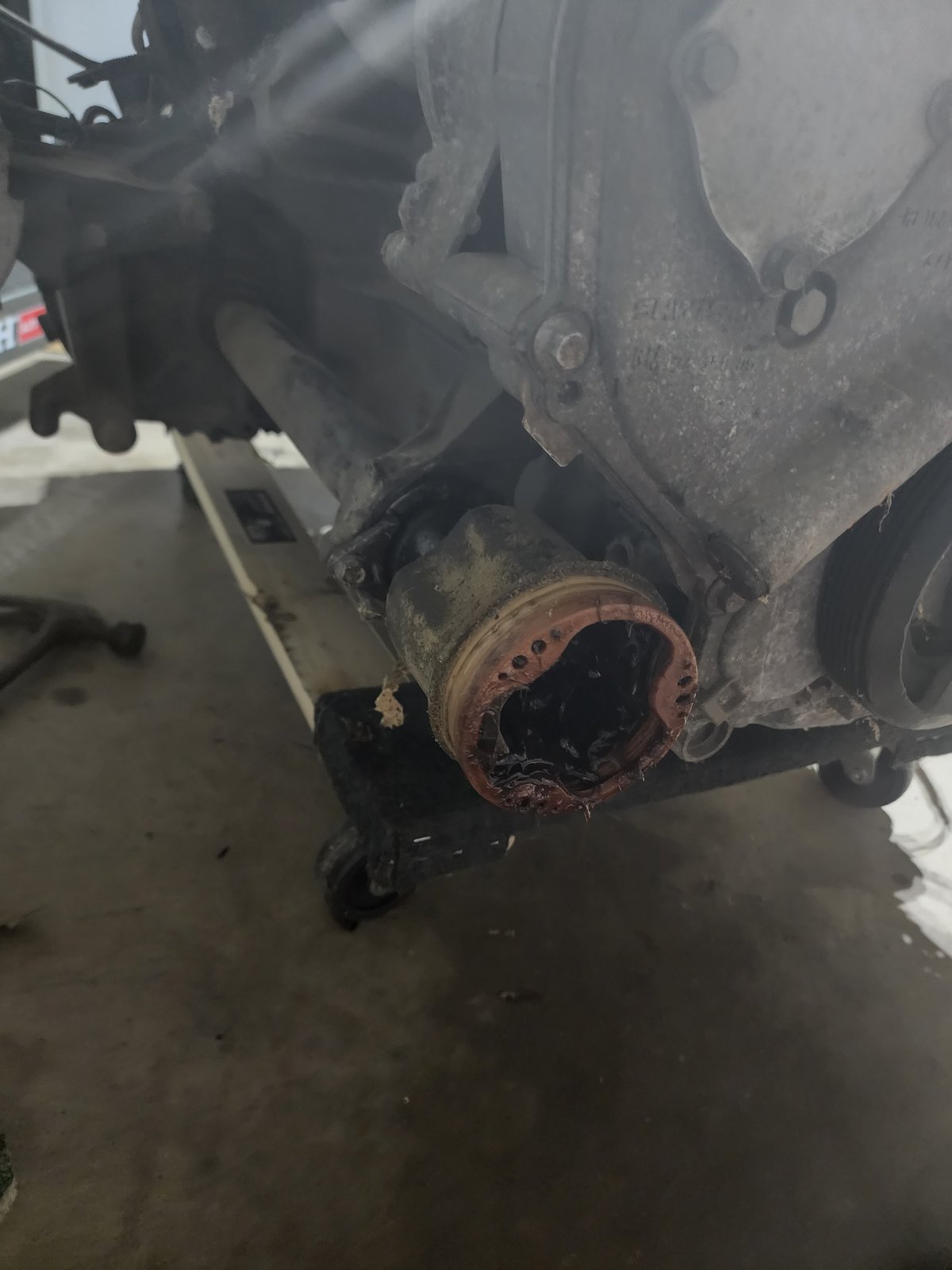

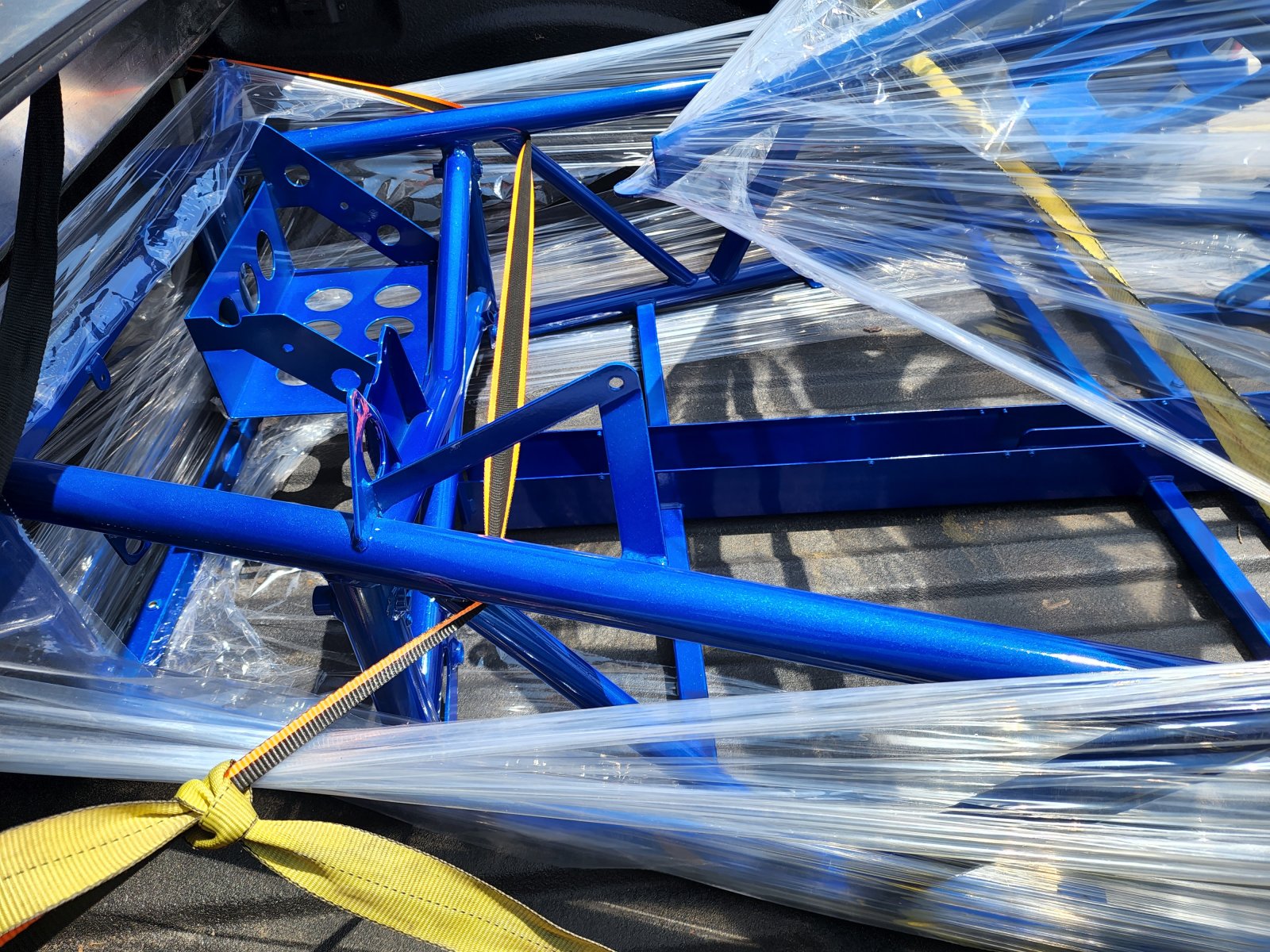

Frame should be ready for pickup at the powdercoater sometime next week so I've been working on cleaning and painting parts. One of my axles was still on the transmission so I decided to pull it out. That didn't go as planned so I'll be dealing with it tomorrow!
RCK605

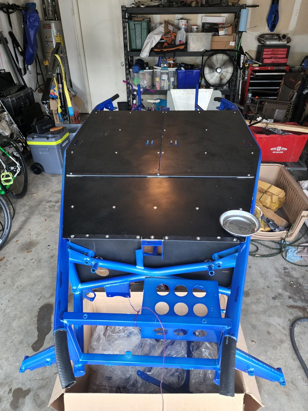

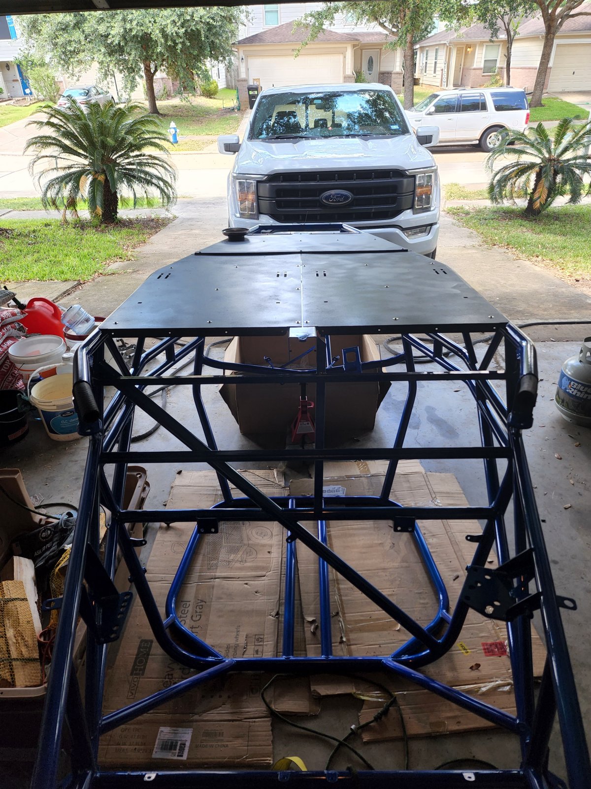

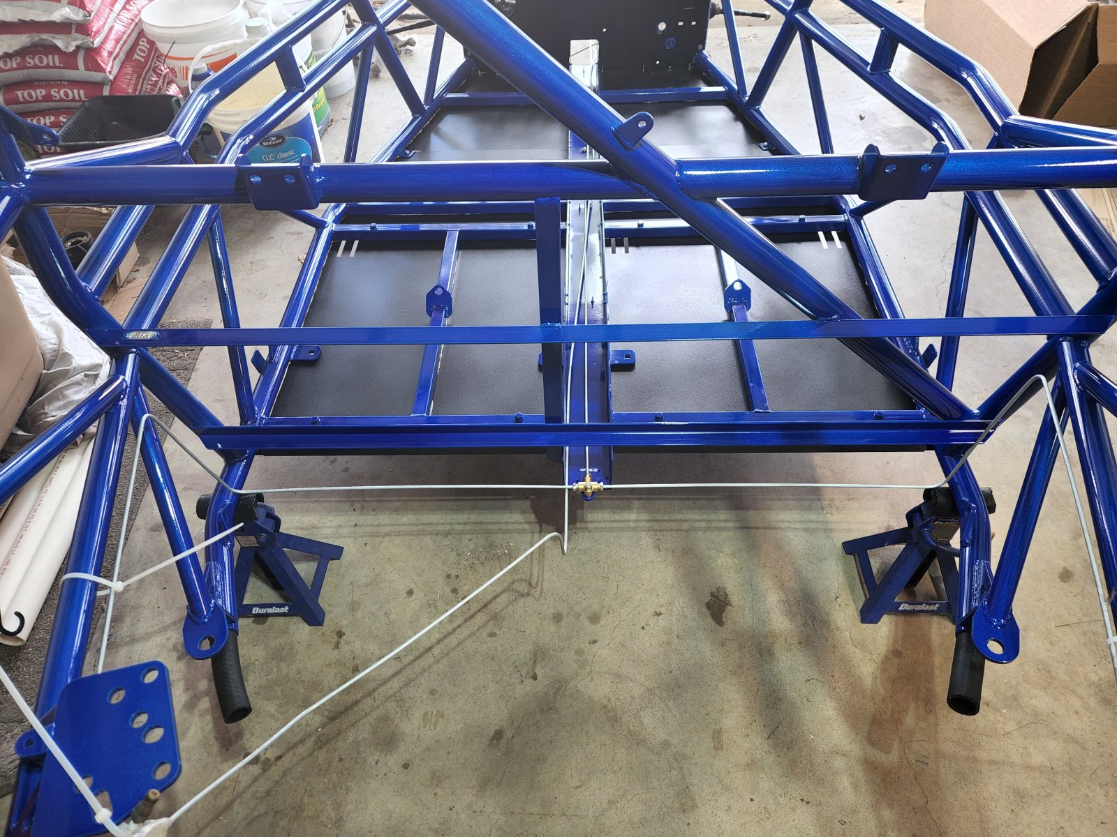

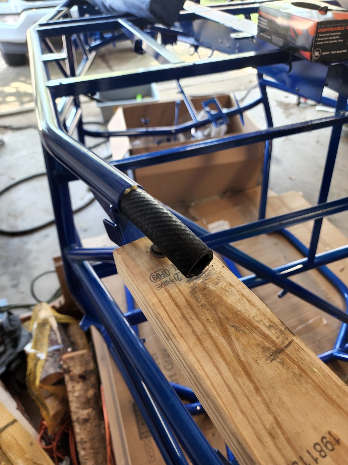

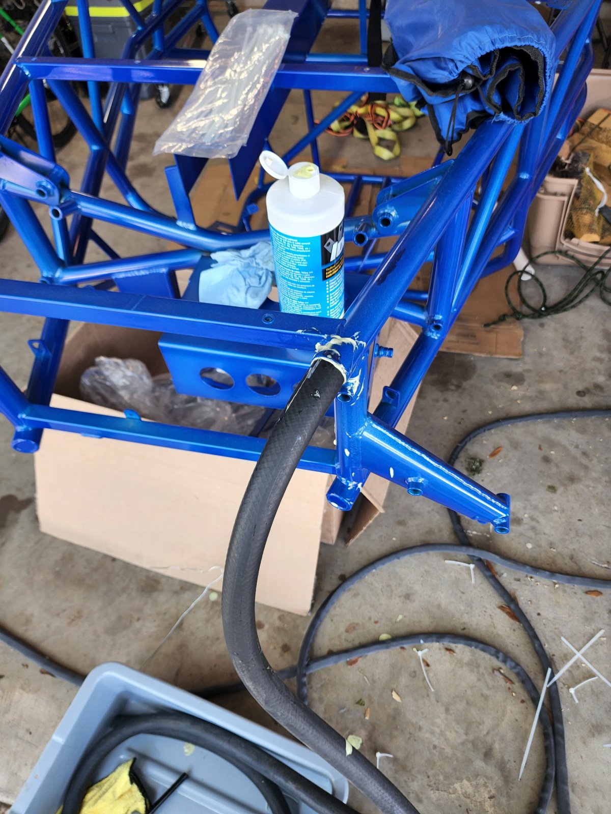

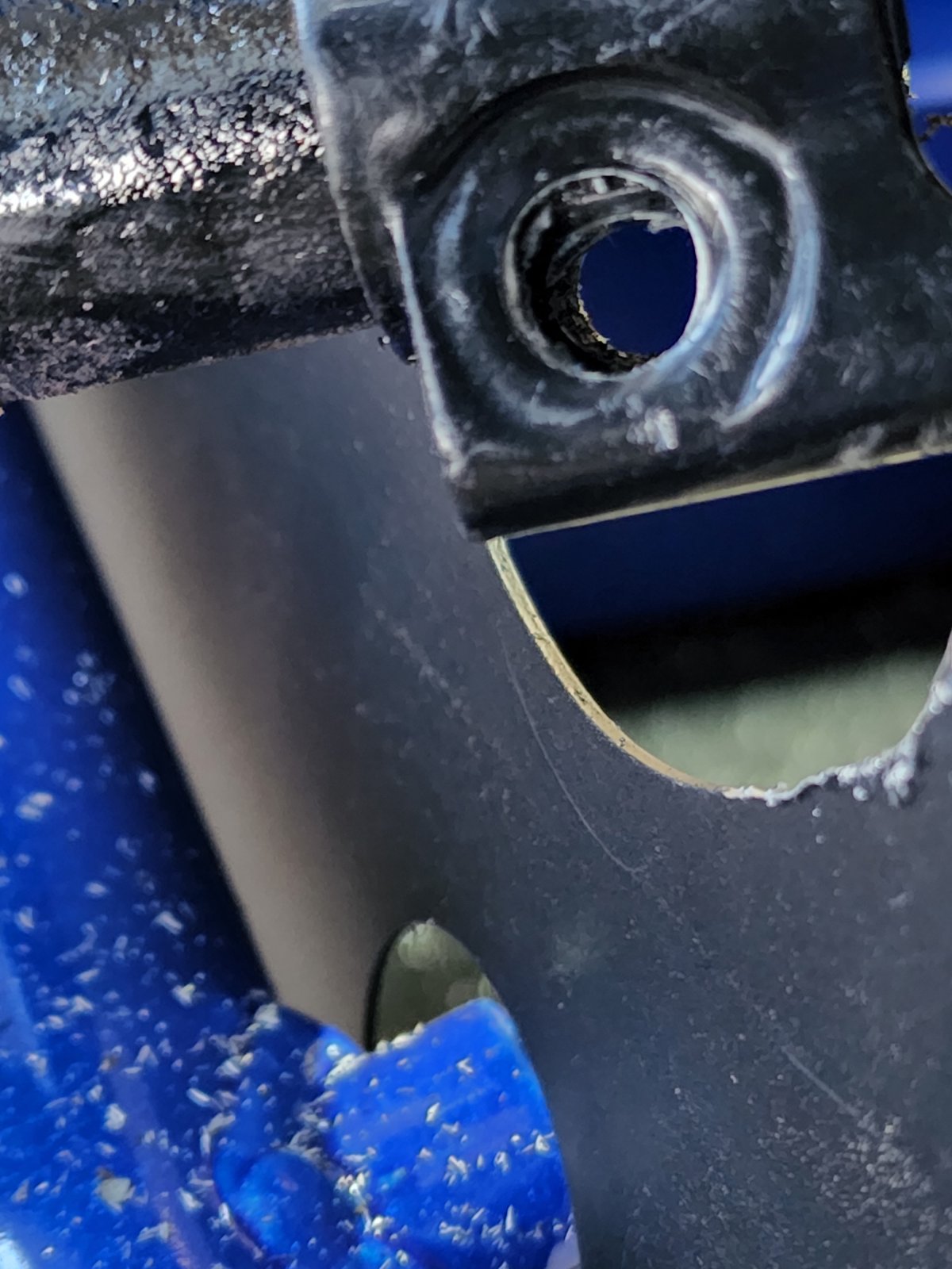

Got some work done the past couple of weekends. Pulling the hoses went pretty smooth. If you haven't done this yet, I recommend pulling a towel through the frame a couple of times first. I had a lot of sand come out.

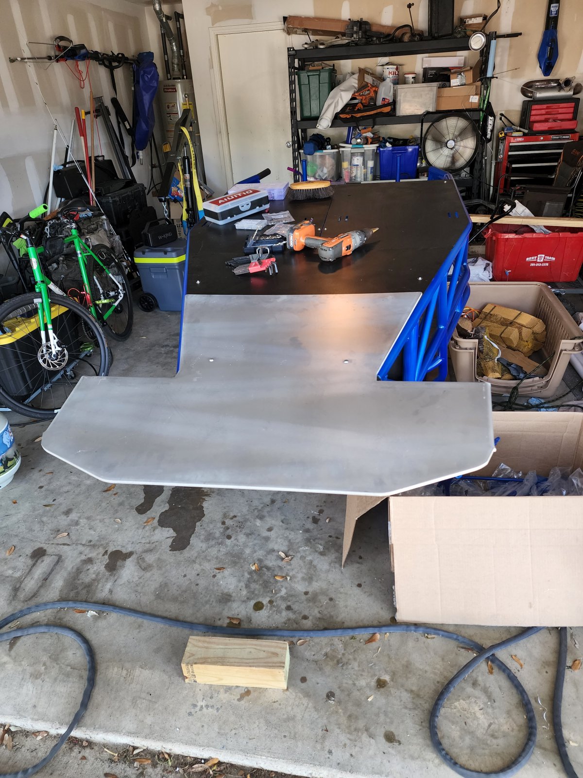

Floor went on pretty easily. Minimal mess from the urethane adhesive. Mocked up the splitter as well.

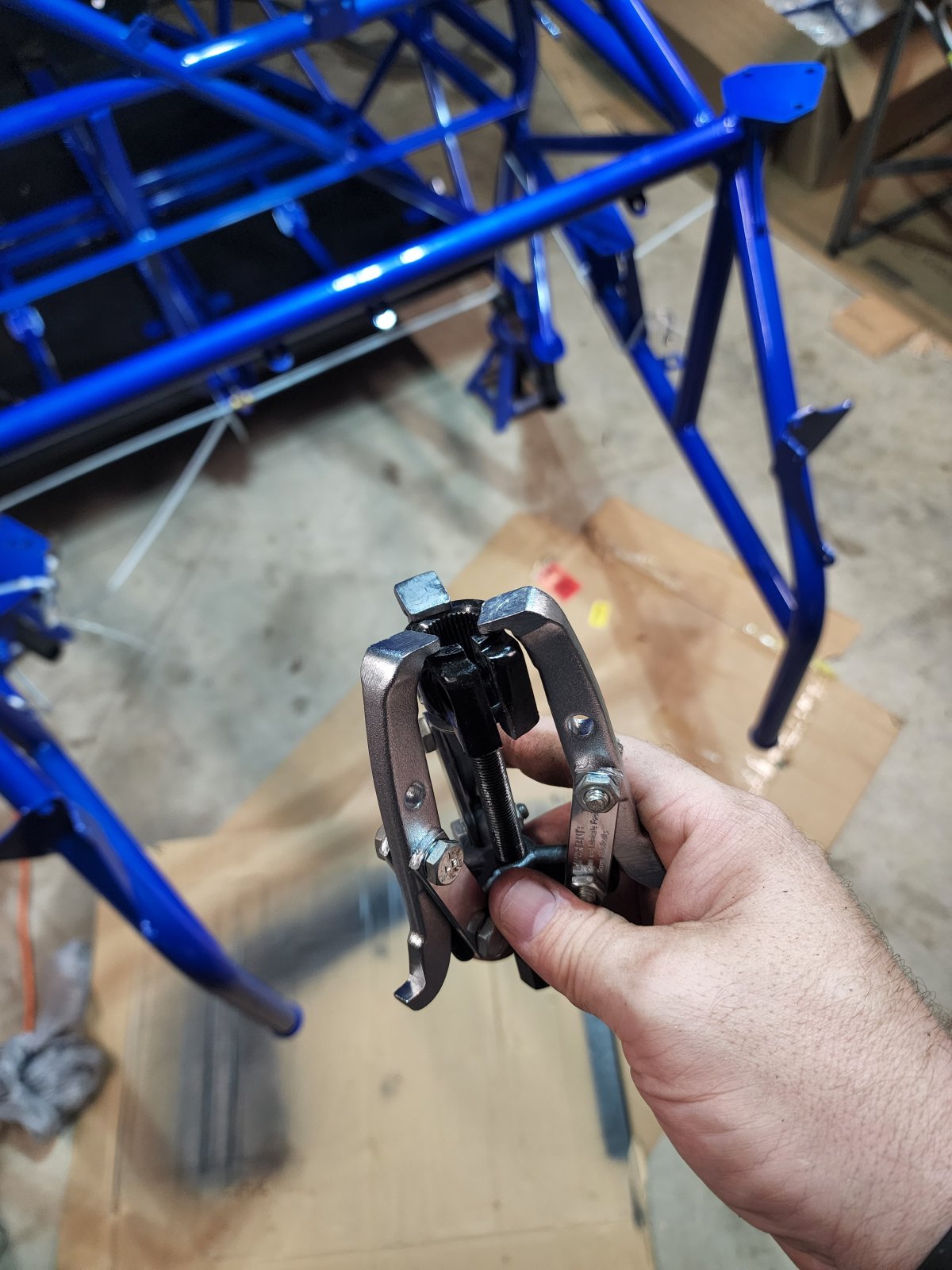

Then I ran into problems. The cheap steering shaft I got off of Amazon has the hole drilled in the wrong spot and can't get the bolt through on the steering rack side. Then I couldn't get the spline side off so I had to cut it and use a puller. I guess I'll be getting a new one of those now.
