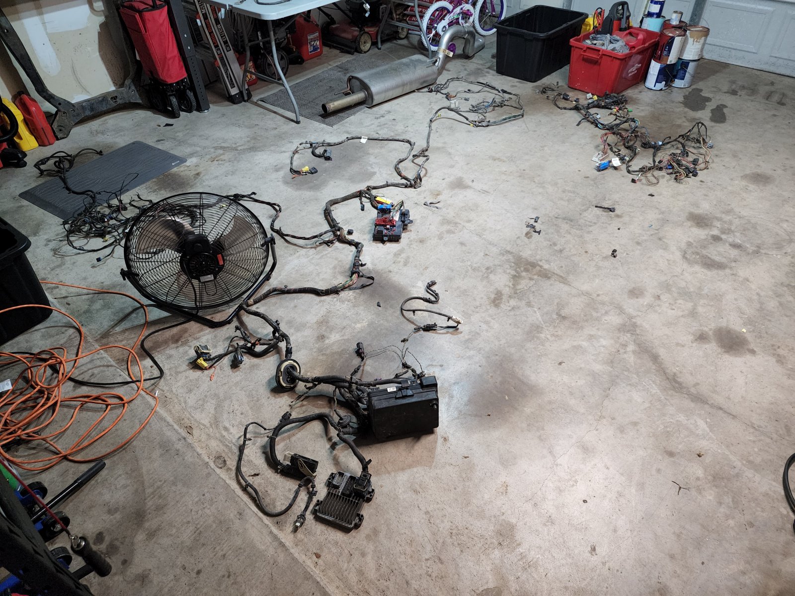

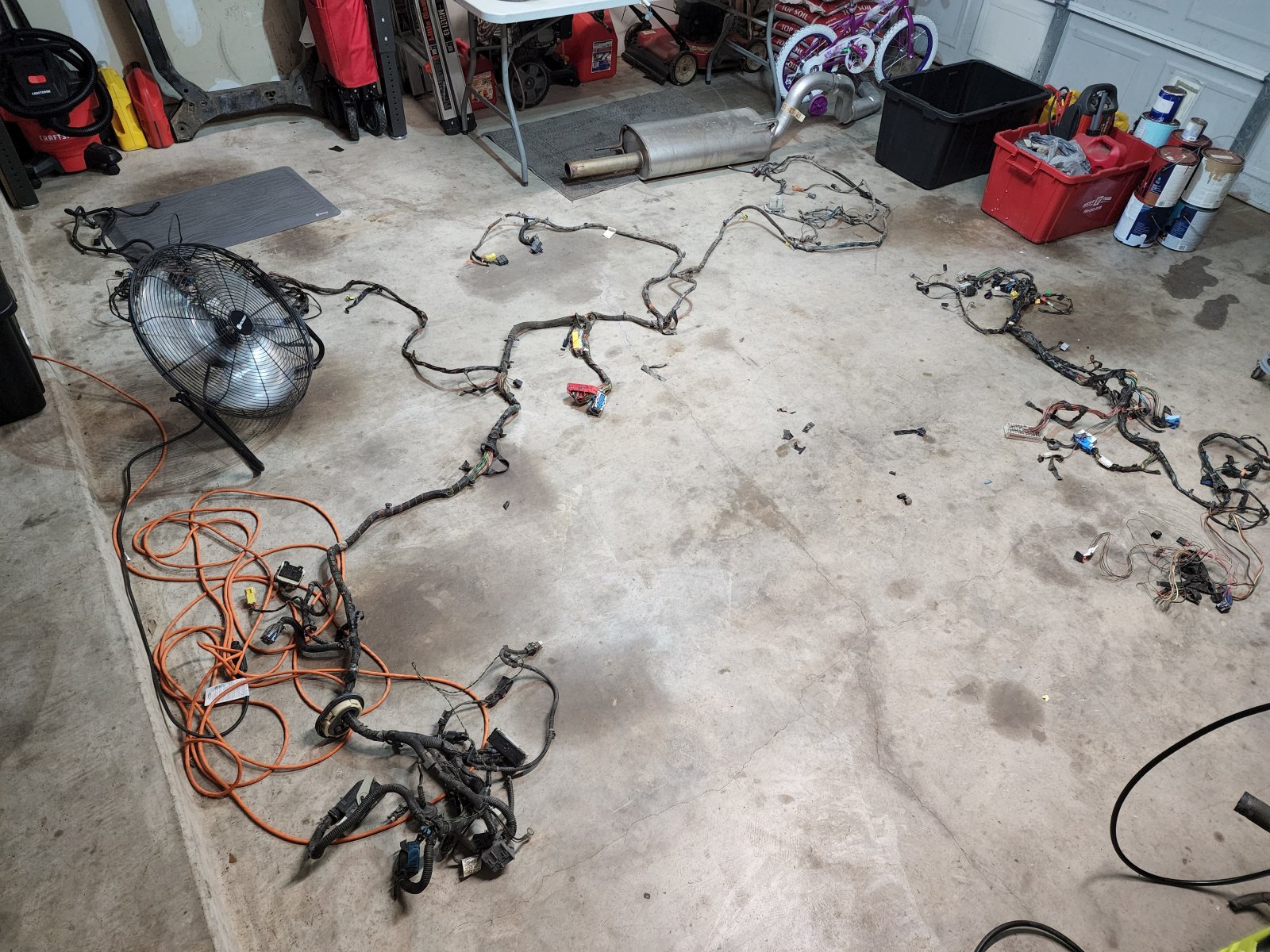

Finally finished cleaning out the garage and organizing everything. Now I can start on making sense of the wiring harness and cleaning parts.

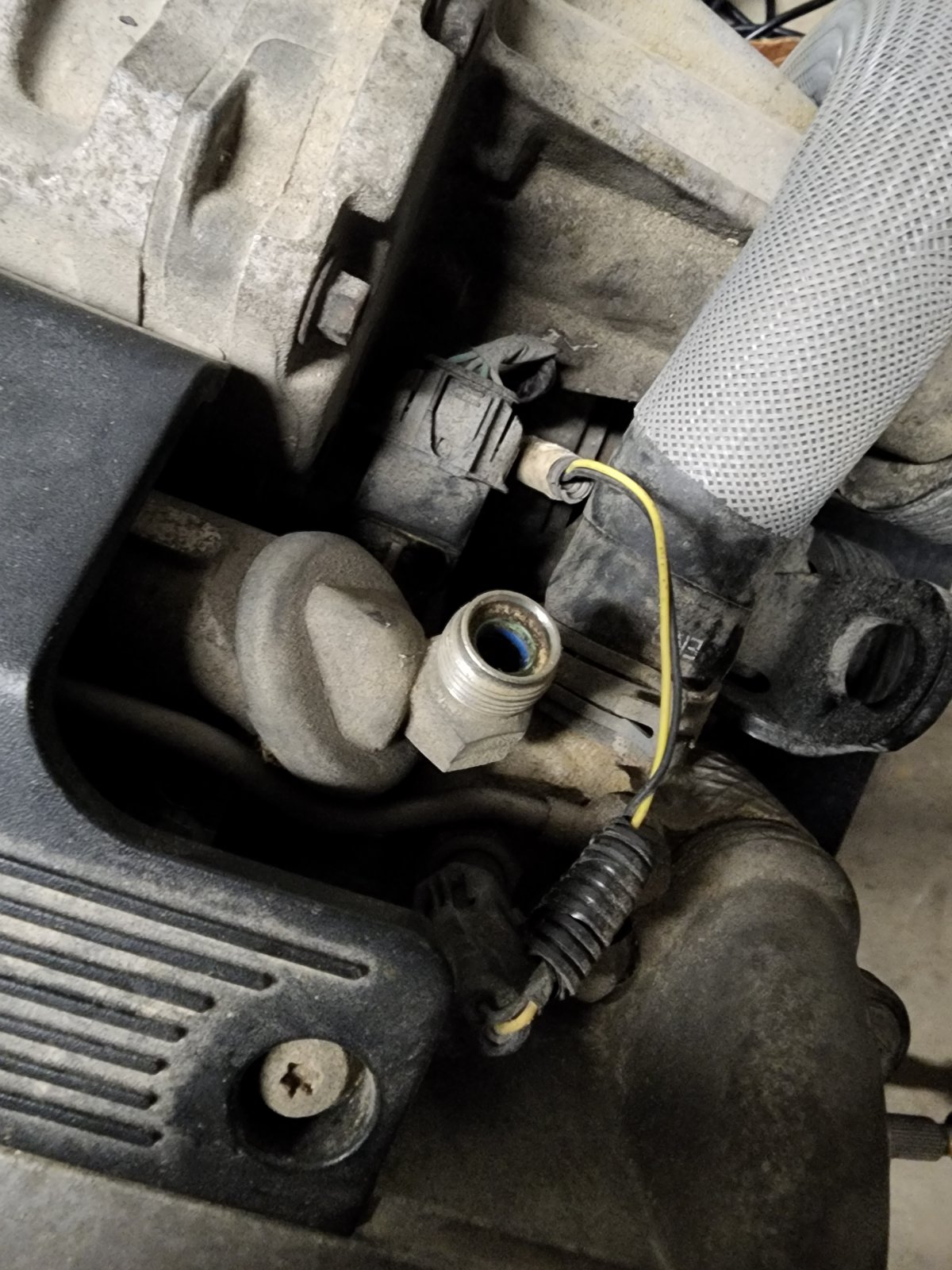

Found a solution to my missing fuel injector feed line. CBM Motorsports makes an adapter to convert the tube fitting to -6 AN. You can find the part here:
The description calls for 2.2L and 2.4L engines, but I confirmed with CBM that the part has a M20x1.5 thread which matches the fuel rail.
If you want to run a return style or boost reference fuel system, OTTP sells an adapter for the end of the fuel rail. I plan to install this adapter as well and use both for inlet. I've seen it mentioned in a couple places that cylinder 4 can get starved of fuel under certain conditions. Since my motor is stock I don't think I'll have a problem, but since I have the part I might as well use it!
Here is a picture of the fuel rail inlet connection. This is where the metal feed line with the QD attaches, but mine was missing and the part is discontinued and I couldn't find one anywhere.
If you run that OTTP Fuel Rail Fitting (LSJ), then it goes in place of your stock pulse dampener.
So by putting fuel into both sides of the fuel rail, you might be creating a problem by eliminating the dampener. Unless you are also going to replace it with an aftermarket one... but wouldn't it just be safer and easier to leave it stock, with a proven system for the stock injectors?

I would leave the stock dampener unless you plan on running a BRFPS because the dampener will help hold the fuel pressure up to the stock (52?) lbs. the reason for the adapter from OTTP is to allow the BRFPS to dynamically regulate the fuel pressure based on the boost.
RCK605
Both valid points. I was a little concerned about the dampener. Sounds like I might create an unnecessary issue by using both ends as an inlet. I guess I'll just hold onto the OTTP part until I turn up the boost and switch to a BRFP.

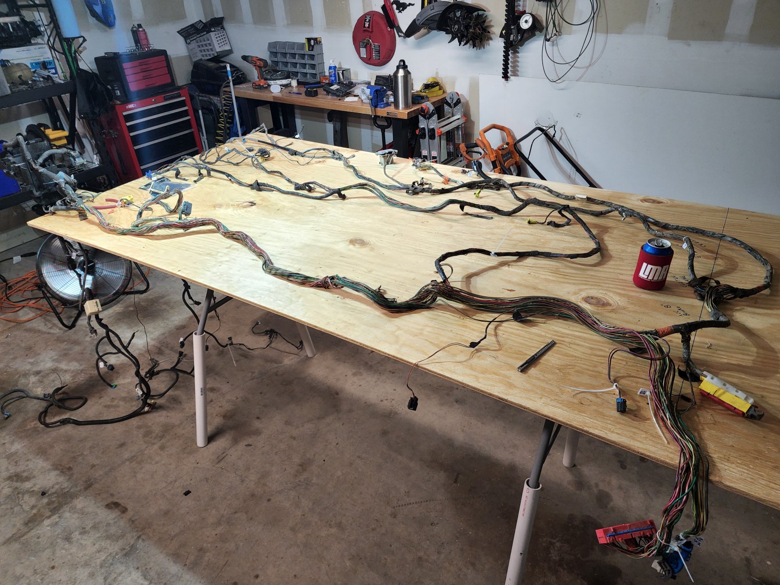

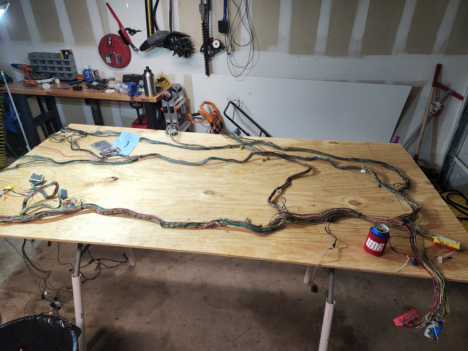

Took the first bite of the elephant tonight. I'm hoping by the end of the weekend I can identify most of the connections by plugging things in. Then I can get them labeled and start the thinning.
That's basically how I ran my BRFPS. The end of the hardline going into the rail had a hairline crack, so I installed the CBM adapter and dropped a fuel pressure regulator on top of it, then the OTTP adapter on the other end of the fuel rail- in through the OTTP fitting, and out through the CBM fitting, then into the regulator, with the overflow returning to the tank. I don't think you need to run fuel into both fittings, by flowing through it with the regulator after the rail, that's about a best-case scenario for keeping the rail full and at pressure. I'm flowing fuel backwards through the rail now with no pulse dampener, but everything seems to work ok so far.

Over the weekend so far, I was able to get all of the connectors labeled. Big thanks to @Ross on that one for providing some videos of his harness and labels. Then I proceeded to remove all of the old tape and loom. My assistant wasn't too helpful and wanted back in the house before we were finished! Tomorrow I am hoping to start on thinning out the wires.
Are there any wires that the videos show to remove that people have kept? I am thinking I may want to keep some additional 12V power. I'll also be keeping the AC wire for a wideband O2.

I kept the 2 aux power ports. Need to add back the heated seats wires. I kept the dash dimmer dial and sunlight sensor, but never use it, so should have eliminated it. I kept the clock spring, and adjustable steering. Was able to put a horn button on the steering wheel. Keep what you want!
