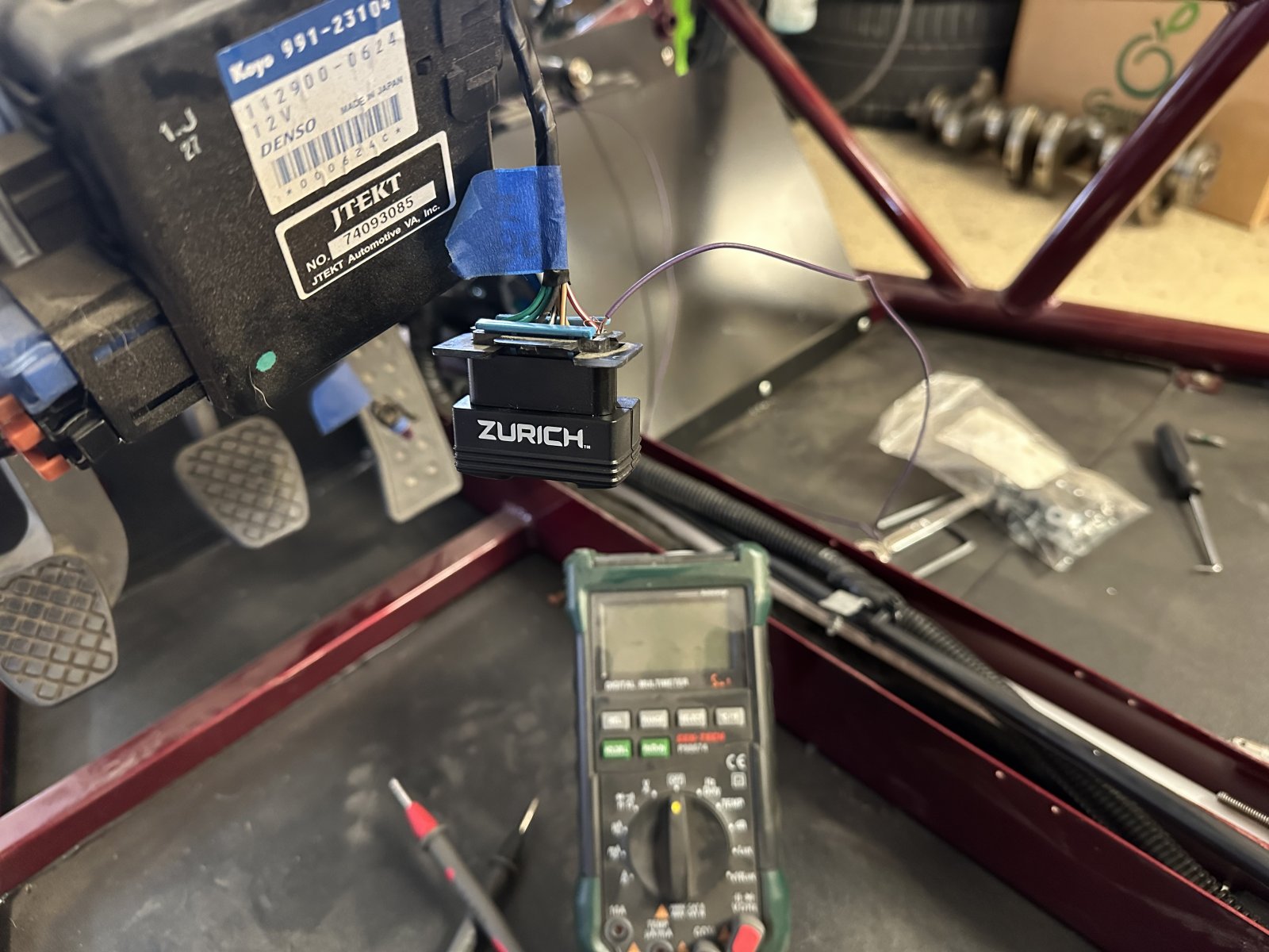

I connected the fuel rail and fuel filter with a short stretch of AN6 hose and threw on the Bluetooth OBD2 reader to immediately find that the power light on it did not turn on... Ok, problems already... A quick fix with a spare piece of wire from the battery terminal to the power pin (pin 16 red/white stripe) solved that Issue and I got my phone connected. Everything that I could read live seemed to be showing real data, so I hope that this was the only wiring mistake I made. I think I'll route that jumper wire in a clean way and make it a permanent feature unless you guys have a better idea.

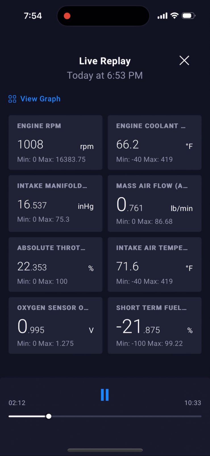

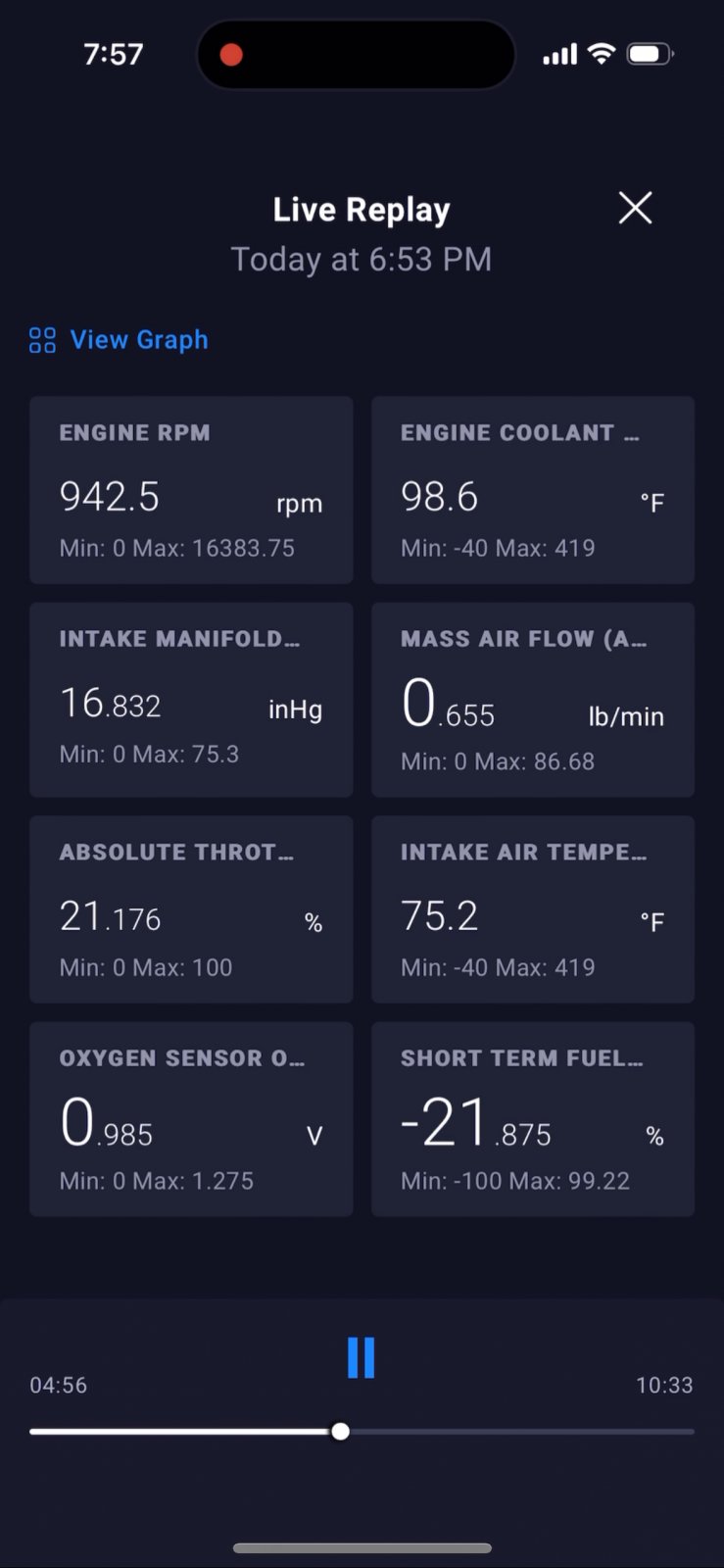

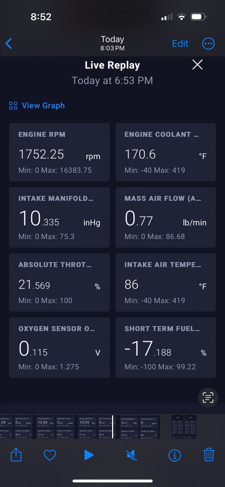

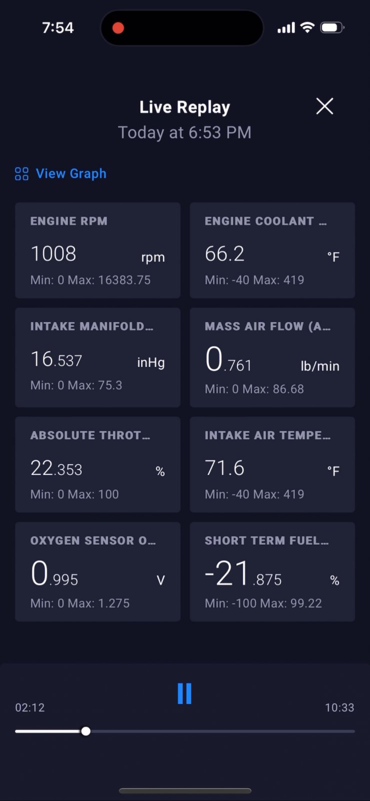

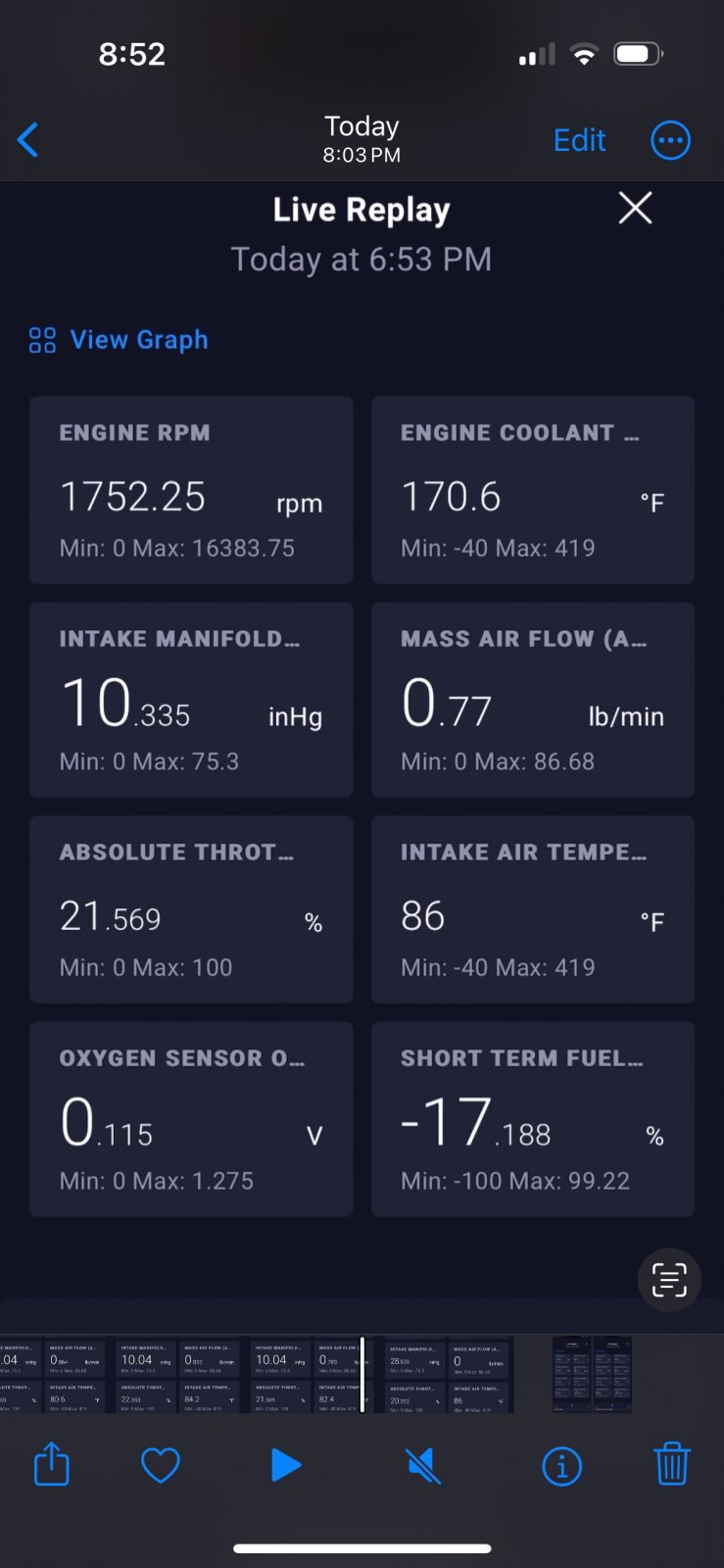

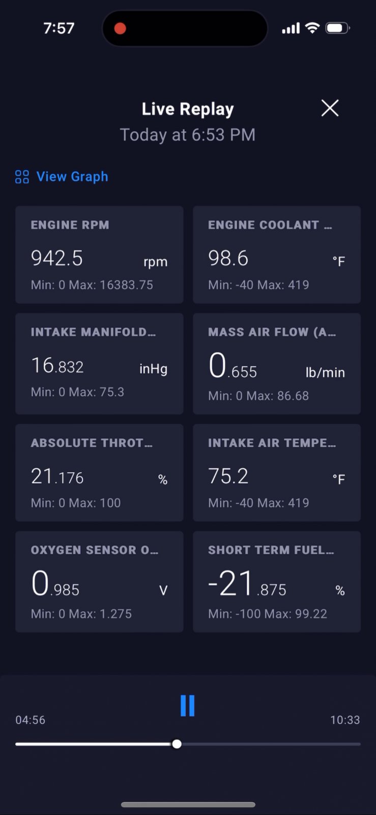

Once I got my reader running, I turned the key, heard the fuel pump prime, and started the car. The engine only turned over about 3 times and roared to life, albeit, roughly. After some coughs and sputters and a bit of help from the throttle, the car idled strongly around 1000 RPM. I saw the temperature reach about 140 degrees after a few minutes of observing at Idle... **see note below** and then held the throttle to produce about 2000 RPM until the engine coolant temp hit 170-180. Here, at the 9 minute 30 second mark, I let off the throttle to again take a look around the car, but when I let my foot off the throttle, the engine sputtered out. I tried to restart it and it didn't want to fire up unless I gave it some throttle. At this point, I didn't push things further and am letting it cool while I make this update. I'm not too concerned because I made so many big changes that it needs tuned BADLY, but I can't say I'm not concerned. Total run time was around 9.5 minutes and I've got the data log to share:
click on the Reddit links to see first start idle and data log in real time.
Pics of different point at first startup. time correlates with time ran:
