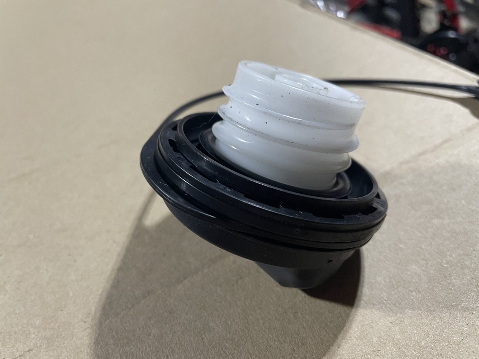

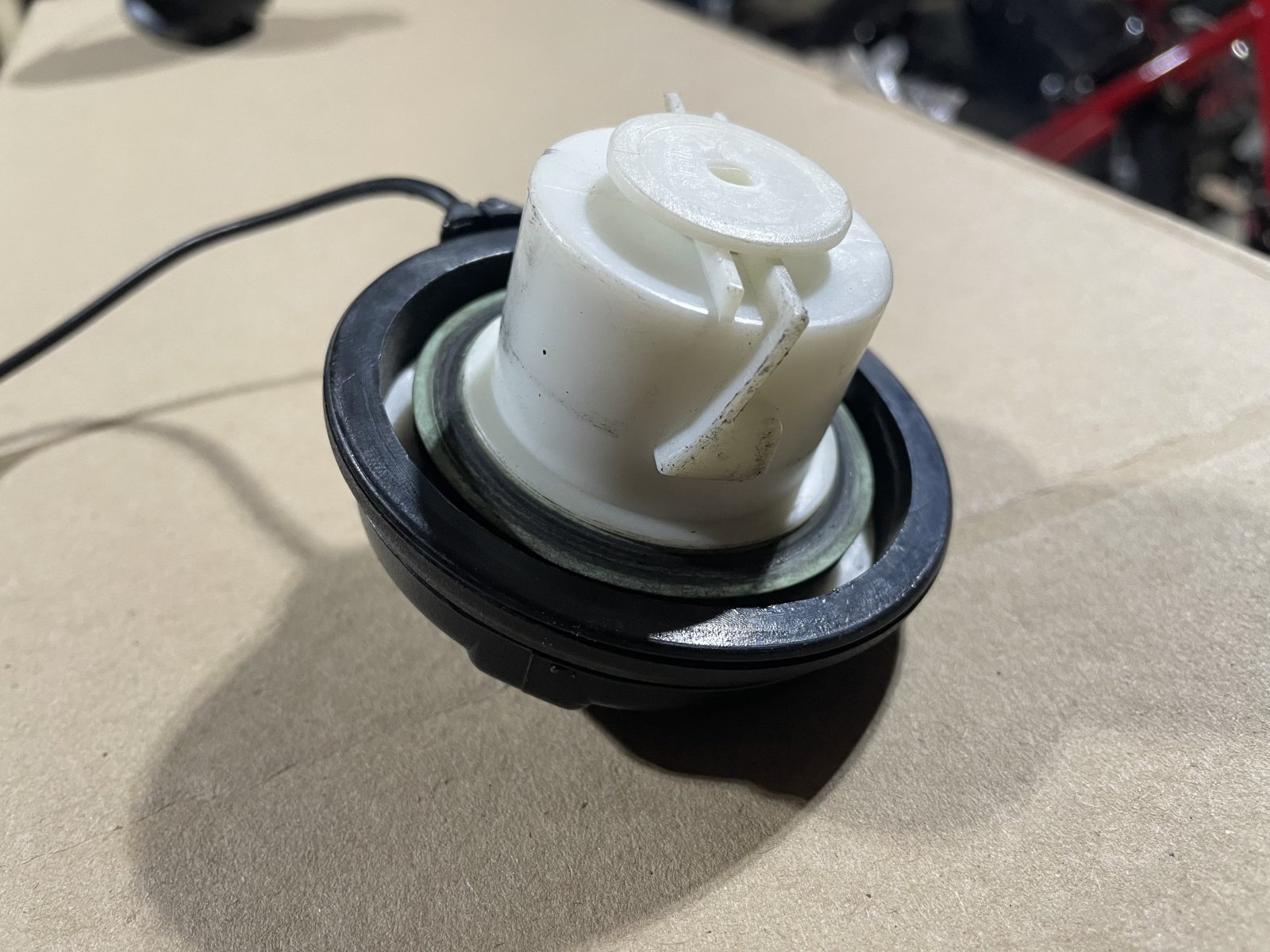

Also, hopefully fixed the fuel smell when turning left issue. Got a gas cap from another member and it is very different than the new one I bought on the internets. My donor came with a locking screw type cap, so I assumed the replacement screw type was proper. Does everyone else's look like the Good picture?
Good:
Not Good:
