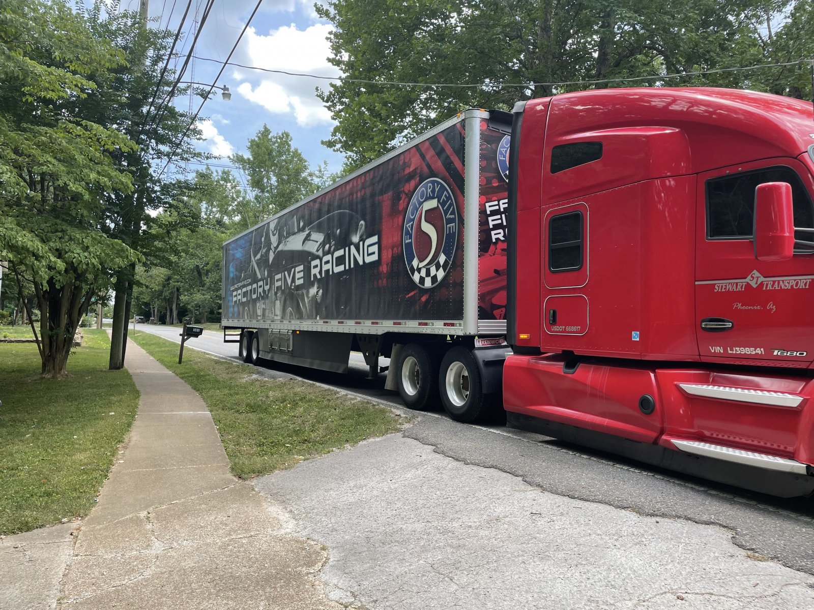

6/23/2022 Delivery Day!!!
Obligatory Stewart Truck Photos. We spent about an hour going through everything because the frame needs to go to Powder Coating tomorrow. Basically everything steel is going.
2022-06-23 1 Stewart Truck.JPG2022-06-23 Goblin.JPG2022-06-23 Goblin_Daniel 2.JPG

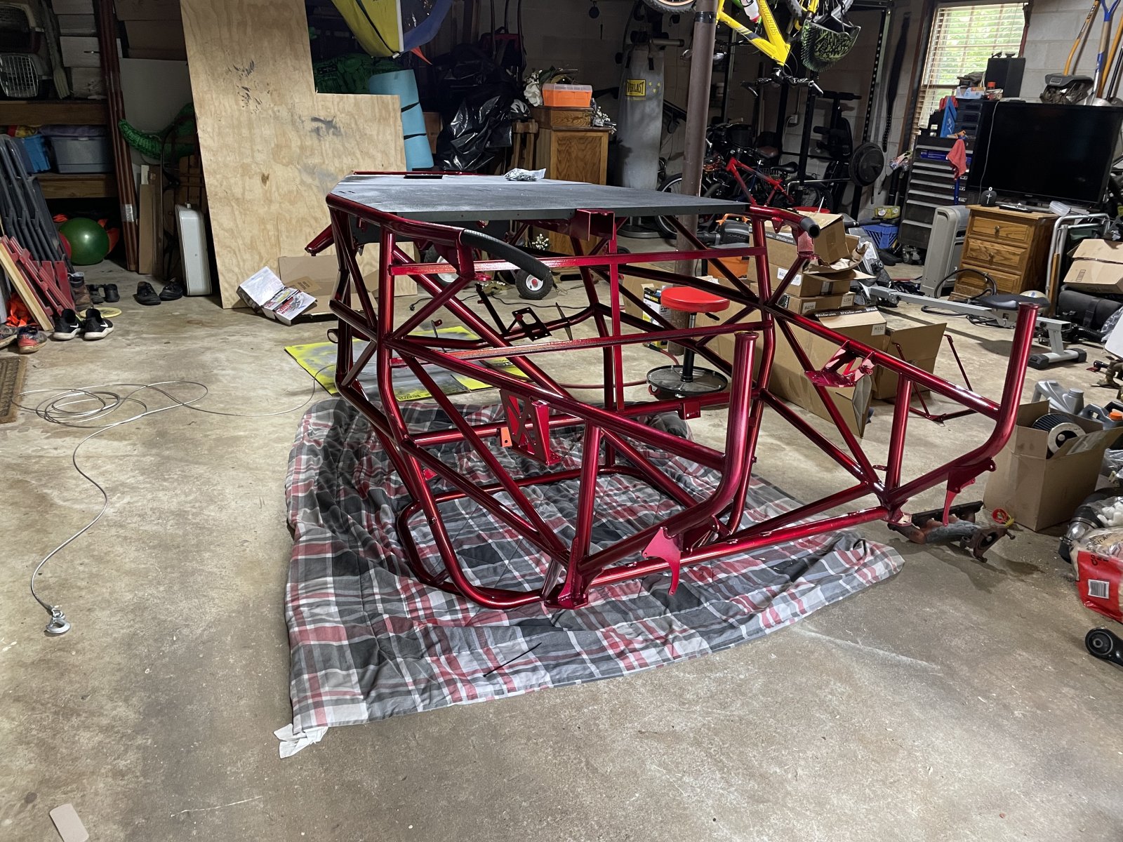

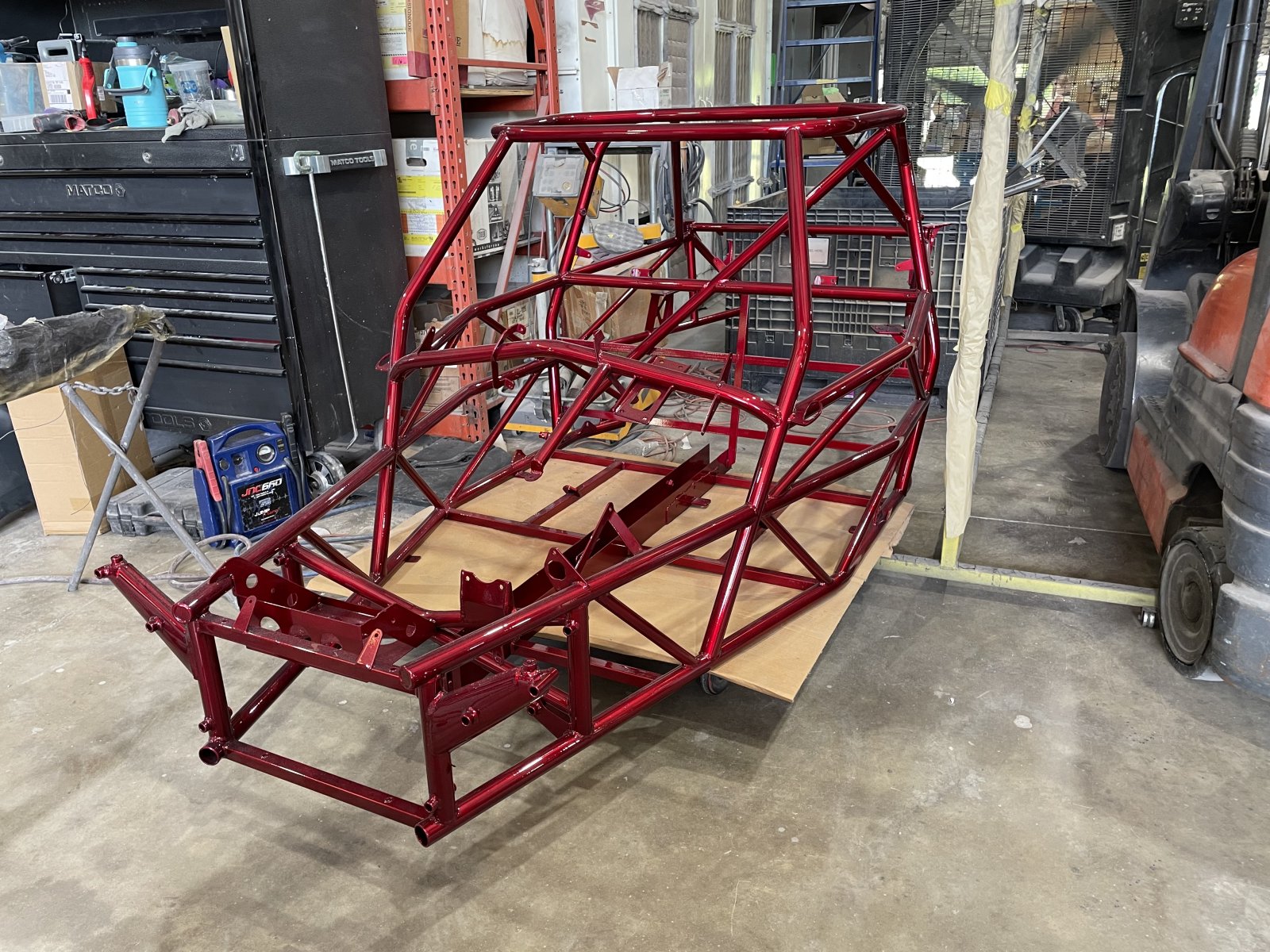

6/24/2022 - Powder Coating Adventure. My son picked a pretty rad color, Lollipop Red (UPS-1506) over Crushed Silver (PMB-1544), if anyone has seen the Soul Red Metallic from Mazda, it looks a lot like that. I personally love that color, so it worked out great. I made sure that the clear going on it will also have UV protectant in it, based off others recommendations.

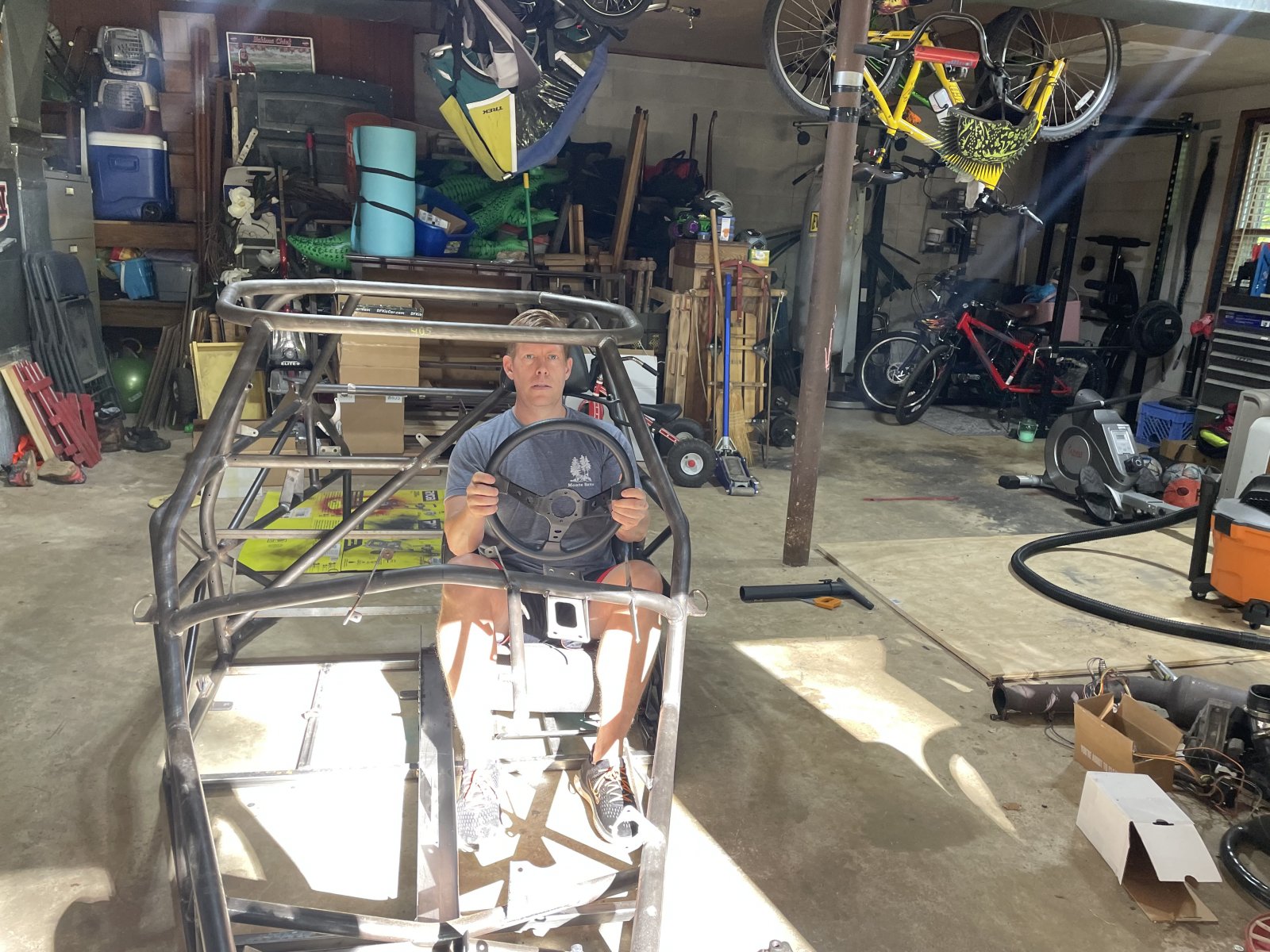

Oh, before it went to the coater we put a seat in the thing just to get a feel for it. It's going to take a little getting used to getting in/out. It's wee bit tight!
Also, stopped by to meet GTStory and picked up a set of seatbelts without seized bolts. Thanks you for those units!
vroom! vroom! :)

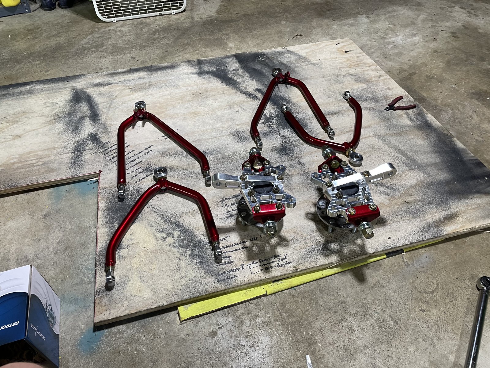

We put together the front hub assembly it went pretty easy after looking over the assembly photos and watching with the archived videos. Note, put the upper/lower bolts in before attaching to the silver knuckle. They won’t fit after.
