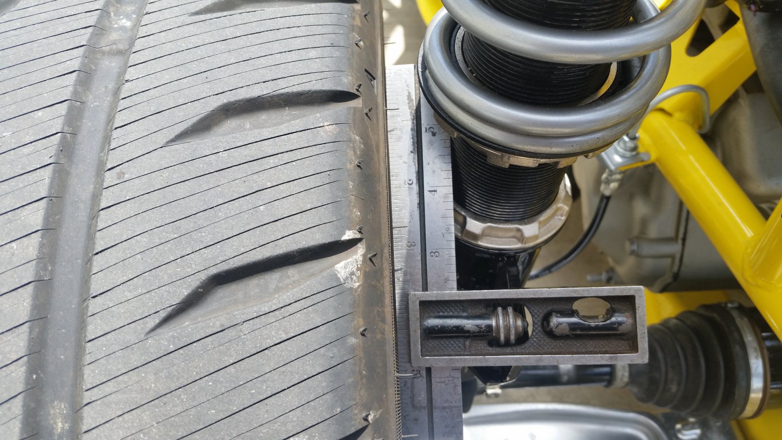

Brad - have you measured how much clearance you have between your coilovers and the wheel/tire? I'm trying to figure out if my setup needs spacers or not - and judging by an earlier picture in your thread (and the tire/wheels sizes and dims you posted) I think I might not need them.
George
I do have a 1/8" spacer so that the Wilwood caliper will clear the wheel. The wheels basicly have a 5" backspacing as my goal is to get the line through the king pin angle meets the center of the tire tread.
Brad

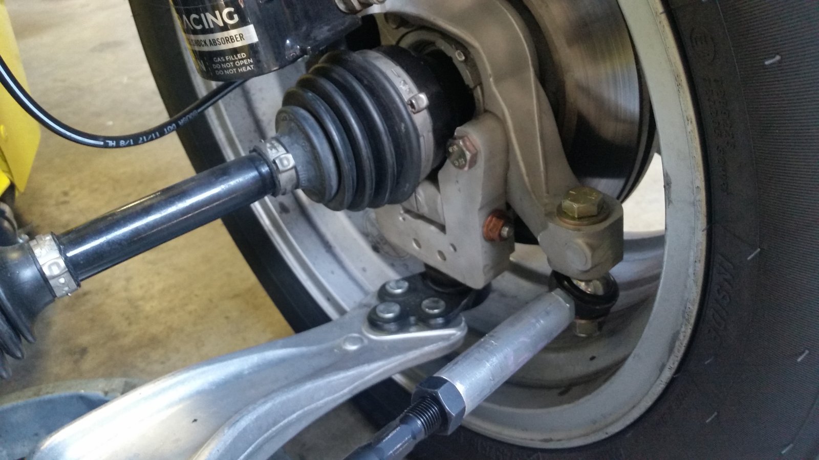

DanPerryy
Could you post some pictures of both axles showing the mods you made to the suspension. I too would like to drop my car by a couple of inches at some point.
George
I made lowe balljoint extenders so that the suspension geometry would be correct when lowered. With the coilovers from DF Kit Car the height and shock travel can be adjusted.
Brad
