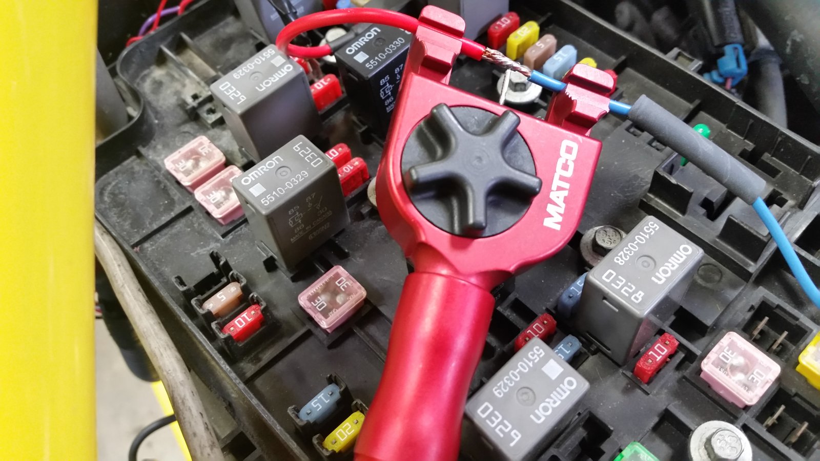

Got new tool for soldiering wires

George
It holds the wire to be soldiered you turn the knob with your thumb to advance the soldier. Yes it is a little high tech but works great when trying to do it under the dash of a car.

Neat idea. You could probably also use solder sleeves which is a little piece of heat shrink with a ring of solder in the middle. You heat it up with a heat gun and it melts the solder and shrinks the heat shrink all at the same time.
If you're a solder stickler like me, then there is one problem with using these. Some of my wiring was so oxidized it had a pretty dark coloration. Even with flux I had a hard time with getting the solder to wet the wire. I'd have to go over it a couple times and had to hold heat on it a lot longer than necessary to get it to tin halfway decent. I got so frustrated with this for my ground wiring that I went out and bought new fresh copper wire just so I wouldn't have to deal with the oxidation. If I had used solder sleeves, I would have been left with a questionable joint.
You did right by not using them. They do have there time and place, however.

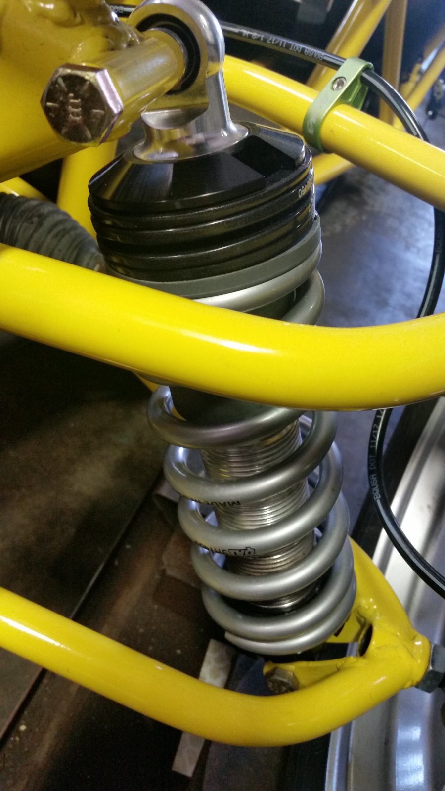

Added tender springs and sliders to front springs. So that the spring does not fallout of its perch when cornering hard.
When I run into this, I fan out the wires and physical clean them by pinching them with Scotch-Brite and pulling off the end of the wire or a knife and scraping them lightly to get the worst of it. Then I use extra flux from plumbing on the end of the solder.
Your right, its a pain in the butt soldering corroded wire.

The spring is Eibach EIB0175-250-0150, The floater divider is Hypercoil HYP18DS100, I thined the divider portion by 0.100" to get the ride height lower, as it tuned out the adjusters had to be run all the way to the bottom to get ride height with 400# springs. I have ordered a liter tender spring from Hypercoil CS100 it is 25# per inch with 4" free
length. Still experimenting only got to drive in parking lots so far but I like the change. Hopefully I will have an update on my rear suspension modifications.

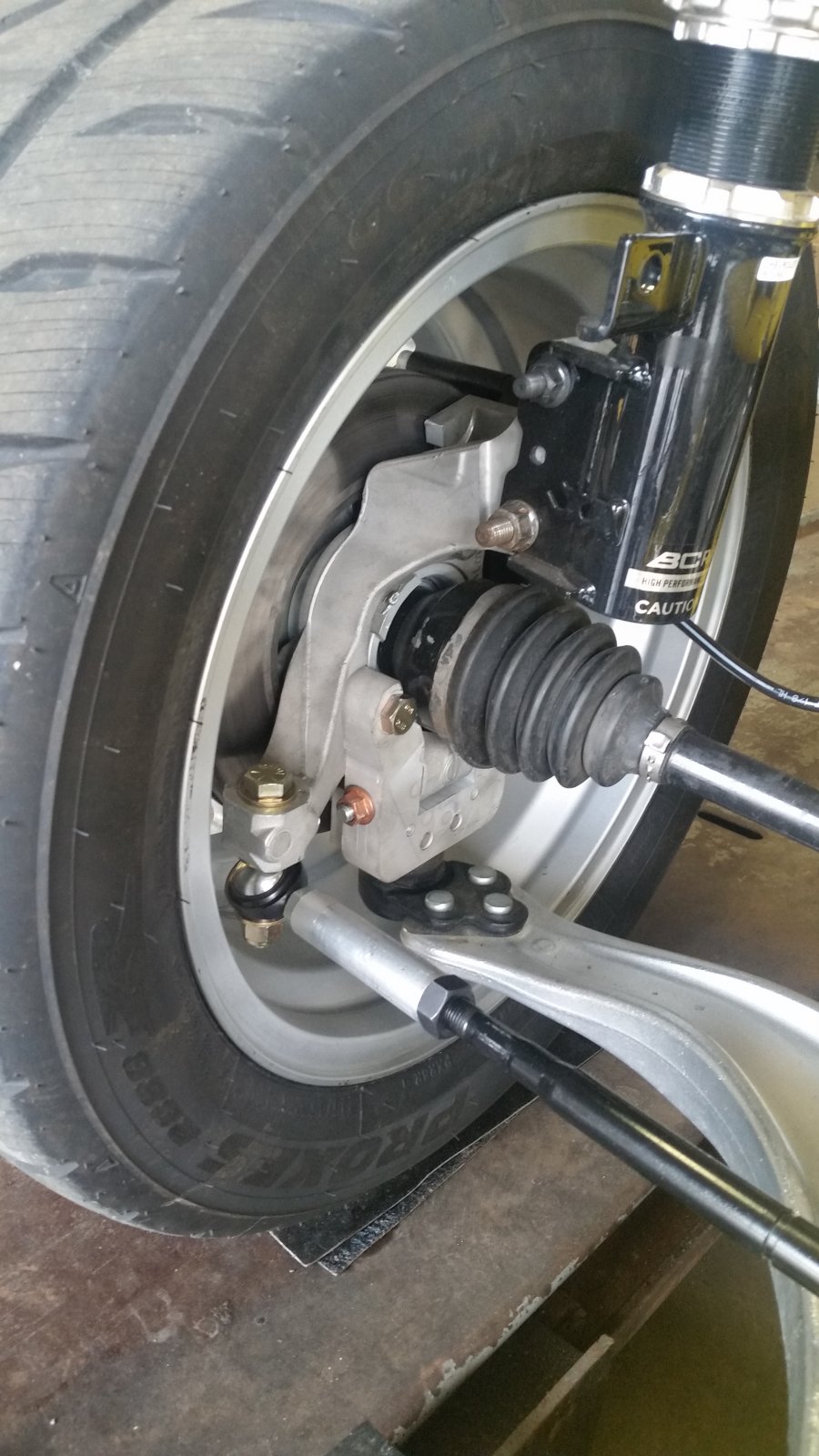

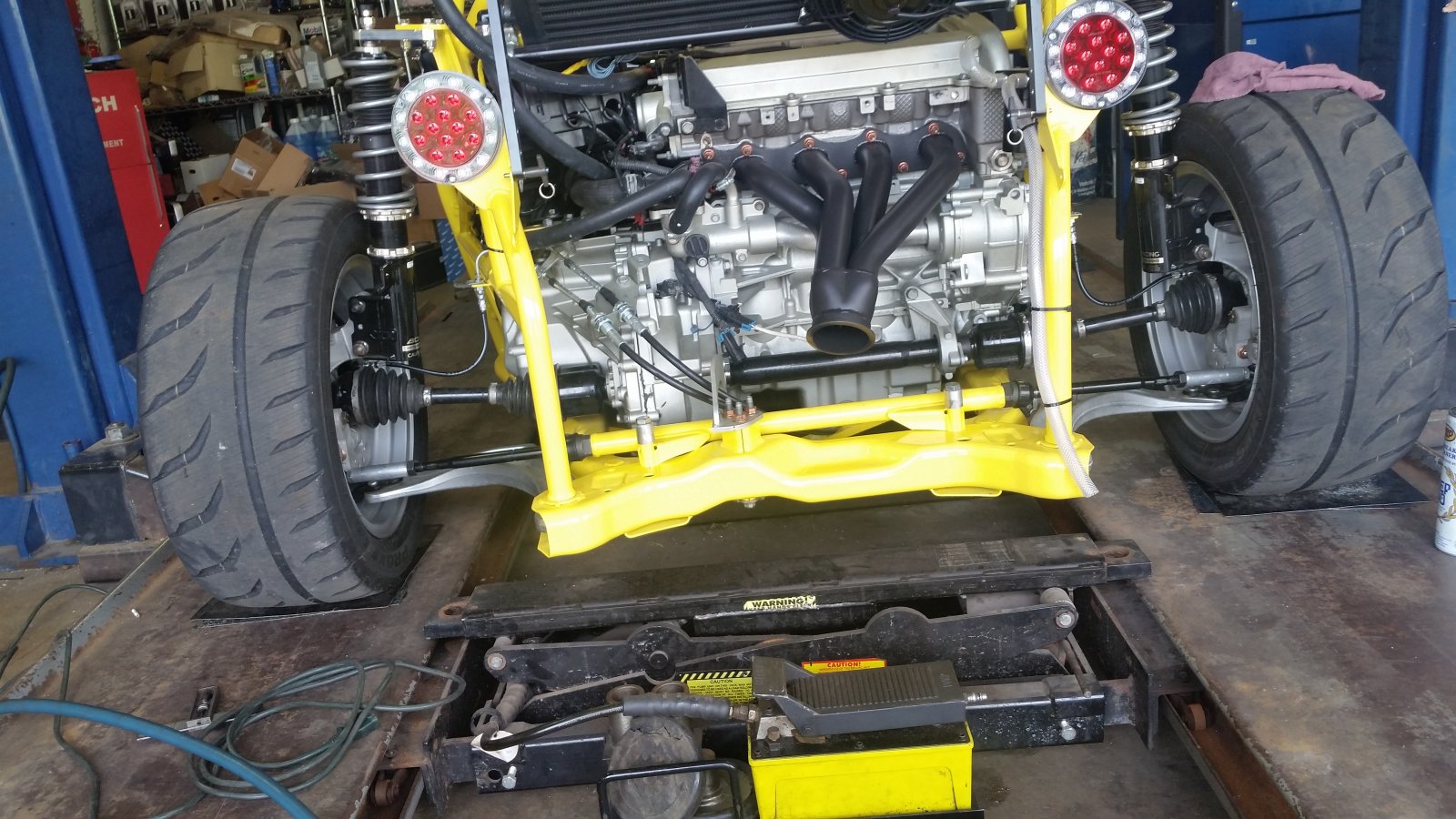

Install my lower ball joint extenders, Lowered car 1" in the back. Increased my rear roll center. Frame rails are now parallel to the ground with 5" ground clearance. Also modified the position of the inner tie rods to give 0 bump steer.
lowered rear spring rate to 150# from 300#. With the 300# spring suspension would not collapse any. Need to see if axle angle causes any issues. Note the springs a 10" long to help prevent coil bind.
