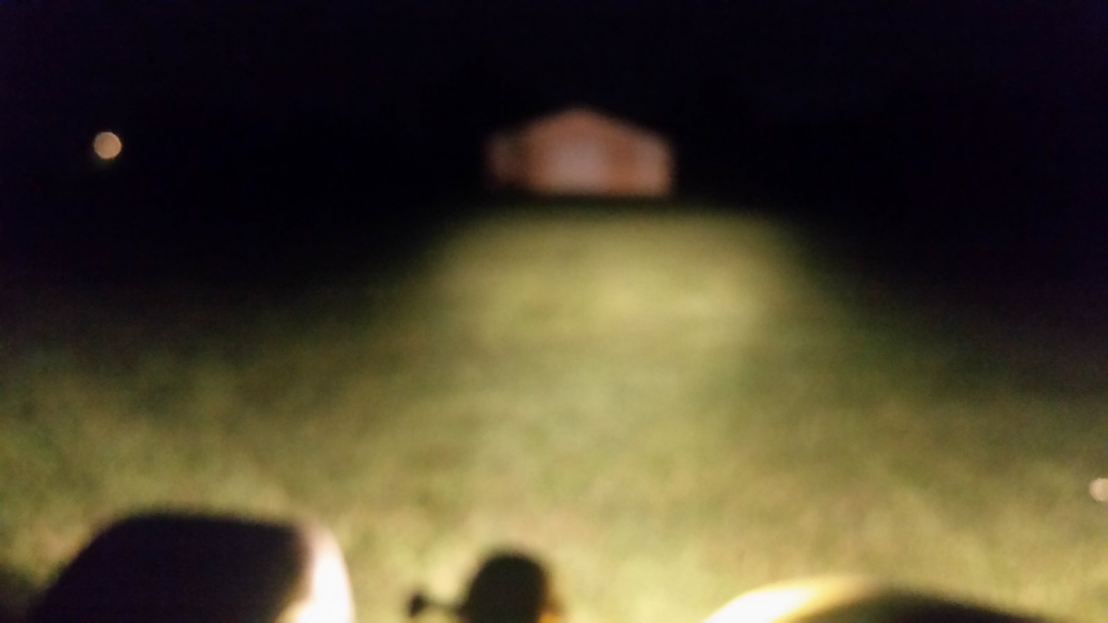

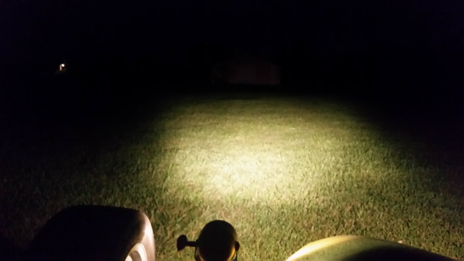

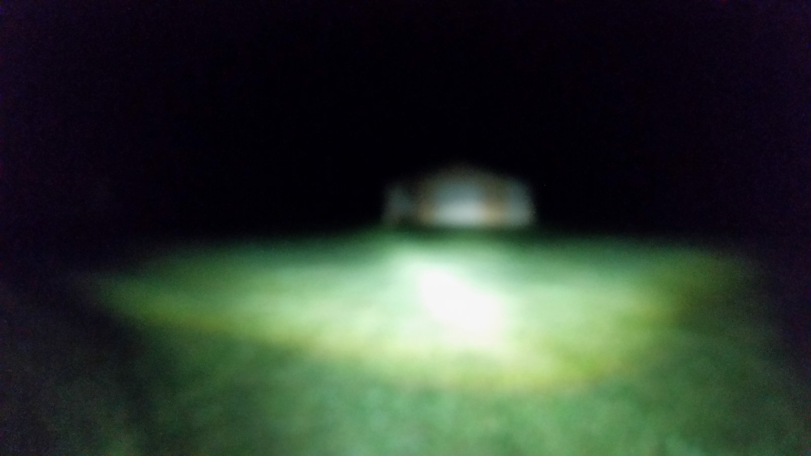

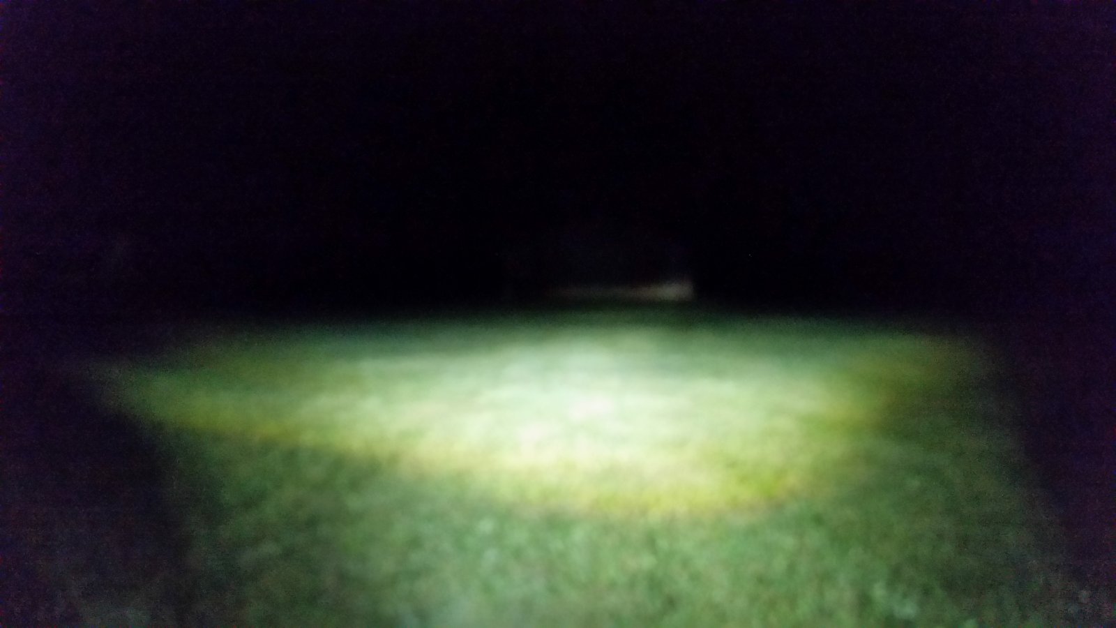

Here are pictures of the GF supplied lights with 35/60 bulbs and the JW Speaker led to compair. Need to adjust lights up a little bit.
