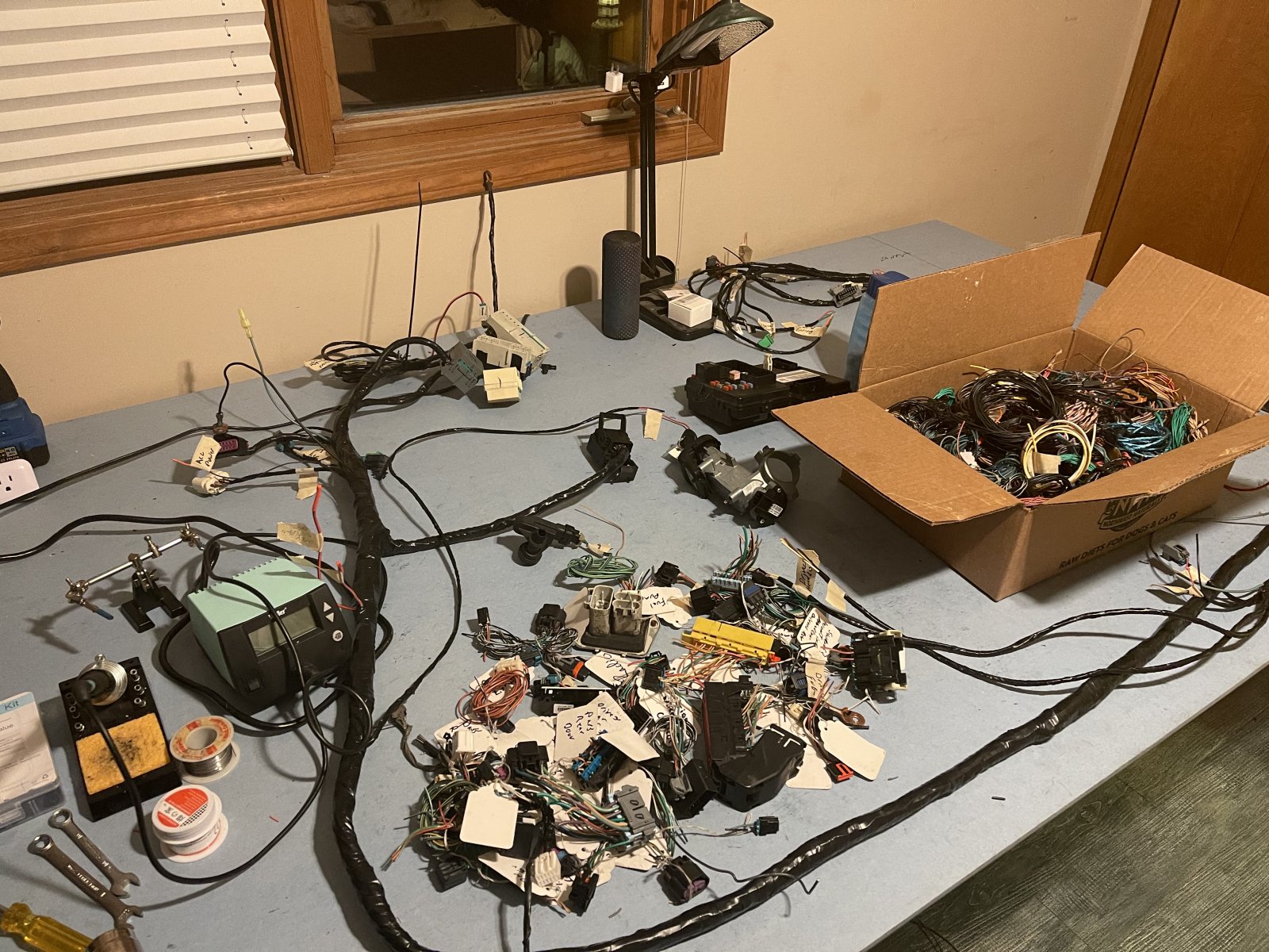

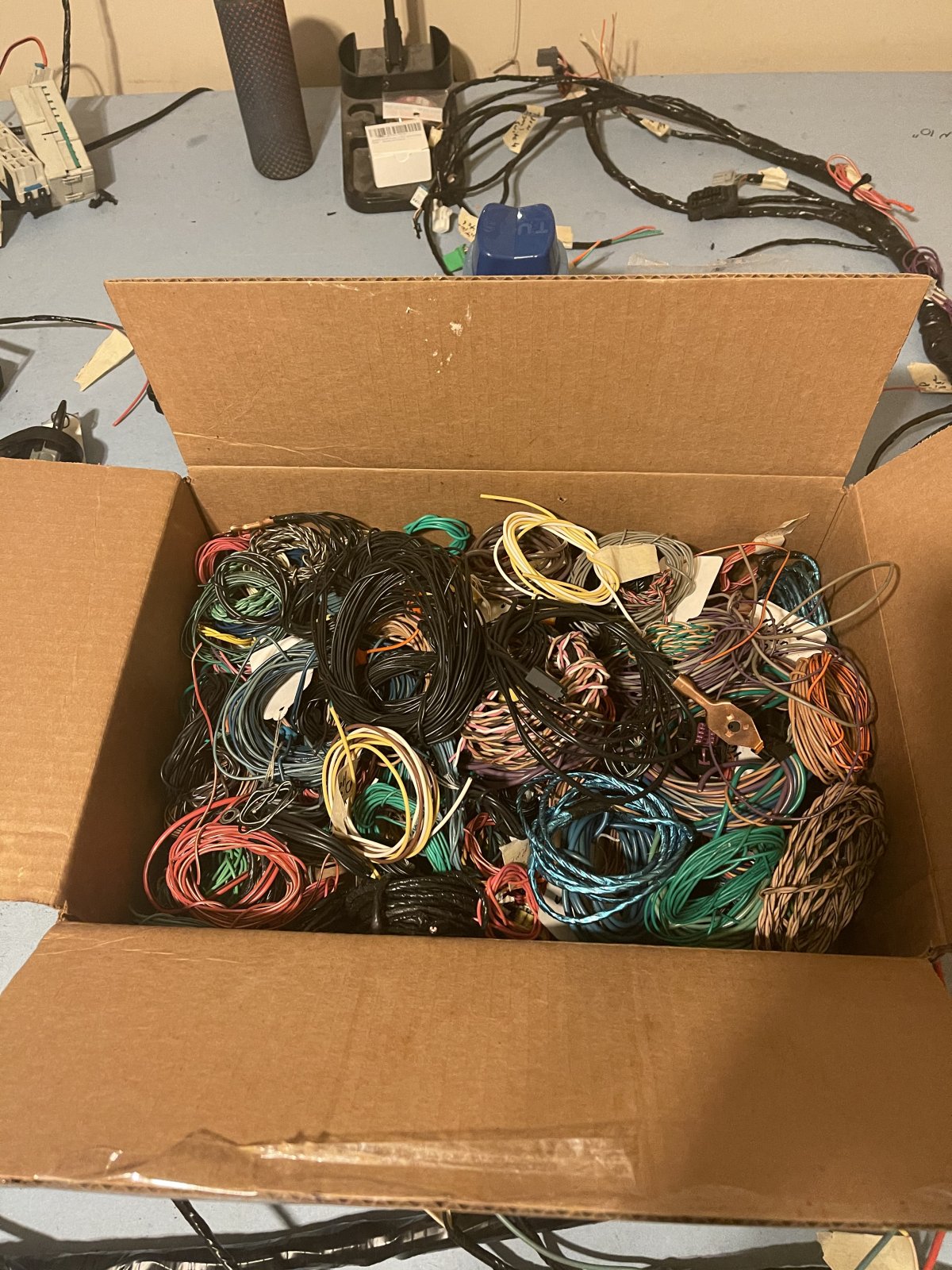

I wasn't that organized about it, what with the boxes and all, but one of my benches is just covered in rolls of wire that I took out of the harnesses.

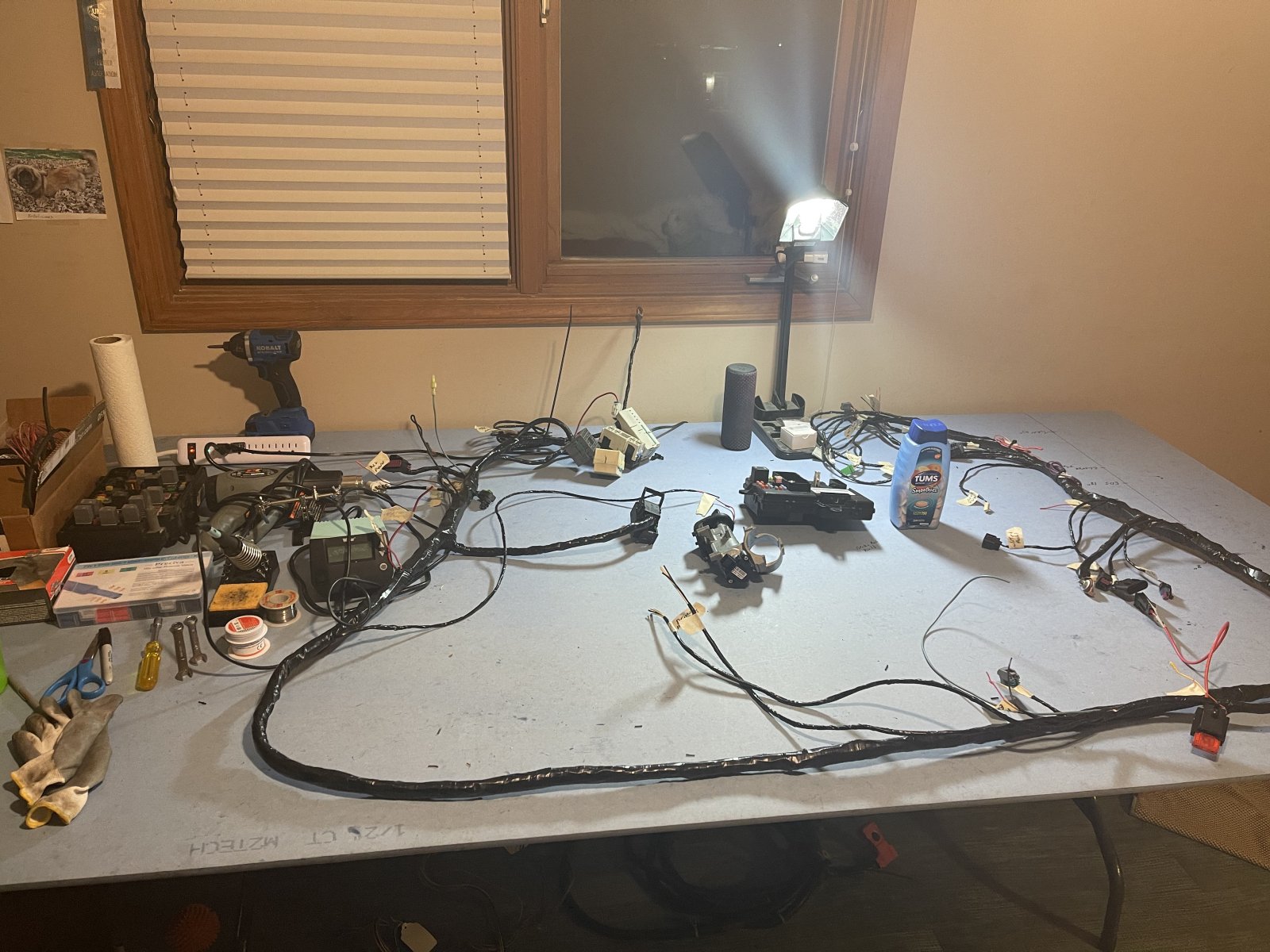

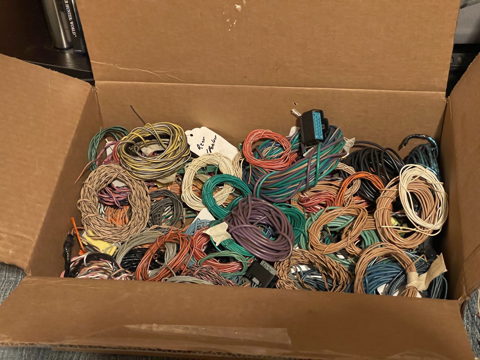

Well one week later. A box full of cut out wires, pile of connectors, trash can full of tape and wire loom, 6 rolls of new tape and 3 panic calls to Lonny (only to find out I didn’t cut out the wrong wire) my harness is finished.

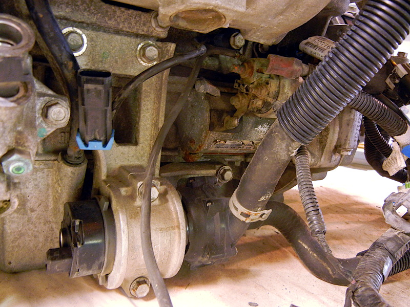

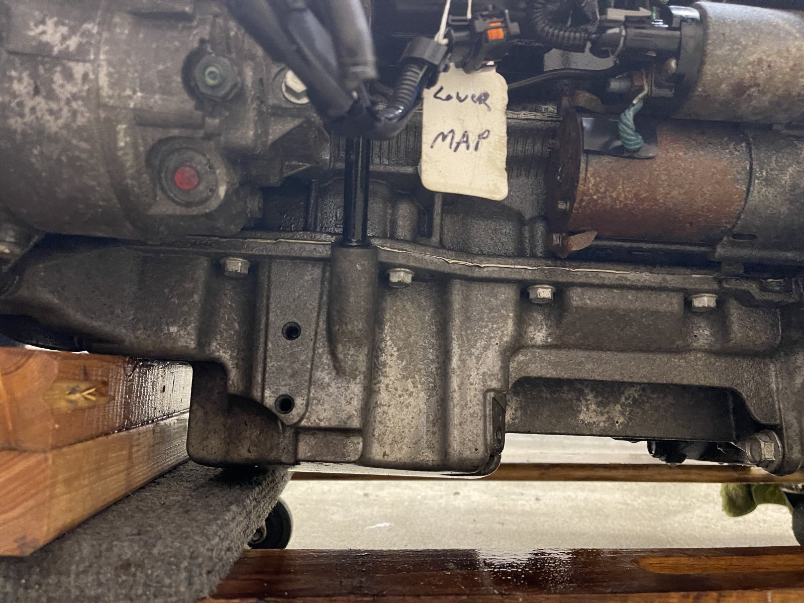

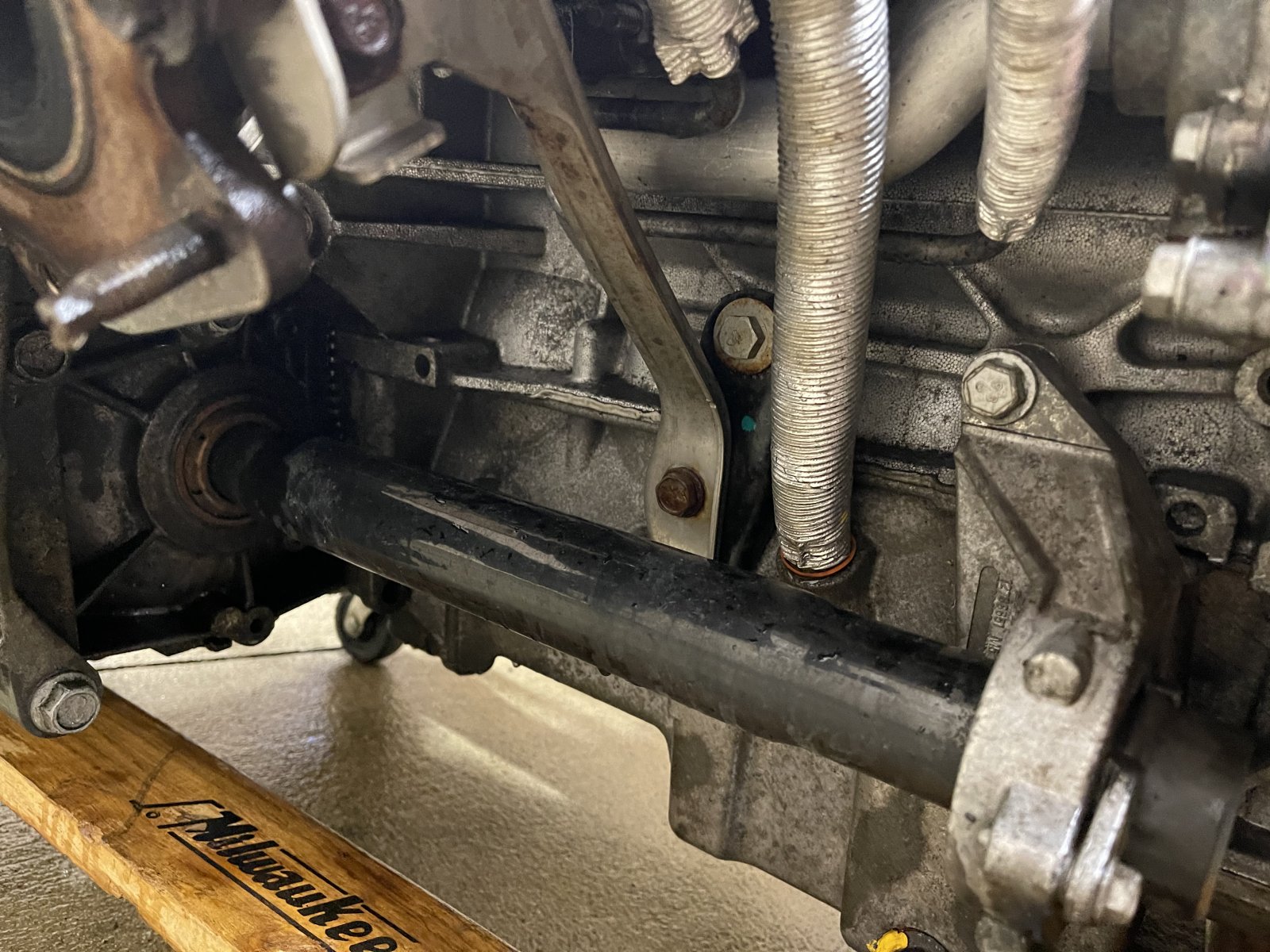

Correct me if I’m wrong. Shouldn’t there be a pumped mounted somewhere in one of these photos on the engine for the intercooler. Or is that something that comes from DF and I have to install it

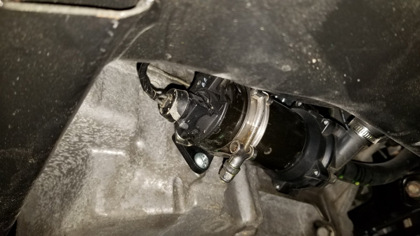

Well on the SS/SC, yes there is a Bosch pump mounted on the lower front by the starter. Does not come in the kit, should come on the car. Did your car not have one?
R
Donor is a 2009 SS/TC which does not come with the pump. When you ordered your kit, if the TC donor option was selected, then DF should supply the pump for the heat exchanger and the large clamp to mount it.
On the TC engine, if you're looking at it from the front, on the bottom left there are two threaded holes that align vertically from each other. The TC kit comes with a diamond-shaped plate, a small metal bracket, and a Bosch water pump. The diamond-shaped plate bolts to the engine via the two vertical holes, the metal bracket bolts to the plate via two horizontal holes, and the pump is secured to the bracket by a cylindrical clamp.
*edit* just noticed I dribbled some coolant down there. Guess I'll go clean that up now!
