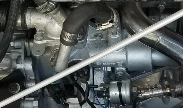

This seems like a trivial request, but I don't want a crimped hose... I have an 09 SS/TC and I see everyone with fancy non-crimped loop hoses and I don't think I saw one like that on my donor to be able to reuse.
What part number are you guys using for this? I'm seeing several options on Amazon but I 'd rather get something someone's already used and knows is big/long enough.
I searched but only found a hits for SS/SC guys and didn't wanna get the wrong part.
Thanks in advance!

Kenny123
I'm having the exact same issue. I have a 2008 TC and I truly don't have this hose anywhere. Any help would be huge.

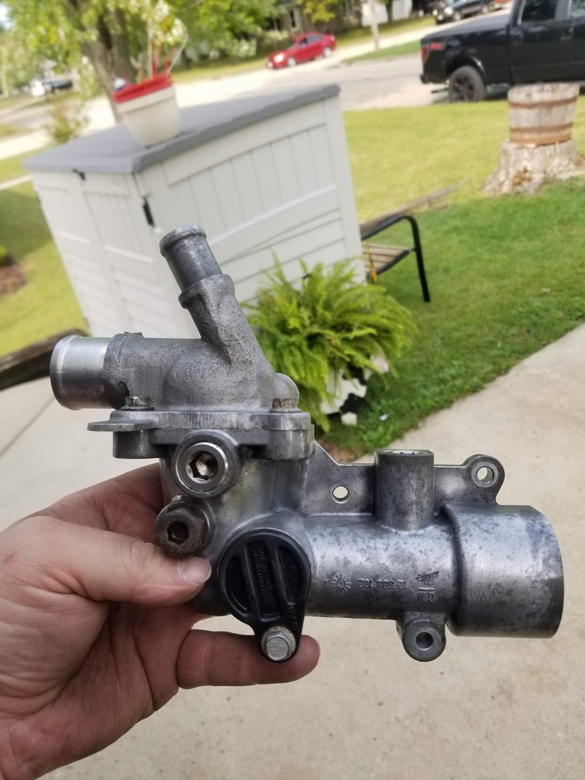

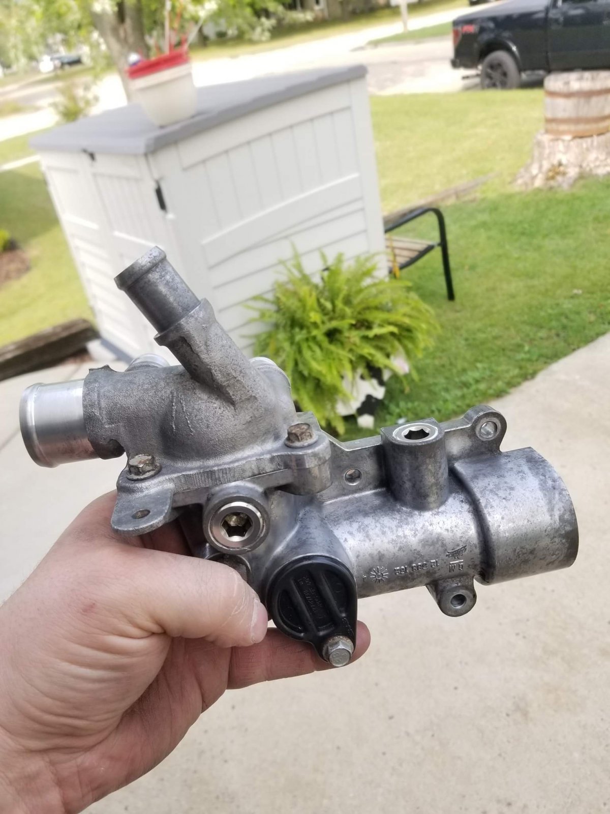

You guys have seen the thread about drilling out the wall inside and capping off the tubes right? That's what I did, cleaned it up very well.
Edit: my car is a ss/sc maybe it won't Carry over to the later cars?

P
I haven’t seen this post, mind sending a link?
Yeah my fault, the title actually says supercharged guys. So not sure if this would carry over for non supercharged guys or not. Took me a second to find it. Might be worth looking at, the part doesn't look that different from the OP photo.
