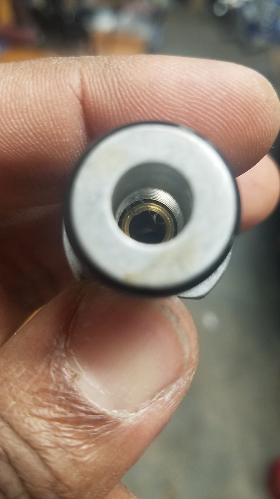

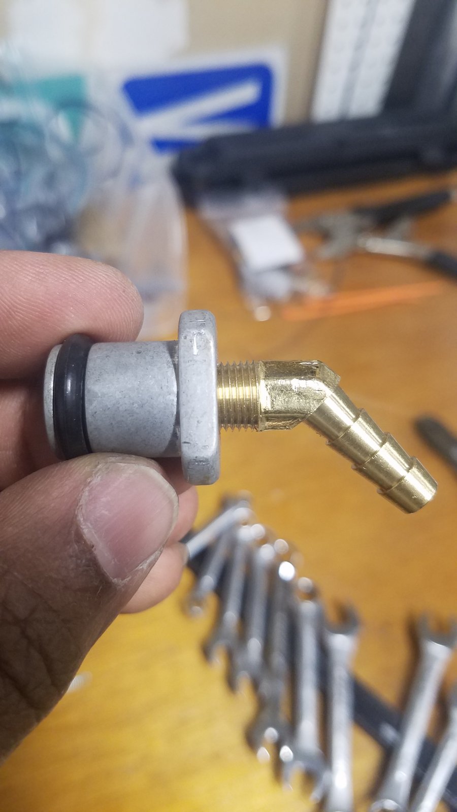

Tried to prep the brake reservoir relocation but fear i might have cross threaded the bracket and nipple... will have to double check if this is normal to have some shavings when threading this... I'm afraid iay jave uggah'd when i should have duggah'd
Do you have access to a tap & die set? Looking for an excuse to buy one?
It looks pretty straight, but even if it is cross threaded, put some thread sealant paste in, and it should seal up and work.
It seemed I had done the same also. Alot of us have gone with the AN lines later because of drips on the floor at the reservoir.Lines and fittings

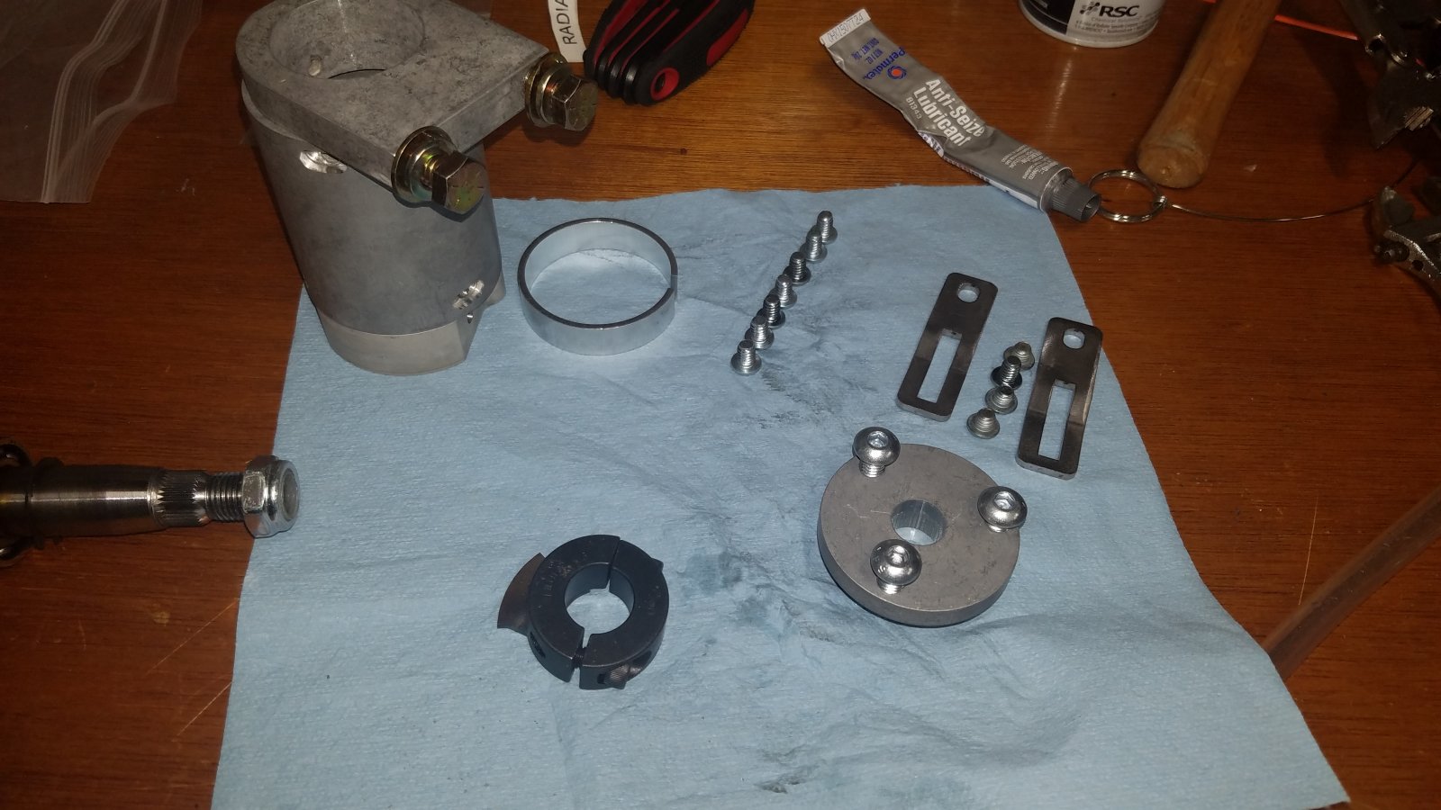

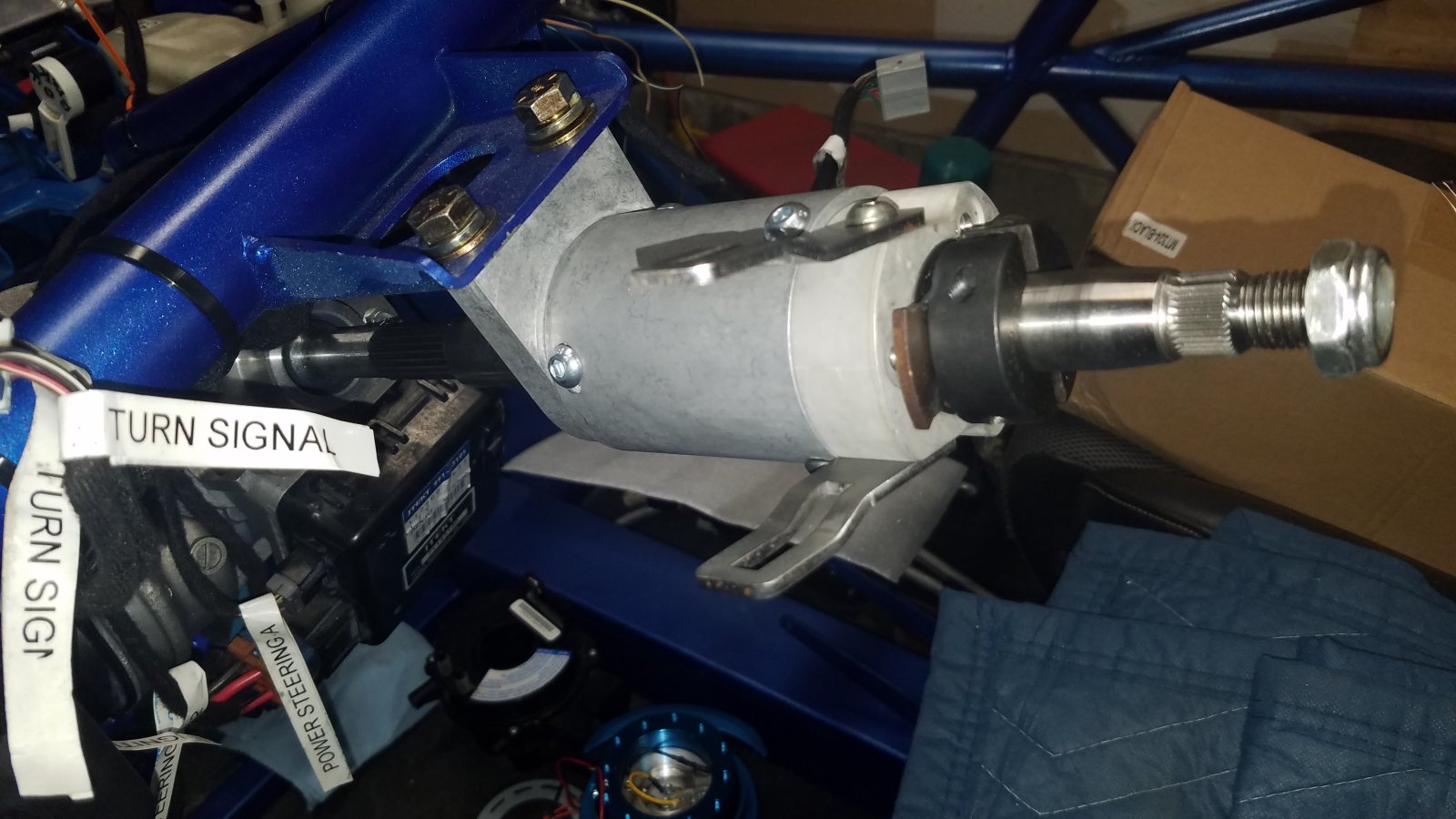

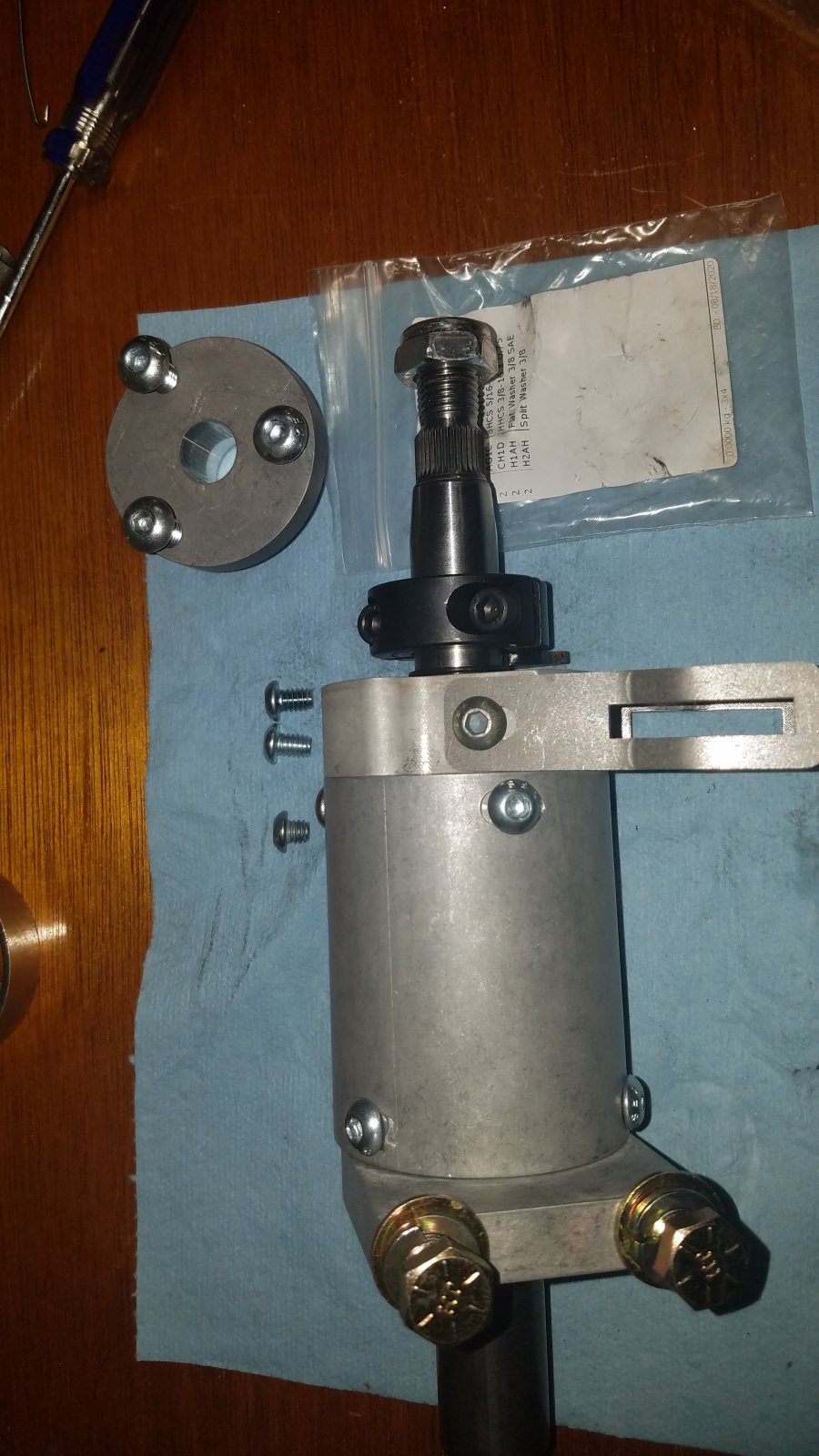

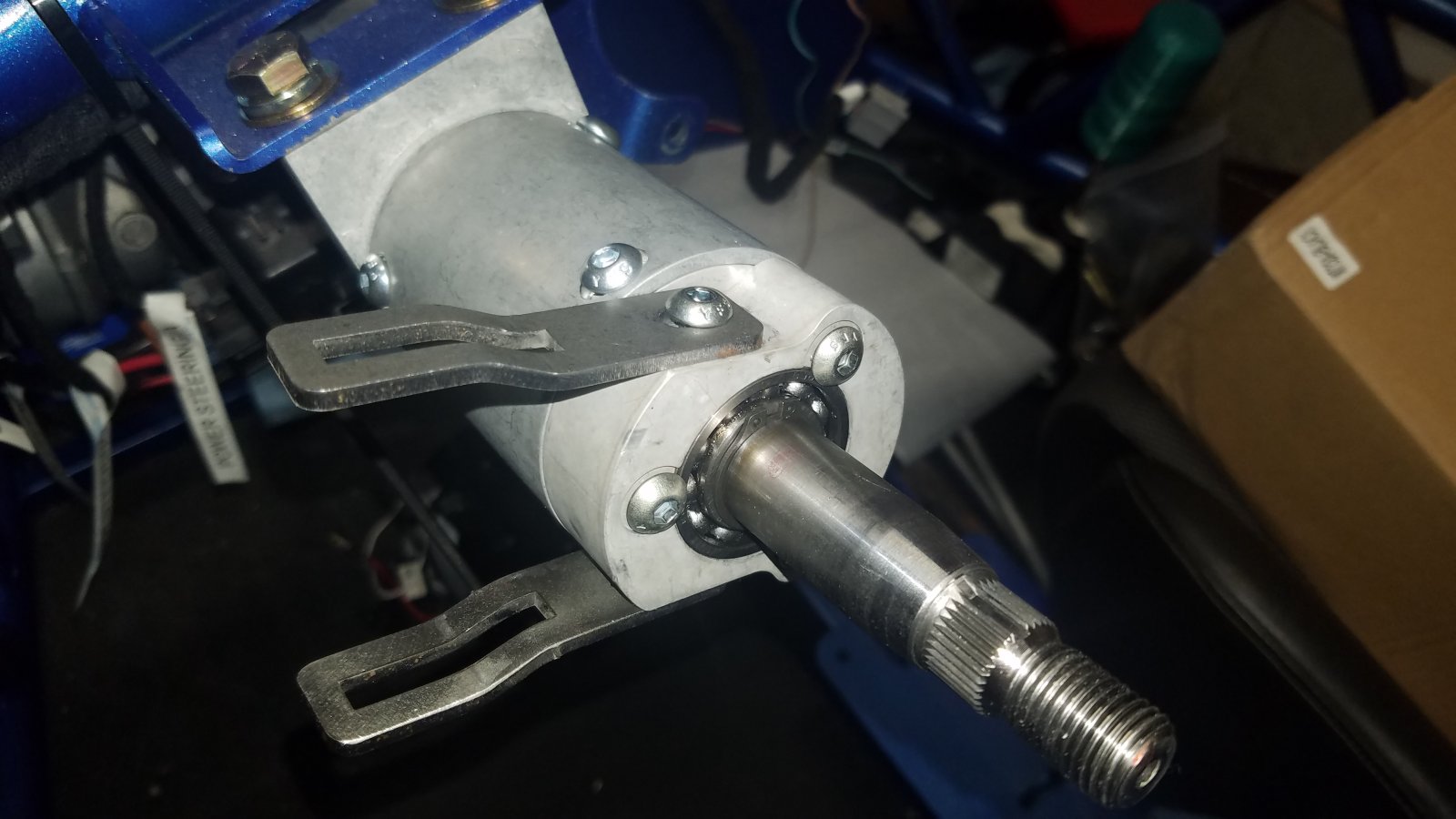

While trying to do a little here and there, I put together the steering column
19772
Am a little concerned that i had a few spare screws left over...
19774
In place on frame
19773
SwerveMonkey
... three of the really short screws/ /go into the face...
D'oh! ok... so i used two of the stubby screws to hold the turn signal... which in hindsight makes sense being that there were two of those left over
I'll swap those screws out
after that I'll have three stubby & three larger screws

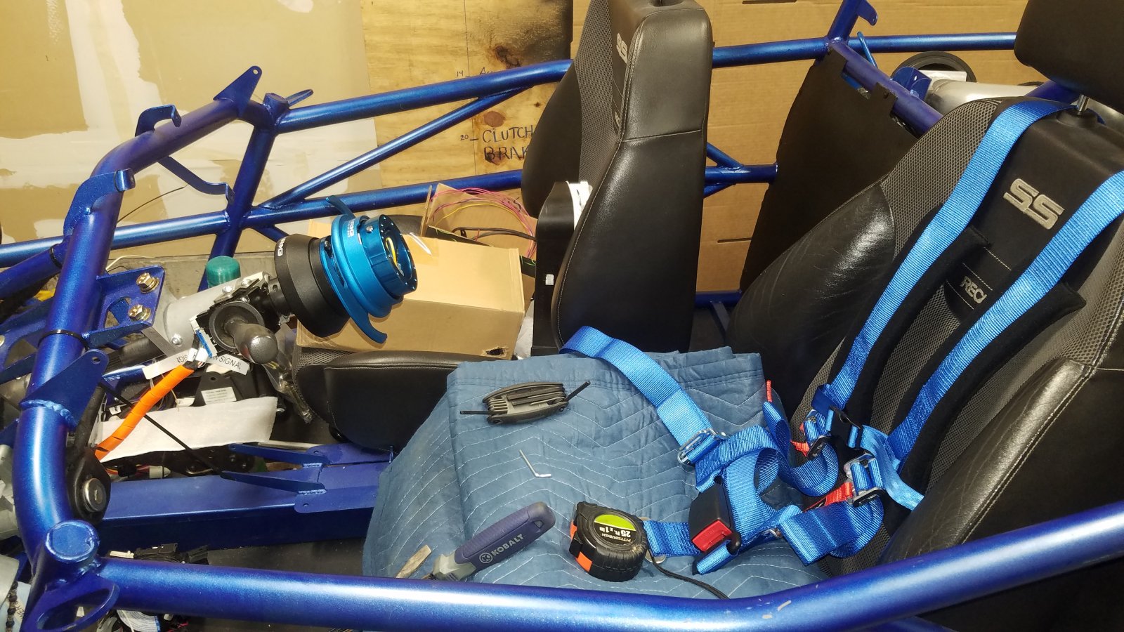

I've an NRG short hub and quick disconnect as well, so I don't think I need the wheel HUB... pics incoming
Edit:
Swapped the screws around and now is much better

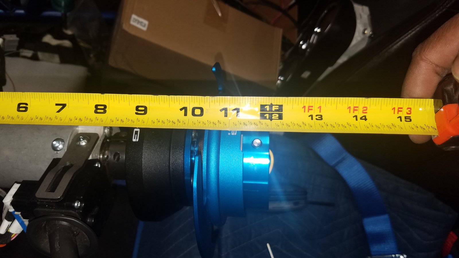

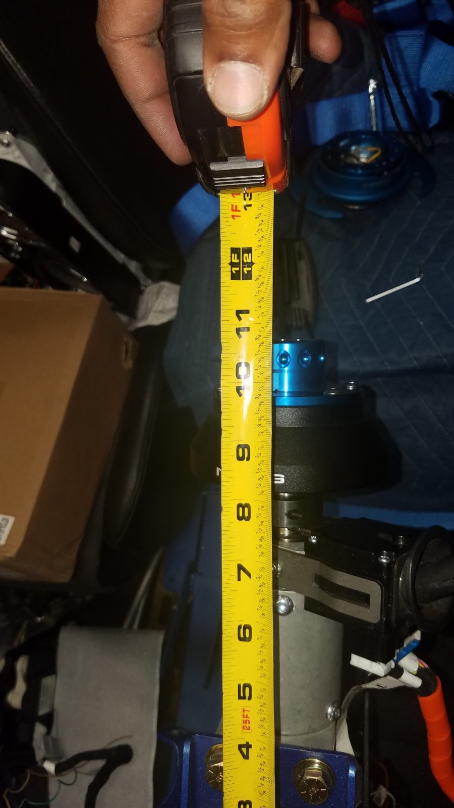

Put the short hub and quick disconnect on at the same time...
Edit for add pic
Goblin Graber
Looks good now. With the NRG quick release and one of their flat non dished wheels mine felt super close. Someone suggested to me that I cut the tube. I cut it down from 3” to 1” to compensate for the QR and it’s great. Keep that in mind if the wheel you get feels too close.
Fozda
That really all depends on where your seat ends up. I have an NRG quick release with a non dished wheel and it just happened to sit the perfect distance from me once I spaced the column down.

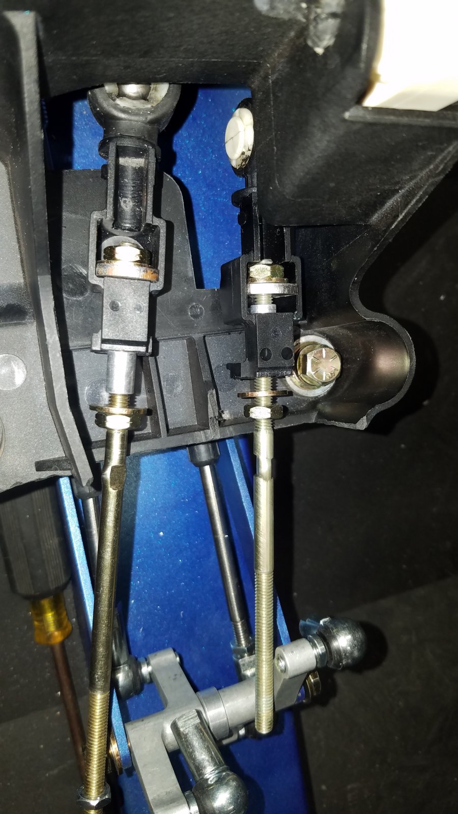

One day later... got the hardware in place as the video describes... but i still have two left over 1/4 washers that idk what to do with... the shifter assembly has six i xan account for... 2 for each shift armlink, 2 for the counter pivot in front... and I'm not sure
19952
where the last two go.
