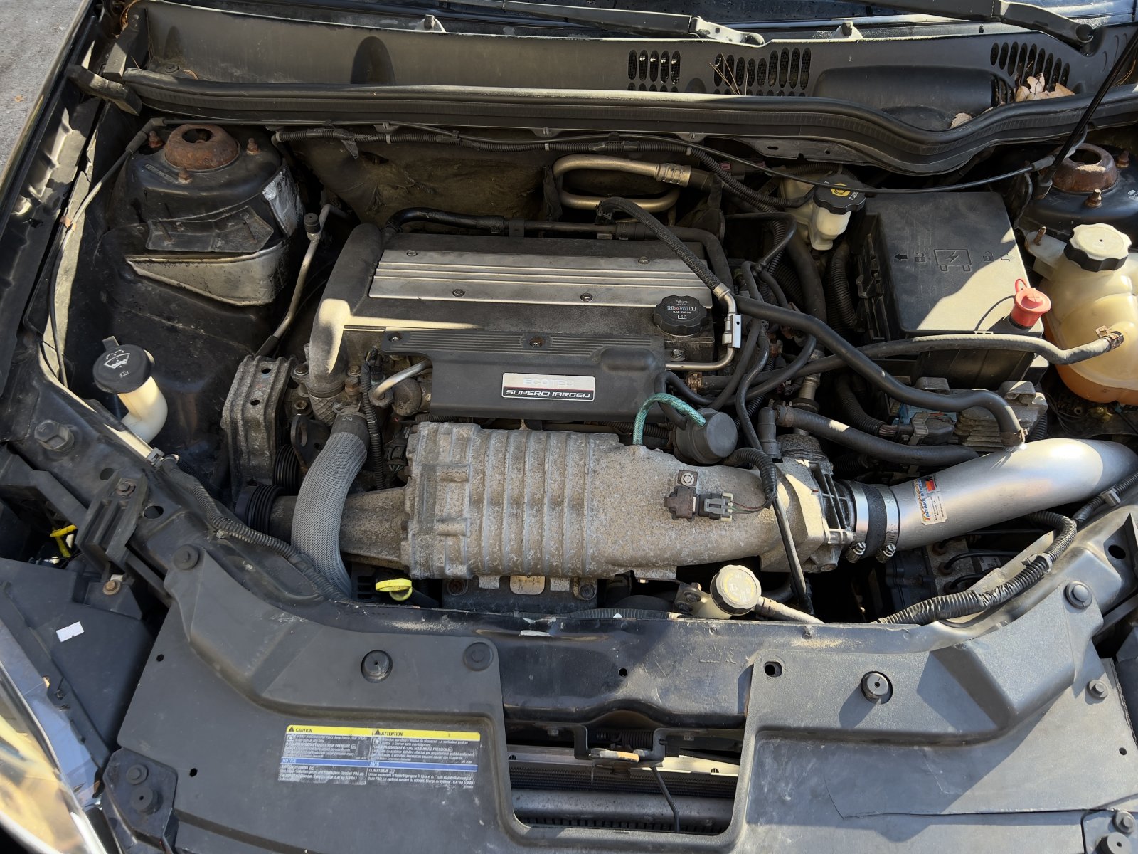

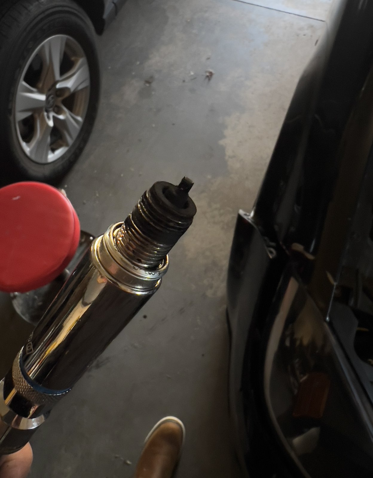

The only two engine issues I am having with the car are weird idle with the car occasionally dying as well as a stutter at high RPMs. This afternoon I removed the spark plugs and found the left (standing in front of the car) to be covered in oil or gas and the remaining 3 black as night. I previously planned to replace spark plugs tomorrow to see if that fixed the stutter but after pulling them I believe there are other issues. Research suggests various seals, O-rings, head gaskets or piston rings may be damaged and need replaced. My first thought was the begin tear down and move forward prior to having a “perfectly” running donor. I planned to disassemble the engine and replace gaskets, timing chain and inspect anyways.
Is this mindset/strategy flawed? I understand the recommendations of getting the bugs worked out before pulling the engine but some things are leading to work I’m doing anyways for the build.

Make certain you have your donor as operable as possible (for parts used in the Goblin) with as few issues as possible. It will make your first start and initial 'fixes' for any of those issues much easier.
While the engine is together, check compression, and do a leak down test. Could just be a valve. These engines are known for cam chain issues with the tensioner and guides. Spark plugs are a good place to start. The black spark plugs ... running rich I would guess. The oil covered one seems suspect... head gasket? Valve guide worn out? Bad injector?

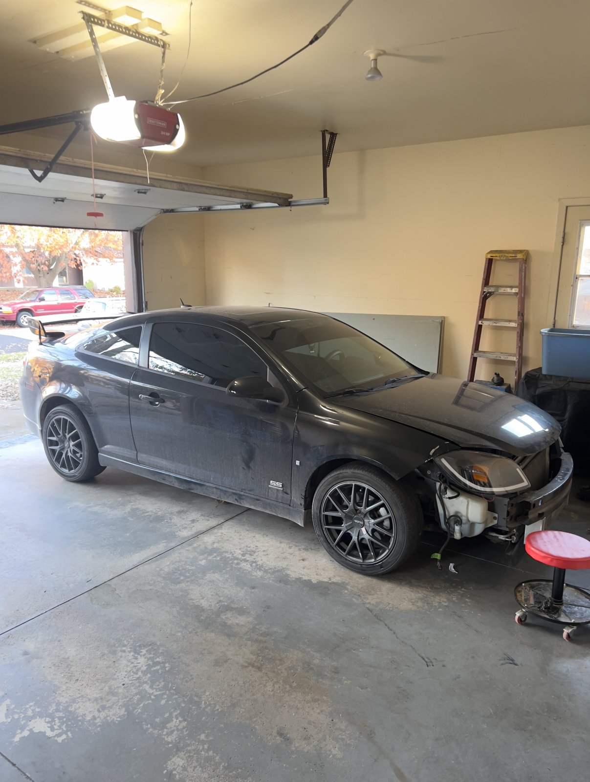

Got the front bumper removed and some miscellaneous junk.

Put a little oil in each of the cylinders and re-test. But usually leaking pressurized air from #1 into #2 shows head gasket is open between the two OR valves are open on both cylinders in that crank position.(or possibly burned/bent valves?)
It is possible to have the head gasket fail between two cylinders and NOT mix oil with coolant.
If the oil came down the plug from the valve cover all that spark plugs' threads and seal area would be wet/dirty; the seal area looks clean in your picture.
That build up on the plug looks like soot from running rich. You may have a clogged injector that will not close? If it has washed the oil out the rings too many times it can lead to cylinder and piston scoring/failure and even low compression on that cylinder. A diagnostic manual would have a simple test to prove a clogged injector.
