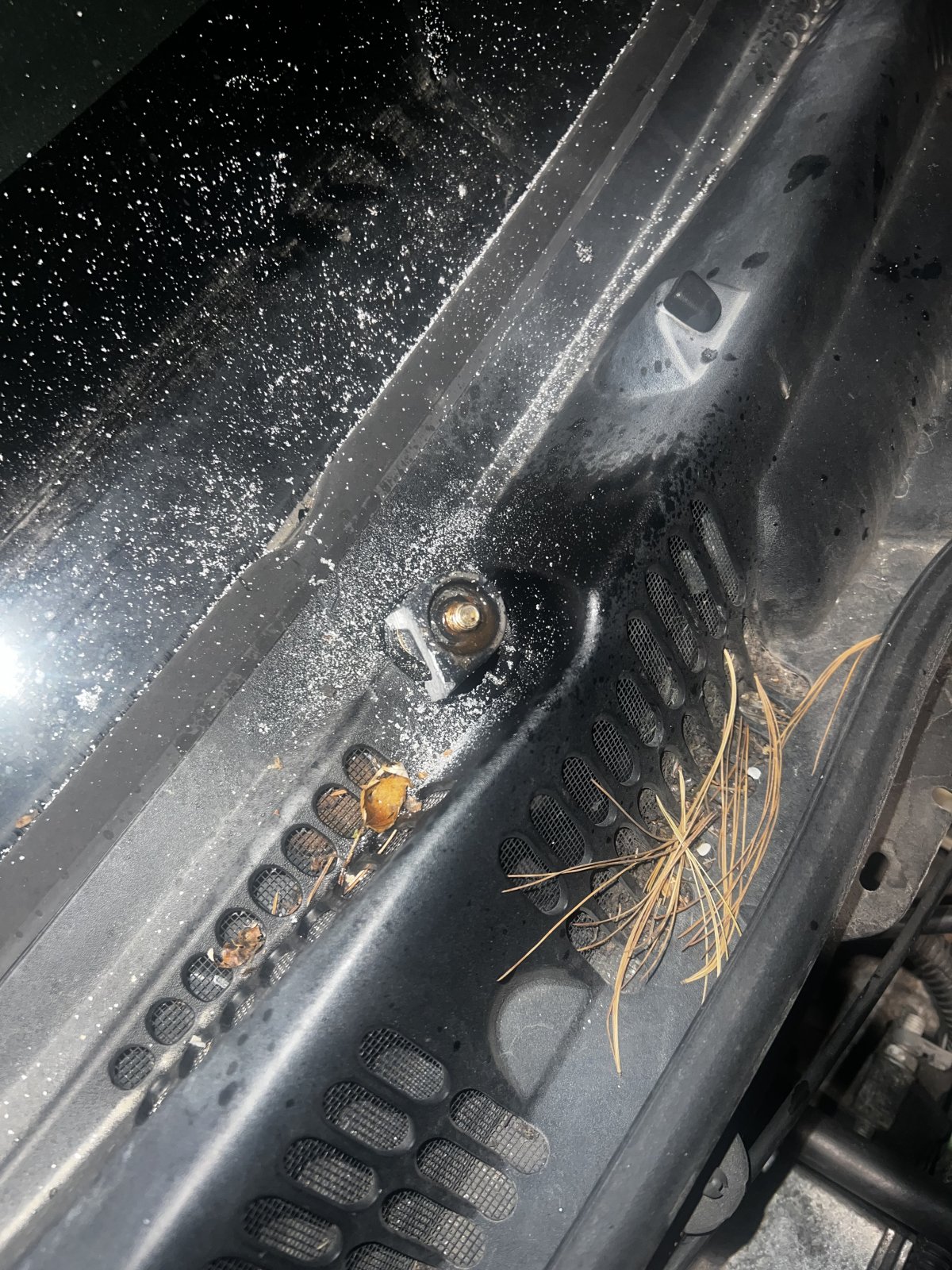

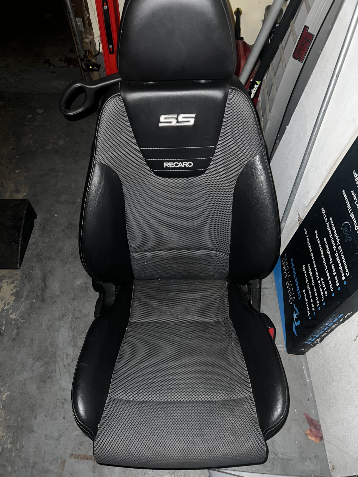

Moved forward with the project and got through video 2 of stripping the donor. Thank you for the engine advice. I learned something new so I can’t complain, can’t say that for those who helped but it is appreciative. With stripping so far I’ve had an interesting time with the door plugs. They’re different than the video and had to take the door off first. Had to chop the wipers off with a sawzall due to being rust welded on. I’m excited to get the seats cleaned up, they’re in pretty good shape and will save me some moolah.

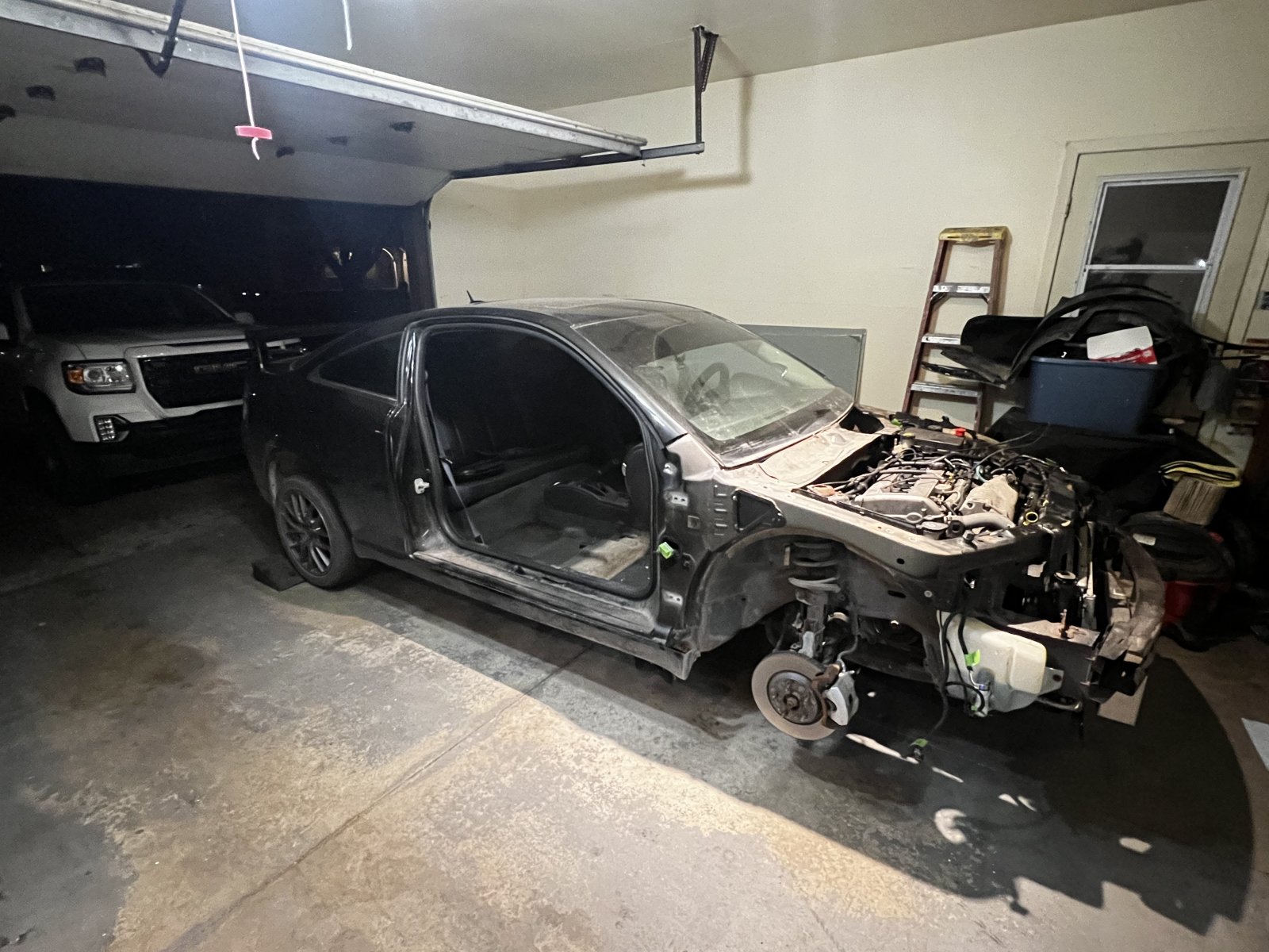

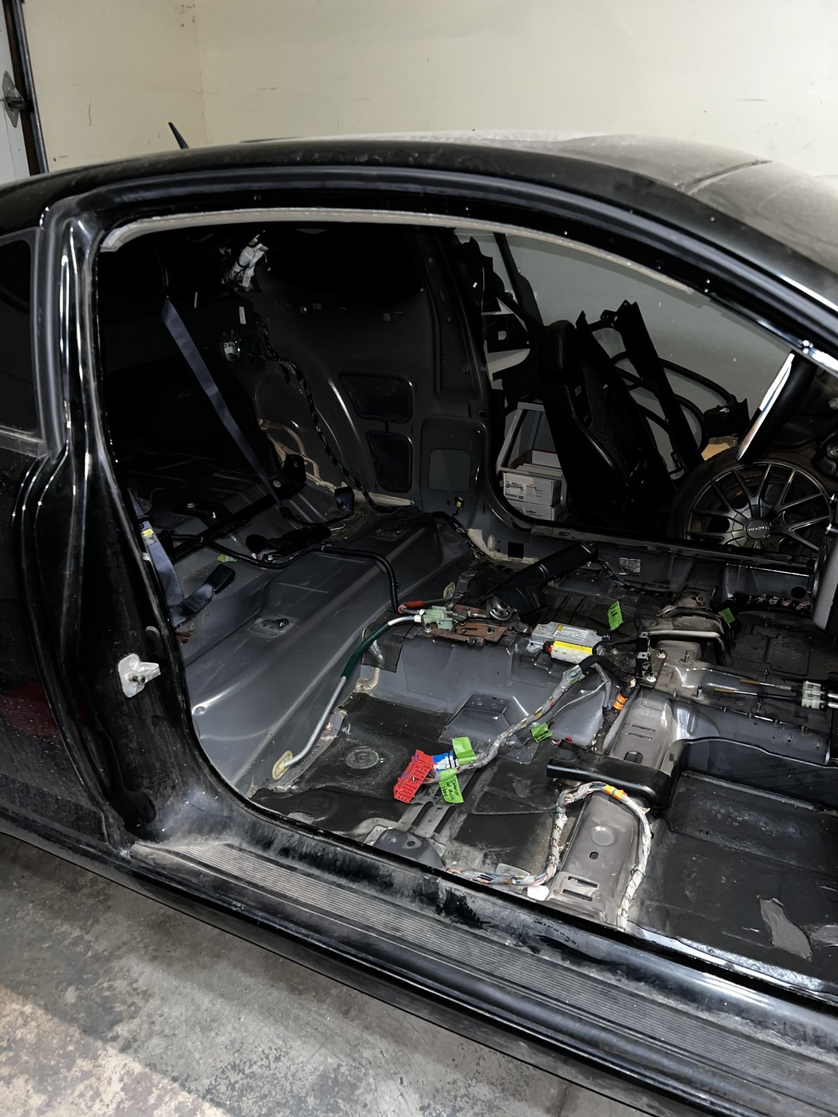

Jumped out of order due to not having the ability to pull the motor just yet.

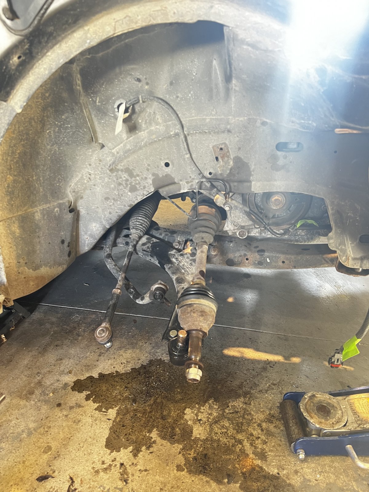

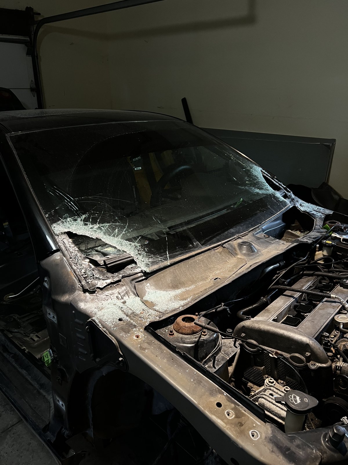

Got the inside stripped and ready to pull the dash as soon as the motor is out and I can easily get to the remaining connections. Had some fun with busting the corners of the windows after frustration set in with removing bolts. Also got the front suspension taken apart. Unfortunately couldn’t get the sway bar links to unbolt but after a quick google search and seeing the price the sawzall came in handy once again. I’ve been labeling things like crazy and already have loads of pictures. It takes up a bit of time but will be worth it in the end to have the documentation.
Planning to pull the motor on Sunday and get the dash pulled.
Moving right along! I laugh every time I walk in the garage due to never experiencing something like this. I’m not sure if I’m laughing because I’m excited or laughing because I think I’m crazy :D

Let me be the first to give the obligatory advice. Don’t forget the parking brake tubes
I made a note and put a tag on it to remind myself to take it out. I’d like to keep it as long as possible to keep the wheels locked while jacked up in my garage.
