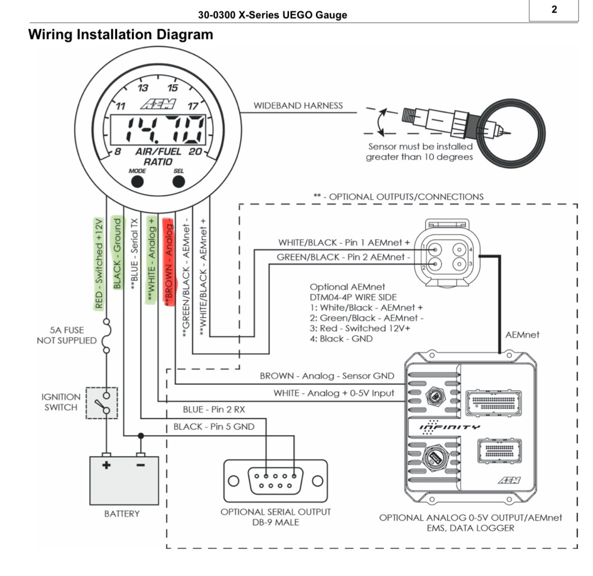

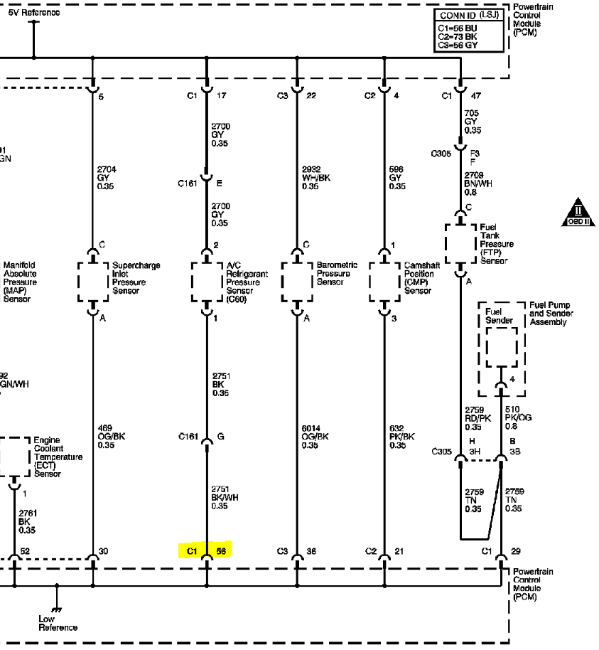

I picked up a wideband yesterday and am in the process of getting it wired, this is very foreign to me and trying to read through the diagram and understand everything.
I have switched power for the red wire, a ground for the black wire, and a wire from the AC Pressure Sensor to the white wire to monitor AFR in HP Tuners.
Do I need to worry about the brown analog negative or is this only needed if I have a separate data logger as shown in the diagram? If it is needed, can this be coupled with the gauge ground? I just don’t want to button everything up and have it not work correctly.

Brown should be tied into the ground supplied by the ECM for the AC sensor if there is one. This is sometimes called by GM "low reference" or "low ref". If there isn't one labeled for that sensor, I would tie it to another ECM sensor ground since there is probably only one sensor ground buss in the ECM.

Would any ground to the frame work? I have extras in the front under the hood but can tie it into the ground lug under the fuse box if needed. The main fuse box ground is in the rear.
Ideally it'd go to the black/white wire on C1/56 at the PCM, but it'll work without it. Don't ask me how I know.
But if you ask me how I know anyway, I'd tell you some idiot cut the black/white wire out of their engine harness. I've also tuned several other cars that were set up without reference grounds, mostly out of necessity/lack of availability, and not found it to be an issue yet. I do like to do a sanity check on WBO2 and factory narrowbands to ensure they correlate, so I'm reasonably confident I'm not missing a statistically significant amount of accuracy on the reading.

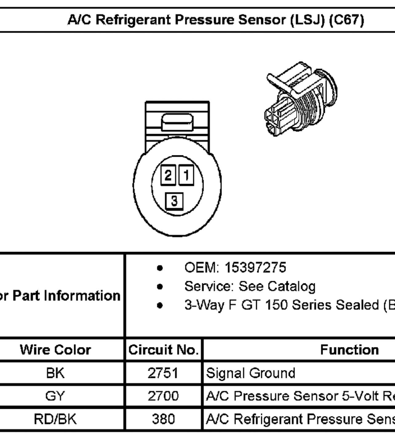

It seems the one you have highlighted is the signal ground shown in the connector view. I still have that wire and will tie it in there!

One of the pro tuners on HPT forum recommends videoing the gauge readout and HPT screen readings at the same time and confirming they match to account for any voltage shift.

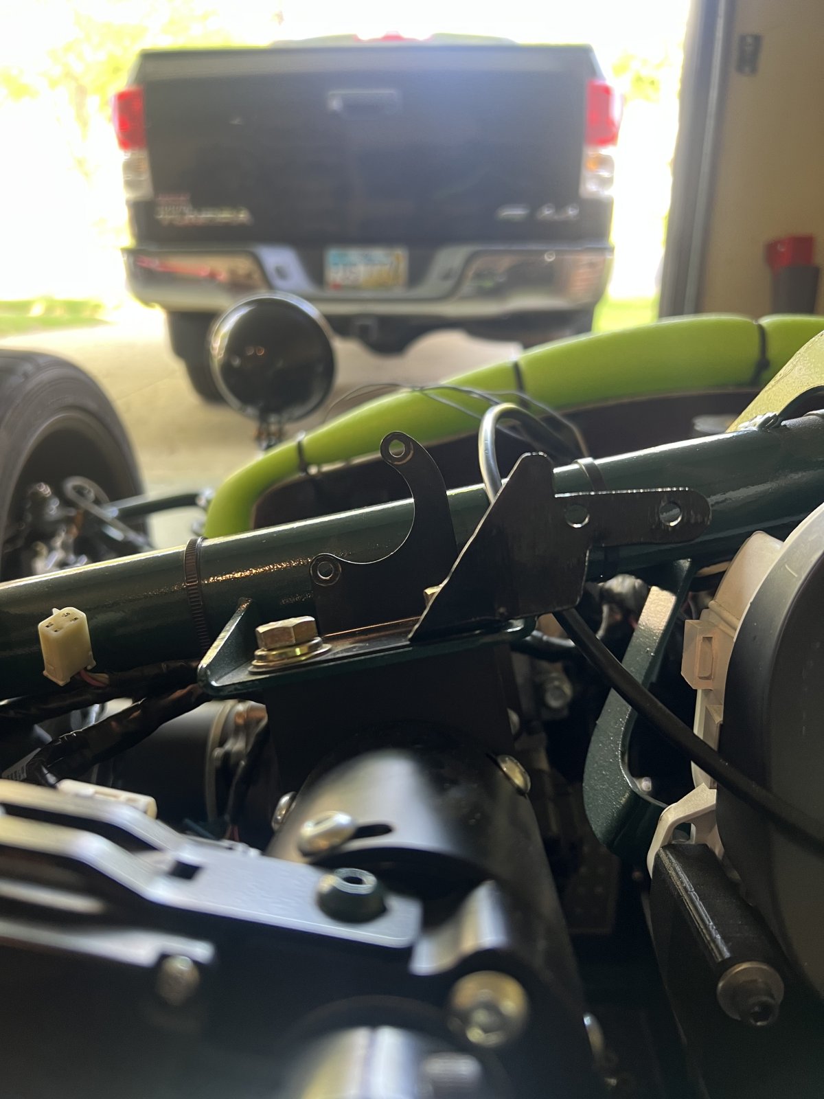

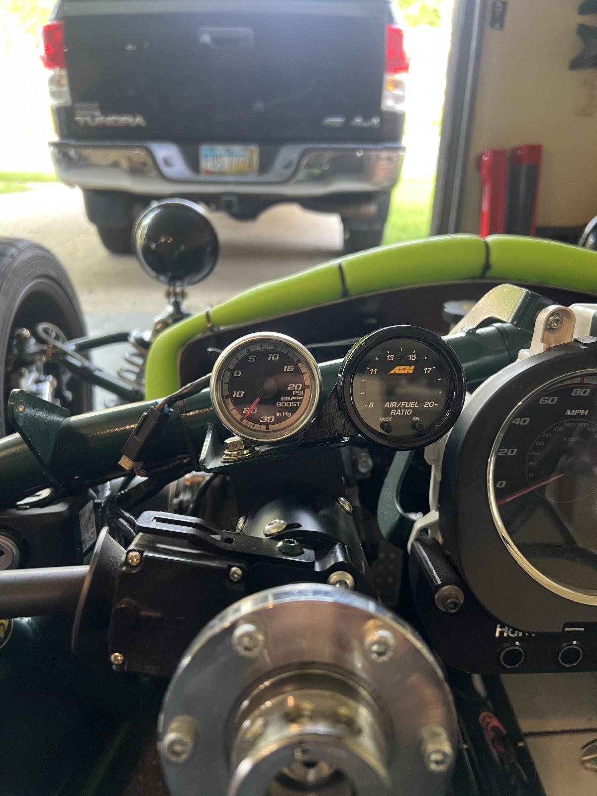

Wideband is mounted, was able to make a small bracket out of some sheet metal sitting around the garage. Working with 13 year old tin snips, it’s not the best looking thing, but it holds the mount and is pretty darn solid.
51976
51977

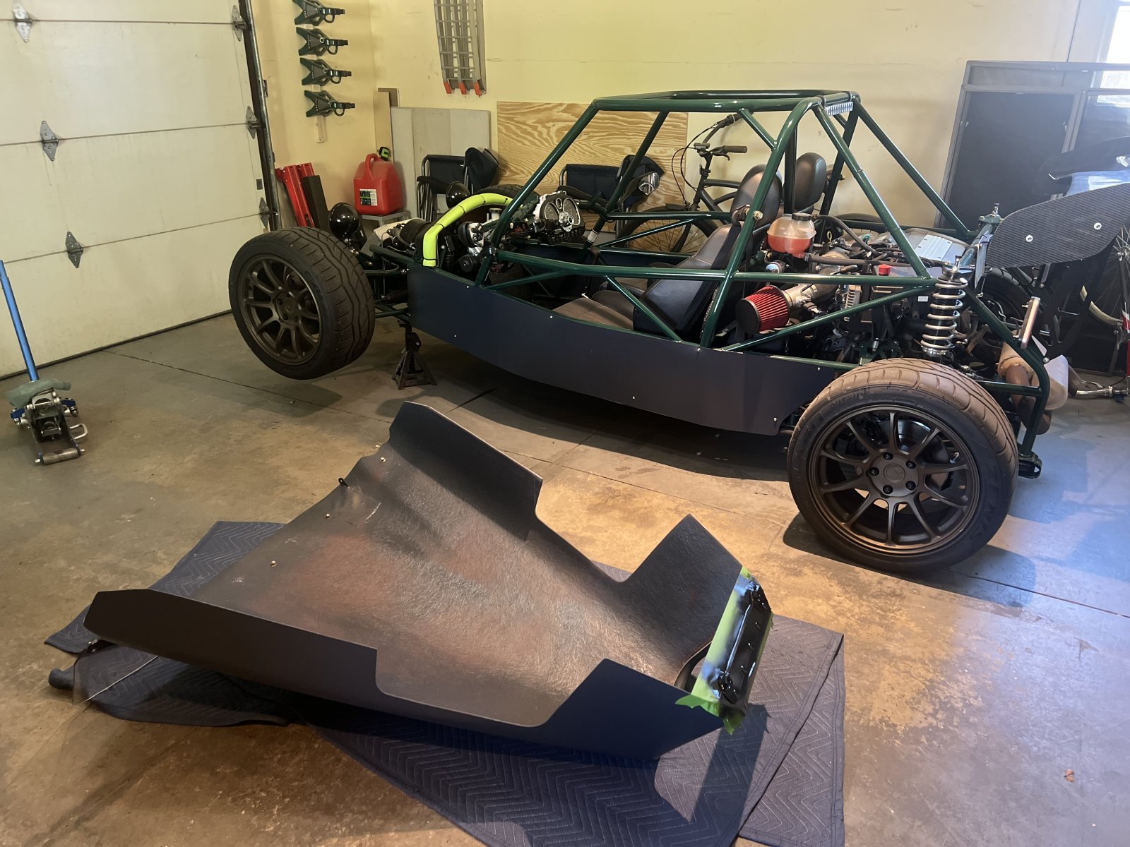

I have all wires extended from the rear AC Pressure sensor and o2 sensor. Just need to finish connecting all wires in the tunnel. VERY glad I used rivnuts since I had to remove the front and back tunnel covers to fish the wire through.
Also took the time to touch up some road rash I got from a helluva hump in the road. Took the paint right off the mount on the hood and the cross member for the radiator mount. I’m thankful nothing broke and it was just cosmetic.

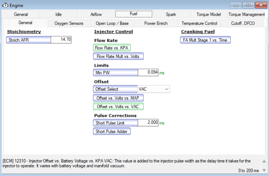

Flow Rate and Offset (Engine>Fuel>General)
52062

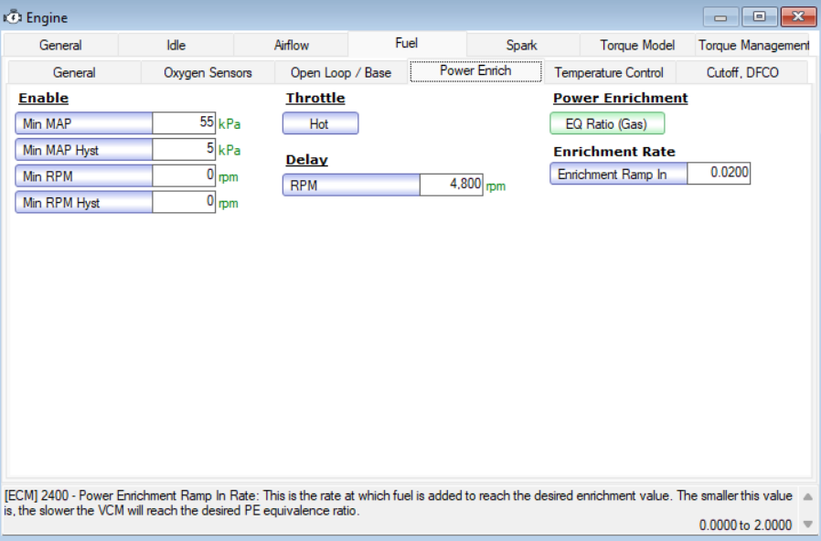

EQ Gas Ration (Engine>Fuel>Power Enrich)
52063

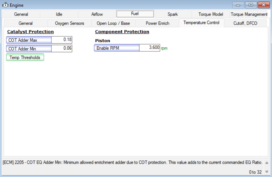

Temp Thresholds (Engine>Fuel>Temperature Control)
52064

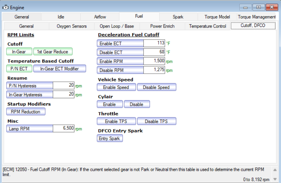

Cutoff and Temp Based Cutoff (Engine>Fuel>Cutoff,DFCO)
52065

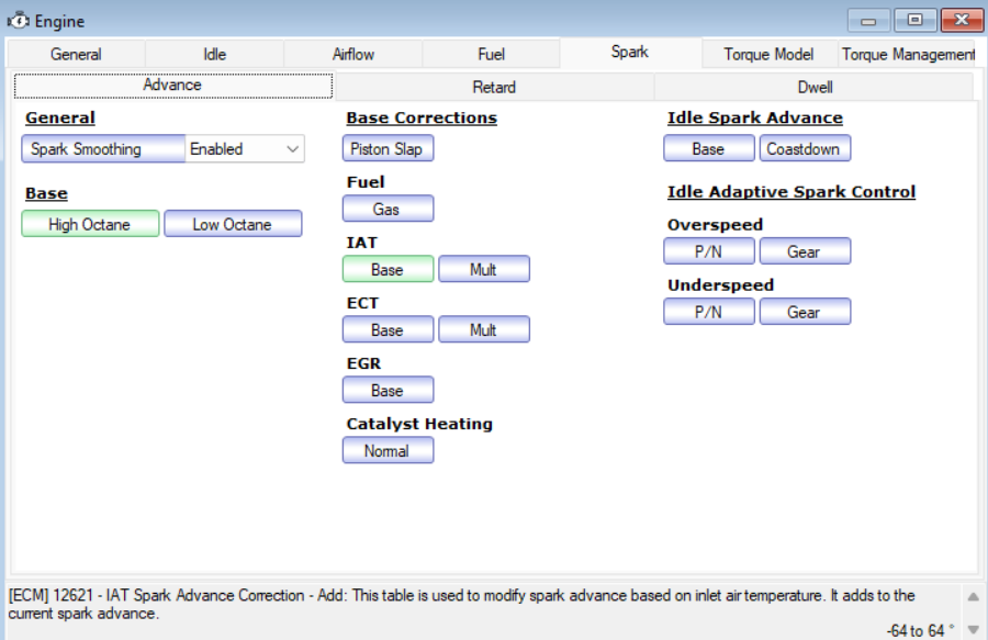

Base High Octane and IAT Base (Engine>Spark>Advance)
52066
