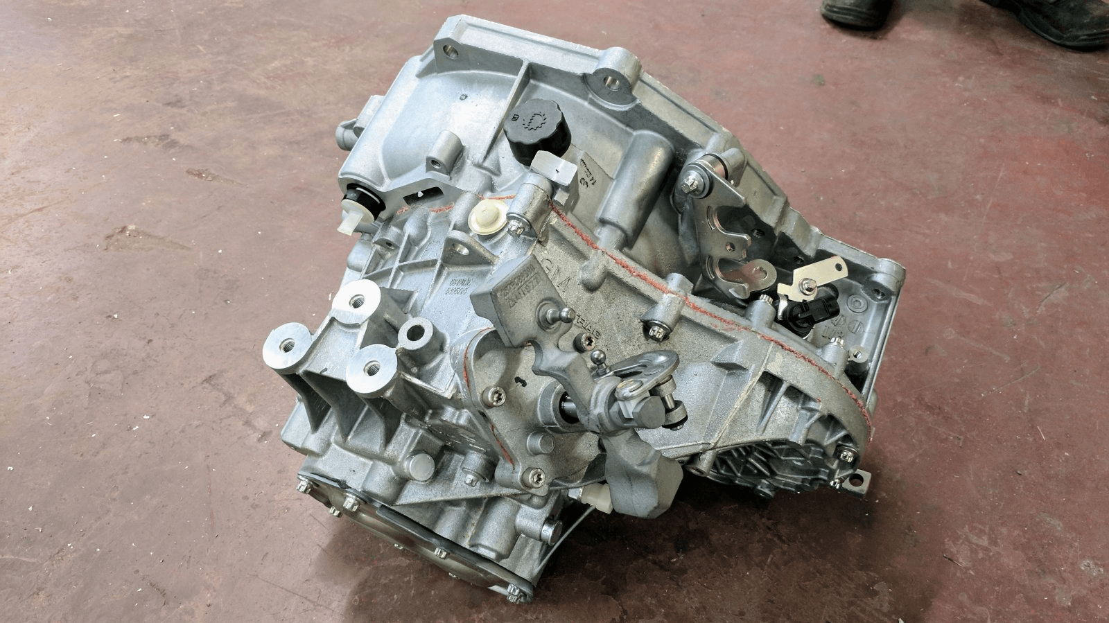

F35 Transmission
Things to look for:
  • Transmission mount bolt holes sit on different planes; one bolt hole is lower than the others. Note: The F35 normally uses an aluminum adapter bracket that bolts to the transmission and includes the three top bolt holes. If you are missing that bracket, we offer a replacement that works in the Goblin: F35 Mount Adapter
  • Shifter arms have one counterweight.
  • End cover is a 3D cast shape rather than a flat plate.
Chevrolet Cobalt F35 transmission showing uneven mount bolt heights, a single counterweight on the shifter arm, and a 3D cast end cover.
F35 transmission: mount bolt holes on different planes, one counterweight, and a 3D cast end cover.
