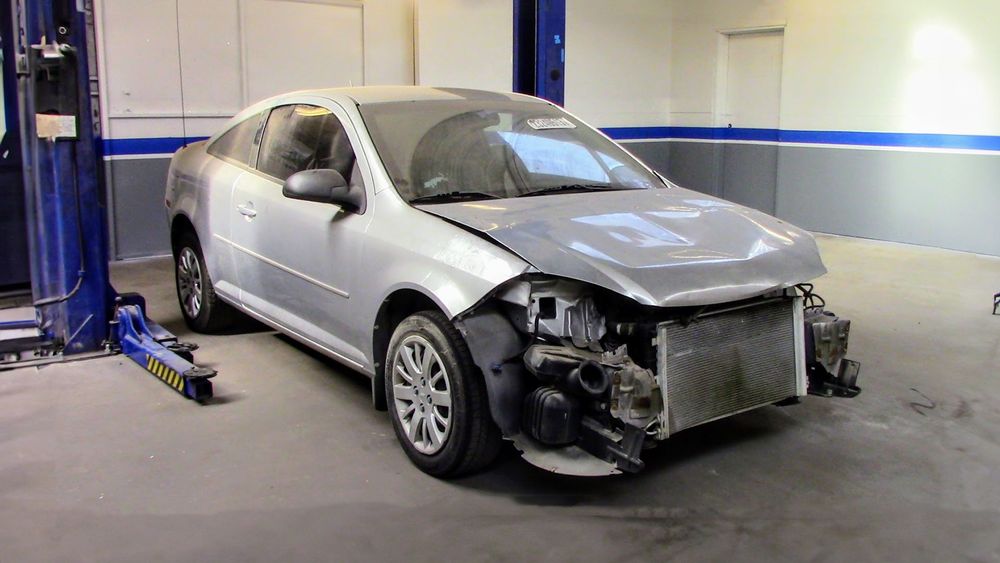

Chevrolet Cobalt donor car in a shop bay with front bumper removed
BUY A DONOR
Single Donor Build
The Goblin V1 is a single-donor kit. You obtain one Chevrolet Cobalt or Pontiac G5 and reuse the powertrain, wiring, pedal box, cluster, and hubs in the Goblin chassis.
Base donors are inexpensive and common, and even stock power feels quick thanks to the Goblin’s low weight. SS donors add serious performance and respond well to tuning.
Finding a donor is straightforward. Search local classifieds or online salvage auctions. Many builders offset cost by reselling leftover body parts and interior pieces.

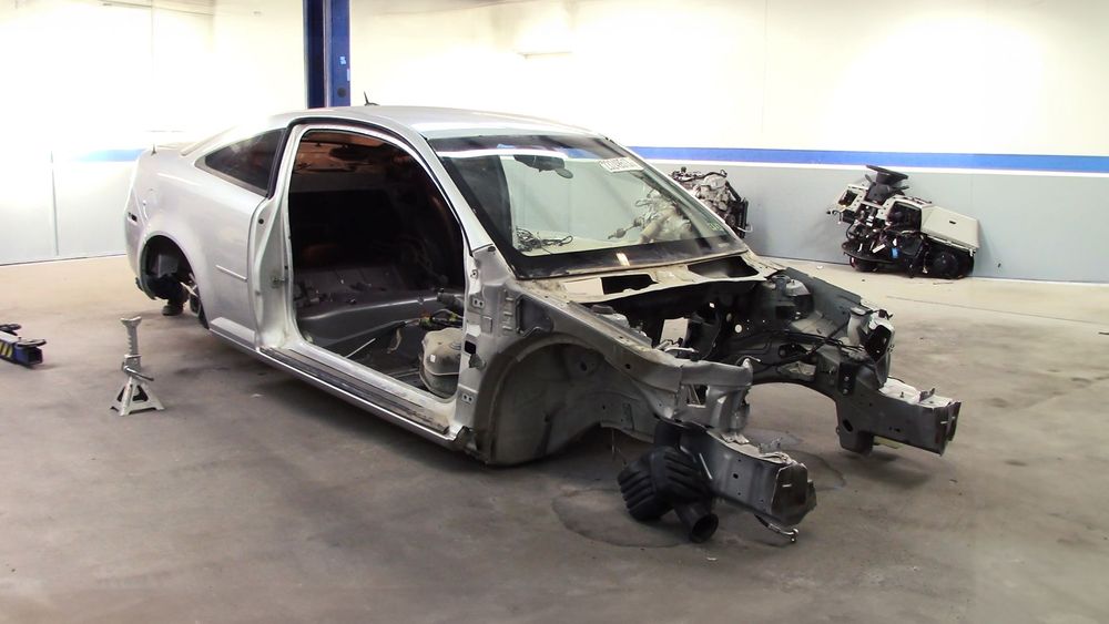

Fully stripped Cobalt donor on jack stands with donor parts removed
STRIP THE DONOR
Strip The Donor
Remove the engine, transaxle, front subframe, and front suspension as a unit, then pull the wiring, ECU, pedal box, cluster, and hubs. Our videos show each step.
Many builders finish donor teardown over one or two weekends using common hand tools and a rented hoist or engine crane.
When finished, sell leftover parts and recycle the shell to recover costs.

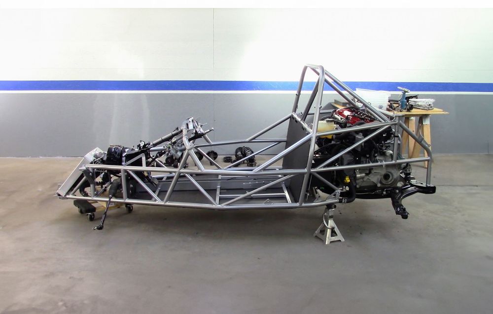

Goblin V1 chassis with engine, transmission, and subframe installed on stands
ASSEMBLE STAGE 1
Stage 1: Get The Motor Running
Stage 1 installs the donor powertrain and core systems to get the engine running for the first time.
  • Mount engine, transaxle, and subframe into the Goblin chassis
  • Install the fuel tank and plumbing
  • Route wiring and connect control modules
Once fuel and wiring are connected, you are ready for first startup.

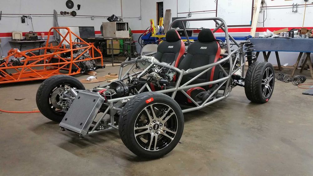

Rolling Goblin V1 chassis with suspension, steering, and brakes installed
ASSEMBLE STAGE 2
Stage 2: Get The Car Rolling
Stage 2 adds suspension, steering, and brakes so the Goblin sits on its wheels.
  • Install front control arms and coilovers
  • Use donor rear struts, install rotors and calipers
  • Install the steering column, tires and wheels
The car can move under its own power now, but wait to drive it on the street until Stage 3 is complete.

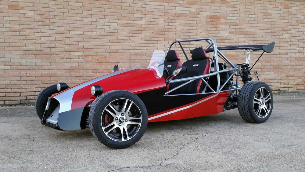

Finished DF Goblin V1 with red and silver body panels parked by a brick wall
ASSEMBLE STAGE 3
Stage 3: Finish The Car
Choose parts based on your goals. Street builds typically add body panels, lighting, mirrors, and comfort items. Track or autocross builds might skip the lights and focus on performance upgrades.
  • Fit hood and side panels, install headlights and taillights
  • Add mirrors, windscreen, and interior touches as desired
  • Final torque checks and shakedown
