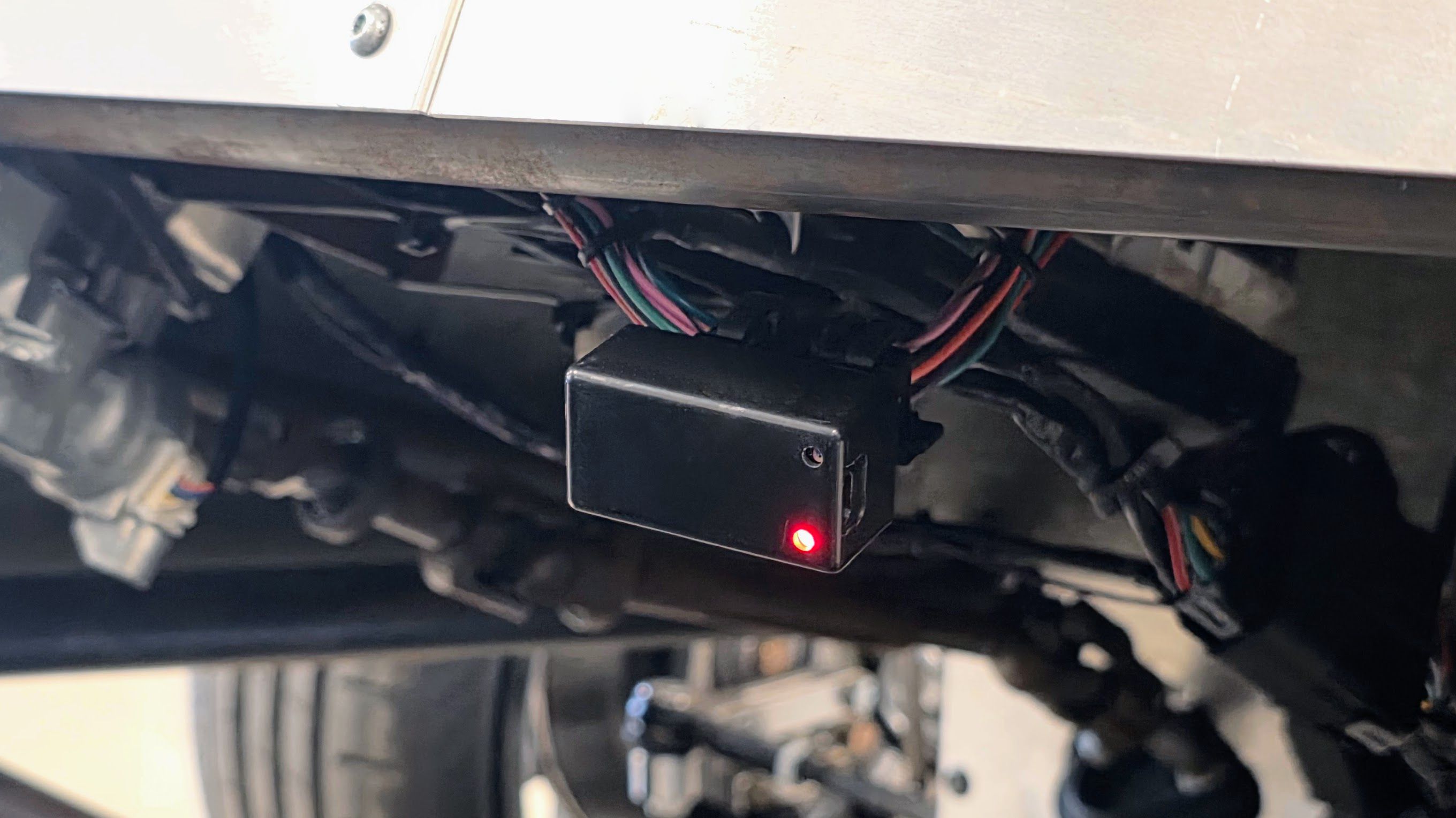

Macchina A0 Bluetooth OBD-II dongle plugged into the OBD-II port of a donor Mk7 GTI system, with the red status LED illuminated during the IMMO delete flash.
The Macchina A0 dongle handling both the ECU and TCU IMMO delete through the OBD-II port. No laptop, no bench rig.
Before today, doing the delete meant connecting a computer to the OBD-II port to flash the ECU, then making a powered connection directly to the DSG to flash the TCU. Two different setups, two different procedures, and some expensive hardware.
Today we ran both flashes through a Macchina A0 Bluetooth dongle and an Android phone. That's it. No laptop. No advanced hardware. Plug the dongle into the OBD-II port and do the rest with an Android phone.
