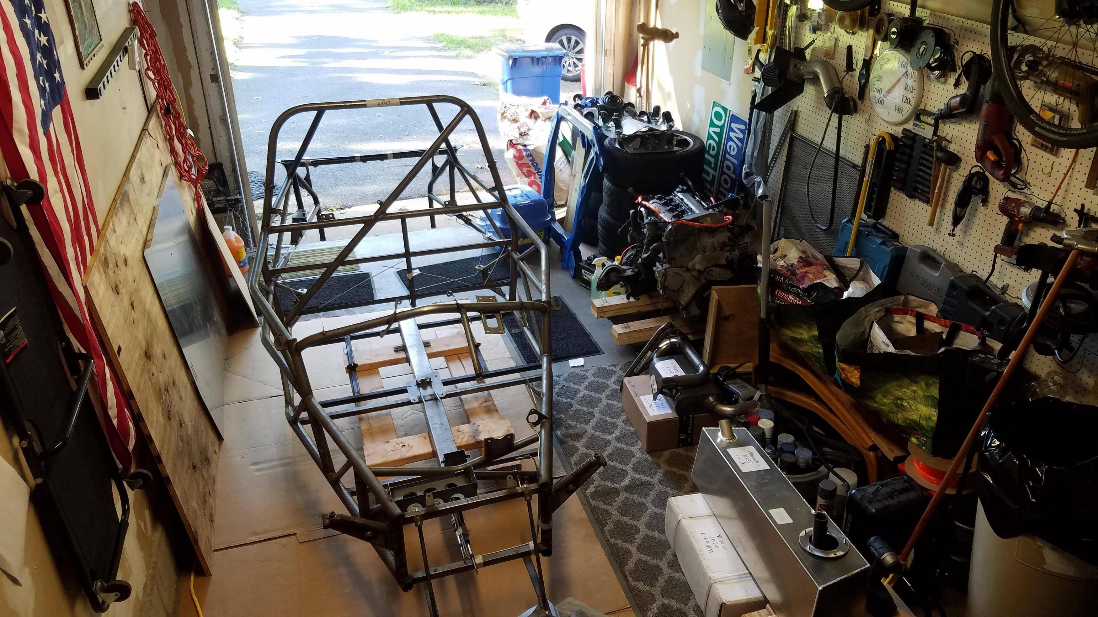

Started building it in my one car garage in Mastic Beach, NY. Just enough room to open one side of the donor
- Will J, Goblin #197 "Featured Build"
Goblin chassis #197 sitting in Will’s single car garage ready to be assembled.
Will says building Goblin #197 in a single car garage was tight but it worked.

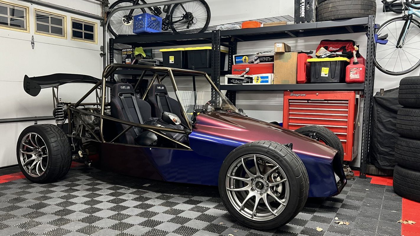

Think up, not just out. In a small garage, every inch matters, including going vertical. Install shelving or wall organizers to get parts and tools off the floor. Getting items up off the floor also makes it substantially easier to keep your workspace tidy. When you are working in a small area, keeping the floor clear will make the build easier and safer.
Nothing more satisfying than Spring cleaning, new shelves in the garage makes it easy.
- Ghostknife, Goblin #383, "Ghostknife's #383 Track SS/SC"
Finished Goblin #383 parked inside a garage with parts and tools stored neatly on vertical shelving.

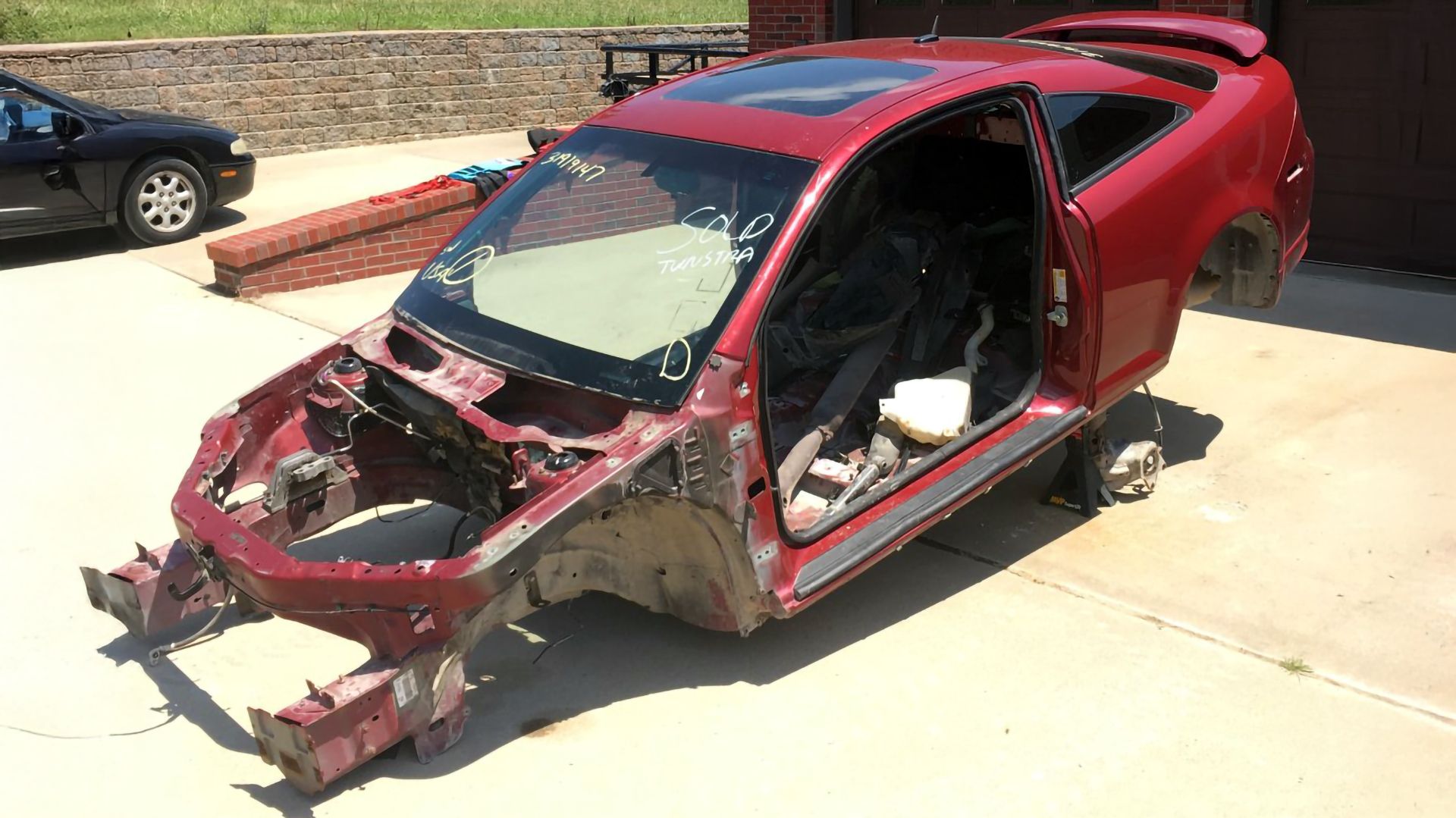

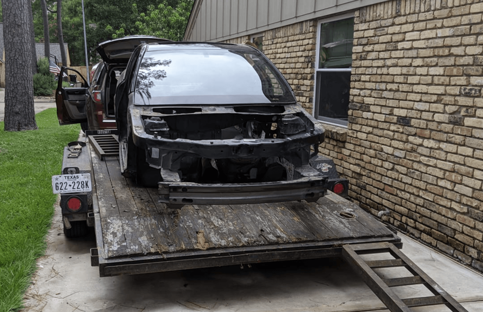

My wife took out an ad on Facebook for a “free shell” no title... a gentleman came and hauled off the shell. Zero cost to me and minimal effort.
- Brett E, Goblin #229, "Brett W’s City Goblin"
A Cobalt carcass being hauled off after harvesting parts for the DF Goblin #229
Brett was able to find someone on Facebook to haul off his donor carcass for free after harvesting the parts he needed for Goblin #229.

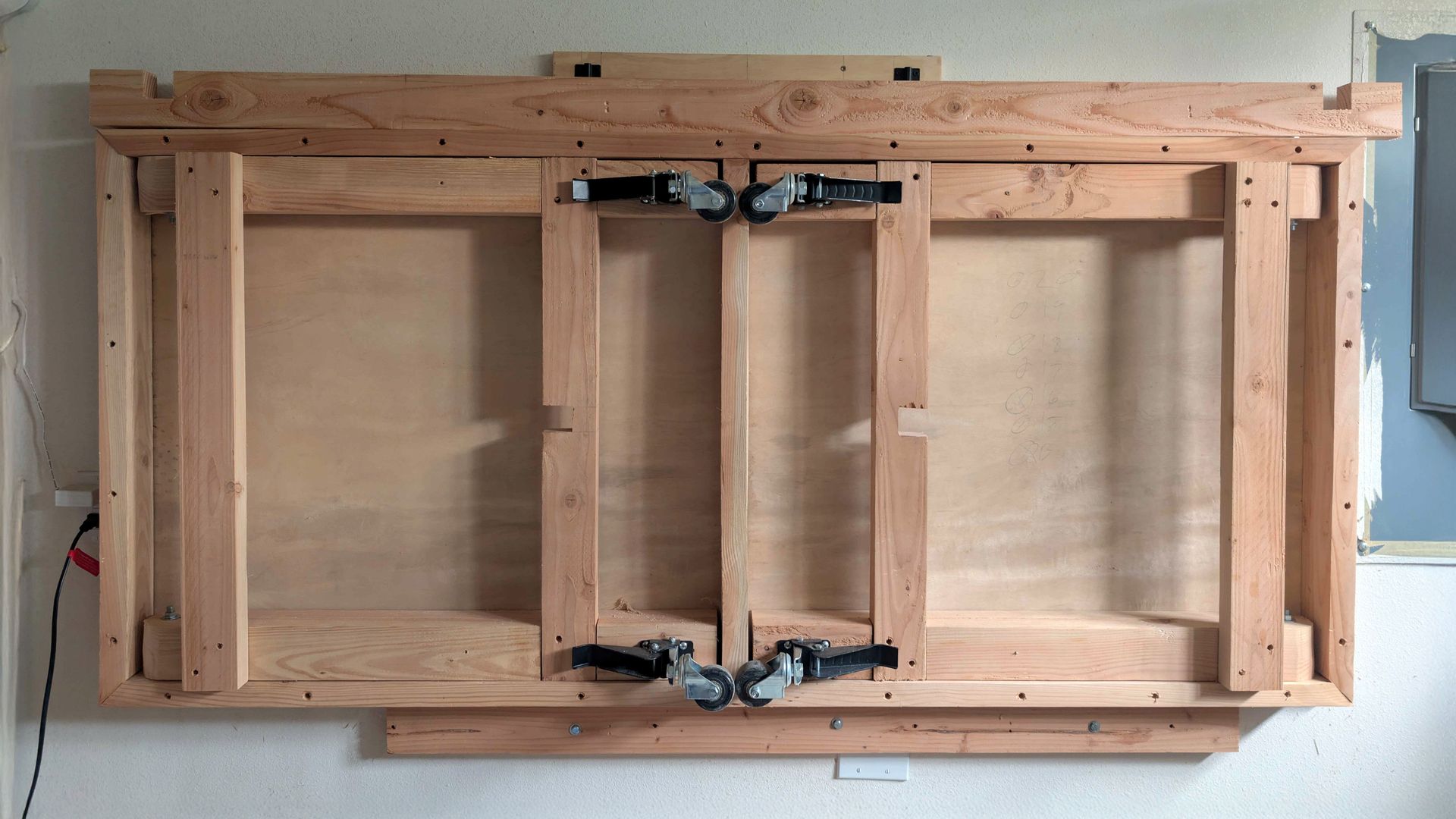

In tight garages, you won't have room for a dedicated, full-size work table, but you need a flat surface for tasks like rebuilding components or laying out wiring. You'll need to look for foldable, portable, and collapsible options.
  • A simple option is a portable folding card table, but be warned that you should protect the top surface with a sheet of plywood.
  • Alternatively, look into building a DIY solution like a hinged bench that folds down when needed or a roll-around bench that folds flat and hangs on the wall. Example video: Wall-mounted Folding Workbench
A DIY wall-mounted folding workbench, in the folded-up position.

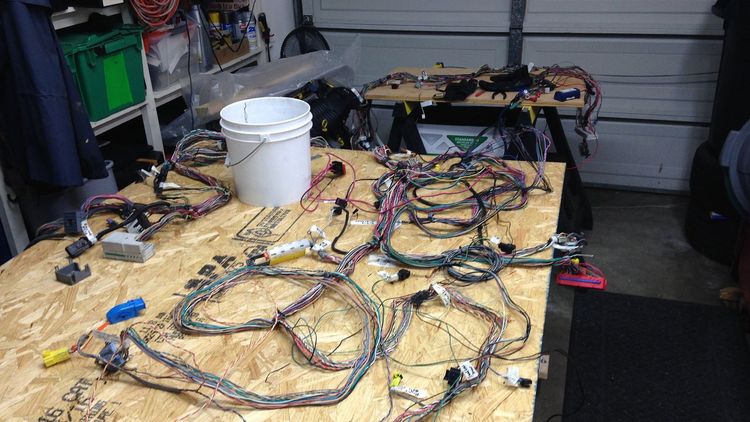

  • One large task to tackle at this time is reworking the wiring harness. Modern wiring harnesses take up a lot of room when sprawled out across a table. Thin out the harness, extend wires, and make all other modifications BEFORE the kit arrives.
Carl's DF Goblin wiring harness being reworked on a makeshift table in the garage.
Carl used makeshift tables when reworking his wiring harness. "Carl's Track Goblin"

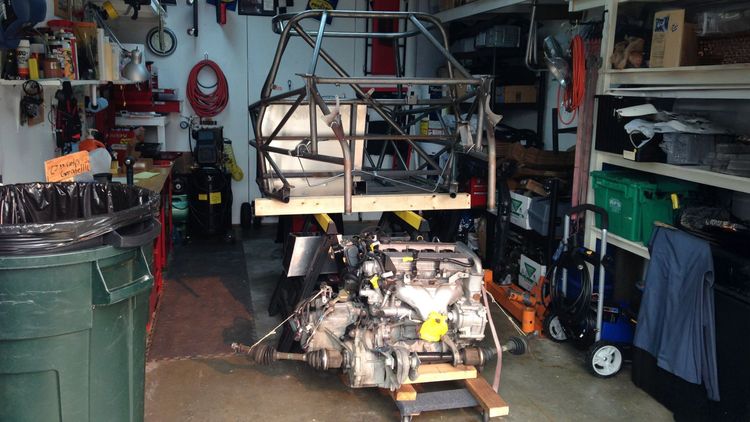

Phase 2: The Powertrain Installation
Once your kit is delivered, the first assembly phase should be about installing the powertrain and getting it fired up.
  • Store kit parts unrelated to this task, like body panels, suspension, and brakes, elsewhere.
  • Even better, if the manufacturer allows it, have them omit those parts from your first delivery. For example, the DF Goblin is available in stages, with Stage 1 having all the parts to get your powertrain installed and running
Carl's stage 1 Goblin kit rests on saw horses over his donor powertrain.
Goblin #39 was ordered in stages to save room. Carl placed the chassis on sawhorses to leave room under it.

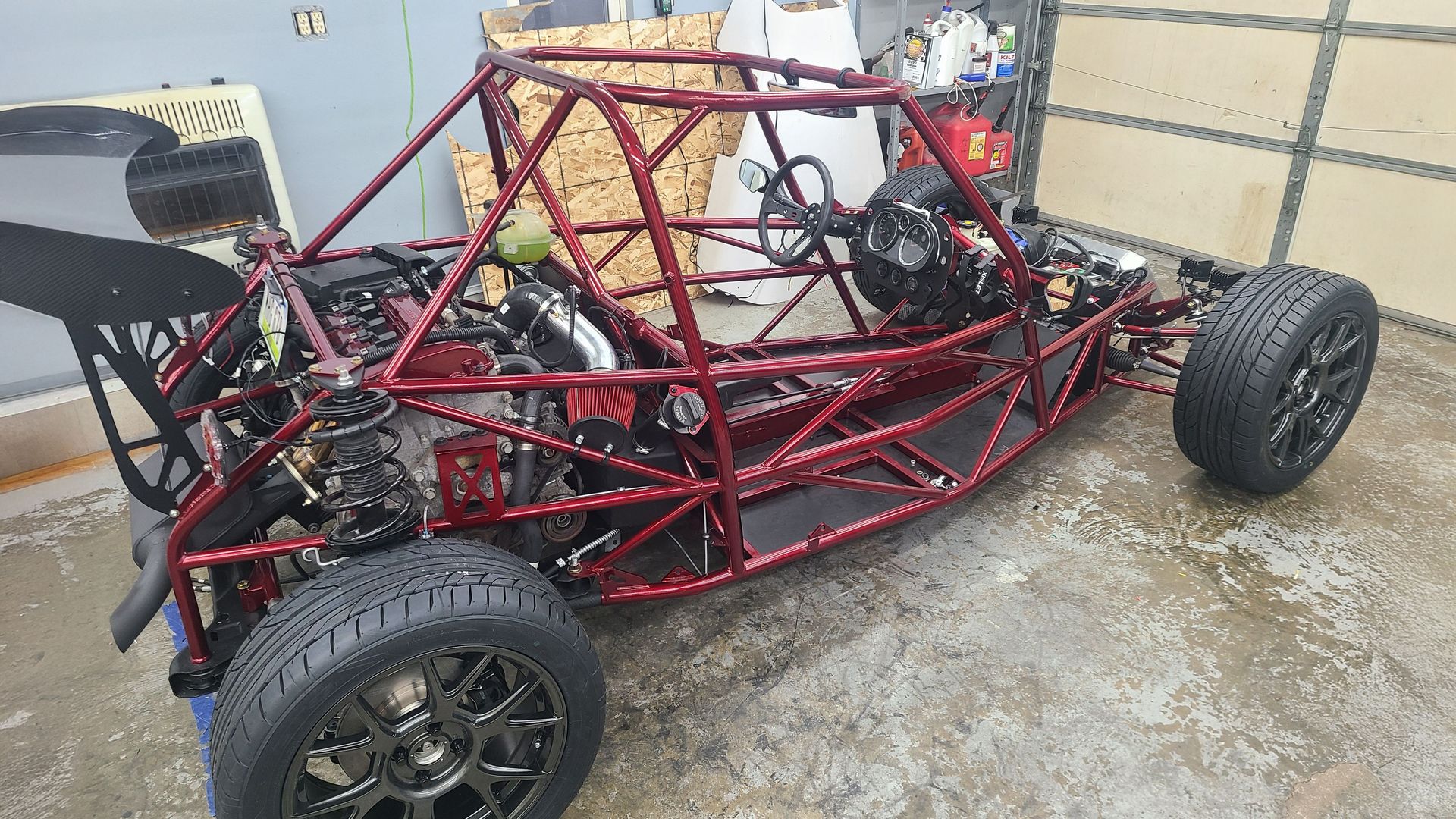

Phase 3: The Roller/Driver Phase
Once the engine is running, tackle the suspension, brakes, steering, and other systems to get the car rolling and driving (Stage 2 for the DF Goblin).
The car will take up more space once the tires and wheels are installed. However, the car will be mobile, making it much easier to roll out of the garage when you need more room to work.
Rob's Goblin #453 sitting on its own tires after finishing stage 2.
Rob's Goblin #453 was suddenly much more mobile after assembling the suspension and mounting the tires and wheels. "Featured Build - Goblin #453"

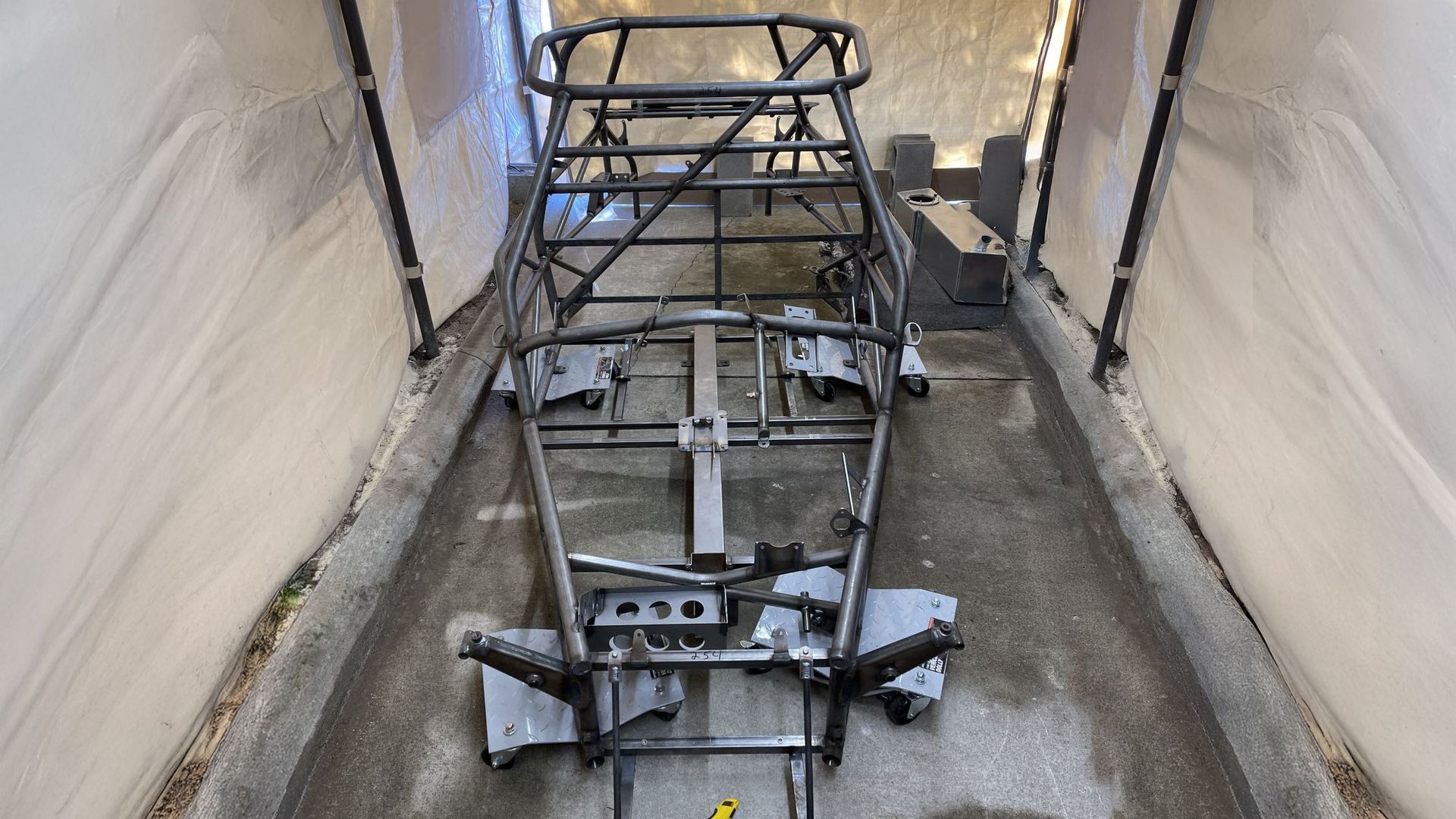

If you have room to build at home but no garage, you can follow all the small-space recommendations, but you must focus on two big considerations: weather protection and security.
  • Weather Protection: The go-to solution is a portable garage or canopy. A 10 x 20 ft portable car canopy is a popular size, and builders have used them successfully. If a portable canopy is not possible, you’ll want a high-quality car cover to keep the project dry when you’re not working on it.
  • Security: You will be more exposed to theft or meddling. Don’t store tools or valuable parts outside, especially overnight.
Nick built Goblin #254 in a 10x20 car port with tarps to keep out the elements.

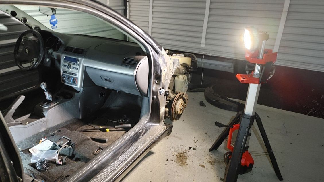

Renting a storage unit for a build can give you a fairly inexpensive 10 x 20 enclosed area to work in, but there are complications.
  • Check the Agreement: You must check the rental agreement to see if they allow you to work in the unit. Many don’t allow any work on vehicles.
  • No Utilities: Storage units rarely have utilities, meaning you’ll need to rely on battery-powered tools charged at home. The lack of utilities also makes things uncomfortable if the weather gets too hot or too cold.
I rented a storage unit for donor tear down. My youngest son helped strip the donor in that 10' x 20' stall (no heat/power/air/electric) in December.
- Kevin L, Goblin #364, "Featured Build"
Cobalt donor being torn down in a storage unit for a DF Goblin
Kevin tore down the donor for Goblin #364 in a rented storage unit. "Featured Build - Goblin #364"
