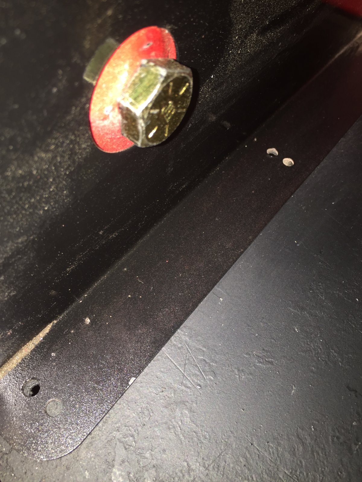

There is an external piece of bar stock that comes with the kit that gets bolted into those three holes to stiffen the area that you use to step into the car.
JSATX

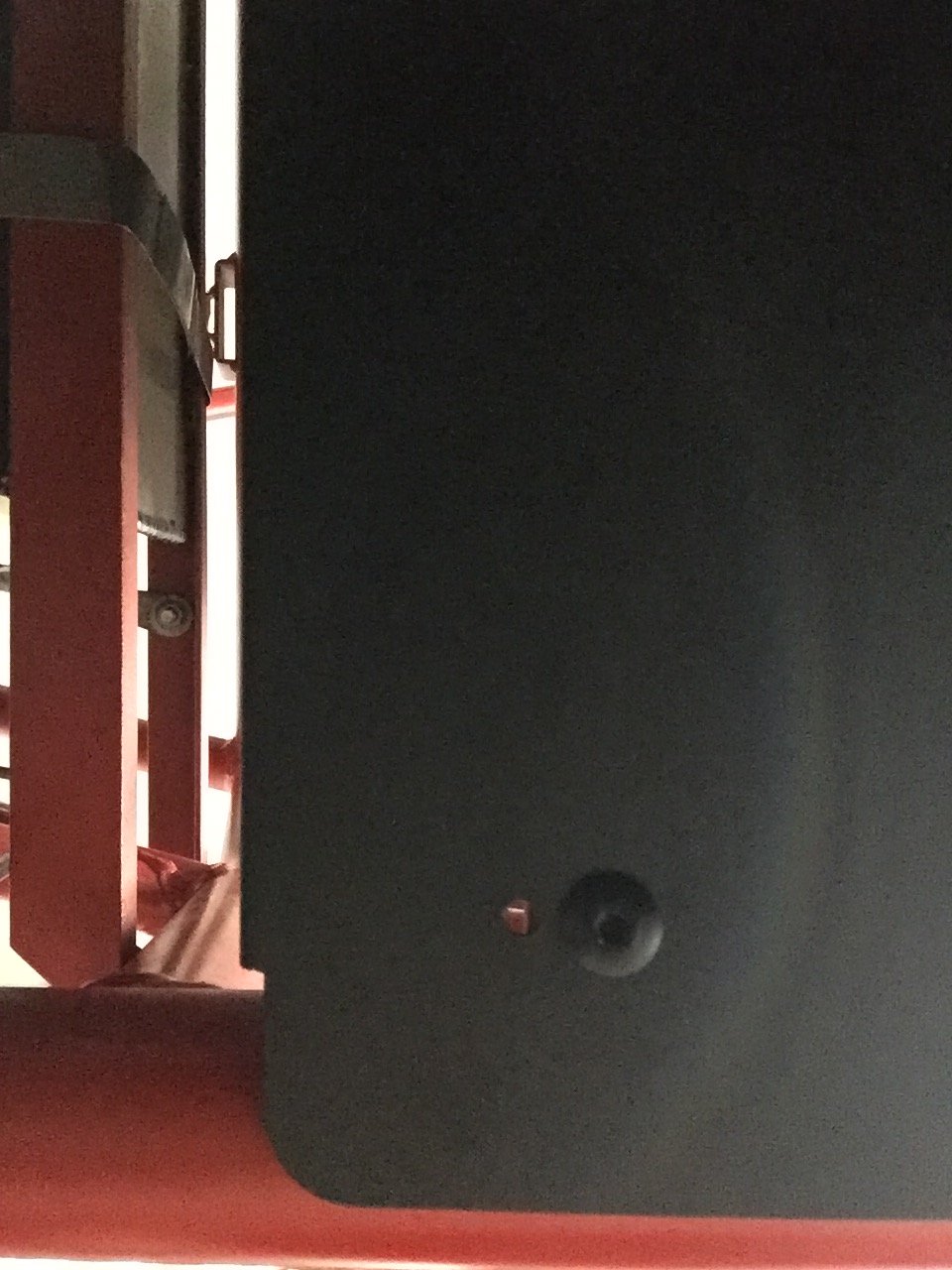

Yeah that's up near the pedals. His picture shows the back of the floor plate.
Mine also has those, but it had a hole just behind it that was centered on the support beam.
I'm confused about the front firewall. It also has two holes. My first thought was one goes to the floorplate and one goes to a little sheet metal plate that extends the rest of the way to the nose. Problem is it's the front set of holes that lines up with the floorplate.
AleX1/9
Turns out earlier versions of the goblin had a 2" brace at the rear instead of 1", and all I needed was some added holes like on JSTAX's. I also have the extra holes on the front like jtax's...might have been a correction?

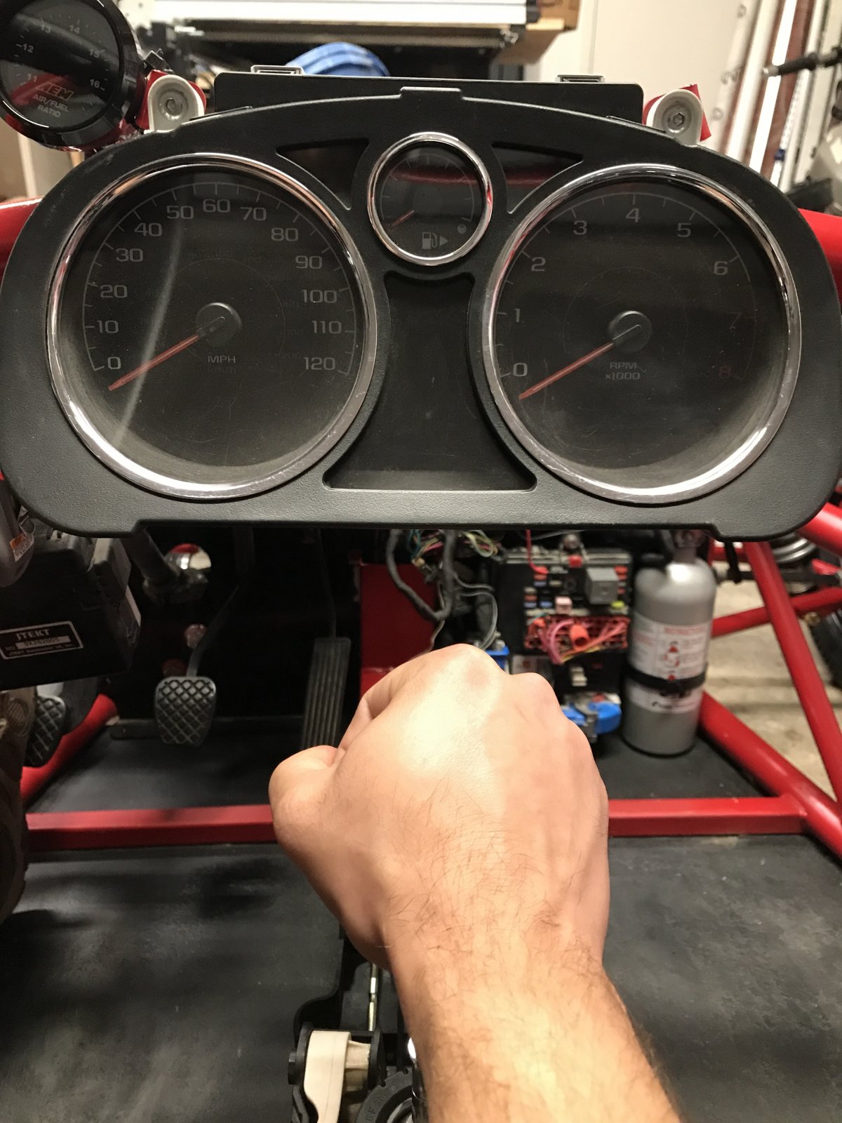

JSATX
I was asking about the 3 gauge pod under the stock speedo/tach unit?
While it does look awesome you're going to probably be pretty annoyed with it once the shifters installed. That's exactly where I wanted to put a switch panel but I'm going on top of the gauges now.
Edit: I meant to say I'm putting a smaller switch panel under the stock gauges and the boost/AFR etc on top.
