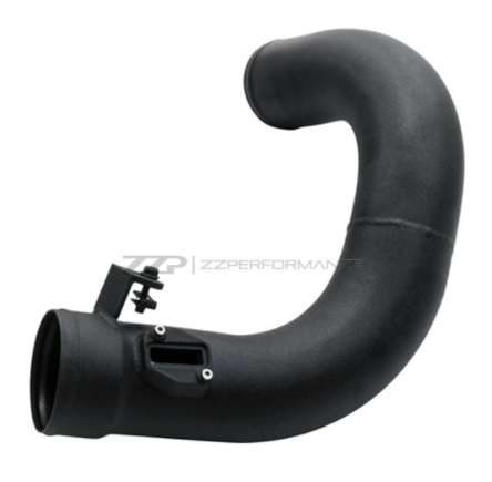

The MAF that was on my SS was in the wheel well. Pretty close to the actual filter. It was the ZZP CAI fyi. I considered keeping it but I assumed we'd have something that came with our kit. I guess not if you had to make yours. I'll have to find something.

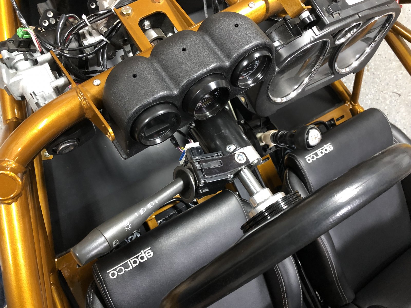

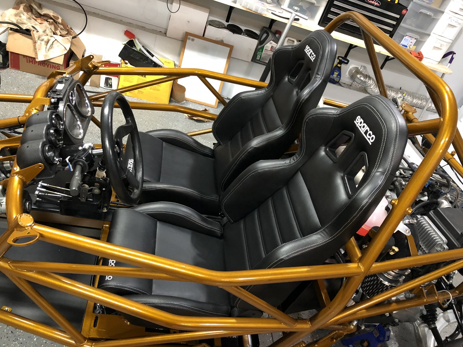

Seems to run ok, but now that the seats are in, I’m envisioning a filter mounted snorkel style between the two headrests! That would also give some length between the throttle body and MAF

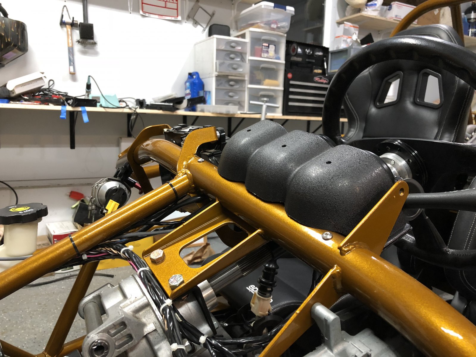

Also found a new spot for the auxiliary gauges. Mounted to the column, and notched into the cowl tube.
I also made some new brackets for the turn stalk, to angle it back and away from the steering wheel. The steering wheels that come from DF have a deep dish, and mine is pretty flat, and was only an inch behind the wheel.

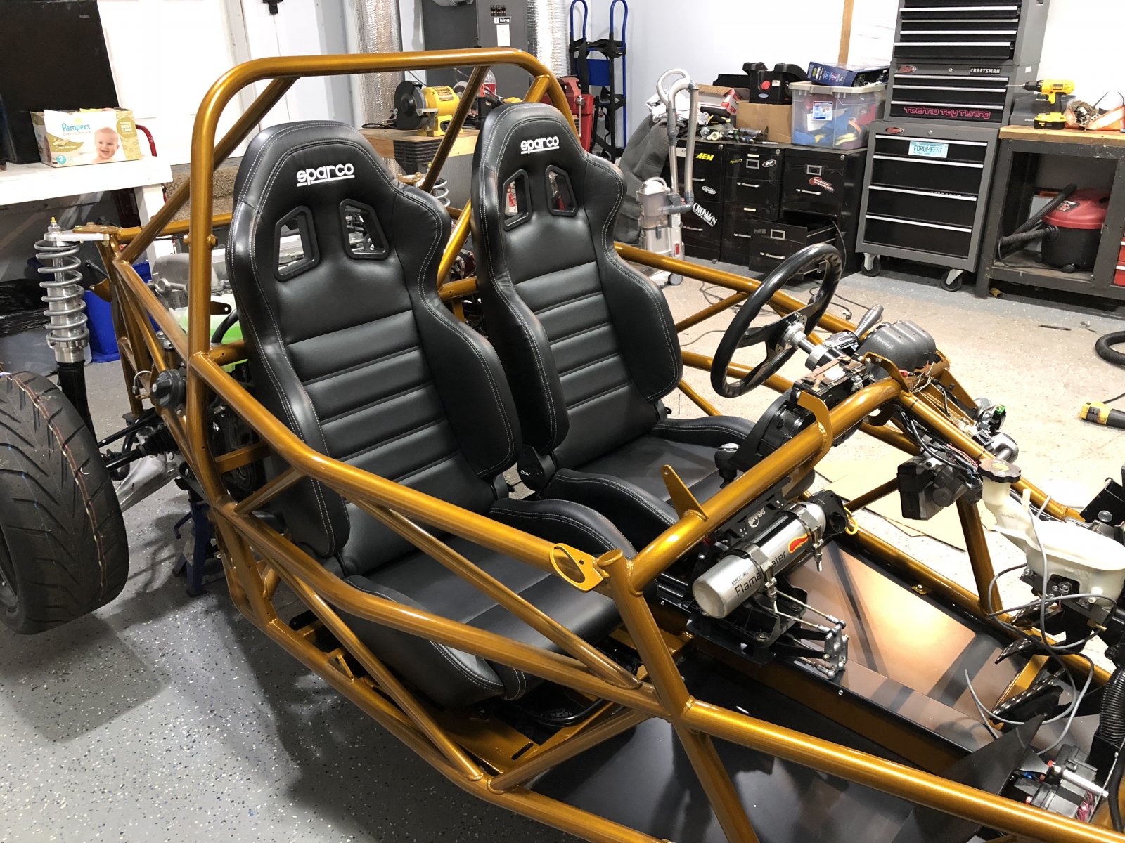

I really like those seats. Are they comfortable? Did you retro fit sliders or buy some for them?
Thanks guys!
They're quite comfy for me, I'm 6 foot 200lbs. Can't speak to long road trip comfort though. I welded supports in for sliders before powdercoating - more details earlier in this thread. maybe page 2? Also laid some dynamat down underneath.
