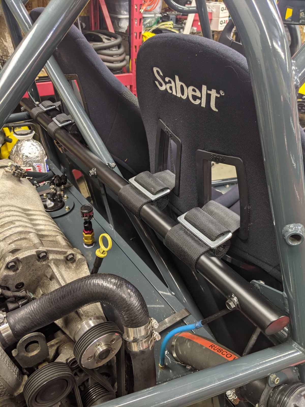

FWIW the tow bar kind of adds a tow hook. Its not ideal, but would work for loading/unloading from a trailer I imagine.

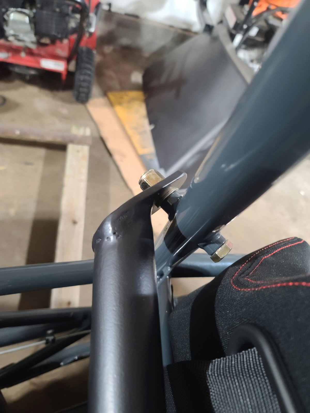

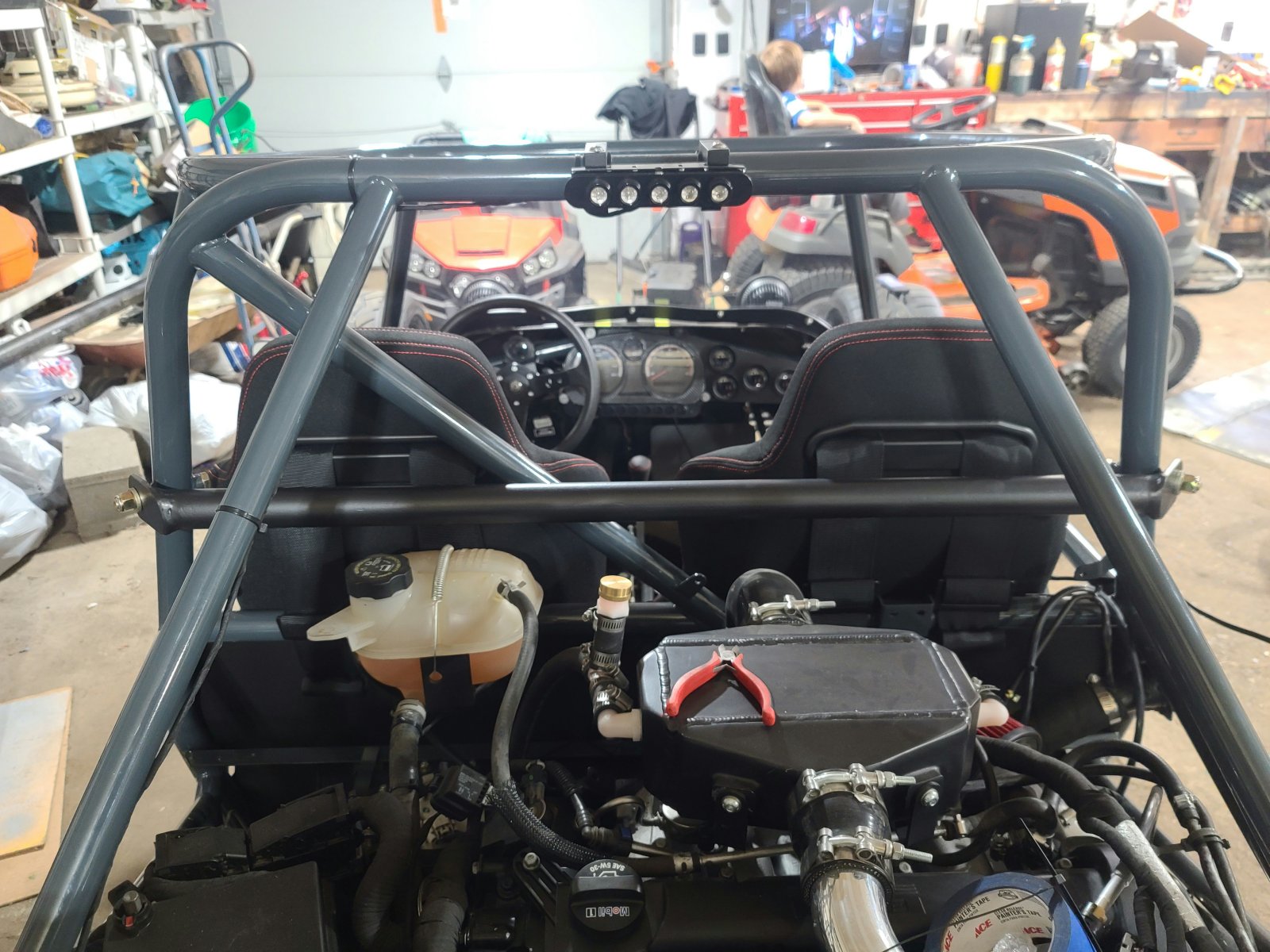

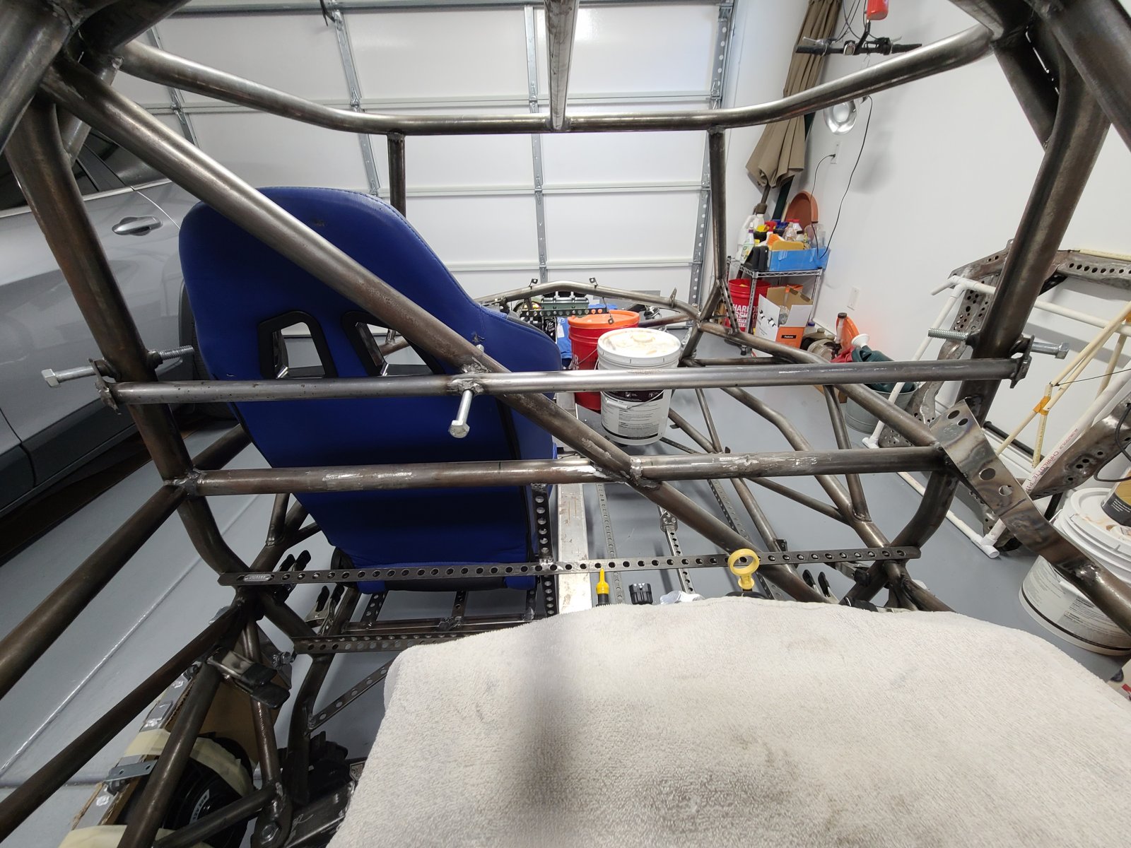

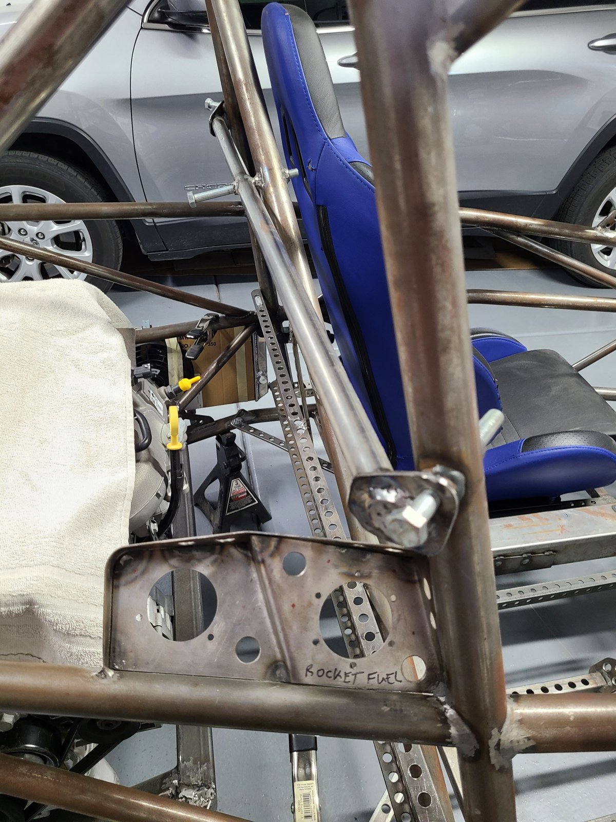

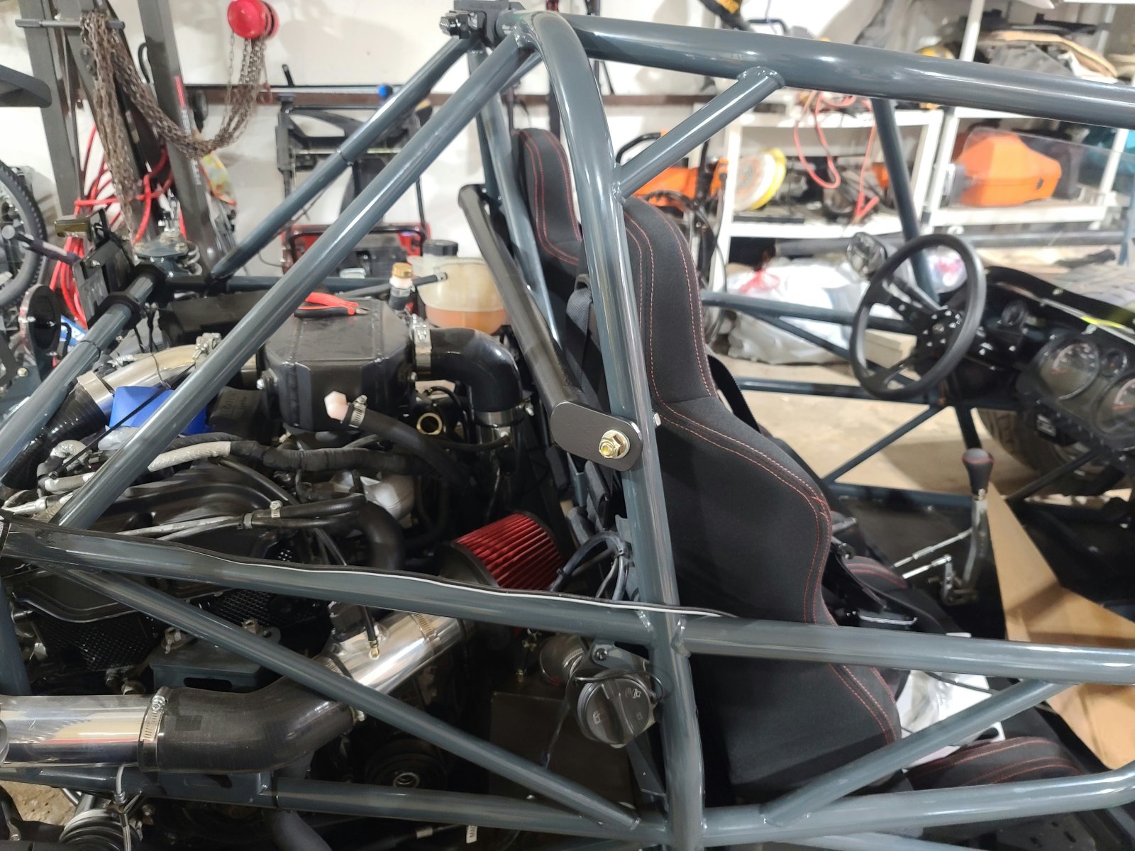

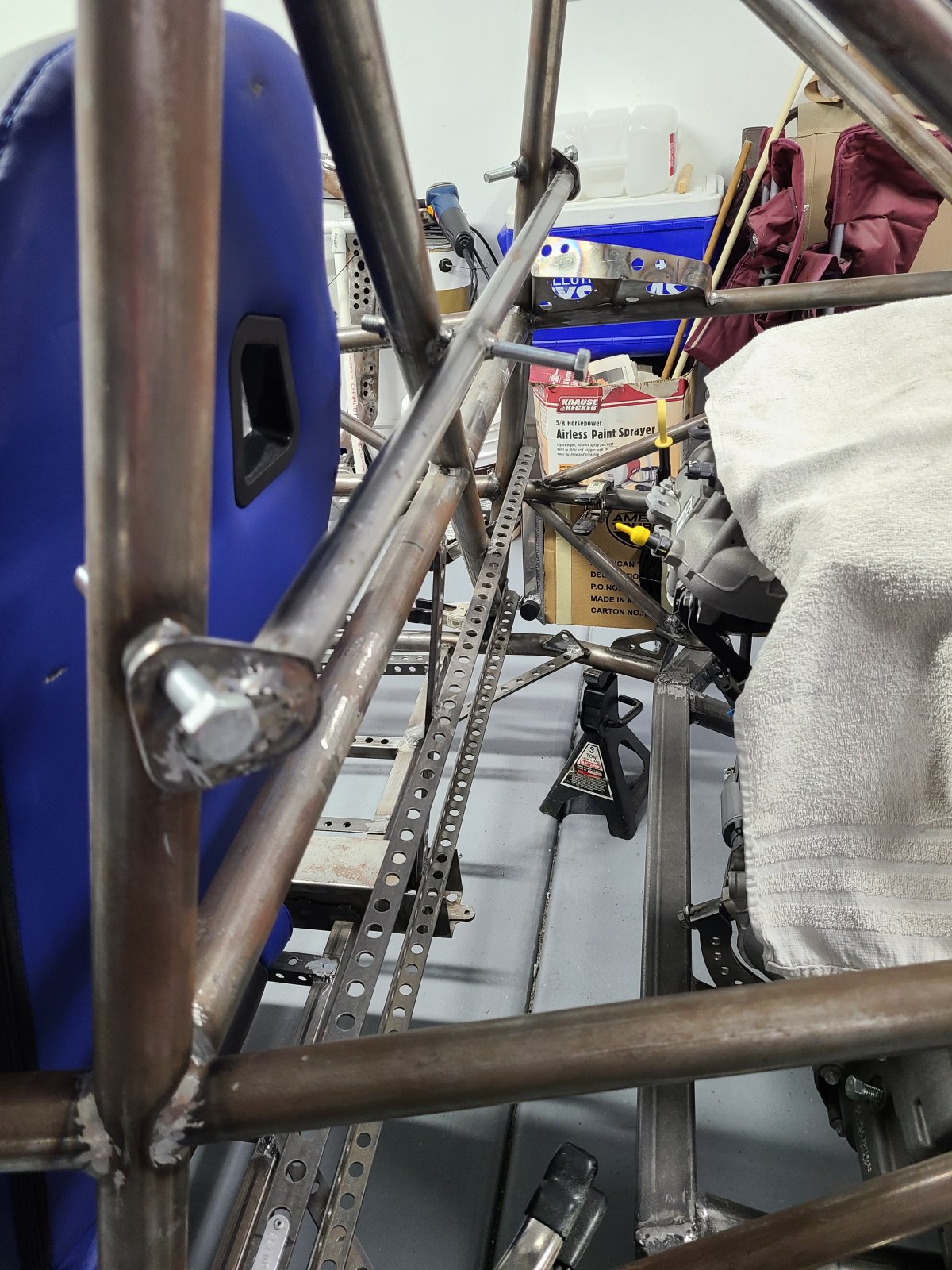

Like this? Several builders have fabricated harness bars that utilize the b-pillar/rollbar upper mounting holes for the stock seatbelts. This is just one way to add a harness bar.

Everybody's seats must sit a lot higher than mine. I had to mount my harness bar quite a bit lower.
You have a lot larger opening for the harness. How tall are you? If you had it pushed up to the tip of the opening, it would be more in line where a lot of us have placed the bar.
