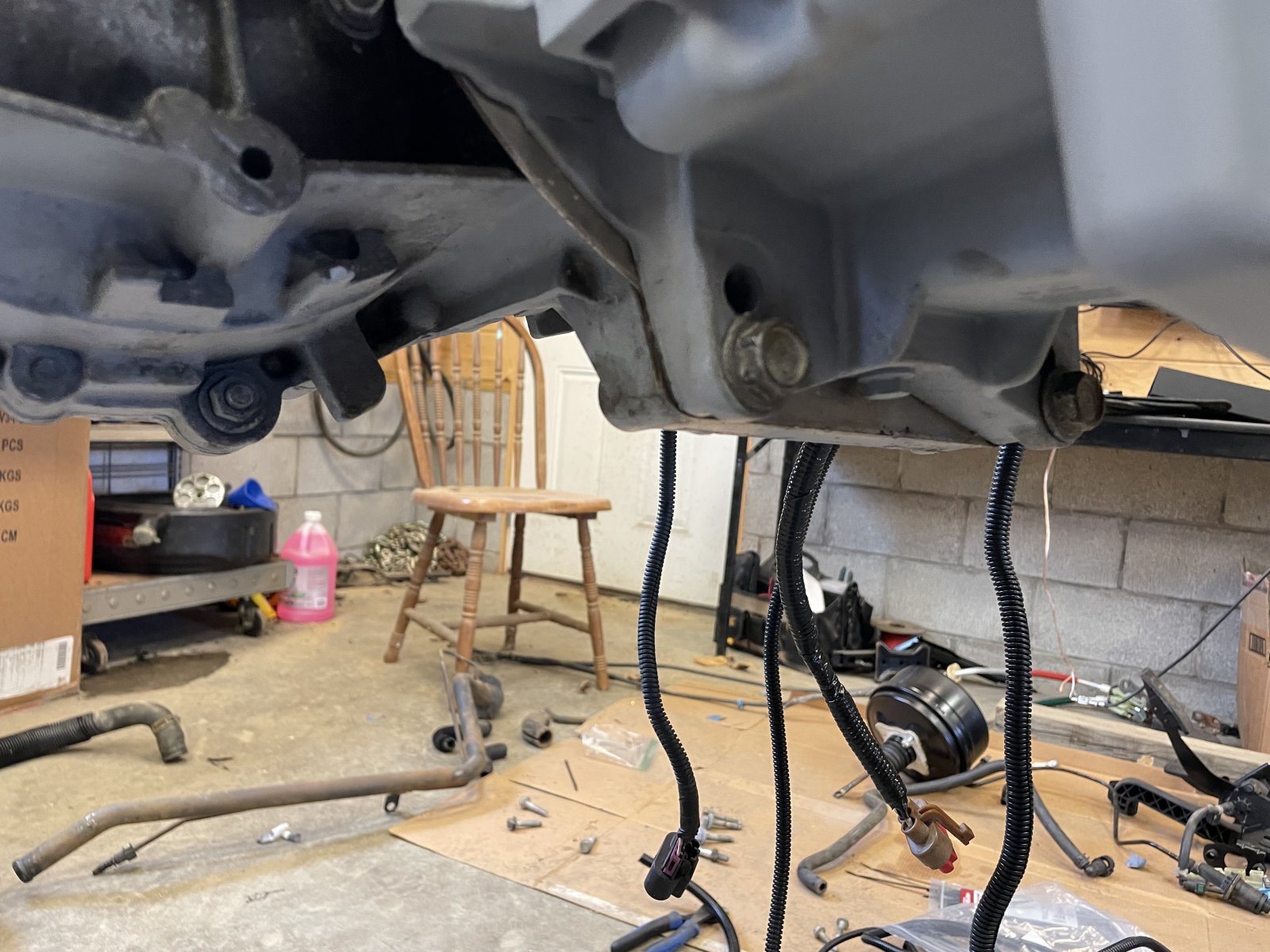

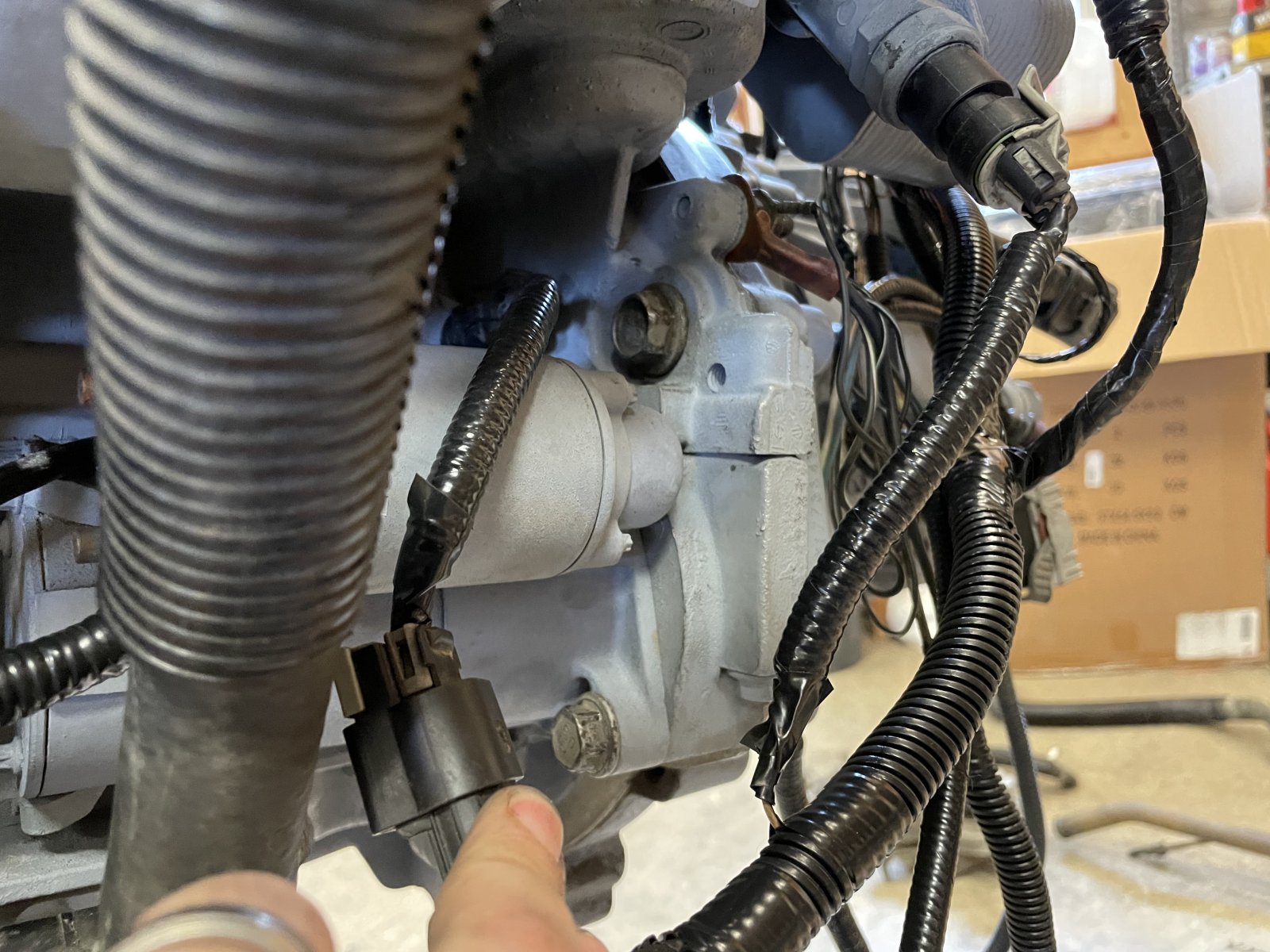

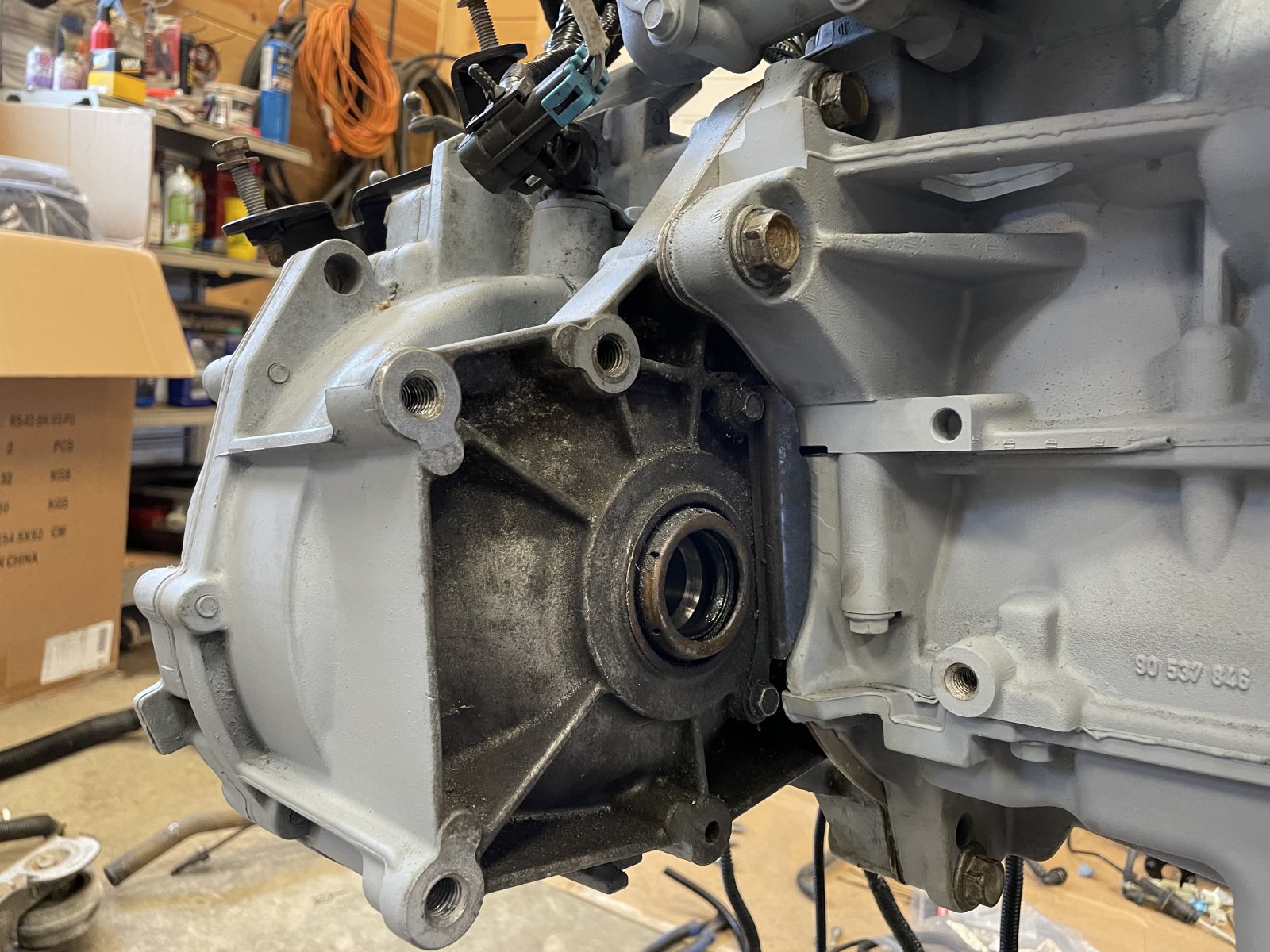

Mating my F35 transmission back to the engine today. Got everything back together and no I didn’t forget the spacer.
Butttttt I didn’t do a great job of tracking what bolt goes where. I have a few different lengths that are the same thread type. I also have one that appears to be a ground stud. I also need to bolt on the passenger side motor mount and appears to be the same thread. So I’ve go the transmission bolted up but I’m not sure it’s with the right bolts. I tried to look through alldata but it mostly has details of the internals, I couldn’t find an exploded view that shows these bolts.
hoping someone more organized than me has this documented somewhere.
A little late, but I would have probed the hole and made sure that the bolt doesn’t bottom out. Beyond that it doesn’t matter that much. I used new bolts by doing it this way using the longest bolts I could without them bottoming out.
Where the ground is connected isn’t that important. I just made sure that a ground was connected from frame to the trans and block.
I think the longer ones went to the bottom two holes the stud was the second up looking from the back in. Then the others were all the same.
E

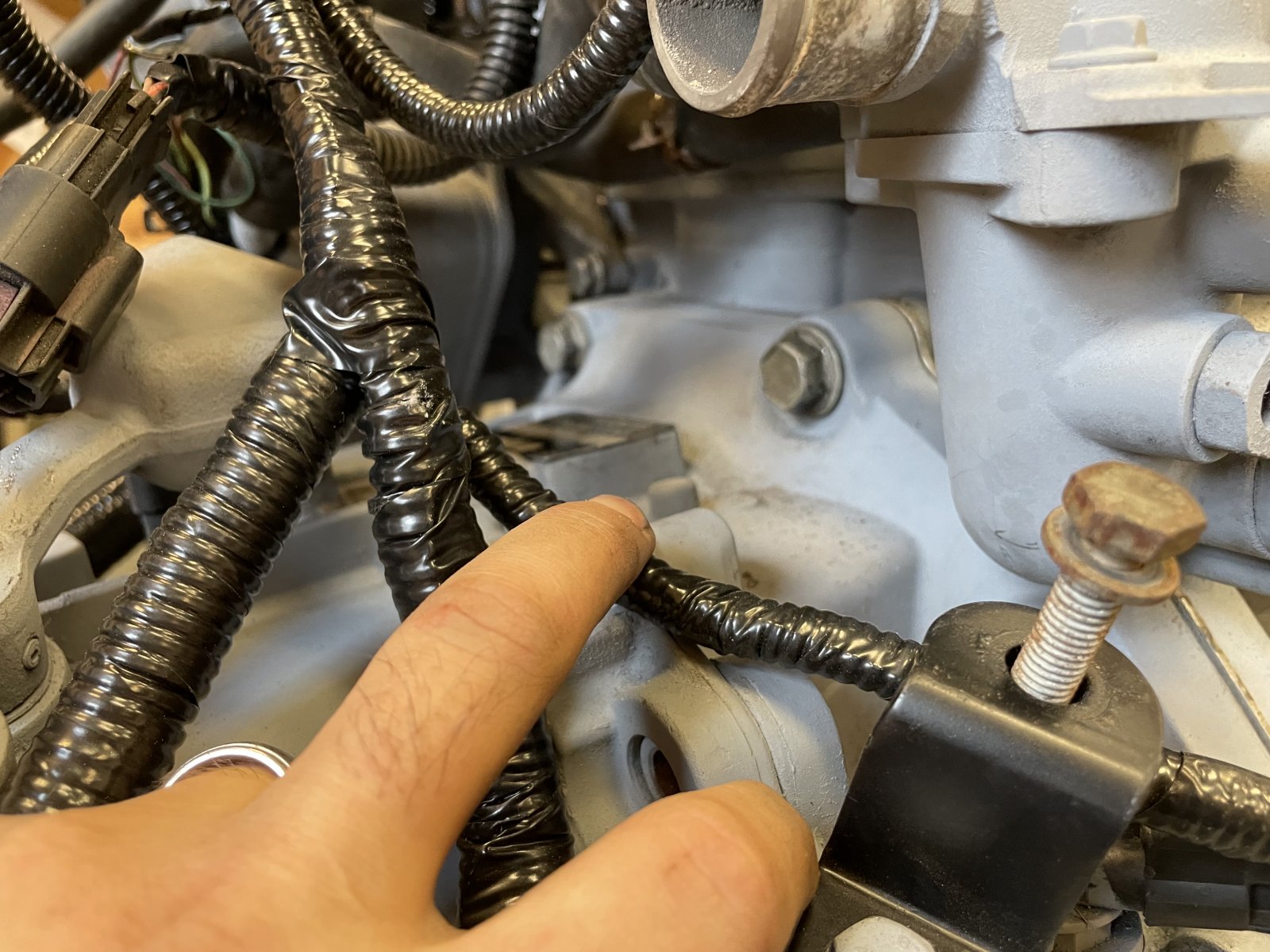

I currently have the longer ones on top because when I went to put them in the bottom they started the bind because they were pushing some crude out. Made me think the shorter ones went there. As you can see from the photos I currently don’t have the ground stud installed. I’m still unsure of where to put it. Looking at the manuals I’m thinking it might be G105 but I’m not sure. The engine already has a ground stud and the transmission housing does too.
if anyone is in the tear down process learn from me and take a lot more photos.

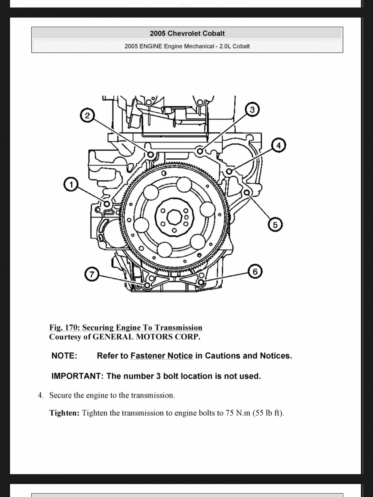

Found this is the engine manual (photo attached). Apparently you leave one of the top bolts out?!?

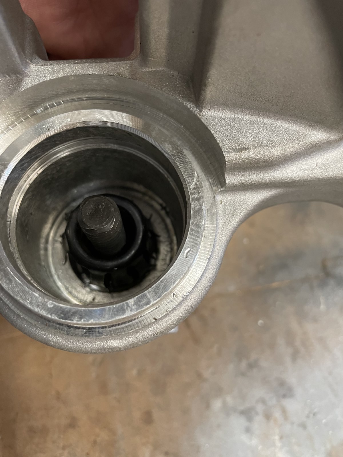

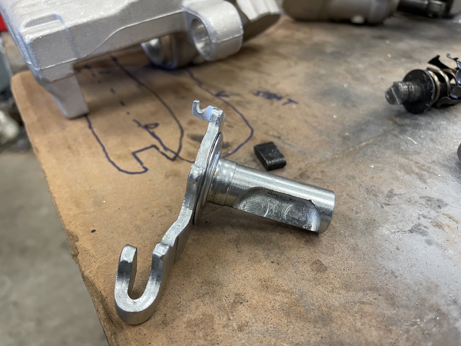

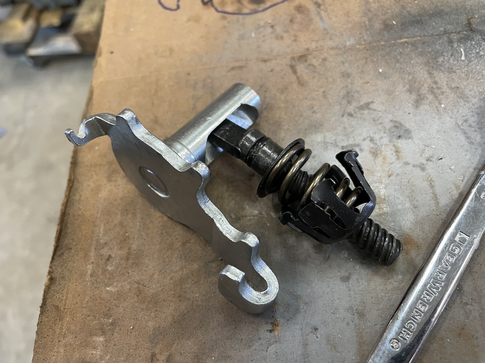

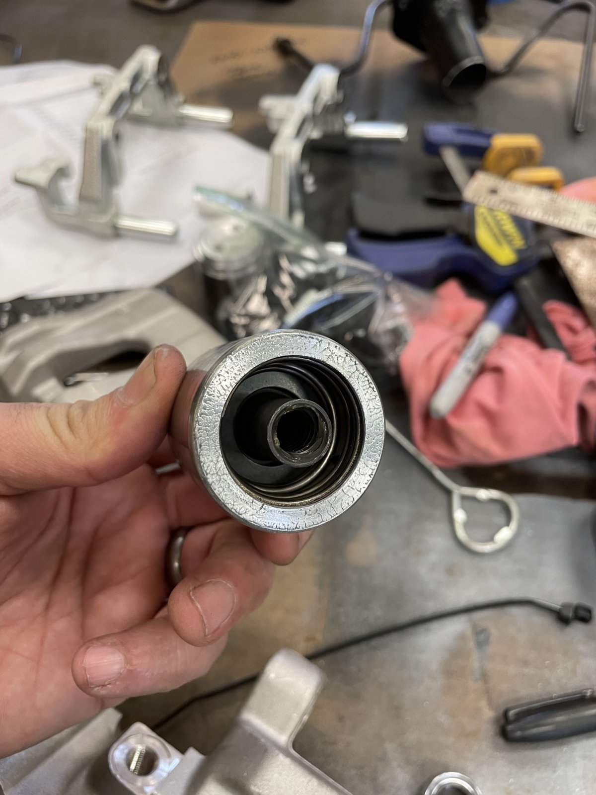

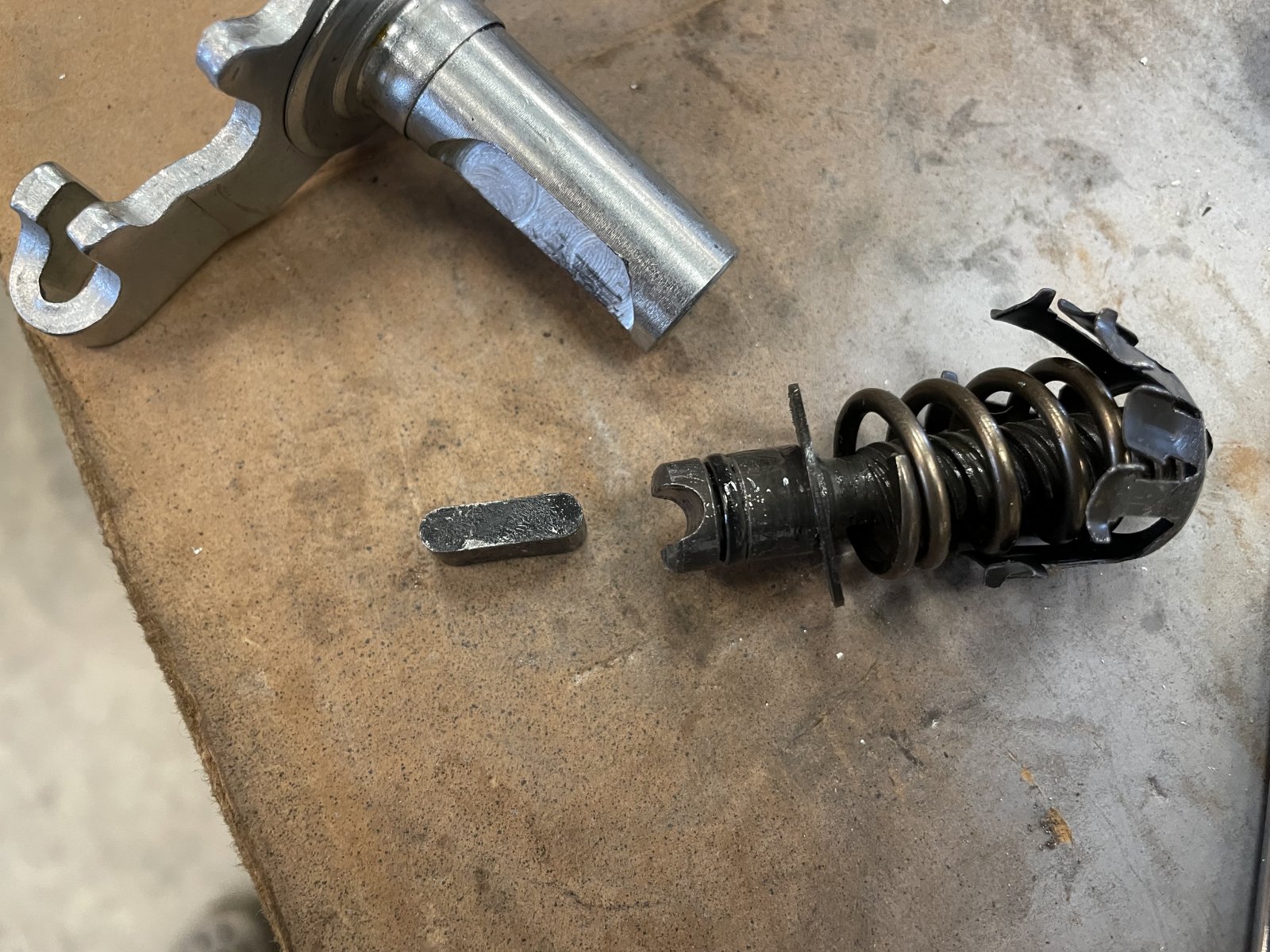

Quick update. Following @escapepilot lead on the other caliper and just leaving the e-brake part alone. On the one I already jacked up I did manage to get it apart. I had to spin the cylinder out because is kind of cork screws into the e brake mechanism. Then there is a little cap that you pop out which holds a spring in. On the other end of the corkscrew is a notch that a small oblong shaped piece fits into. The shaft that goes out and connects to the e brake cable and spring has a notch in it that moves the oblong piece when it’s turns, which then moves the corkscrew that pushes the cylinder. I need to figure out how to get the spring compressed back with the cap on it. And I need to drill out the pin I sheared off and thread a screw or something in to replace it. Attached some pics of anyone wants to know how these things work. Bottom line is don’t do what I did, follow @escapepilot direction.

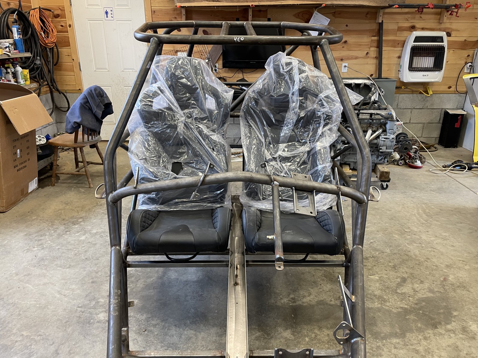

so the good news. Got my seat brackets welded in and my seats are temporarily in place. Fortunately I recalled reading a @Desert Sasqwatch post one day on angling the seats. My assumption is the offset of the DF tabs for there seats is relative to the angle I needed. Had a buddy out today and we worked up a jig and measured over and over again. I’m happy with how they turned out. If I decide I need any incline I can always add a spacer in the front.
