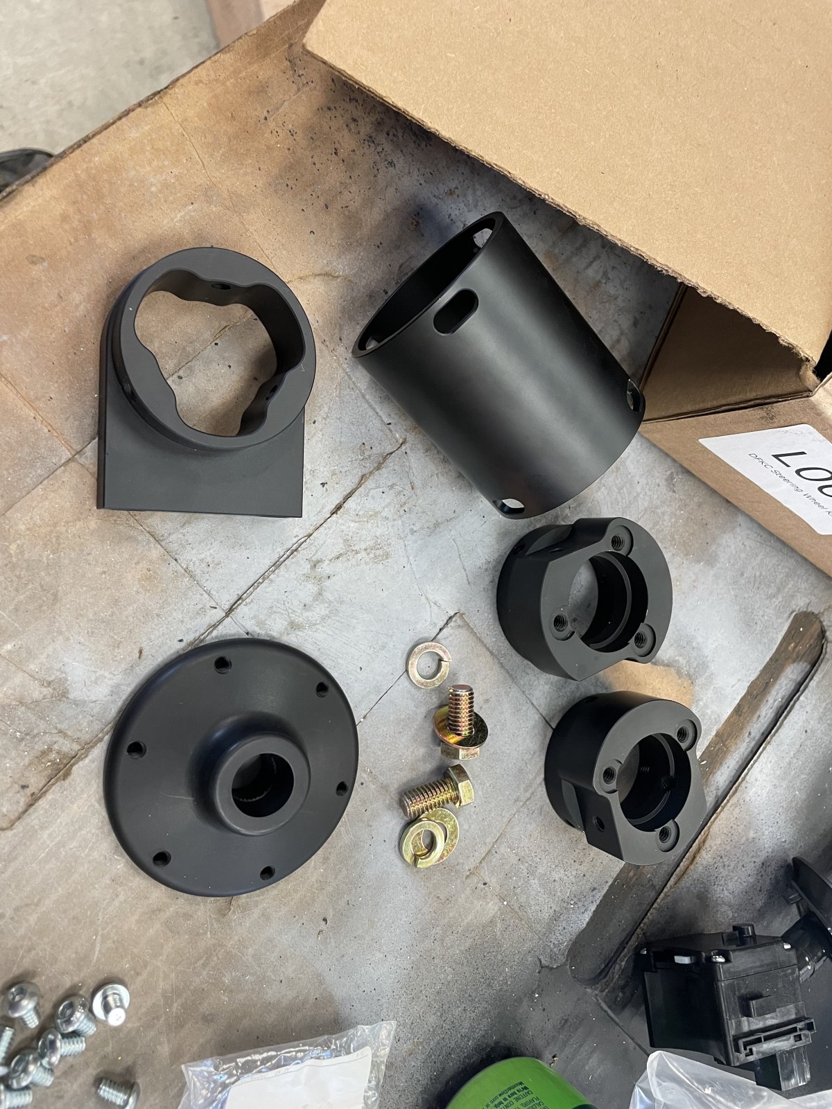

Posted some of my steering wheel issues on another thread, but wanted to also note it in my build log.

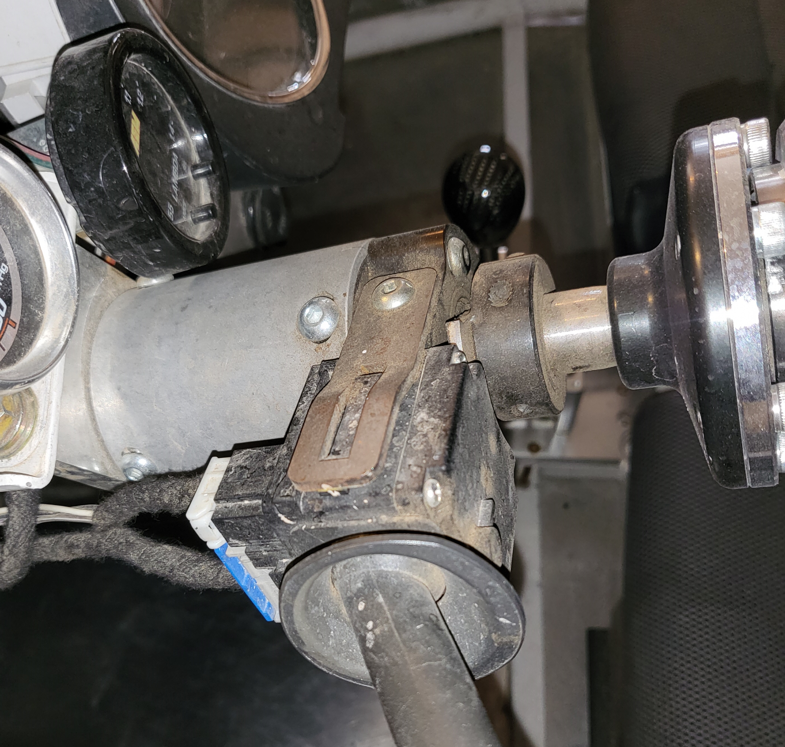

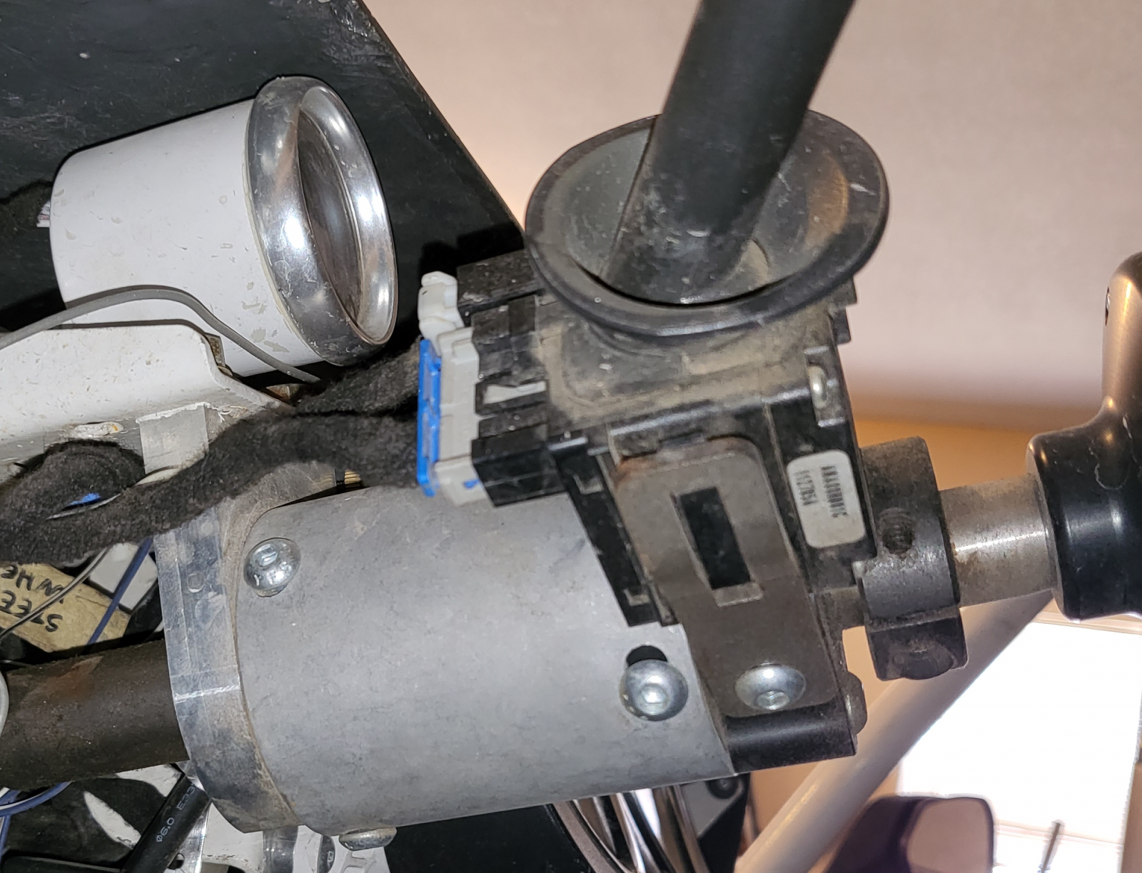

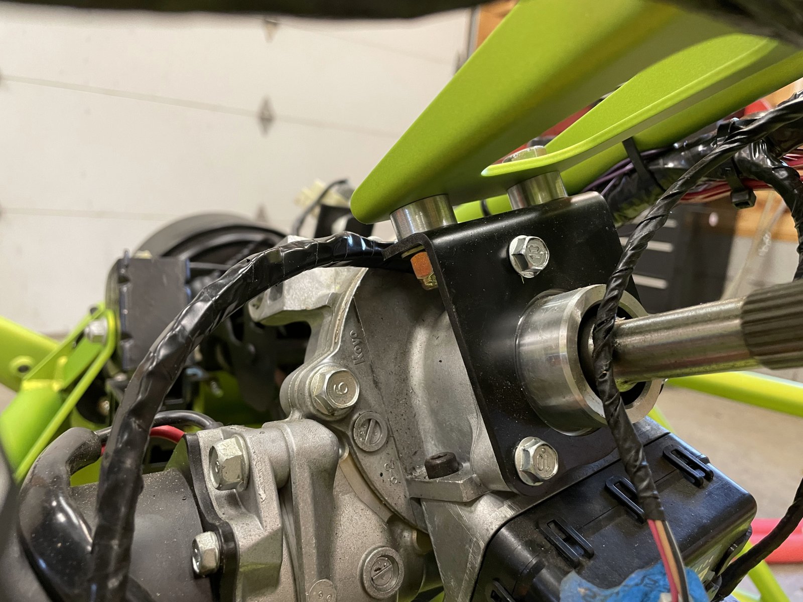

the piece that should fit the steering shaft spline us to small? Are there different size splines for different models? Attached photo shows my part pieces. The shaft is a larger diameter. @Adam and @Lonny ? I’m also looking for a photo of how all those pieces go together. @Ross provided a thread on the quick disconnect piece but I can’t figure the rest out.

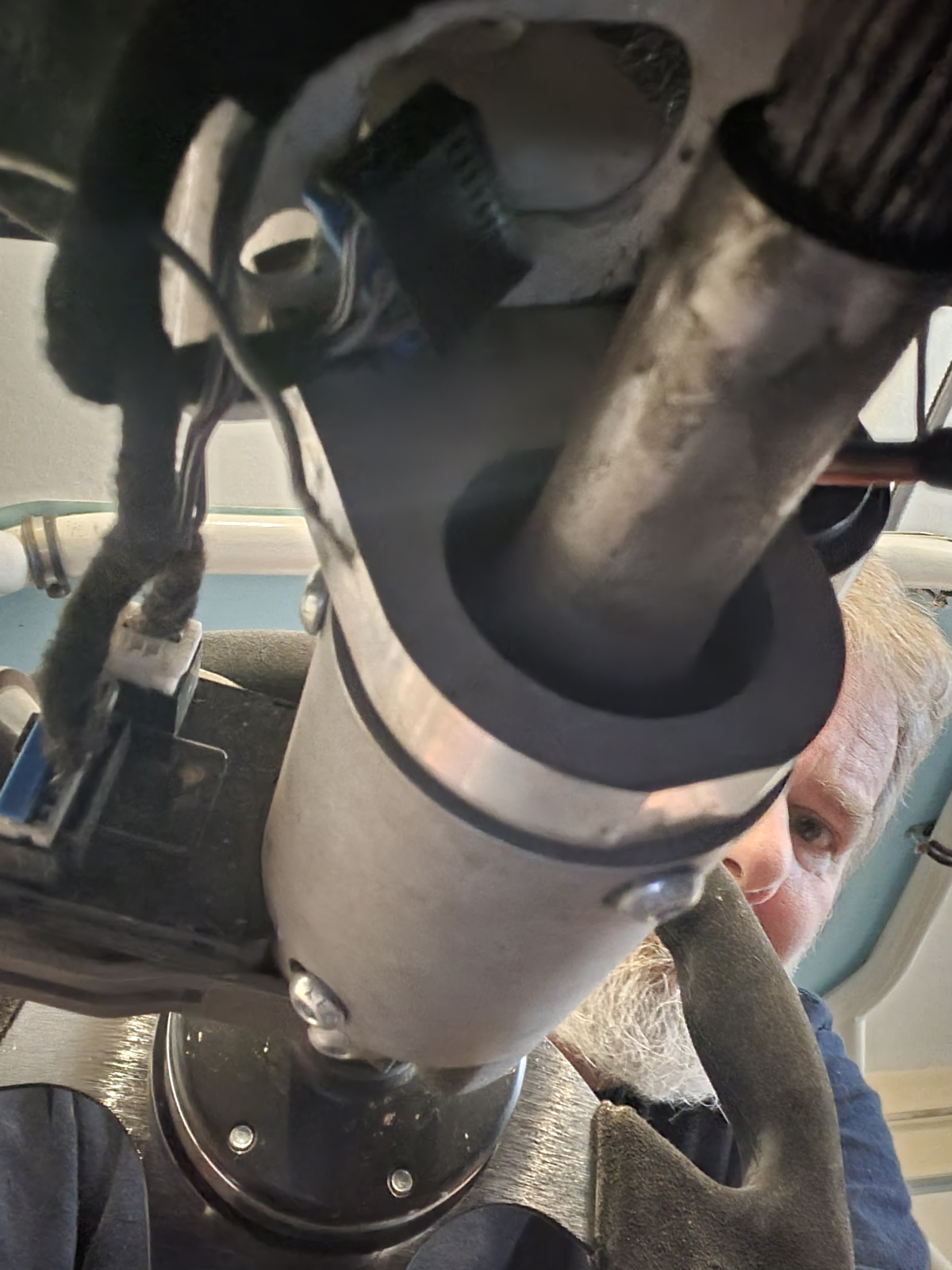

Can you post a picture of your current set up. If I’m not mistaken there are 2 shafts that mate together. Maybe you have them backwards
I’m test fitting things to check seat placement before powder coating. So maybe I’ve jumped a step.

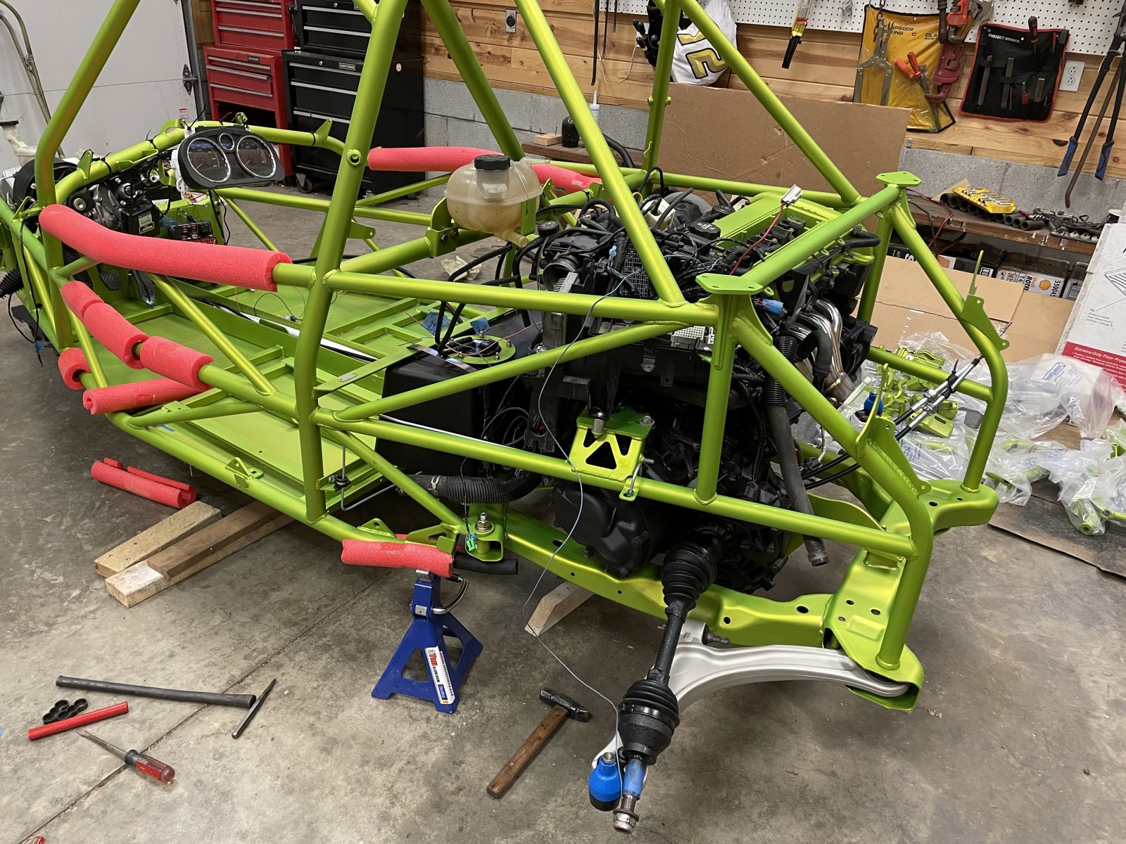

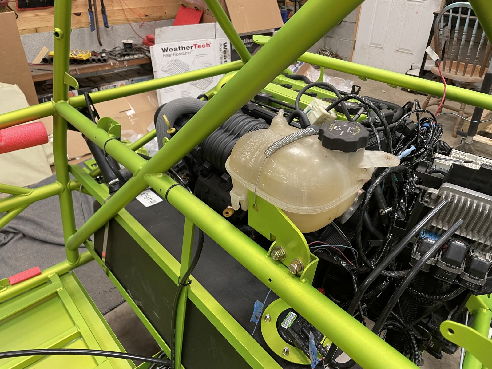

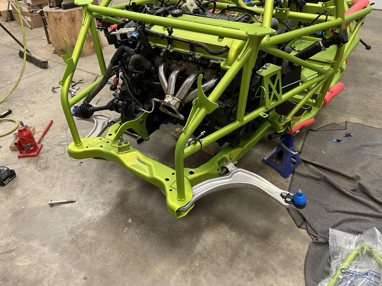

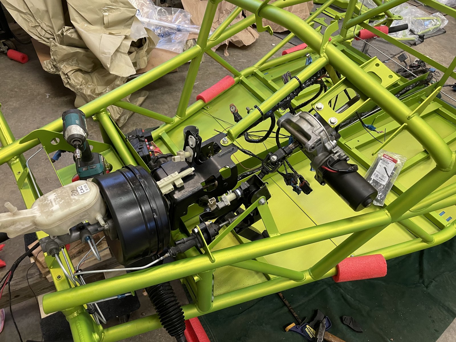

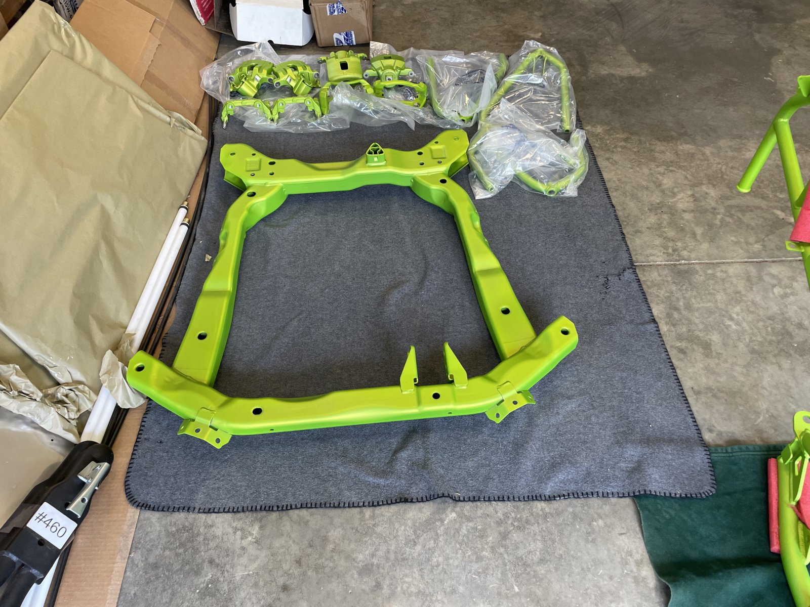

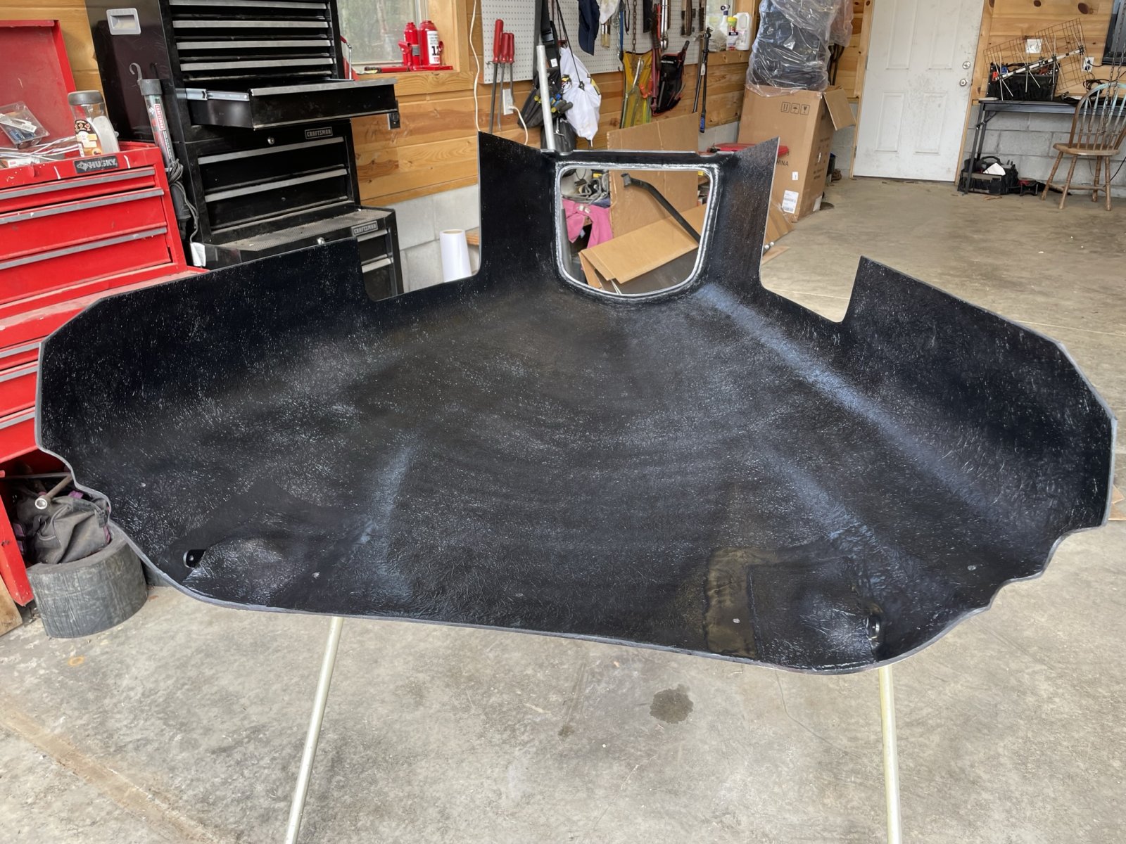

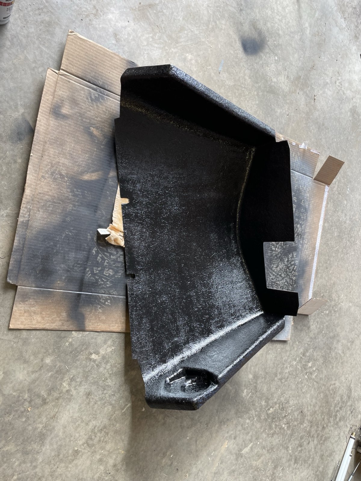

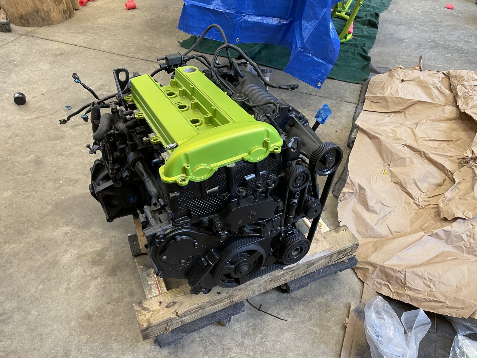

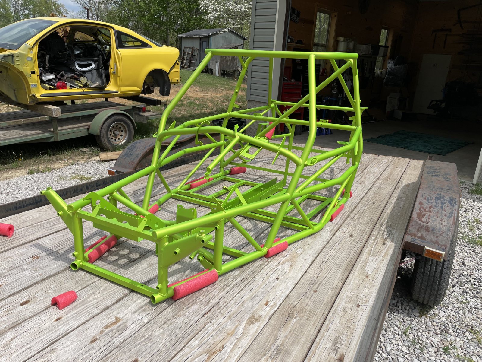

Been awhile since I have gave an update. Got the frame and parts to the powdercoater. Went with Columbia Coatings Toxic Lime. Happy with the color and pretty happy with the quality. While the frame was off I decided I didn’t like the Duplicolor Engine Primer color so I opted to pull the wiring back off the engine and go Duplicolor Engine Low Gloss Black. Very happy I did. I also painted the backside of the fiberglass pieces black. After getting the frame back I got the hoses pulled and the floor pans on. I decided to go with clear silicone on the floor pans instead of the recommended black sticky stuff. Not sure if that was a good idea, but I had a fit with the rivets because my tool is garbage, so I was glad to not be fighting that also. I’ve made it few some of the first assembly videos, so far no major issues. It seems like I my brake line is a little to long. I’m also just following the videos right now but I did buy the proportioning valve so I’ll probably have to go back and rework things later when I decide to install it. Attached some pics below.

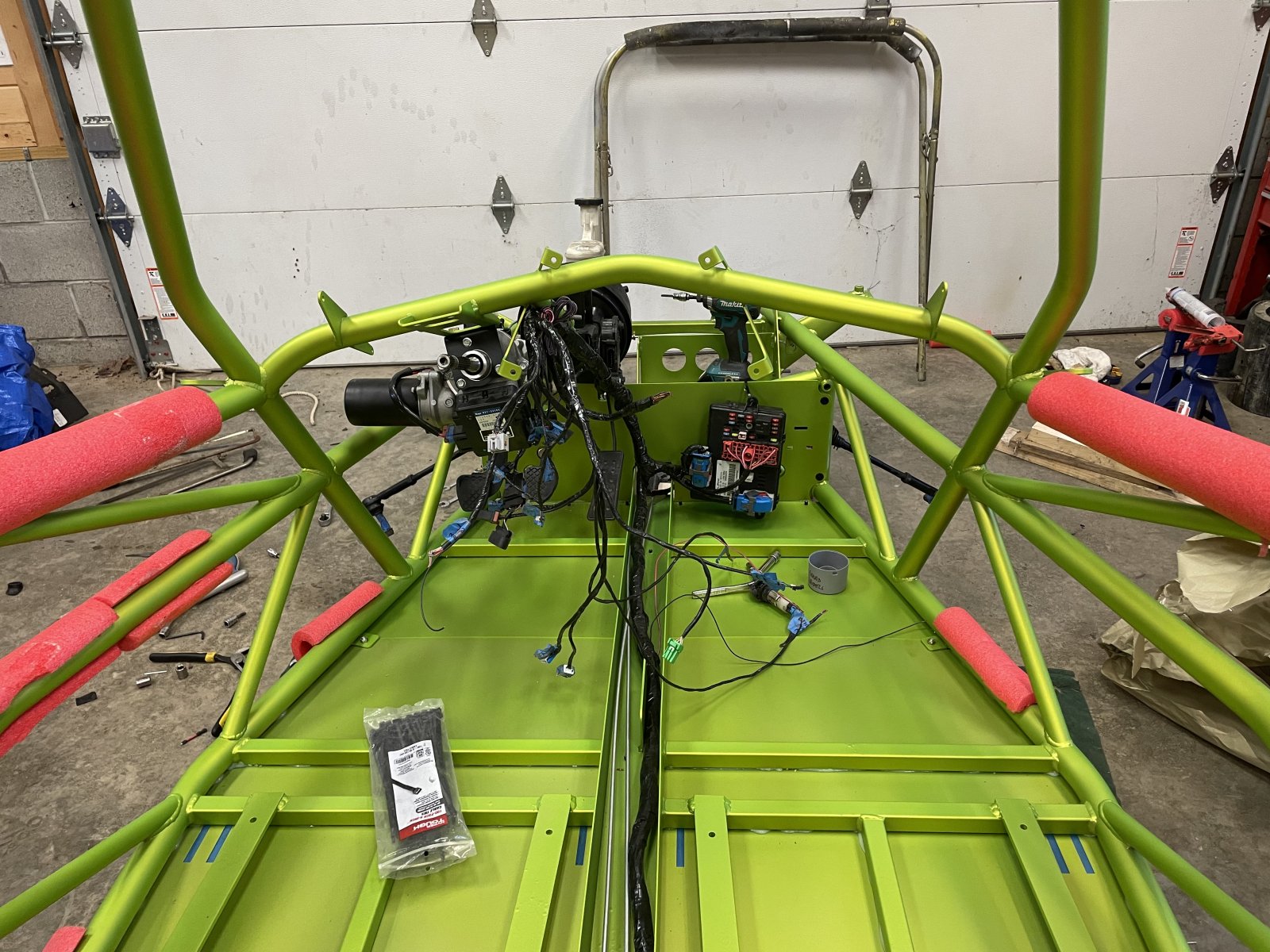

So I got the engine in and subframe bolted up. Mounted the fuse box and plugged in what I thought I needed. Ran hoses for fuel and to the overflow bottle. Put some oil in, coolant in, and some gas. When I turn on the key the lock actuates on the key mechanism and then I hear a click at the BCM. Doesn’t sound so much like a relay clicking as it does something is short. I pulled the plugs off the BCM and checked grounds back to the battery. Some PINs indicated they were hot side of battery. Most rang out but there was a small pink/white that didn’t. I think it was on the red plug. Anyway I have a lot of troubleshooting to do. Wanted to put this out there incase there was something stupid I was missing. I did push the clutch in. I also check and I have power back to the fuse box. The fuel pump relay never engaged.

Red wires on a Cobalt are typically "battery positive voltage" wires, then once they go thru a fuse, are
Red wires with a White stripe. If they also go thru the run/start relay, then they are typically
Pink wires, that are switched by the key.

Good info. I’ll try to run that down to see if a fuse is blown and that’s why the red/white is not hot.

GOOD NEWS! I got her to start. My problem? The fusebox wasnt seated all the way down on the plugs. Next problem? a lot of air in the coolant lines. Next problem? instead of using the self-tapping screw for the radiator fan wiring i put it under the nut that holds the bushing for the radiator. Apparently that is not a good place for a ground (duh).

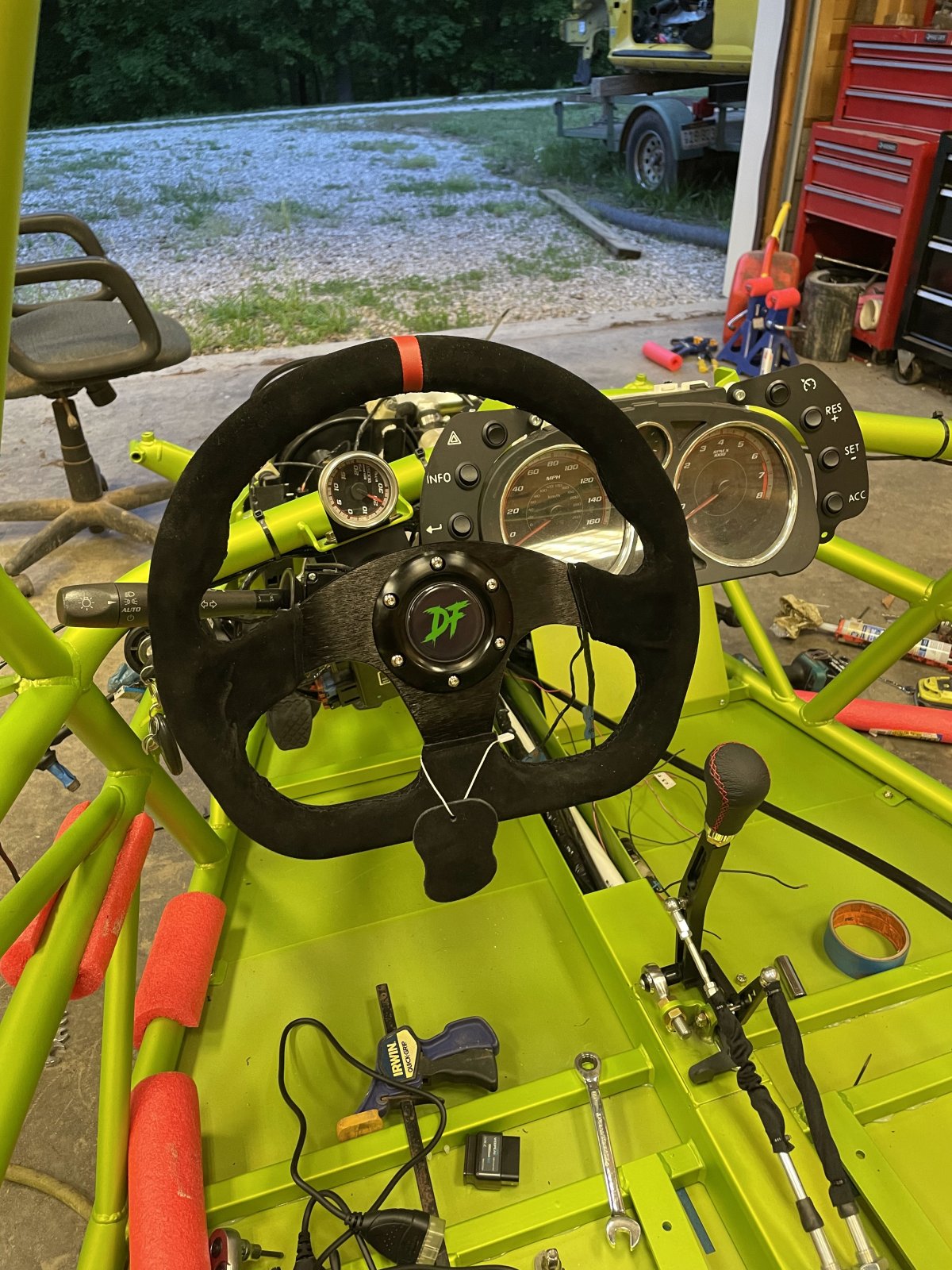

Shifter assembled, but I know have idea how to adjust and get it to function properly. I'm running the DF Shifter. Anyone have a good recommended buildlog to follow for adjust that?

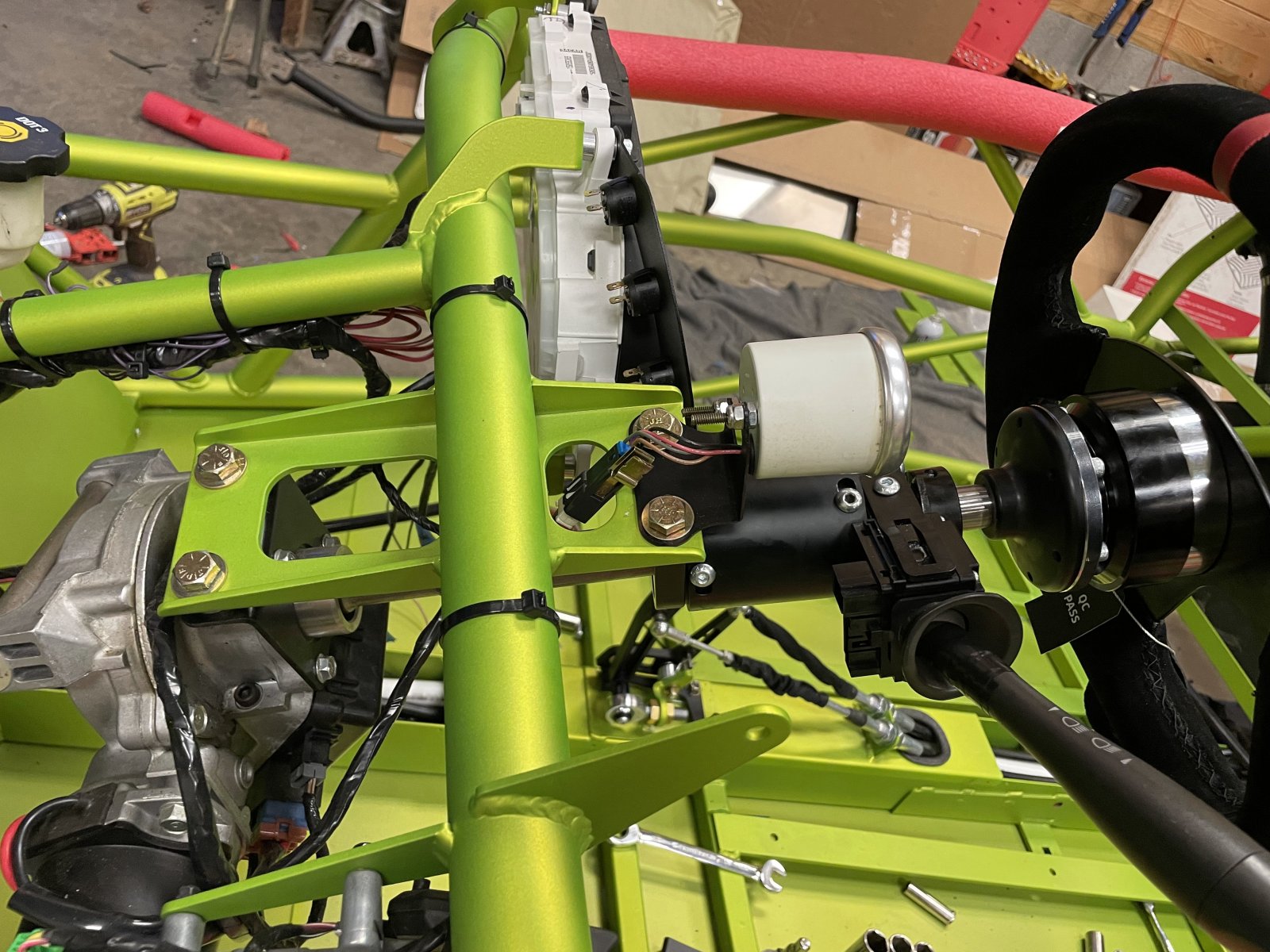

boost gauge installed, I'm a little curious how people mounted this. seemed obvious but the gauge is crooked. (Photo attached)

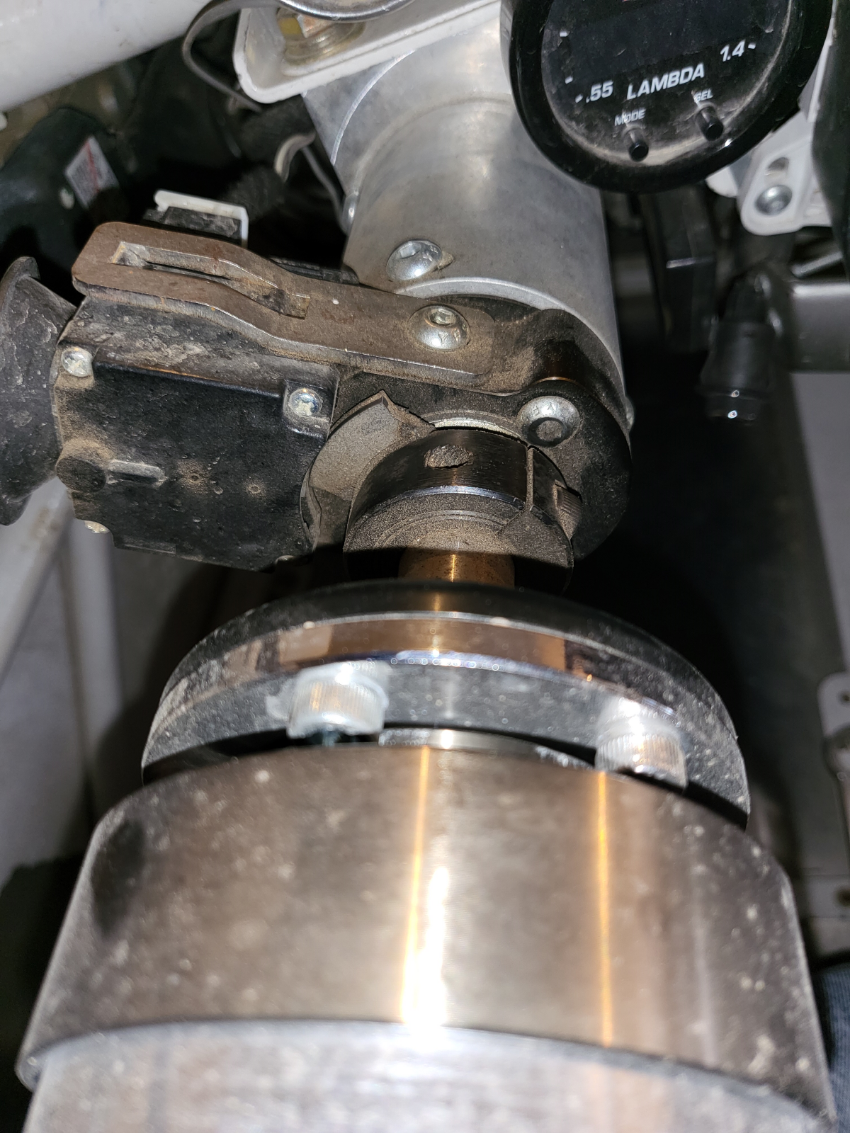

DF steering wheel installed, everything needs snugged up. I also added some spaced between the frame and the power steering pump mounting bracket to help the angle of the shaft through the front panel. I recall seeing photos of someone else who did that. Want to find that picture sometime and verify I did it the same way. (Photo attached)

As far as the shifter installation, a quick search - using the magnifying glass in the upper right corner - would get you to this thread that talks about the shifter (and parking brake handle).
The search function can also help locate several discussions about the steering shaft interference and what builders did to remedy this - some did firewall trimming and other repositioned the steer column.

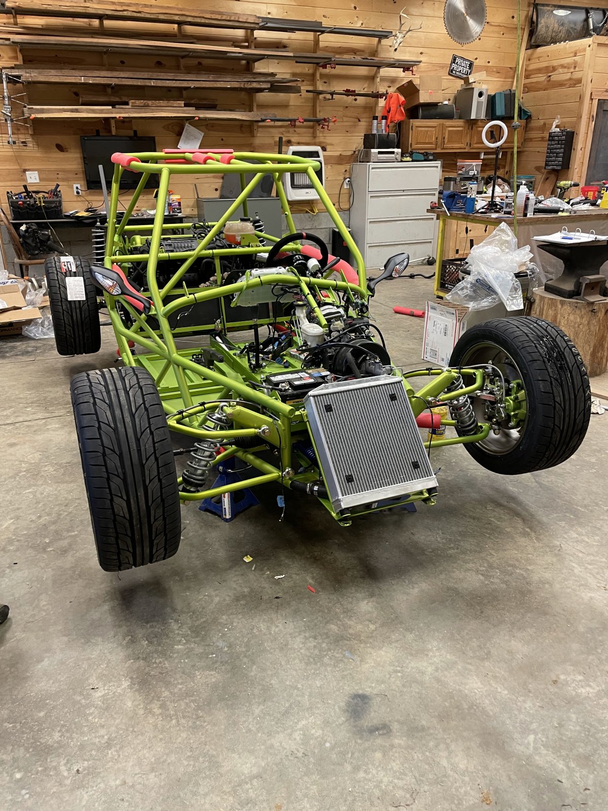

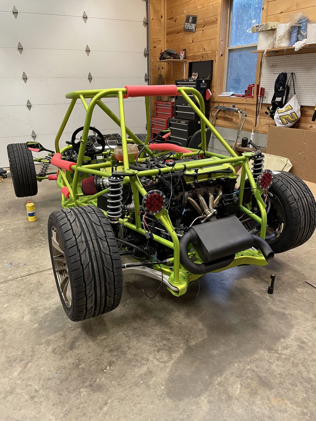

Update.
Purchased and received wheels and tires. Went with AVID1 AV20 Matte Bronze 17x8 front 17x9 rear. Nitto NT555G2 245/45/17 front, 275/40/17 rear.
Got brakes installed and proportioning valve.
Open problems
passenger mirror blinker works properly, drivers mirror blinker does not.
cooling loops are leaking slightly
brake pads from kit for front appear to be incorrect size
Next steps
bleed brakes and adjust shifter
wire rear brake lights and license plate light
Need to acquire rivnut tool.
begin the search for my Wing
start planning wrap
order headlights
