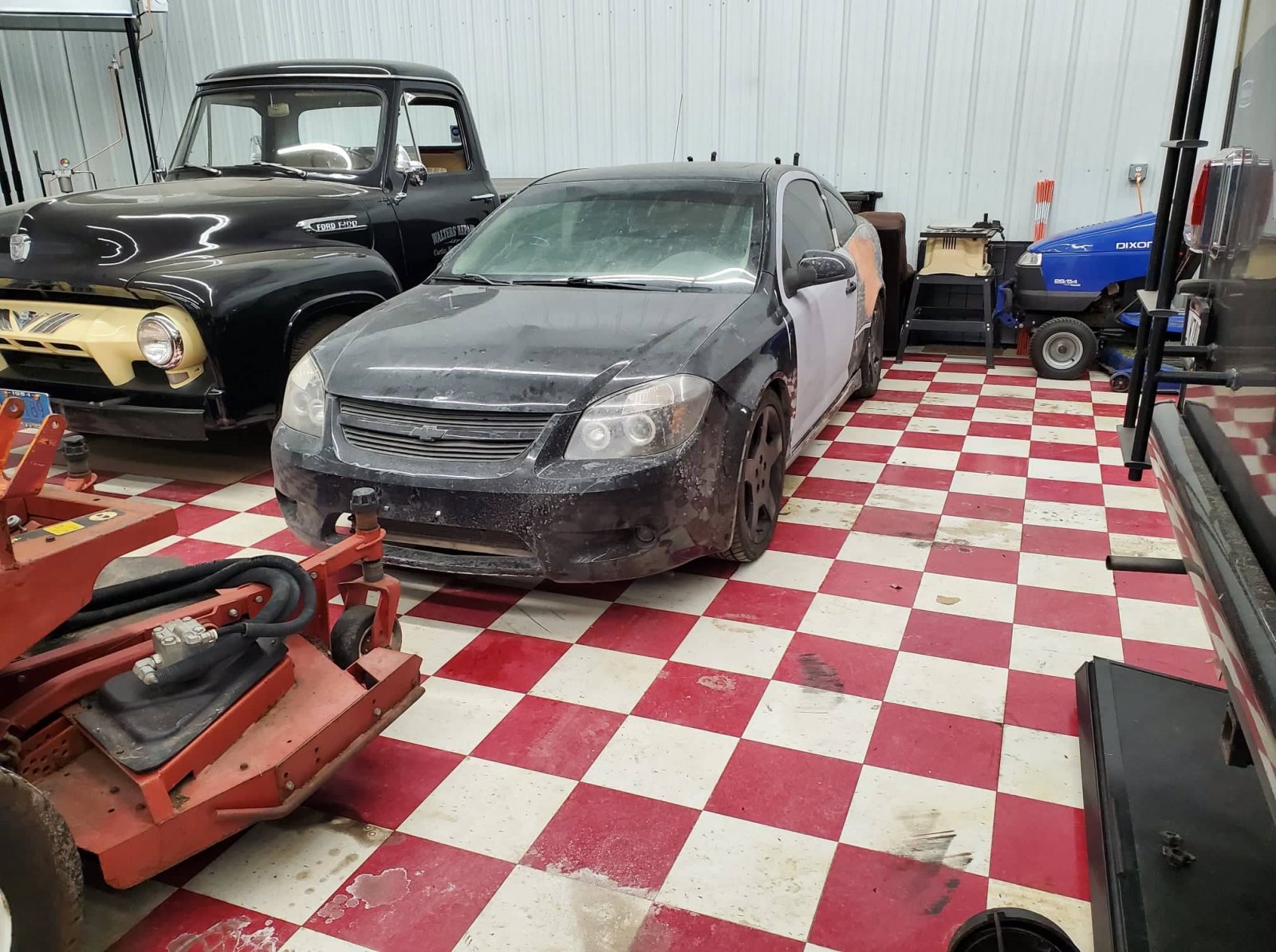

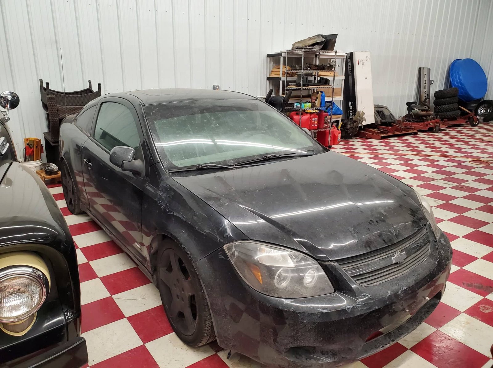

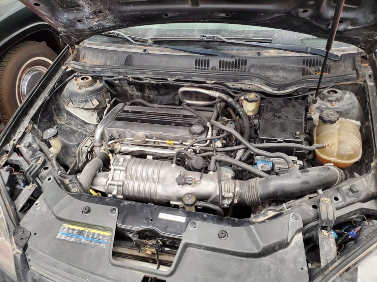

I had been looking for a donor for about 6 months prior to putting the deposit down on the kit. I had lost hope that I was going to find a good donor for a decent price, and decided to pull the trigger on the kit first and keep looking while the kit is being built. Literally 2 days after putting the deposit down, I found a 2006 SS/SC Donor with 140,000 miles for $1000. The car is in pretty rough shape on the outside, but the engine seems to be in good shape. I live in Wisconsin, so rust is something we have to deal with. I had already assumed that most of the suspension that was getting reused, would need to be purchased new. I am in the process of figuring out what needs to be replaced. The transmission is also something that may need replacing. The kid I bought the car from said it had issues shifting but he "fixed" it. I haven't driven it yet, so I am not sure where that stands.
I am considering doing a headgasket, timing chain, and dual pass while the engine is out, just for piece of mind. I have not started the disassembly process yet. I have a few projects in the garage I want to wrap up first, so I can give all of my attention to the kit car. I also want to drive the car for a bit, just to see if there are any other gremlins before I tear it down.

Welcome! That sure looks like a primo donor! Doing the dual pass while the engine's out is a no-brainer, as are the timing chain tensioner and timing chain guide bolt. I wouldn't recommend a head gasket unless you think there's a reason the motor needs it, but that's completely up to you.
devianteng
Welcome! Donor looks pretty good where it matters. I've been considering Kirkey 65's as well. I'm hoping to have my frame in the next few weeks so I can measure out for them before I order them. I'm really hoping they'll fit.
Like said already, dual pass is a must as well as updating the timing tensioner (really the whole kit if the car needs it).

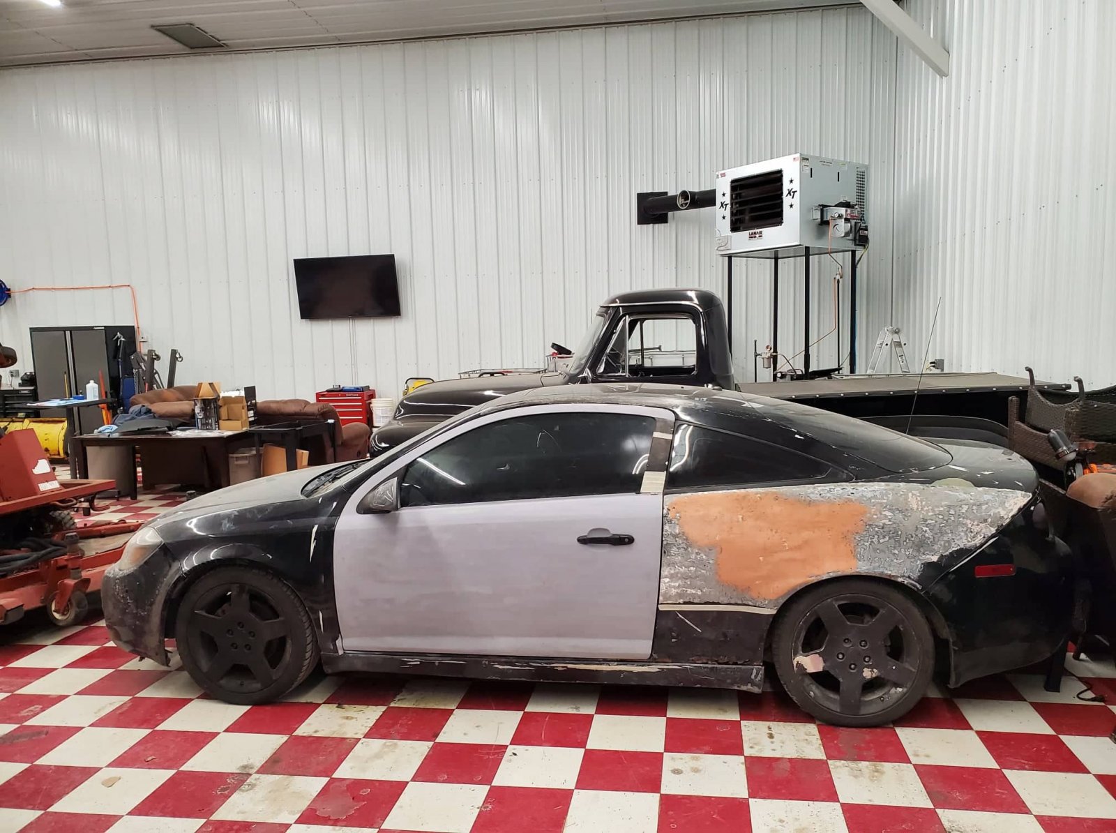

Jesse, welcome. Love the F100 also occupying the garage - and see 'Walters Repair' on the door, guessing this was your father's or grandfather's truck?

Your shop looks ideal for teardown - so git'r'dun!!!

That looks like a perfect donor.

Yes, the F100 was my grandfathers. He used to work on the assembly line at Ford in 1954, and really loved these trucks. He bought this one in the late 70's and did a complete restoration. He did everything himself in his workshop, I even remember helping him reinstall the front windshield when I was really young. He wanted to sell it as it wasn't getting driven. I couldn't let this one go down the road to someone else. Not necessarily my style, but I don't have the heart to change a thing. In my eyes, it's still his truck I am just holding on to it for him.
I also have a 78 Dodge D100 from my father waiting to get some love as well. Plan to drop a 440 in that one. I think the Goblin is going to come first though.

11 to 12psi is the stock boost on a supercharged LSJ. Sounds like you have a boost leak, or maybe the intercooler laminova tubes are plugged up.
You probably have some engine codes that need sorting out.
Could be the boost control solenoid. That’s the most common fault when it it flatlines at 4 psi. Mine did. Looks for codes
