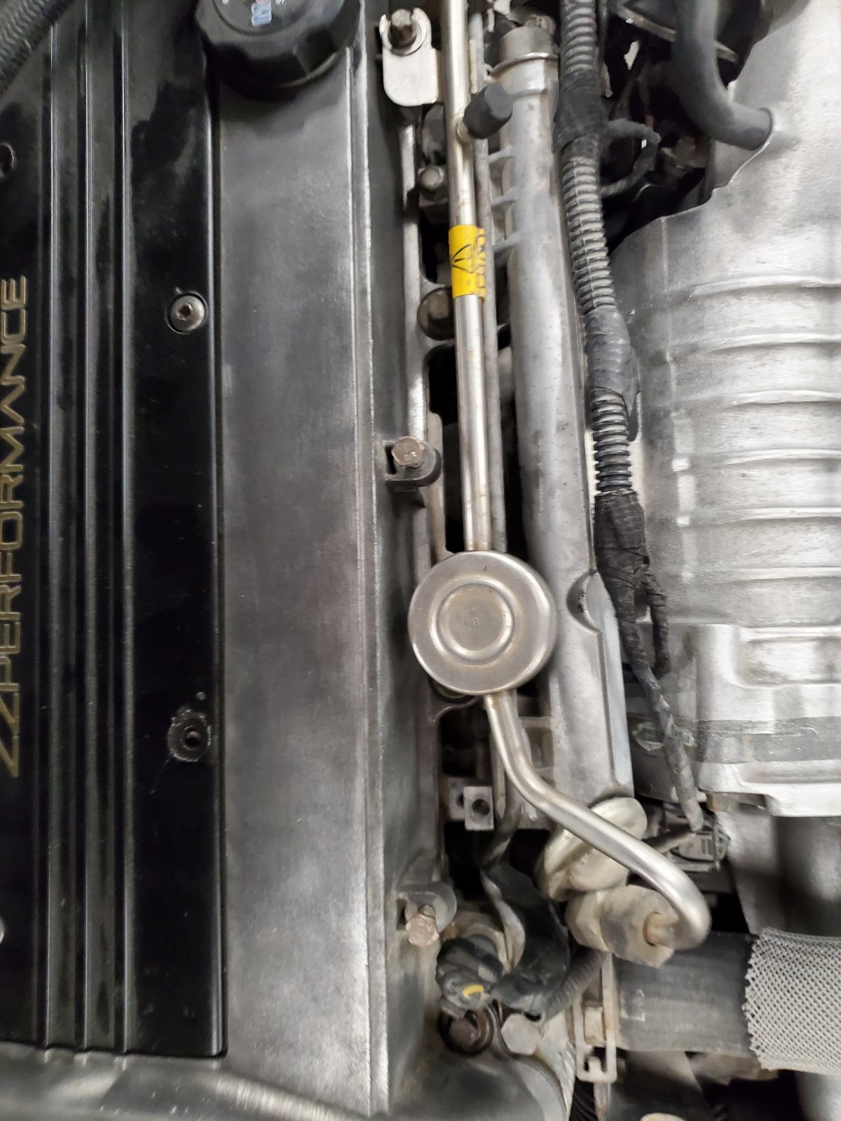

Fun new issue popped up now. One of the bolts came out of the fuel rail. Car runs pretty bad like that..... I actually had cylinder pressure blowing out the injector hole.
Prior to that, I did have some issues with the engine breaking up at higher rpms, but I'm wondering if it's related to the fuel rail issue.
I'll need to figure out what size bolt that is and try some loctite and go from there.

Ya. Replace that boost control solenoid. Common failure
you should be able to find a matching bolt in your doner stash. At least something that will work. Get that all back together and see how it runs before diagnosing any further.

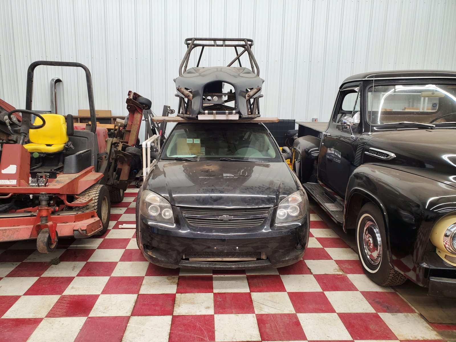

It's been a long time since I posted.
Did receive everything though so I figured I would post an update. I can't say enough about how great Stewart Transport was to deal with, especially considering the cost to deliver.
33972
The donor car hasn't been touch yet. I need to start with stripping that down, and then attack the wiring harness.... The harness legitimately concerns me, which is why I have been procrastinating the tear down.
I am also trying to wrap up all of my other projects, so I can completely focus on the Goblin.

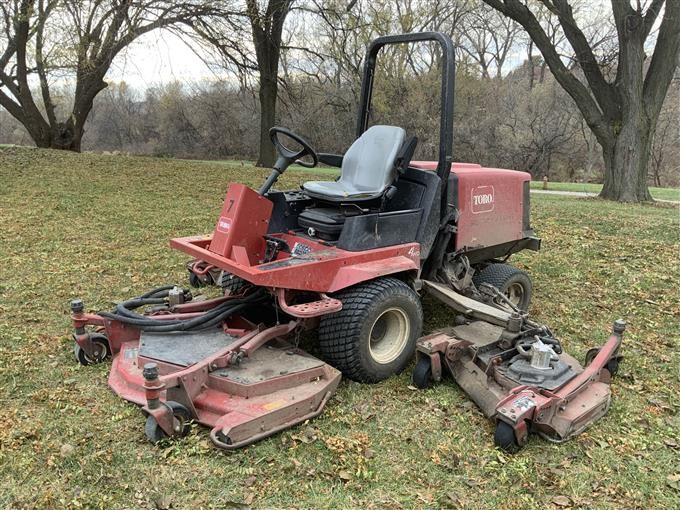

I managed to get my mower finished. May not sound like much but this has been almost a 2 year project. I ended taking 2 parts mowers to make one. I have about 8.5 acres to mow, and can now mow it all in about 2 hours.

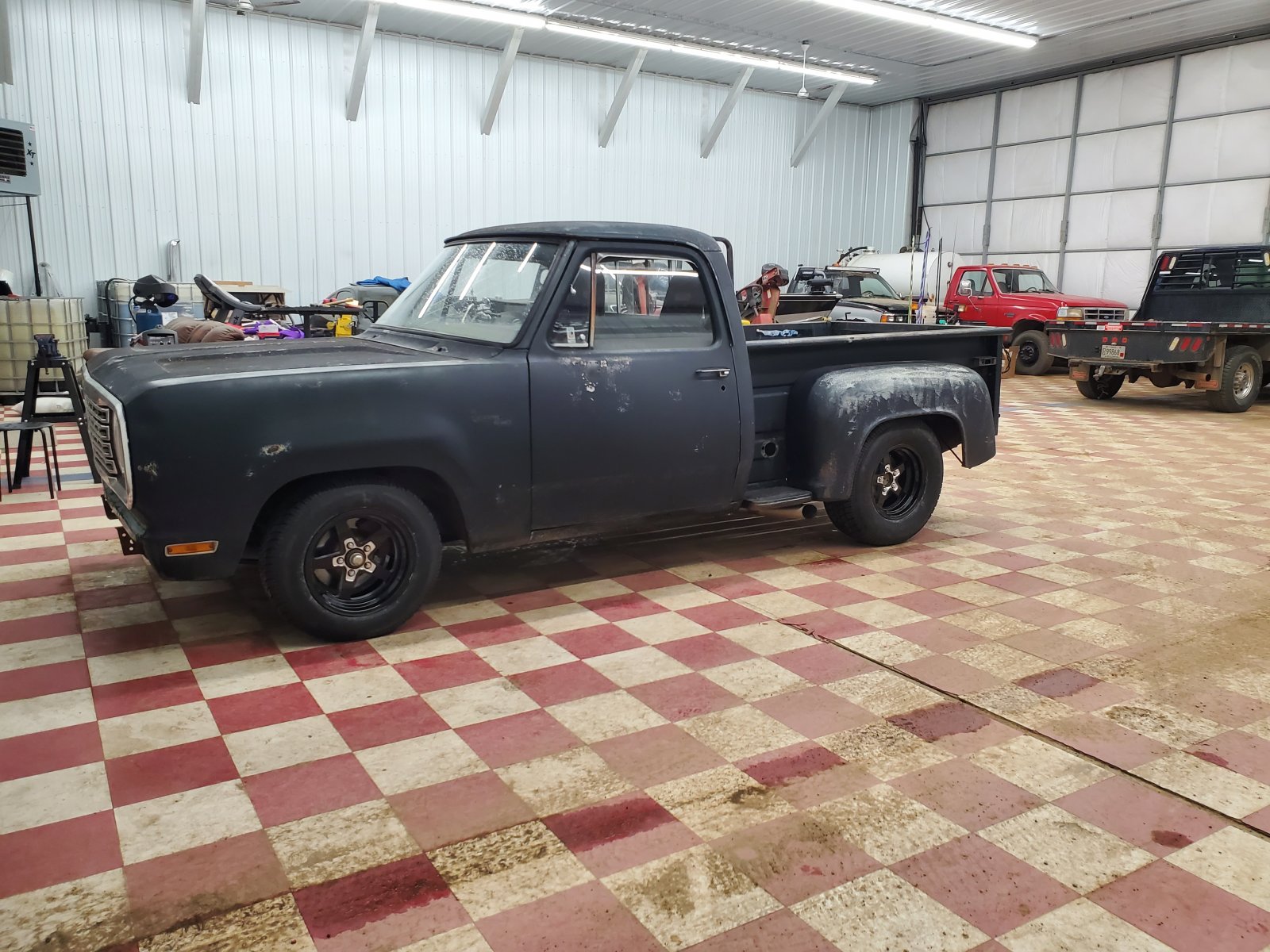

This is my current headache. I am trying to make it my daily so I can stop putting miles on my F150. It's been sitting for 10+ years, and has some gremlins. Once this is wrapped up, I can start on the Goblin

I agree with you on Stewart Transportation, the delivery guy was super nice. He let us take all the photos we could during the unloading.
That shop looks great, so much room for activities.

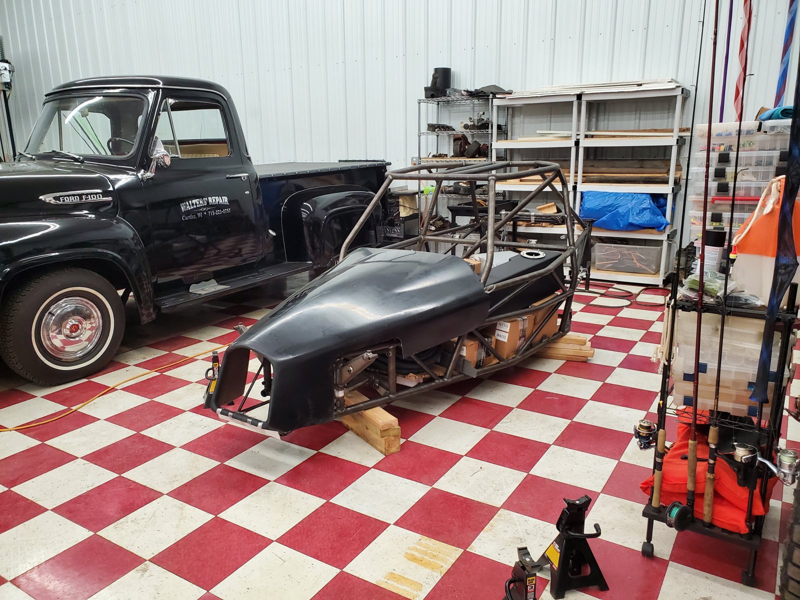

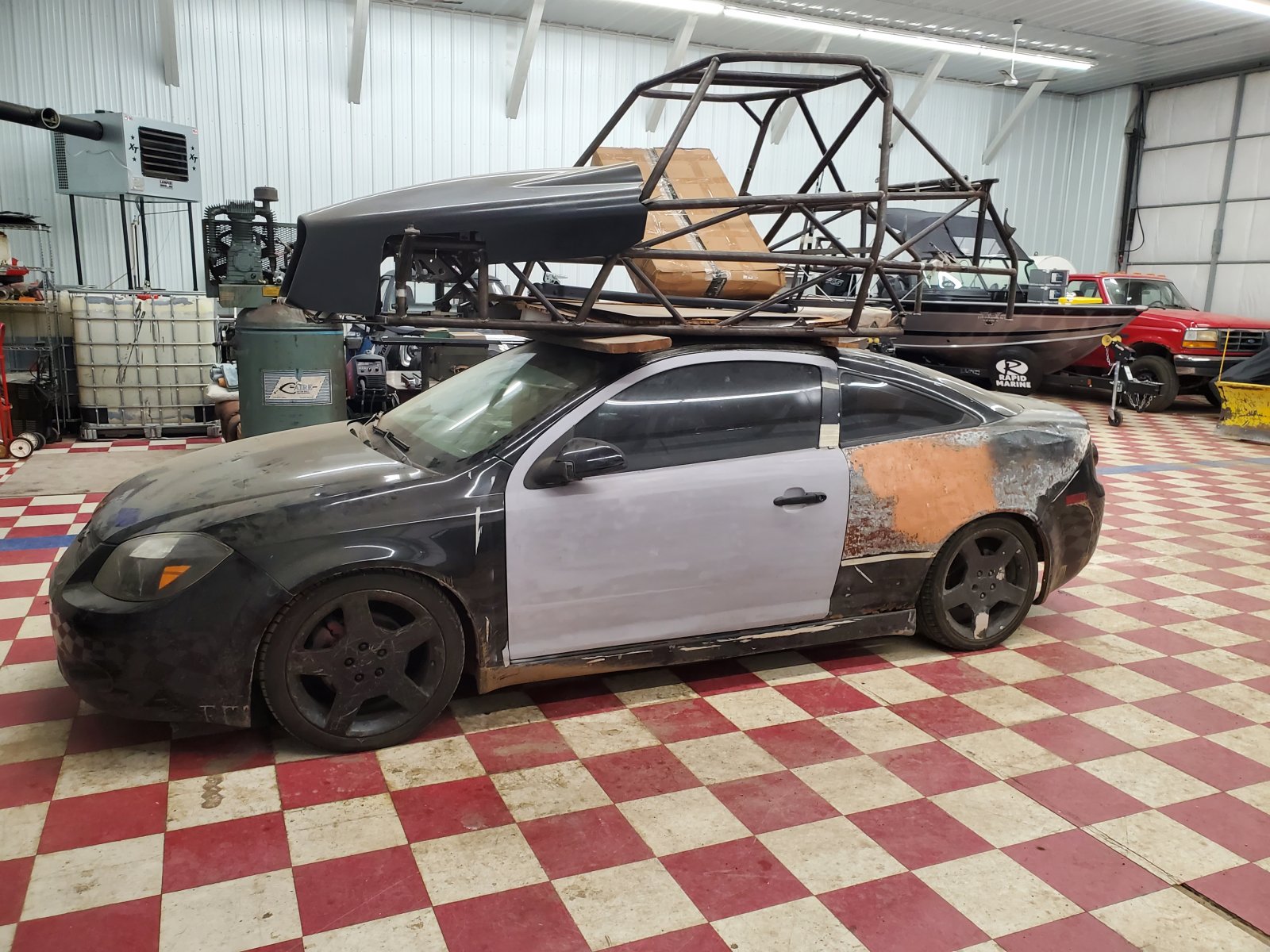

I am finally ready to start the teardown on the donor car now. At this point I need to watch most of the videos over again and comb over the forum, to remember what I need to be doing.
In case anyone is wondering, the donor car makes a good storage location for the Goblin chassis for long term storage :D

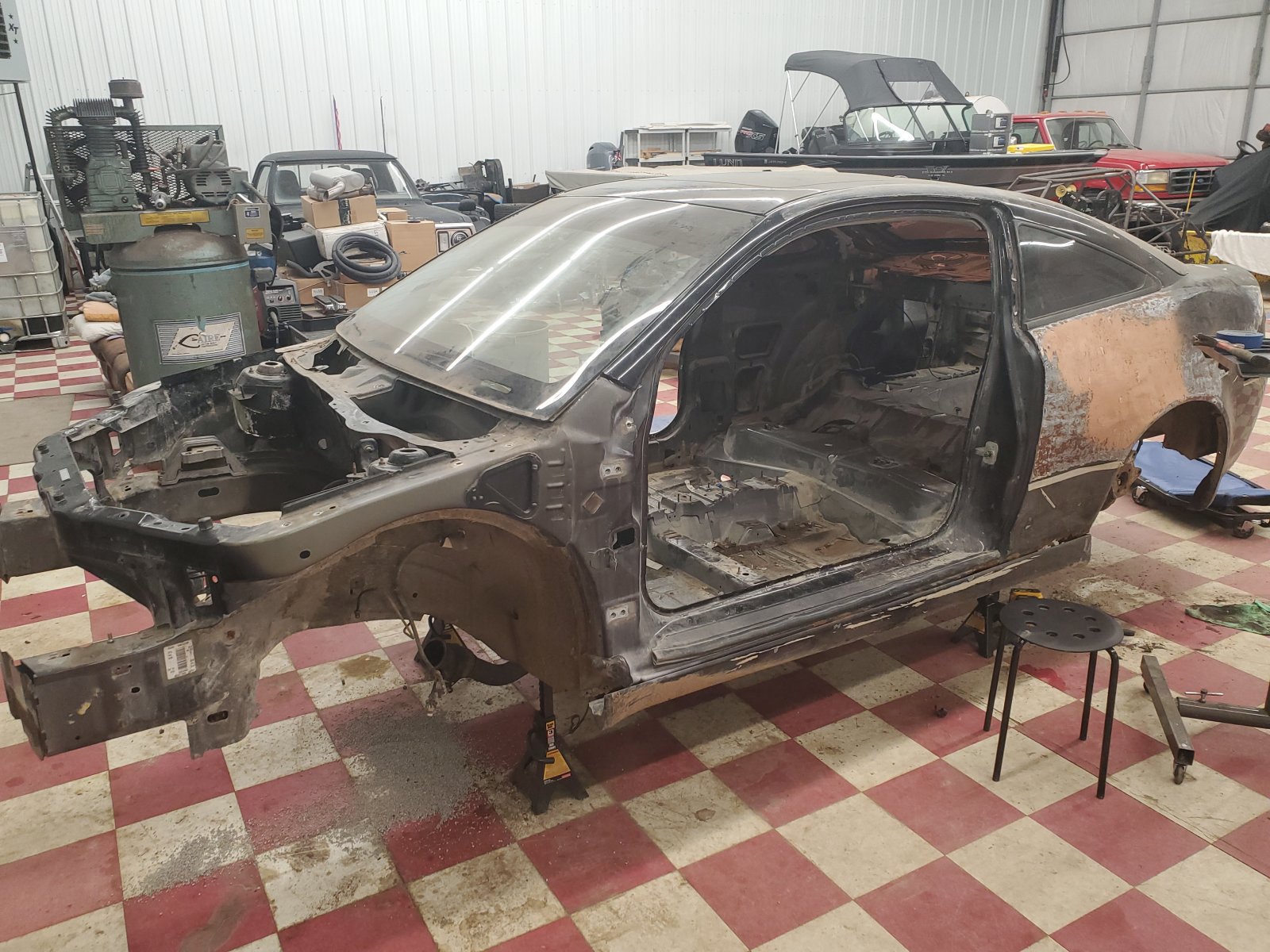

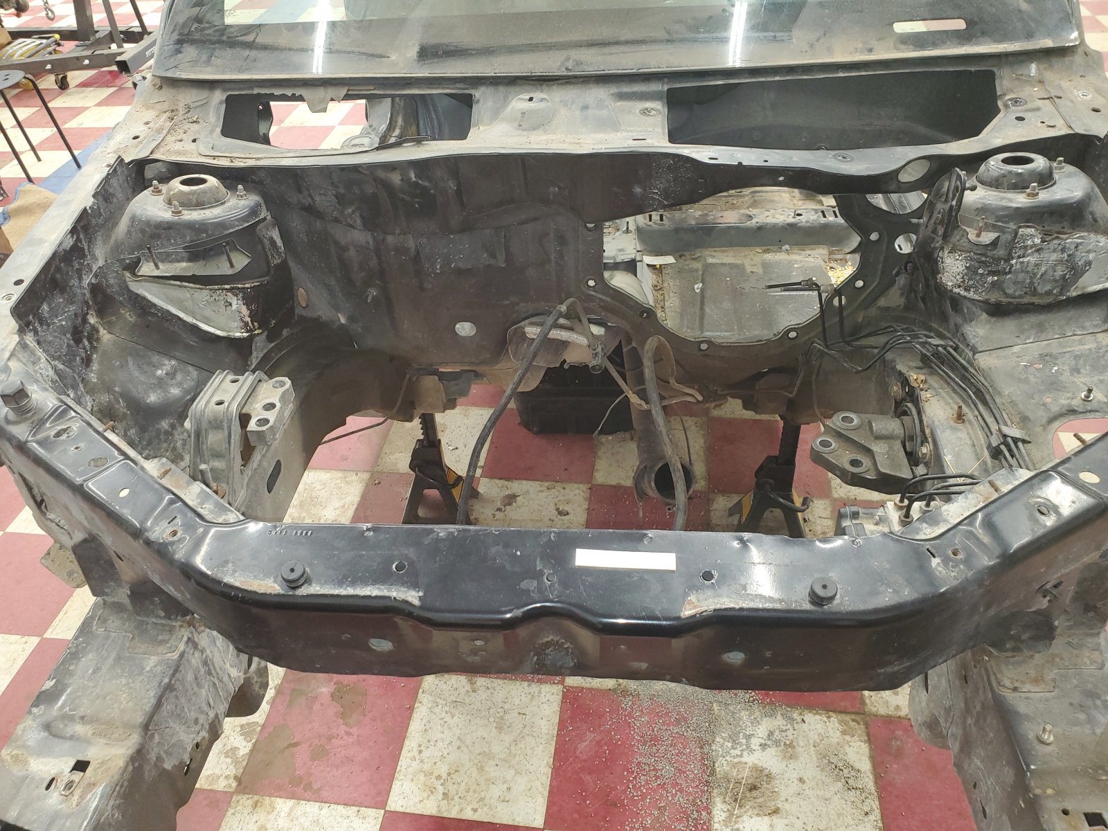

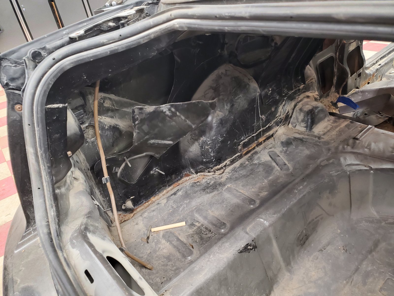

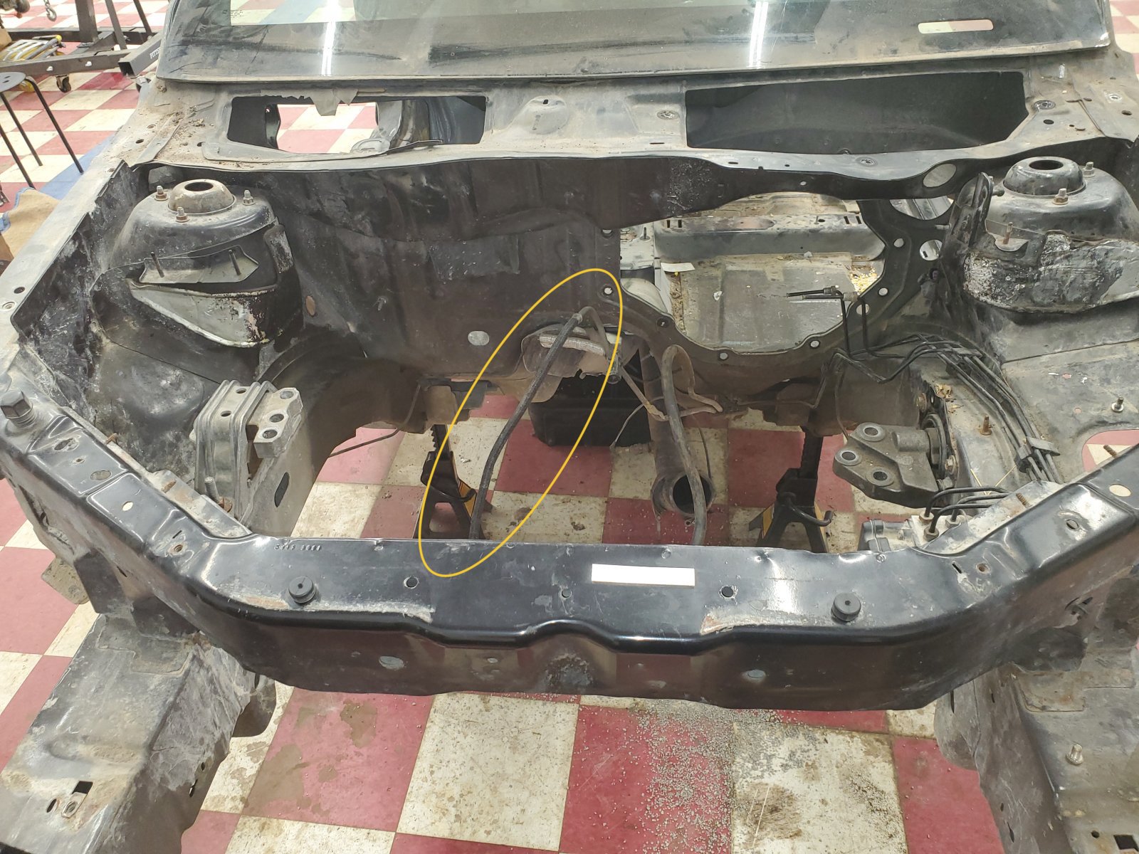

Update.

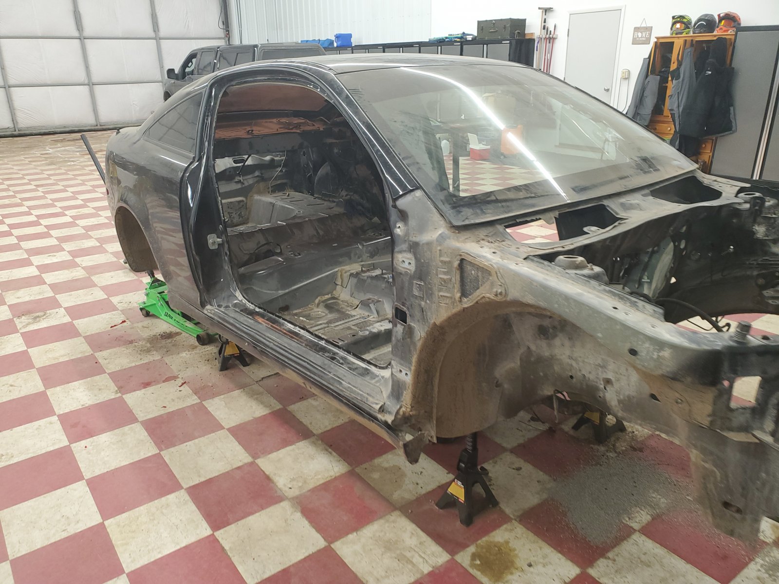

I made a lot of progress last week on stripping the donor. Only thing I have left to do is drop the fuel tank. Overall the stripping process was surprisingly easy. Only surprise I had, was forgetting to discharge the low pressure side of the AC system. It was a bit shocking when I pulled the bolt on the condenser. Being that the car was from the Midwest, I encountered typical problems associated with the rust belt. Nothing too crazy except for the rear hub on the driver side. It was only held on by 2 bolts, one which broke as soon as I went to loosen it. So it's a good thing I didn't do much more testing. I also found out that there was no filter or lid on the airbox, so another good reason I didn't keep testing. I have said it before, but the previous owner did some questionable things with this car. When pulling the engine I could tell it had been removed previously, they even had mismatched hardware for the motor mount bolts. In the last picture you can see where they cut a random piece of sheet metal support in the trunk for some unknown reason. It's a good thing this car is off the road.
So after I pull the tank, the donor will be getting pushed outside. Then I will be tackling the wiring harness, which has always been my biggest concern with this build. When stripping the donor I did label every single electrical connector I came across, so hopefully that will make things a bit easier.
I will also be doing a leak down on the engine as it has 140,000 miles. Pending those results I'll either clean it up and swap the trans, or start rebuilding it.

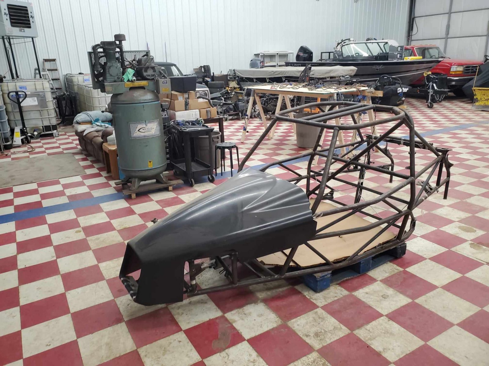

The donor car is pushed out of the garage, and the Goblin chassis has been moved into the work bay. I have started working on the wiring harness. I have completed thinning out the harness, but I have a few left over connectors I am not sure about. I create a second post to address the wiring questions.

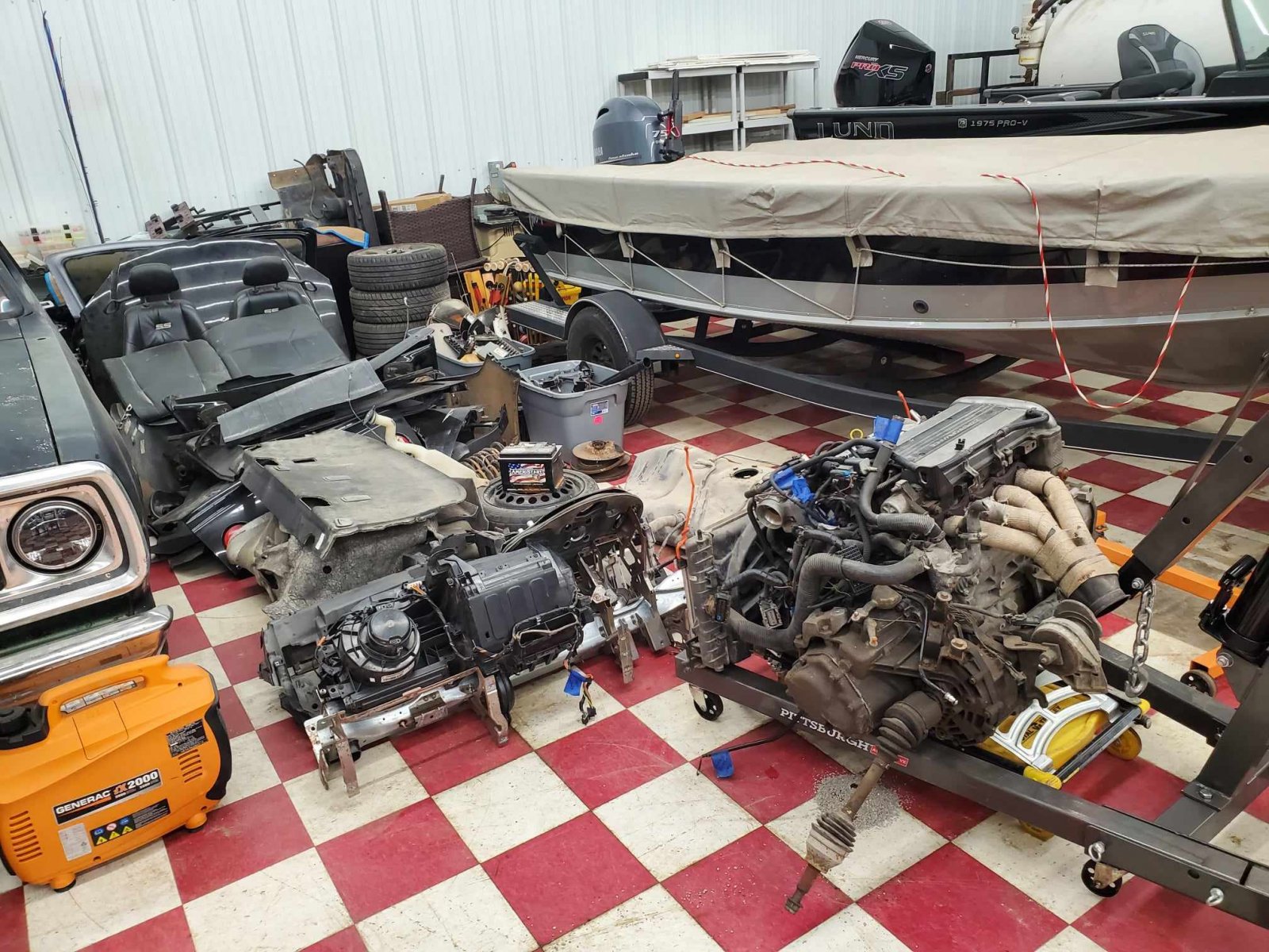

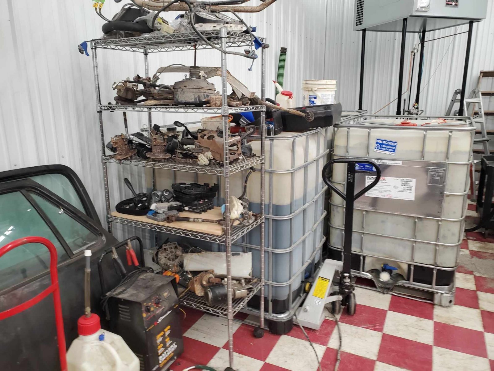

Minus the drivetrain these are the parts not needed for Goblin. I will be keeping these until I finish the Goblin just in case I forgot something.
45246
These are parts going on the Goblin. Being that it's a rust belt car, I'll be replacing a lot of the exterior parts.

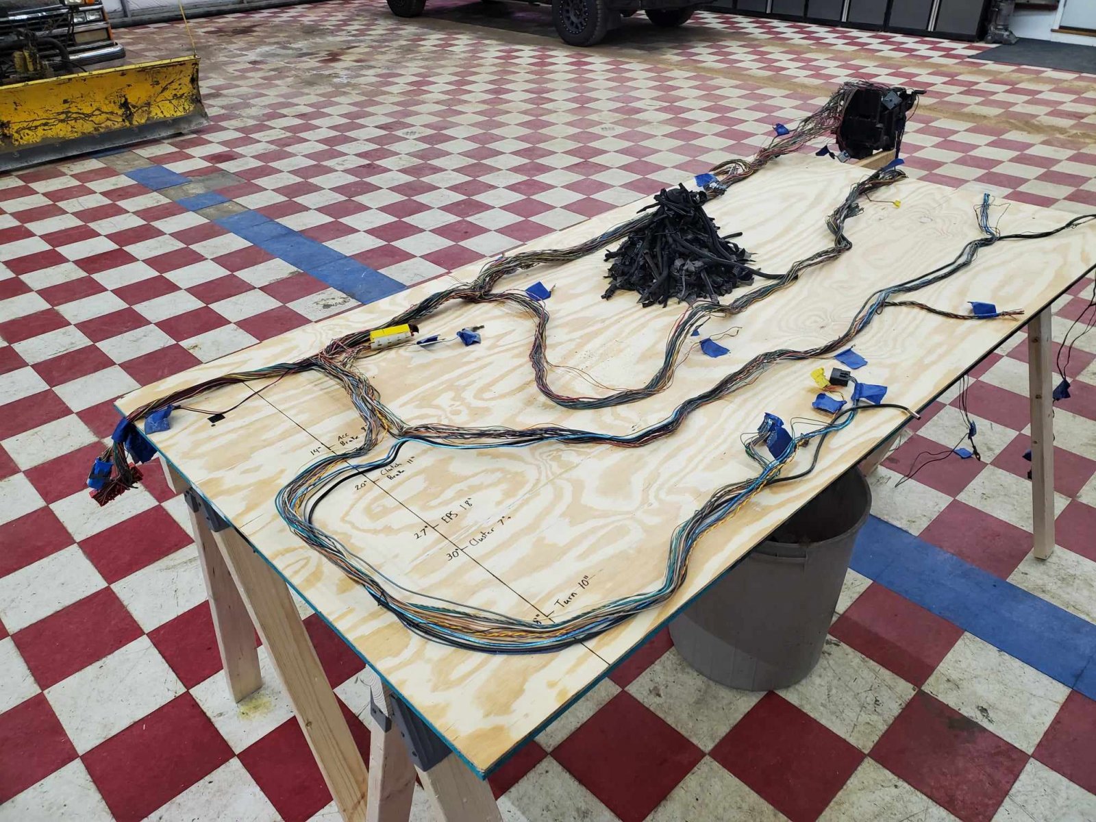

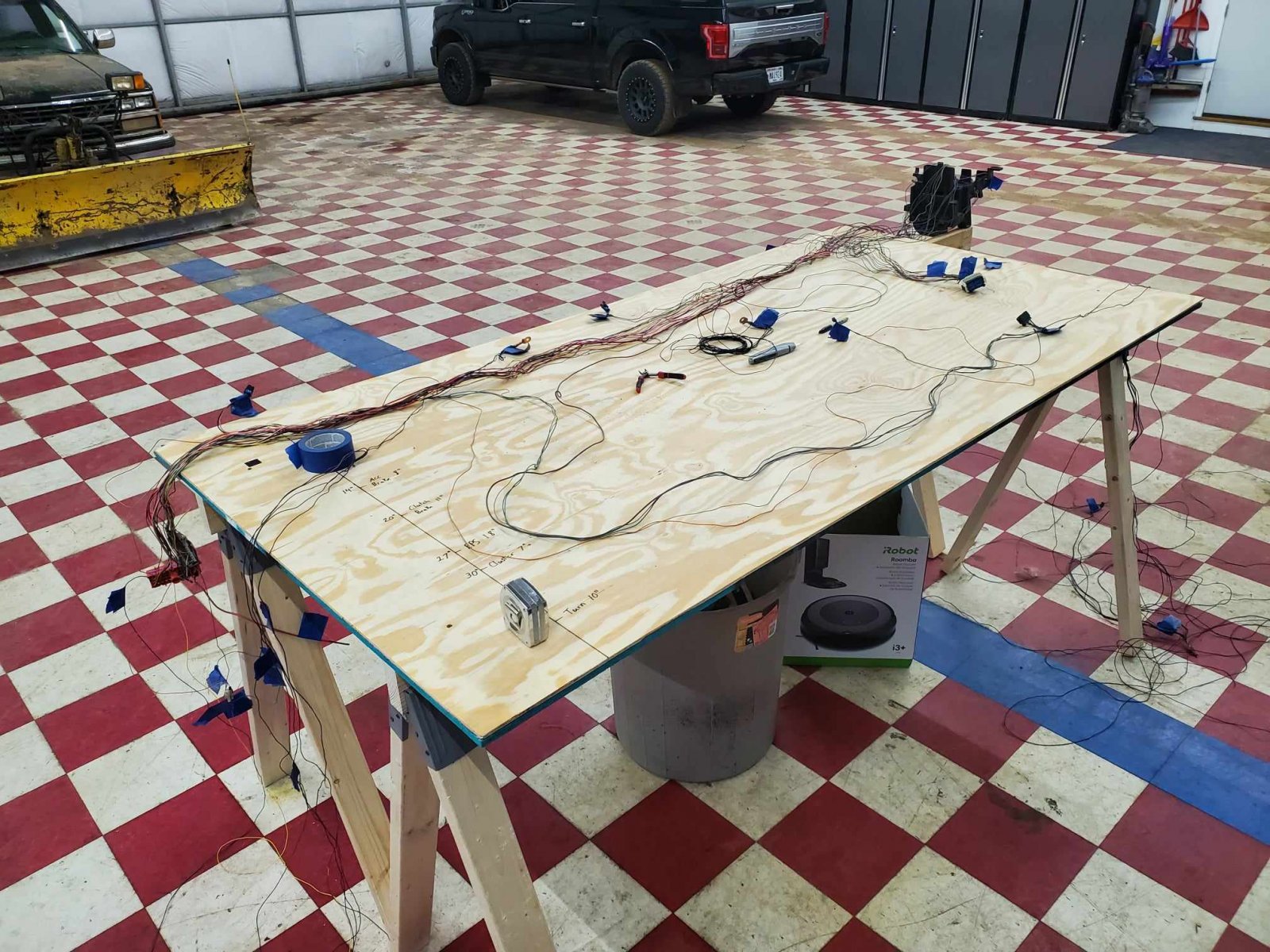

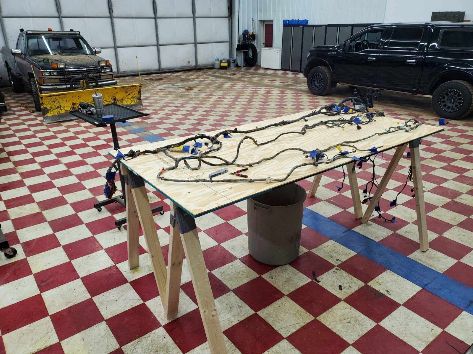

Built the wiring table and got everything laid out.
45248
Wires stripped. Rubber gloves were a necessity for this step.
45249
Thinning of the harness complete, minus a few straggler connectors.
