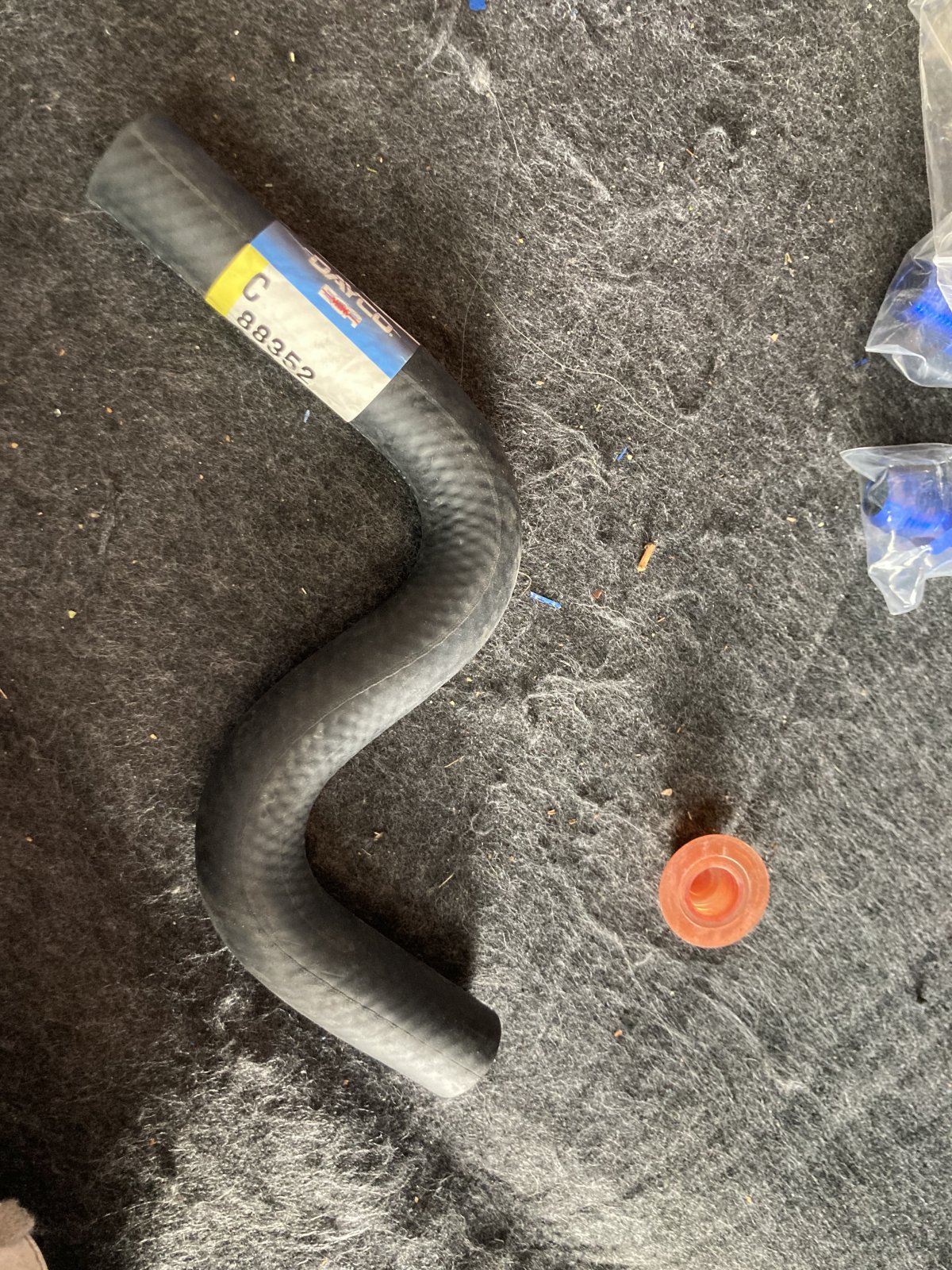

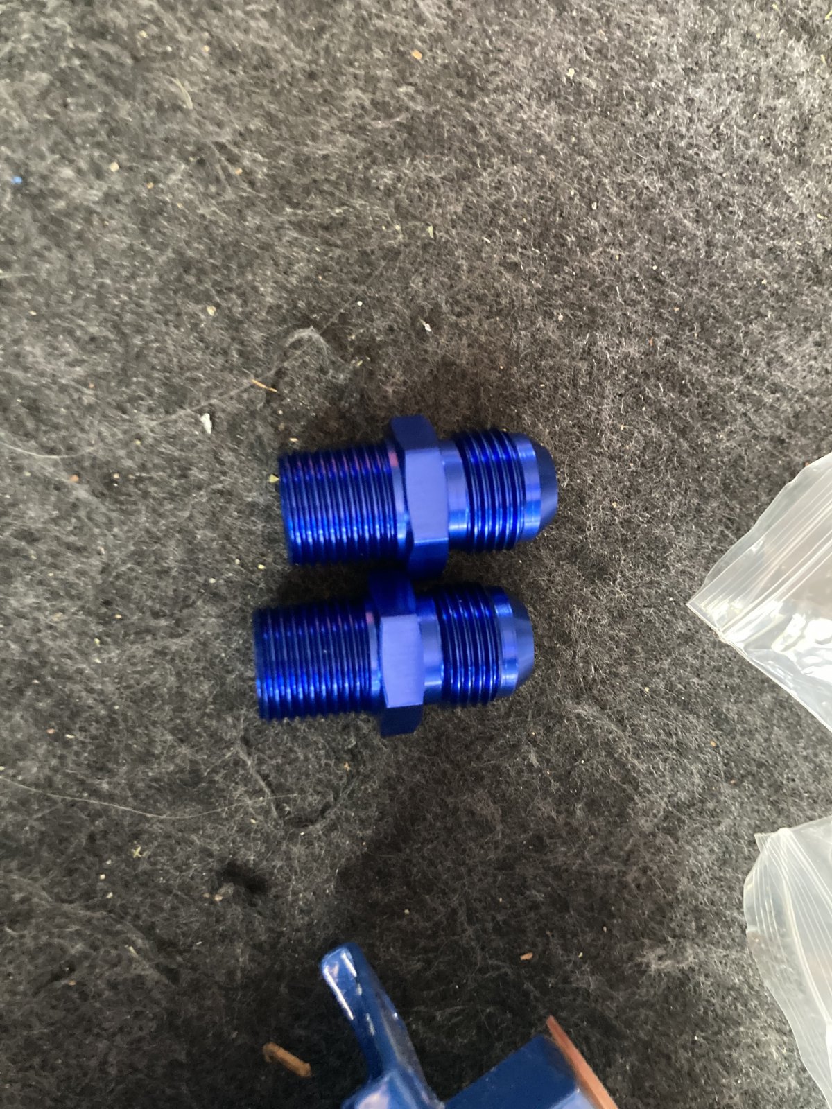

What do these go on?
35913

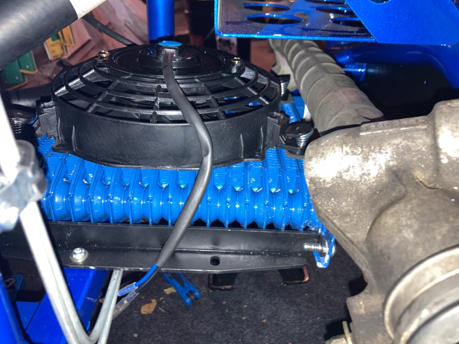

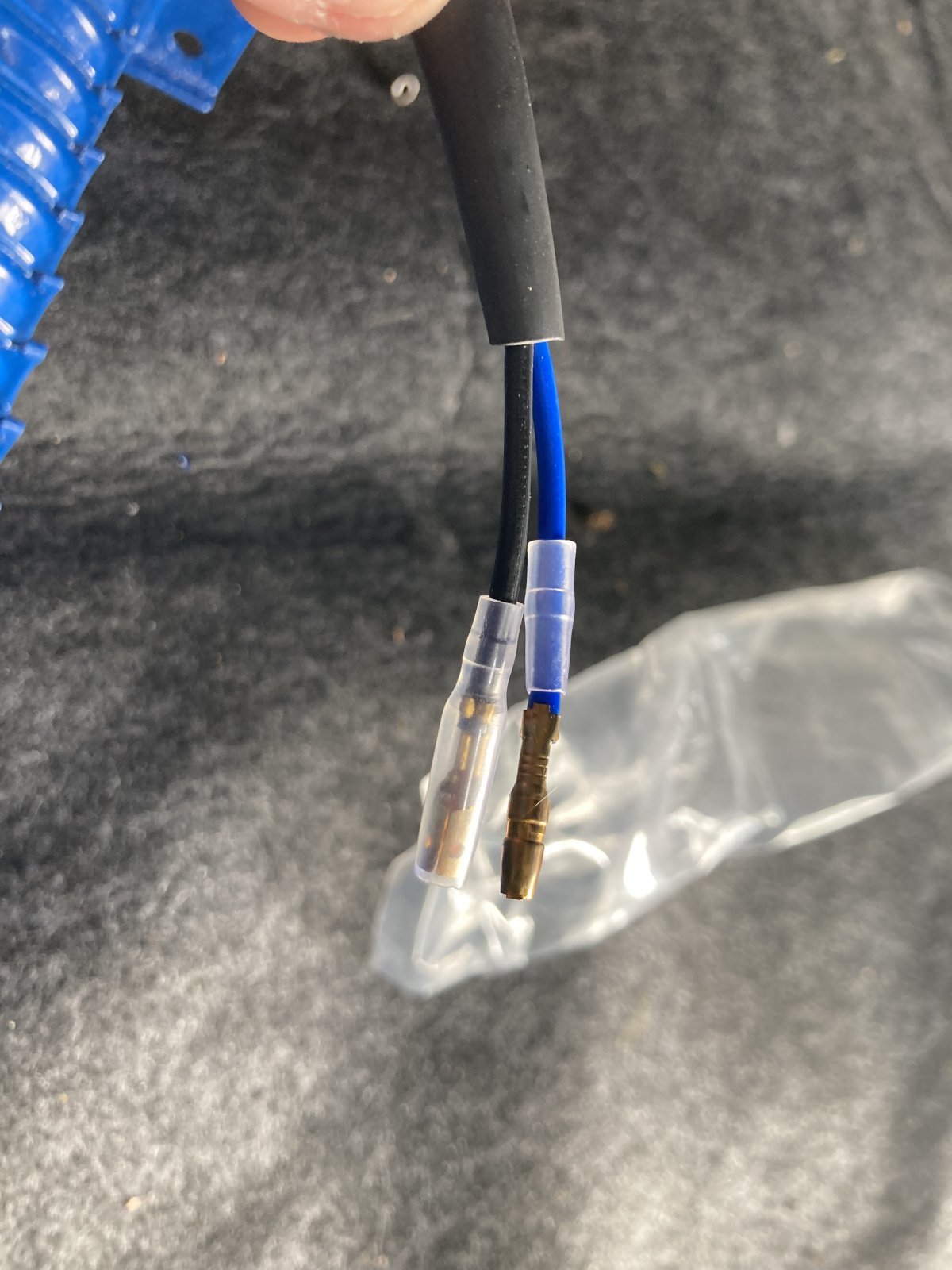

Do I need to change the fan connection for the heat exchanger?

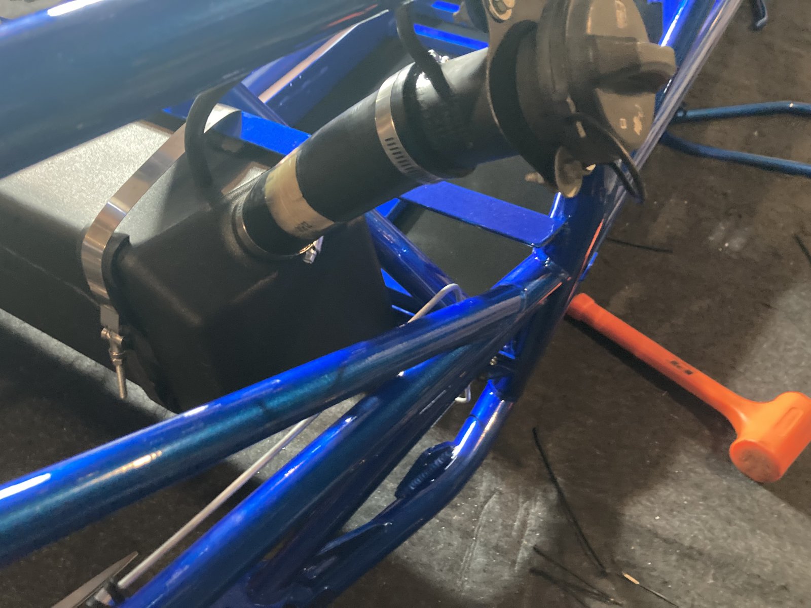

I am assuming I cut this tube in half to create the connection between the heat exchanger and the plastic tubes, is that correct?

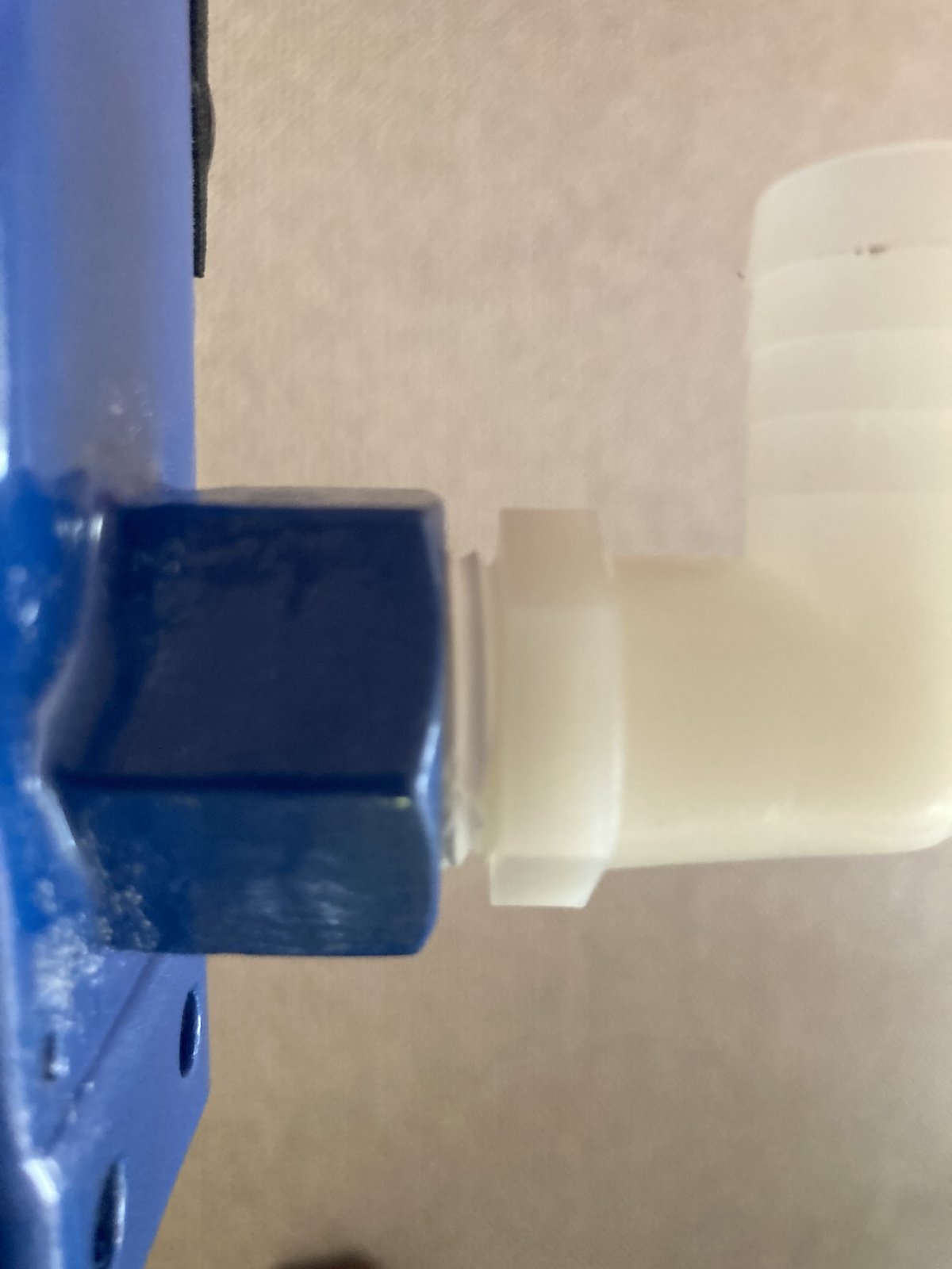

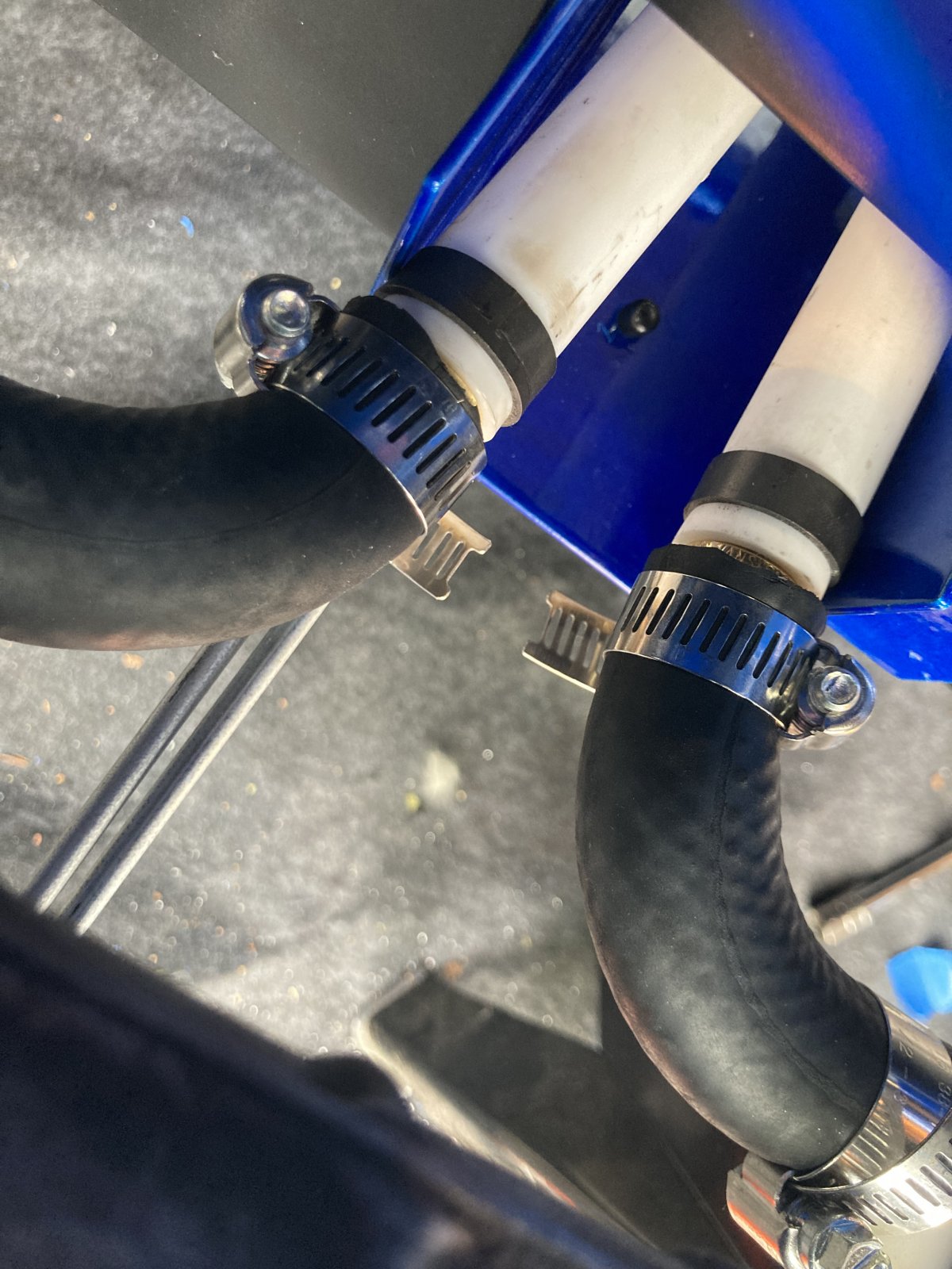

Is this far enough and will it leak? There is about 3 raps of Teflon tape around both connections.

1) They came with the heat exchanger, you won't use them.
2) You have to connect the positive on the heat exchanger fan to the ignition power line you ran for it. You'll ground the negative on the frame nearby.
3) Correct, cut that hose in half.
4) That may or may not be enough. Mine leaked no matter what I did, until I switched to a liquid thread sealant.

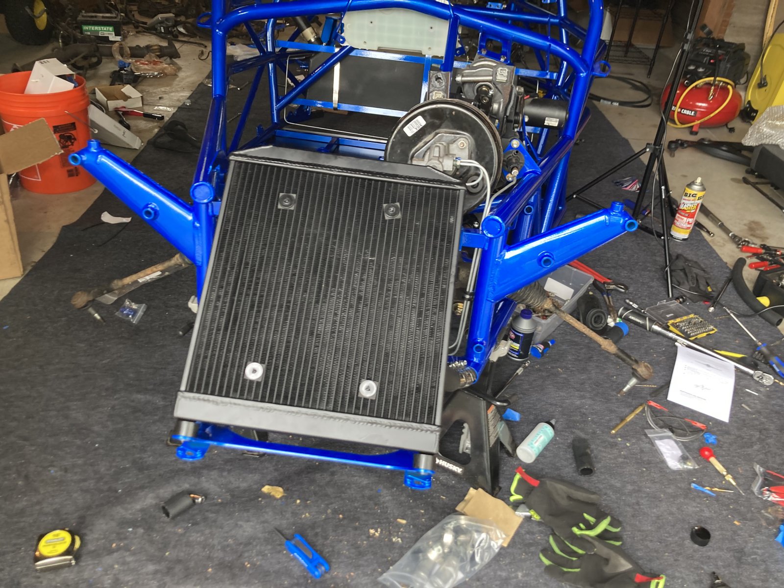

Got both the radiator and heat exchanger installed:
35918
35919
35920
I was wondering if anyone knew if the wiring harness service did the other end of the wires for the heat exchanger and radiator fan?

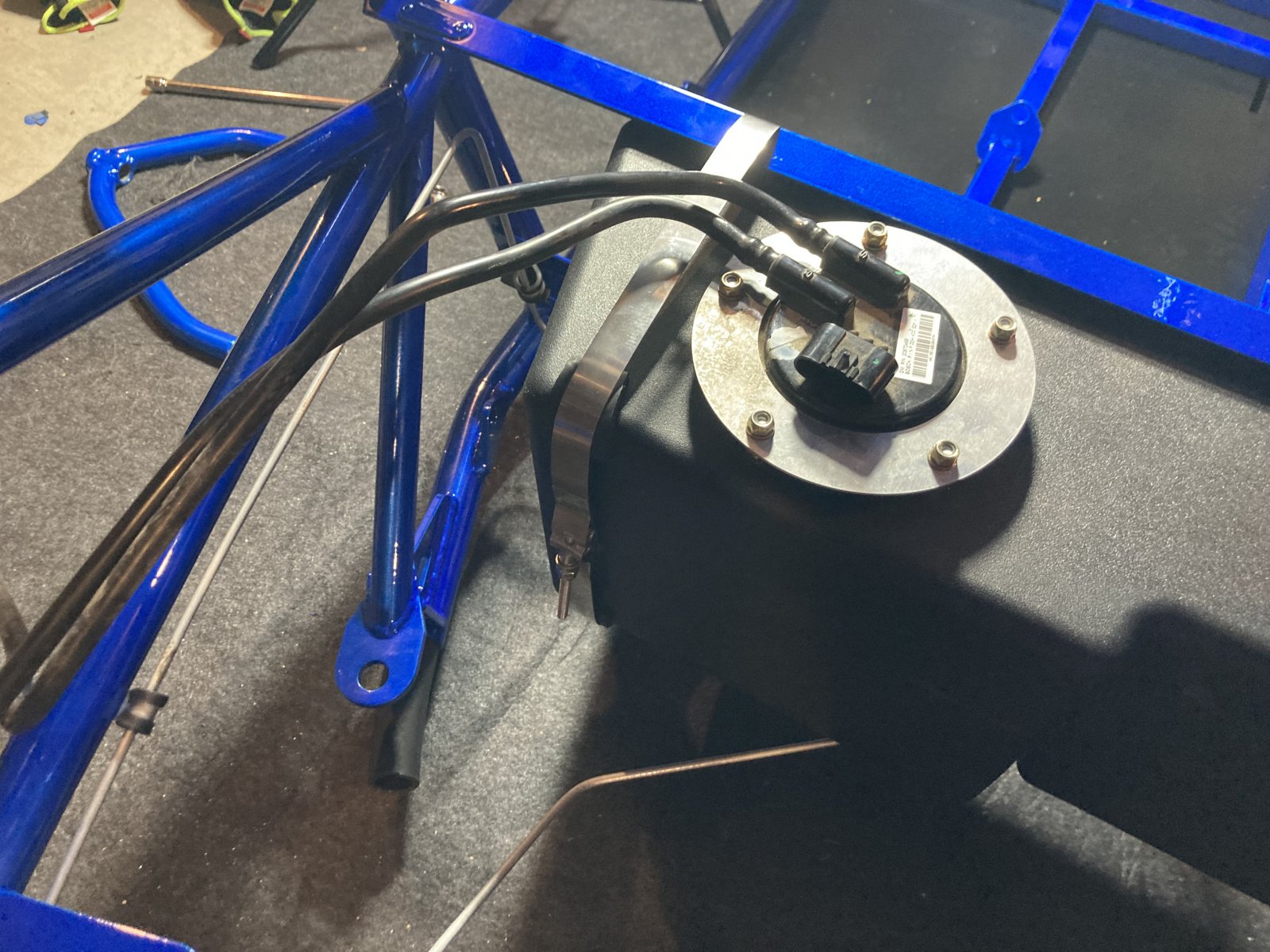

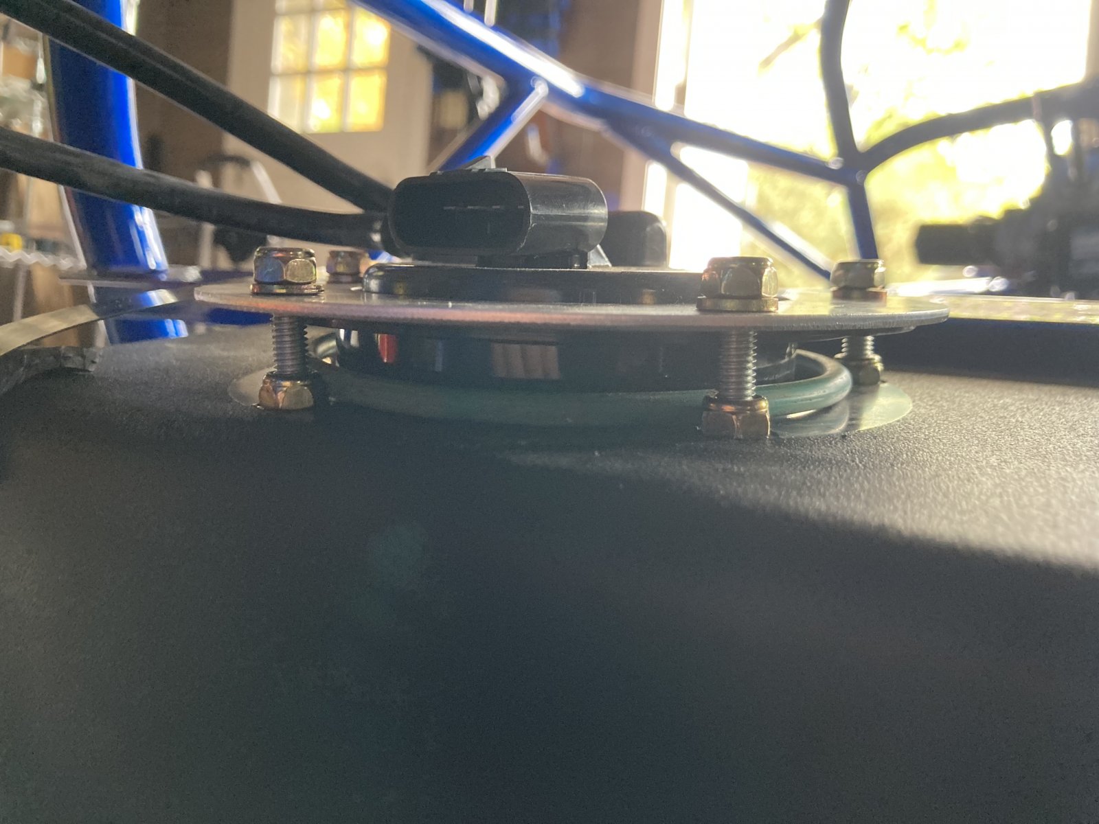

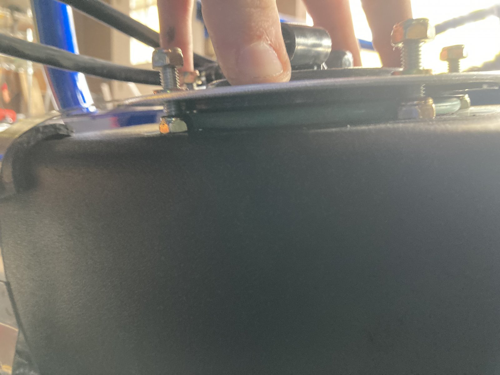

I also put in the fuel pump but I think there is an issue with it. When I push it down it springs back up, here are the photos illustrating how far I can put it down and then it will spring up after that. (Not sure if that makes sense):

Will it be sealed if I just install it like that?

The fuel pump body has springs to push the sump/pickup to the bottom of the fuel tank. The metal flange needs to be tightened down so the gasket is compressed to leave about a 3/16 to 1/4 inch space between the bottom of the flange and the top of the fuel tank - about the thicknessof the nuts. This will ensure the gasket is not over compressed.
My fuel pump also sprung up a little. I just forced it down and bolted it into place.
I cut my fuel neck line like the vide and wish it had been about 4 inches longer. It sealed but the area further down would have filled the hose better.

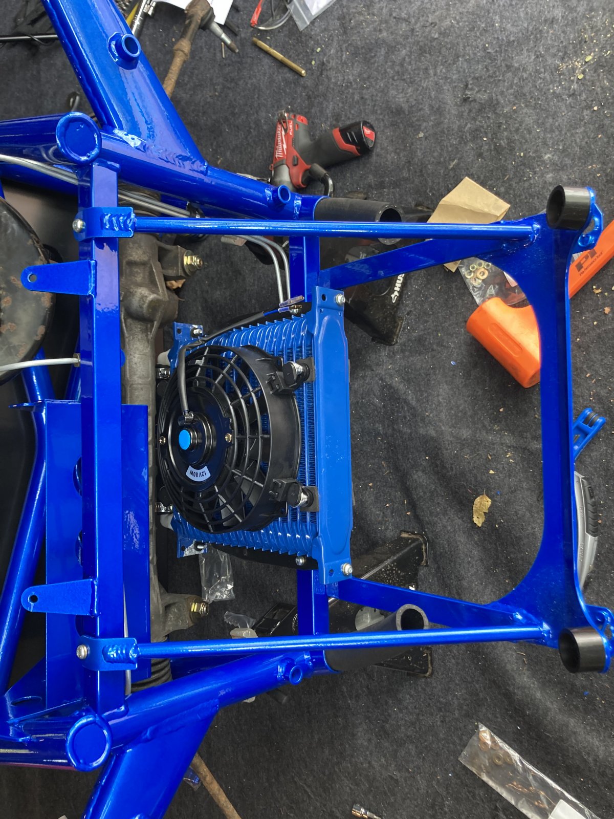

I started off by doing the entire heat exchanger setup on the front end, still need to do the wiring for the fan:

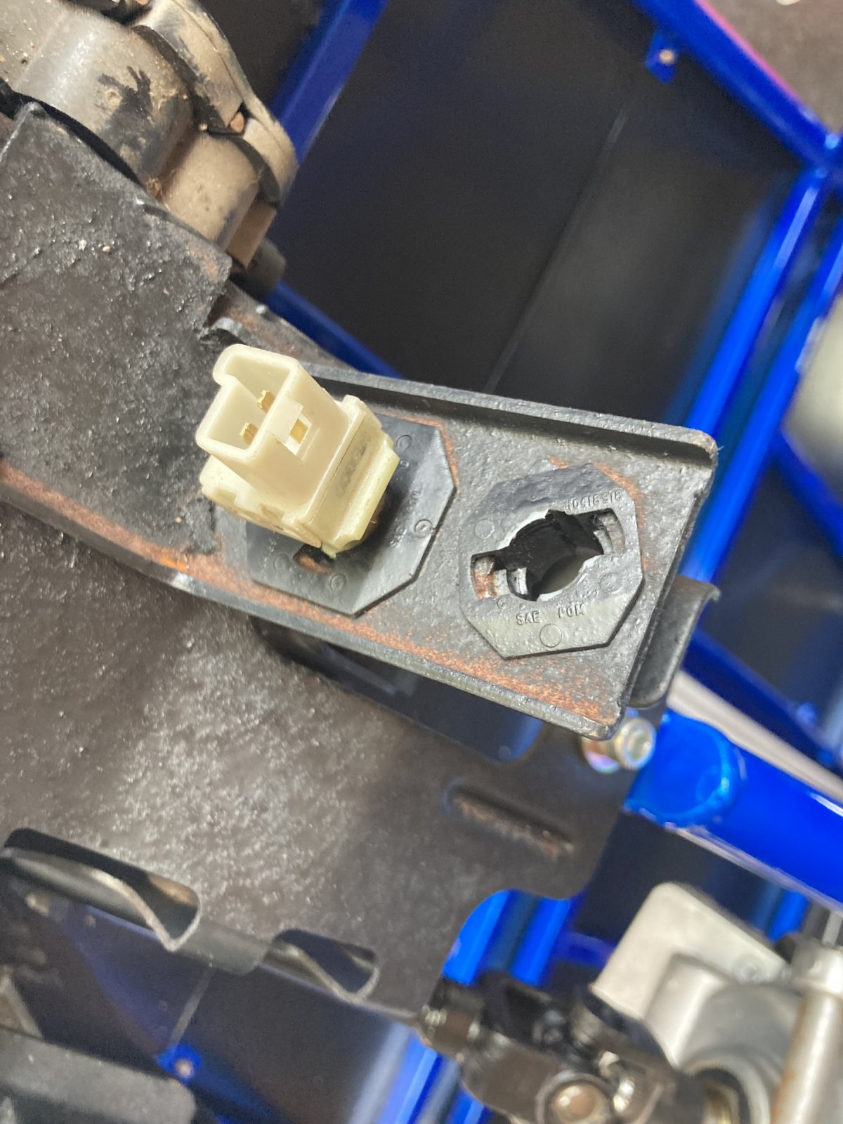

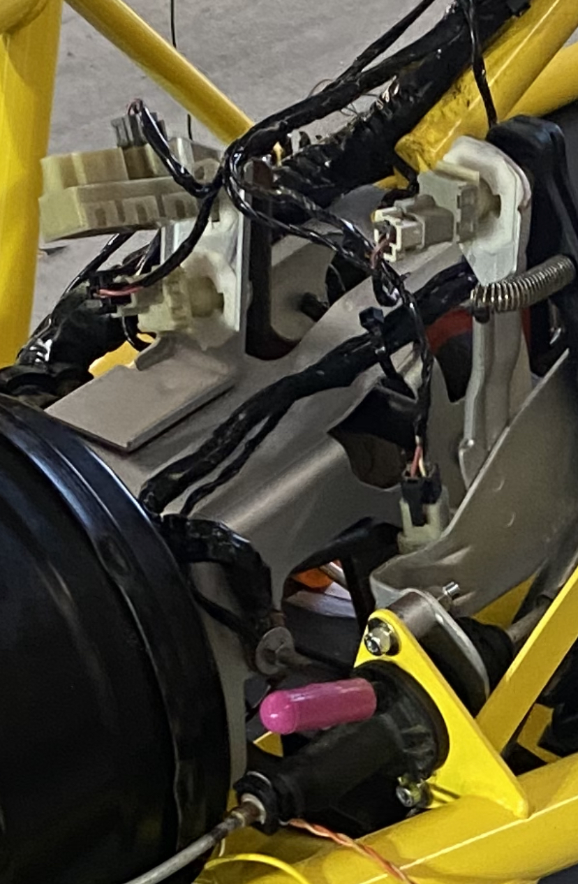

Do I need the top brake pedal position sensor, I can't find any other one and I don't think we had one:

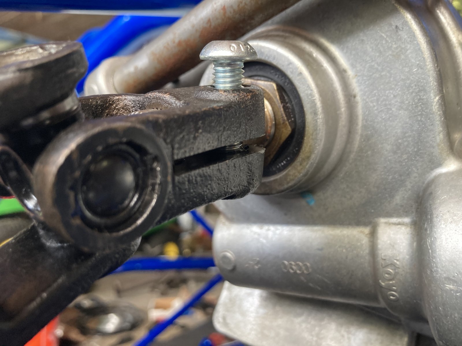

Is this going to hold it seems somewhat high up, not sure if the threads are going into the other half of the clamp. It doesn't seem to want to come off though which I suppose means something good:
35944
Where on the engine is the brake booster vacuum line? I have the 2.4l ecotec, I will post some more pictures in the next post about which ones I think it might be.
