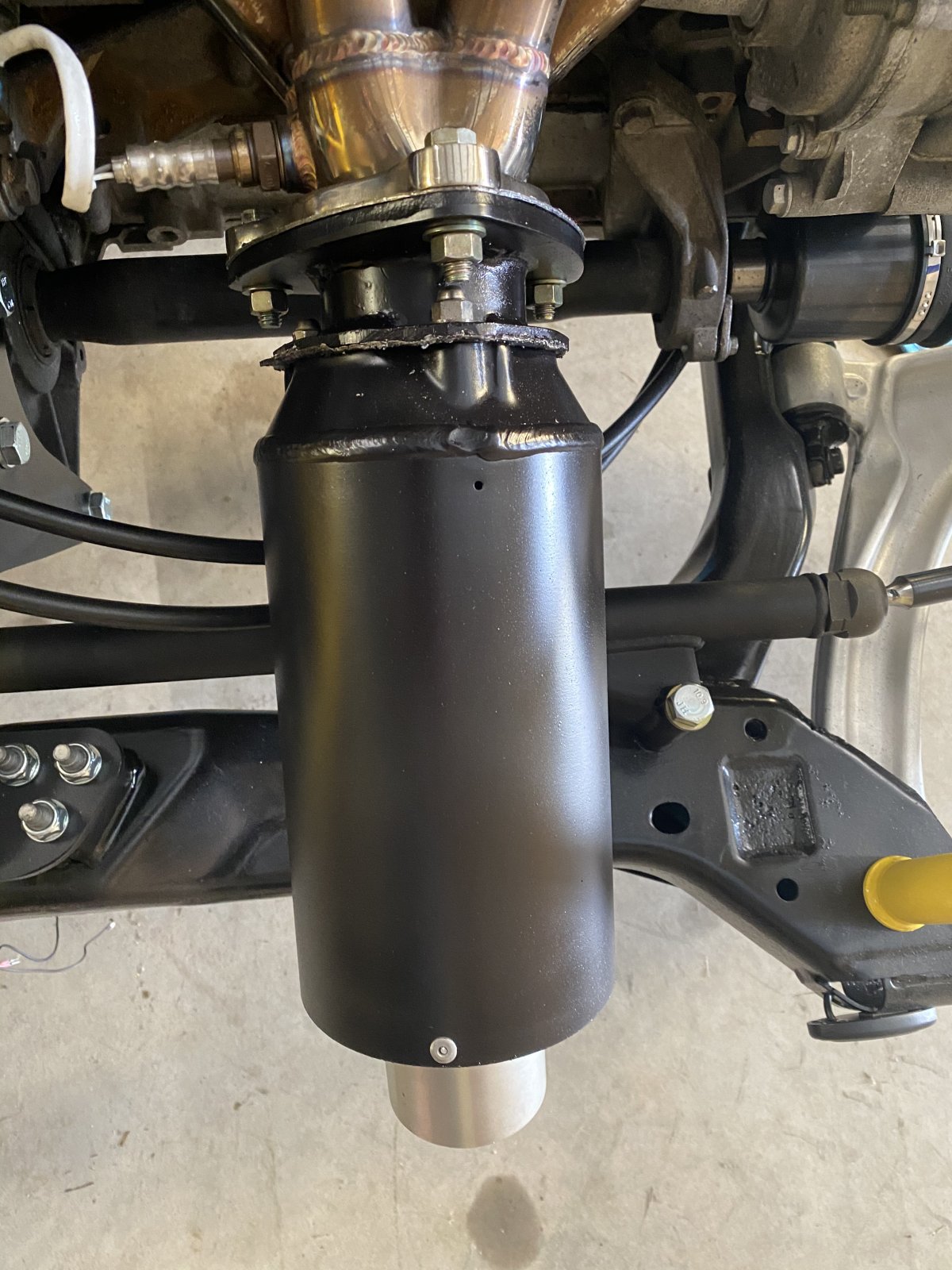

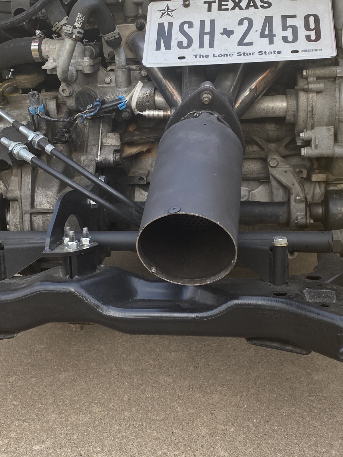

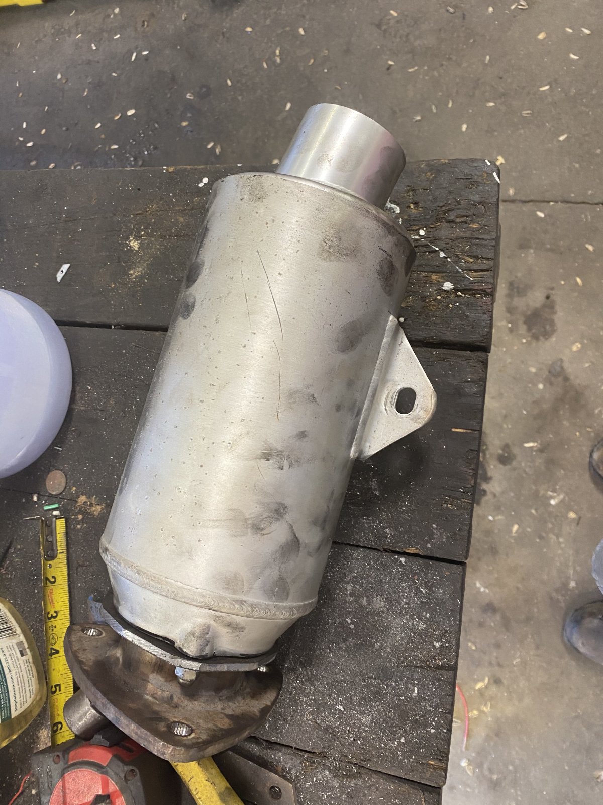

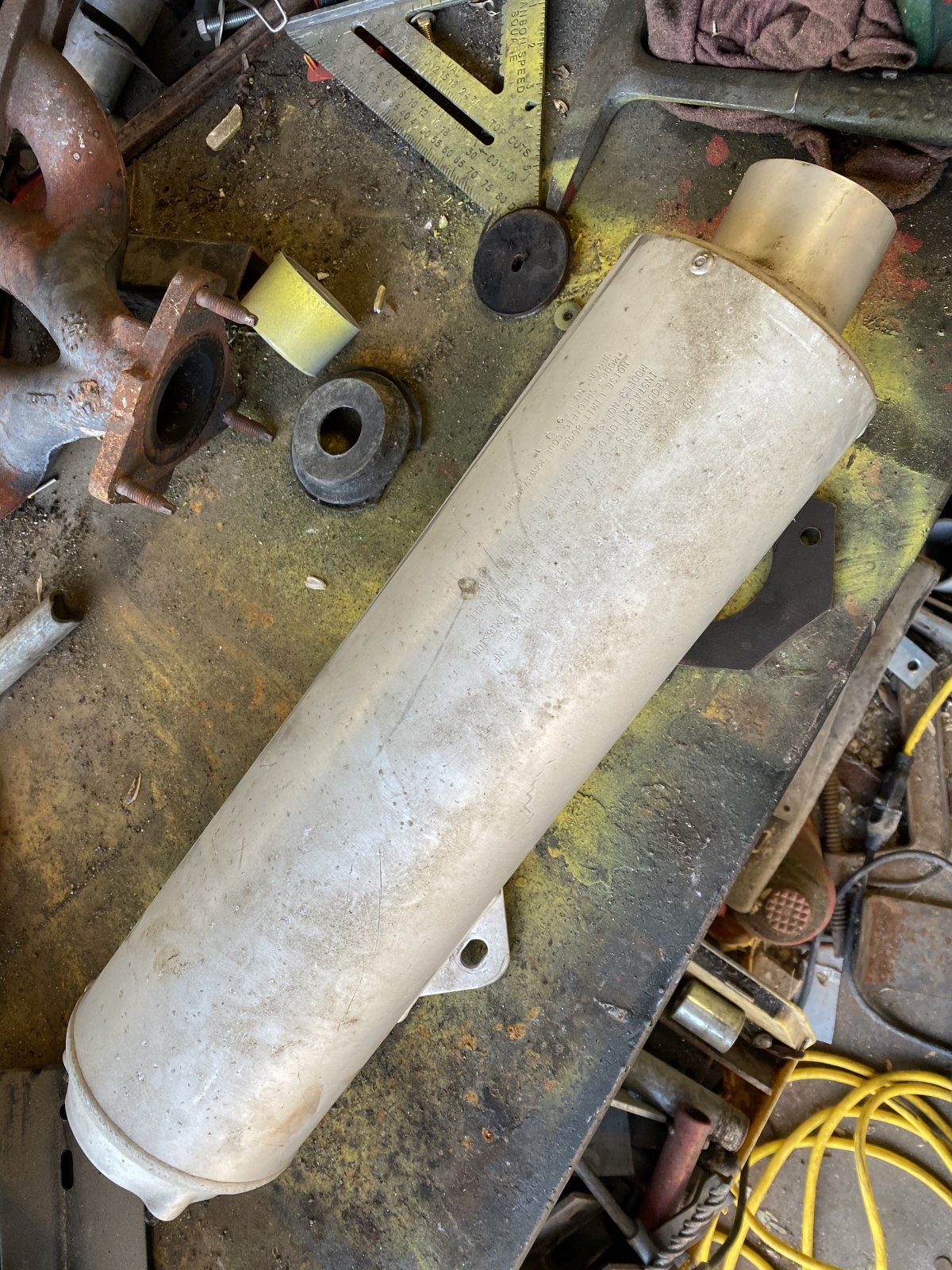

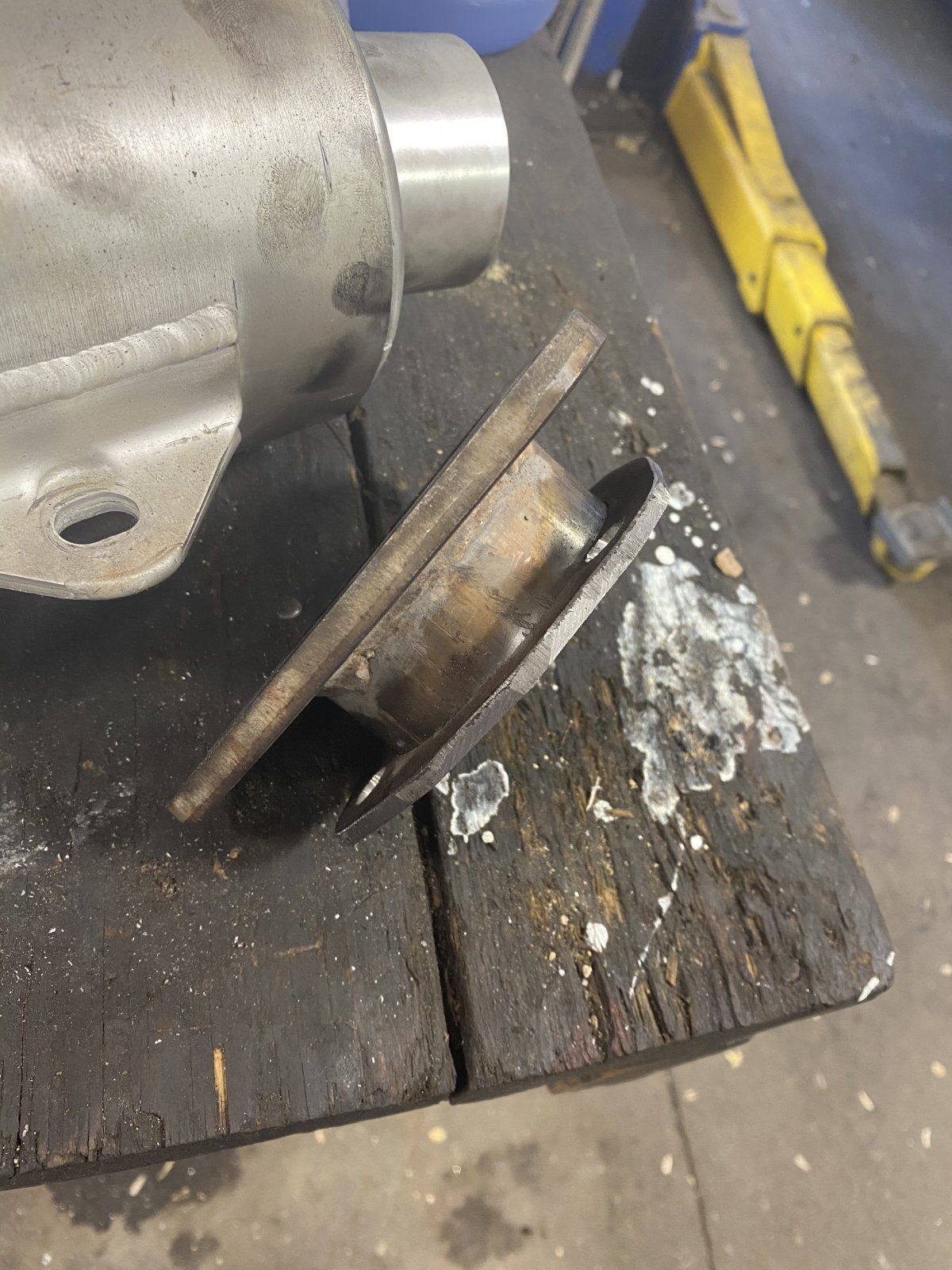

I’m running the stock DF muffler now. I was running a stock ninja 600 (around 2000 I think) muffler I modified to work on the goblin. It was awesome, but a little loud. I added some muffler packing to quiet it down a little, but it moved the wrong way and plugged up the exhaust. I lost power when driving, got frustrated and goosed it. Sooooooo 17psi of boost and 100000% back pressure, something’s gotta give and it was the muffler. :eek::D I’ll rebuild one day. To be honest, i would love to adapt a Ducati v4 exhaust to the goblin.
I used the stock cobalt exhaust flange, some pipe and flat plate to make an adaptor, then cut down the muffler and reattached the tailpipe.
