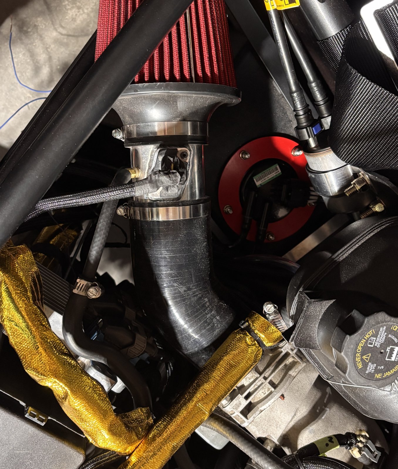

I’ll check for other leaks. This is how I have the intake set up right now.

Does my intake setup seem ok? I've seen a few people mention the distance between the MAF and the throttle body. I'm using the stuff DF sent so I'm not sure how else I could arrange them.
No idle control valve with the DBW throttle body...
Any chance your MAF is in backwards? There should be some arrows to indicate direction of airflow.
The intake setup looks ok to me, only potential opportunity for improvement is to try to match the radius on the intake of the air filter to the pipe to smooth airflow. Filter might need to move up or down that pipe a little, I can't tell from the pic. Let me know if that's not a clear suggestion.

I can see the arrow in the picture. This is the case.
The arrow should be facing air flow entering the engine.
the intake is basically the same as mine, so it’ll be fine. You need to look for a drivability problem, not so much a tuning problem. You can’t tune it until it’s running correctly.
