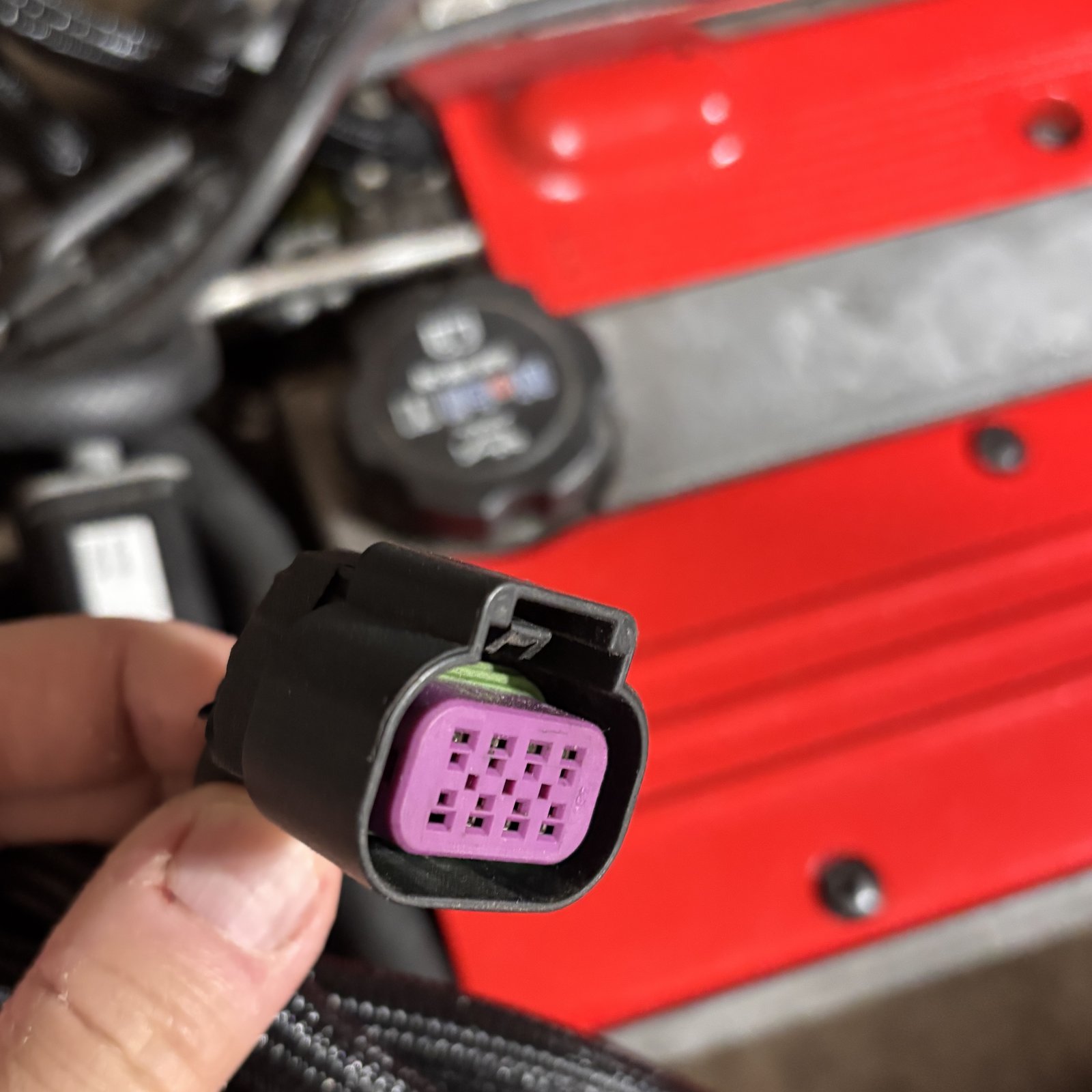

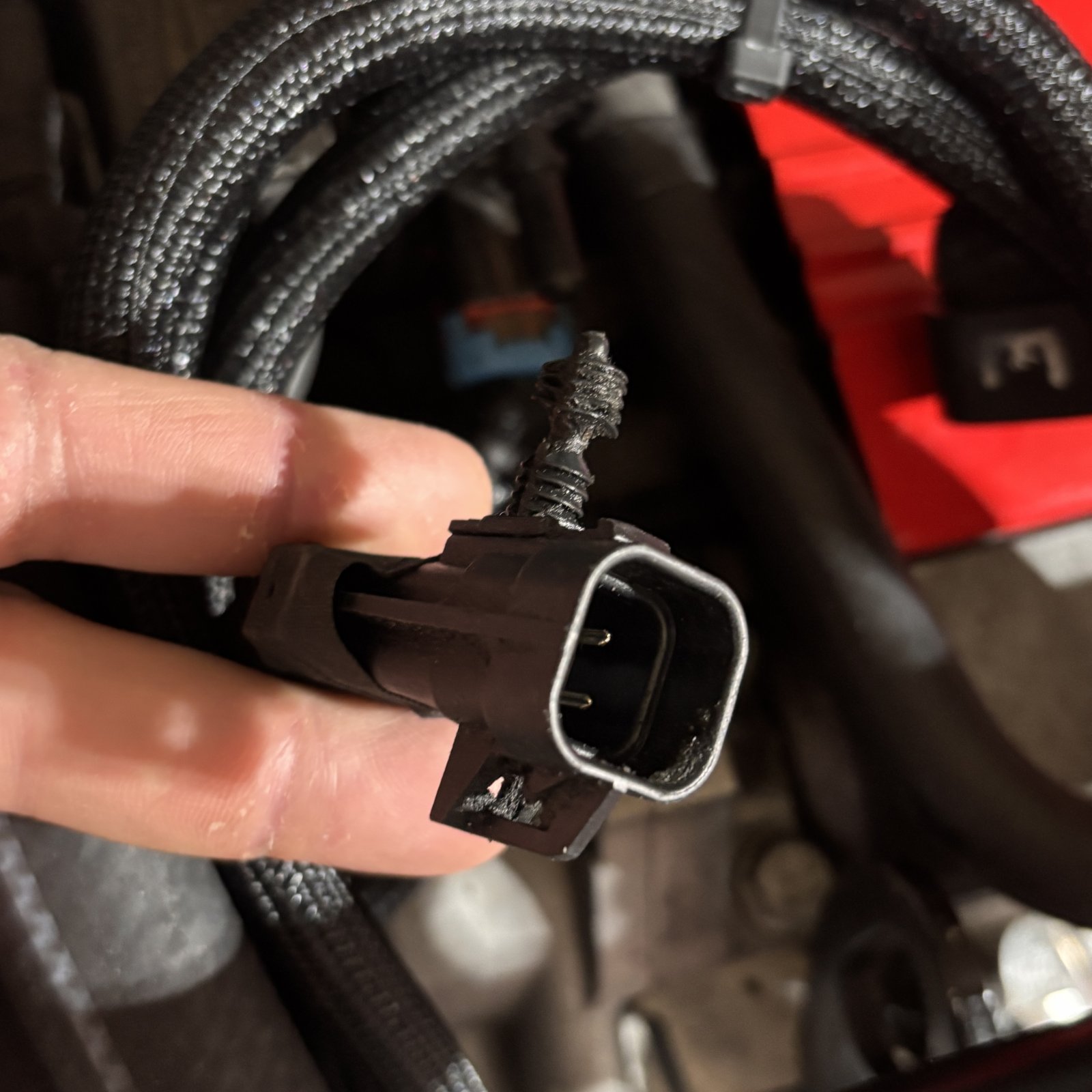

I went through my 3 main grounds on the car (battery box, steering column, and frame by rear fuse box) and cleaned all the powder coat to test ground. They all seem good now with my volt meter. I do still have a purple plug by the engine that had a twin that isn’t plugged in. As well as the square one. Someone said these aren’t needed. I also have one of the old red radiator plugs still unconnected. I am able to crank at this point. For what that’s worth.

First one needs to be plugged in. Looks like a main harness to injectors and such. The second one doesn’t (Post cat HO2S).
