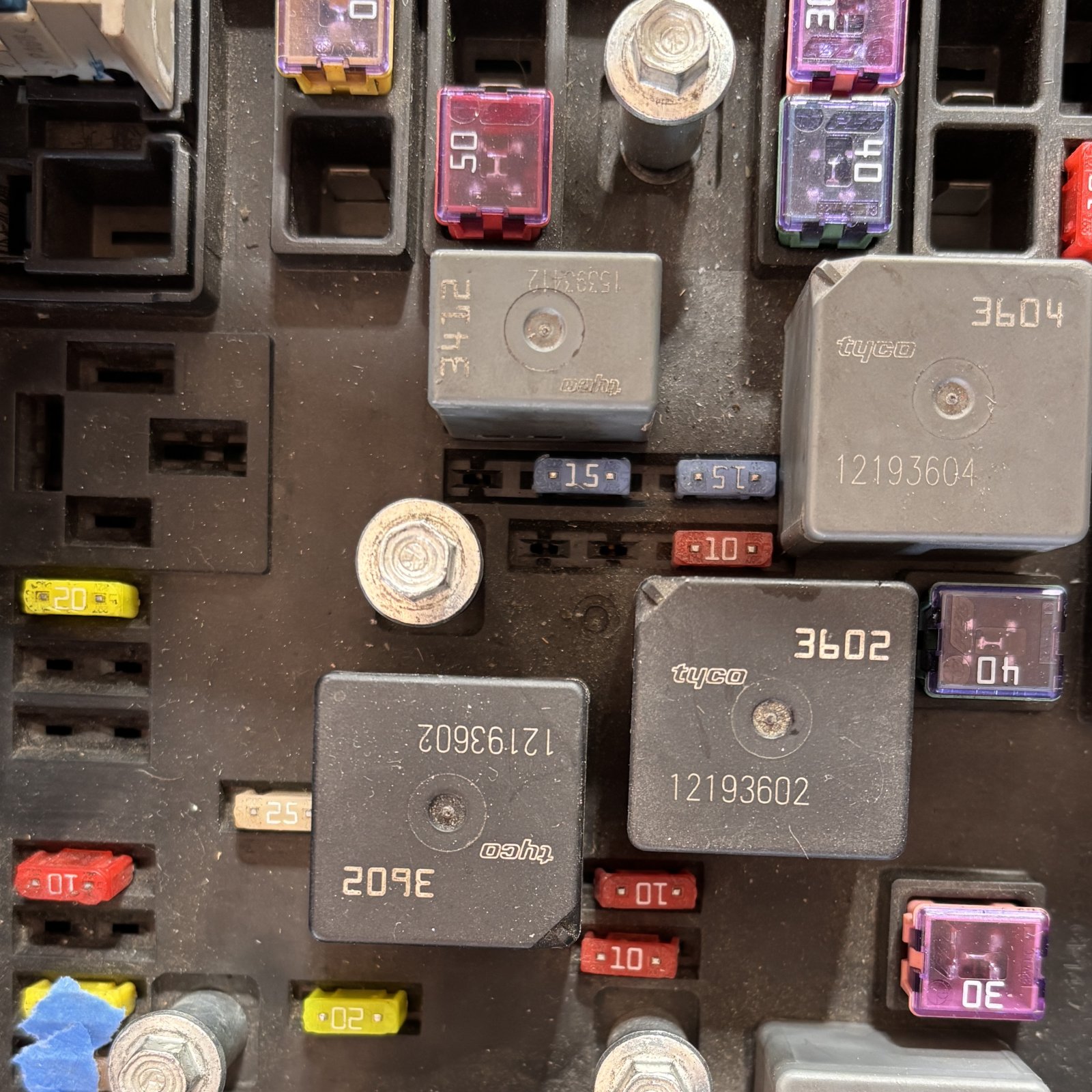

So I did a quick check of feeling the relay when I turn the key and I don’t feel a “click”. I also get .4 volts on the grey wire. Obviously not 12 b but strange that there’s any at all? Also, can you all confirm the fuses and relays look like they are in the right spot? Don’t know why they wouldn’t be but just want to be sure. Also it looks like some relays are upside down based on the text on them. Should I go ahead and wire up the new pump incase it’s absence is the problem?

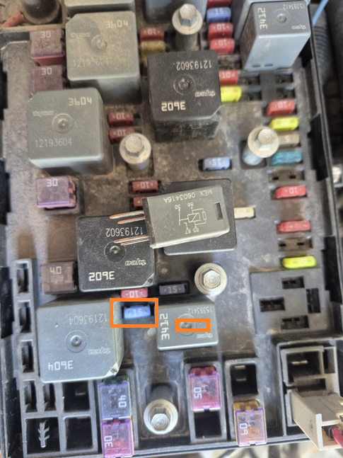

My 06 Cobalt seems to have a different fusebox than your 05. I highlighted the fuel pump fuse and relay with an orange square.
53503
We need to figure out why the PCM isn't energizing the fuel pump relay...
