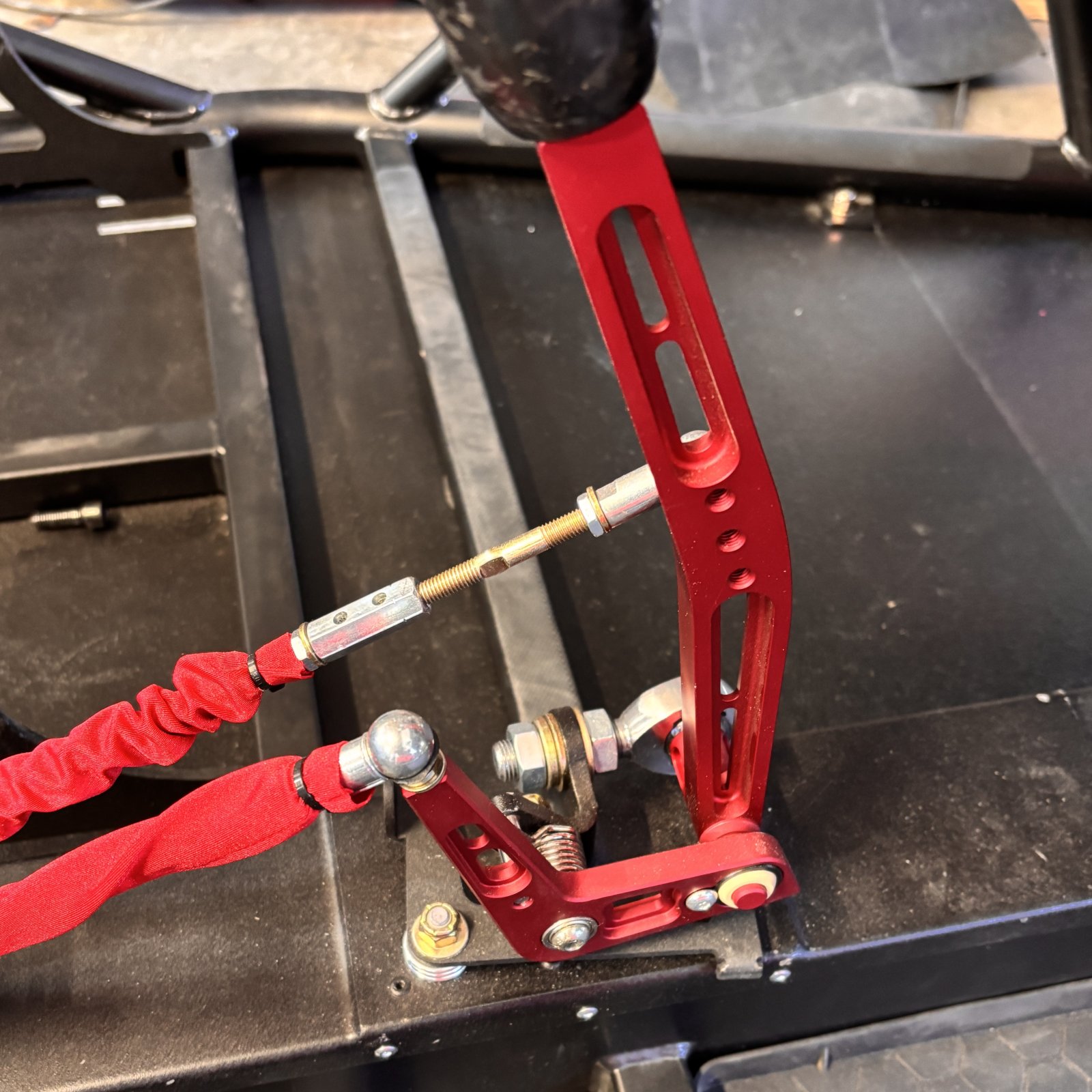

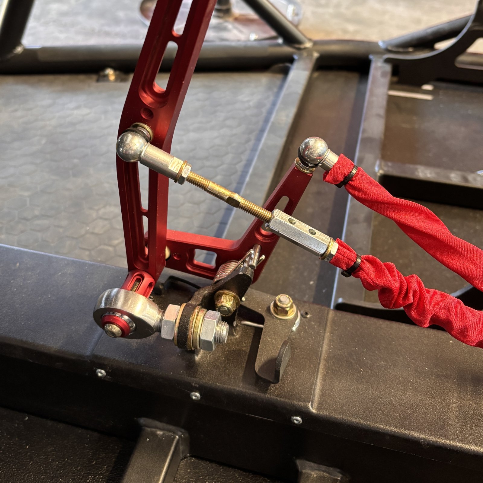

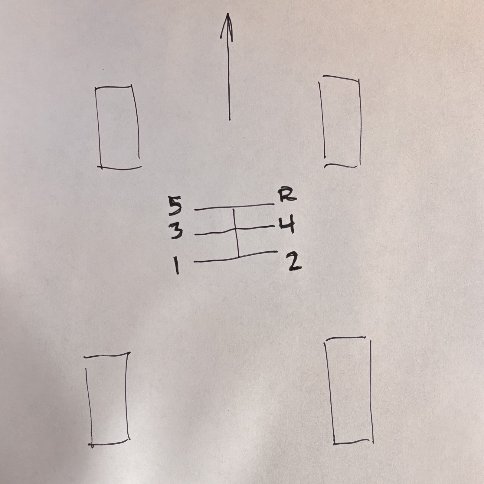

So I installed the tunnel covers and I feel like my shifter isn’t working properly. It’s seems like the shift pattern is rotated 90 degrees. See the drawing to see what I mean. I don’t know if those are the actual shift positions but that’s what it seems like. Did I set this up properly?
I do believe youve got your cables crossed. So swap your cables on the trans end (probably easier than swapping on the tunnel) and see what you get.
As self proclaimed King Grumpy and definitely King of odd shift patterns, this is an easy fix.

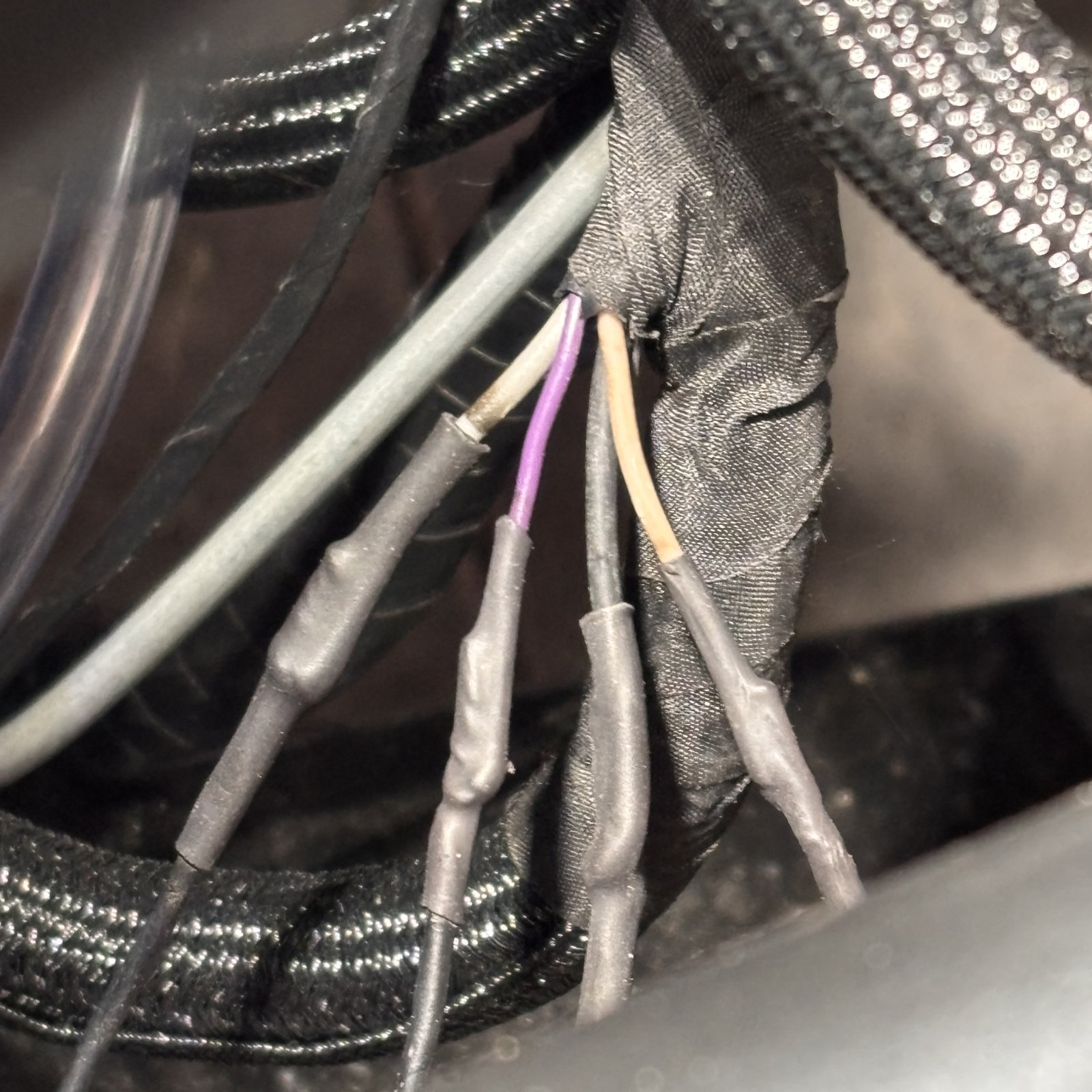

I cut the tape back a bit and found some color! I'm not getting 12v from the thicker grey wire. My grounds seem to be good. Any ideas where to start looking for that issue?

Yeah. It's a little 15 amp? visually it looks ok. I could use my volt meter to double check the fuse itself. I was going to put little jumpers in the fuse socket to check with my volt meter that 12v is getting to it. Would a bad relay disrupt power?
Yes, a bad relay can stop the fuel pump. The PCM decides when to turn on the fuel pump, based on "internal logic". This probably is: - key is on, - VATS doesn't have any security issues, - no serious DTCs (diagnostic trouble codes/ OBDii codes) - turn on fuel pump. If the PCM sends power to the fuel pump relay, then the relay should go click, and then power from the fuel pump 15A fuse flows to the fuel pump motor.
