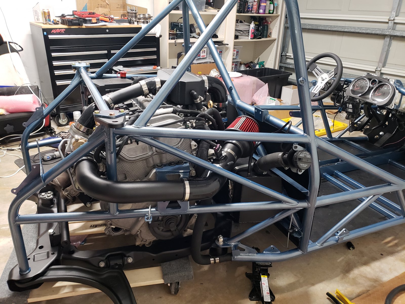

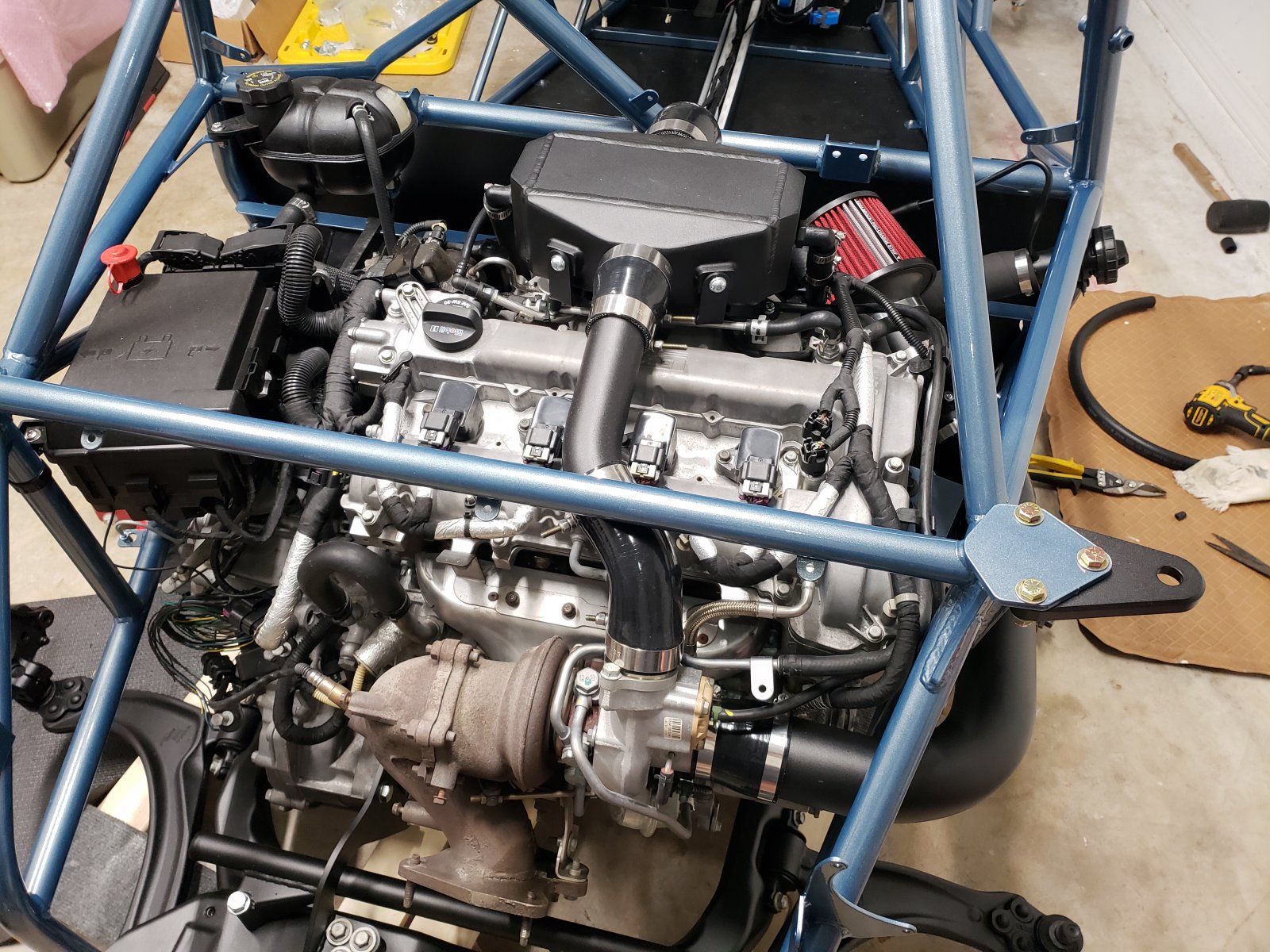

It's getting closer, hopefully start it up this weekend!

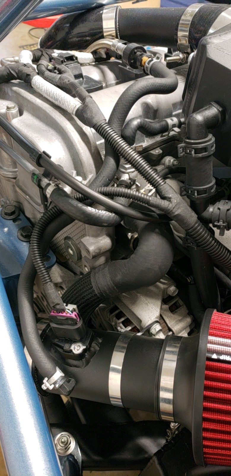

Lethalcast
Okay I was wondering if anyone was running it. I initially thought it was the pcv but then I realized it's under vacuum. All my pieces to cut Male ends off were gone and had to cut one off a fuel filter.

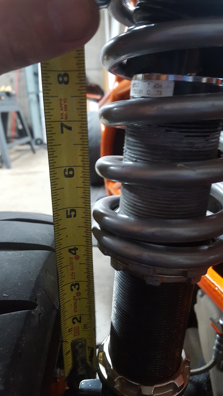

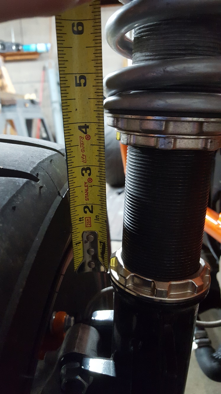

Here is how I have mine set. Basically it's 4-1/4" from the lip of where the bottom lock nut goes to the top adjustment ring where the spring sits.
*Edit* Looks like the forum is having issues attaching pictures.
I'm not sure what the total length is. This gives me about a 7-3/4" ride height as measured from the bottom lip of the control arm. Anywhere from 7"-8" is fine.
