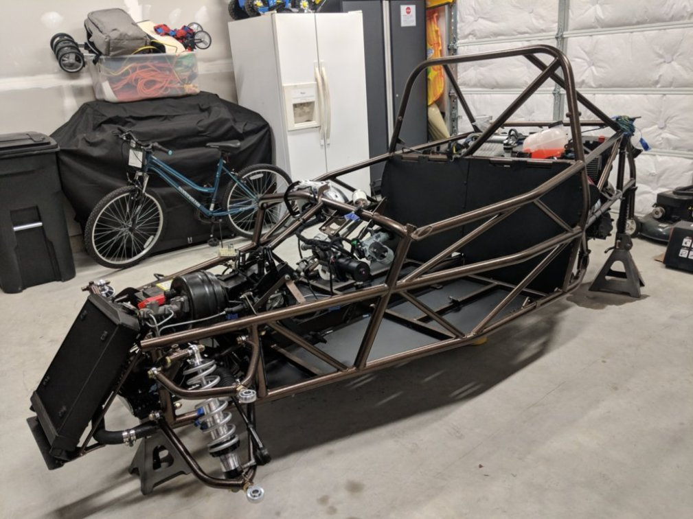

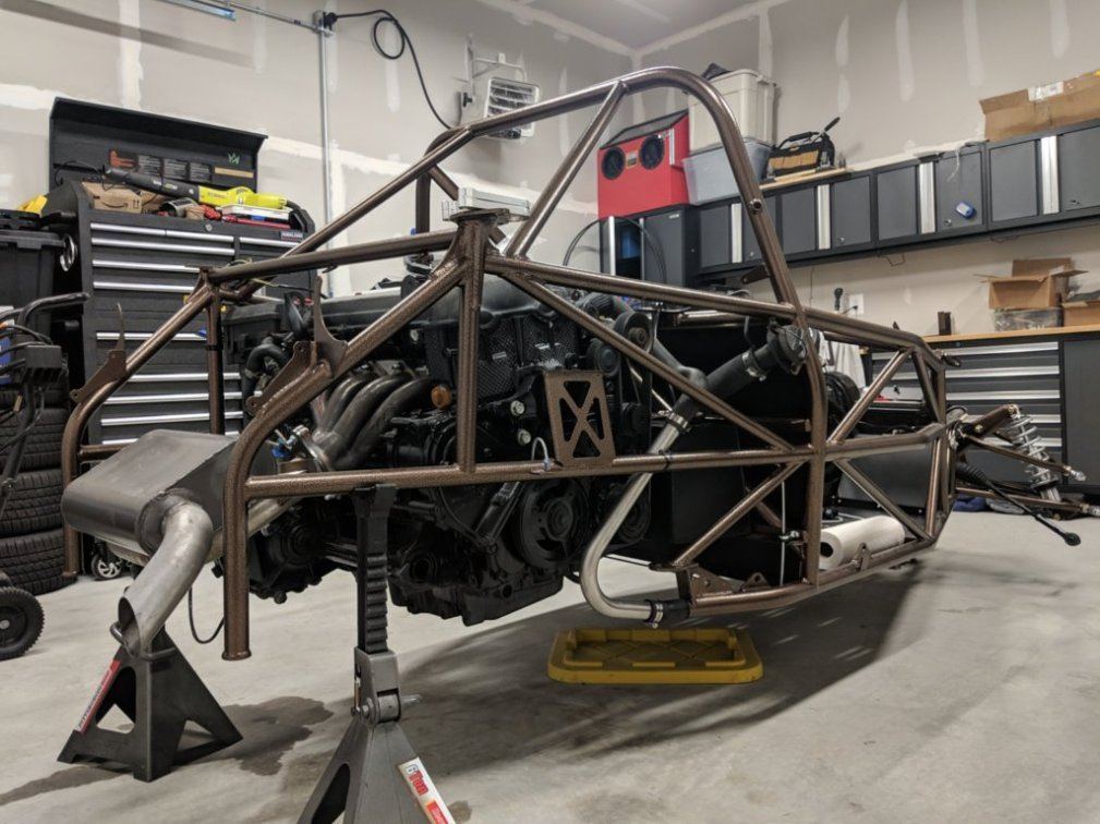

A little more accomplished last night. The springs are on, the firewall is in (pneumatic rivet gun would have def helped with the ones that attach the bottom panels together). I also removed all the lug studs, then put them back in the 5/114.3 holes. Luckily I have a good impact gun made this so much easier.
7509
7510
The only issue right now is that my coolant tank will not really sit on the attachment points of the frame without kinking the hose, I ordered a new hose that has the bends I need, but I'm wondering how it will fit with the air intake on.

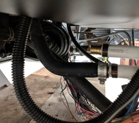

Here is a picture of my the hoses going into the exchanger tubes. The one hanging down just needs to be cut to length and attached. Which I have already done.
Also a bit interesting, today marks 1 year ago that I was working on removing parts off the donor. I lost a ton of time when we sold our home and bought another.
I'm having some trouble deciphering the actual routing... Is the pump supposed to be pushing up to the IC, or is the inlet from the IC and pumping to the front?
It shouldn't matter which direction it pumps or where it goes. All it does is circulate coolant in basically a series circuit.
When I set mine up, I kept two ideas in my head.
  1. I wanted gravity to assist in pulling the coolant down and through the pump. (Not sure if that even matters since the pump has to push the coolant up on the other side.)
  2. I wanted the pump to be on the cool side of the radiator. The theory being that the increased water temp on the hot side could decrease the operating life of the pump. (Not sure if that even matters either since the coolant doesn't get super hot anyways)
Just a couple thoughts.

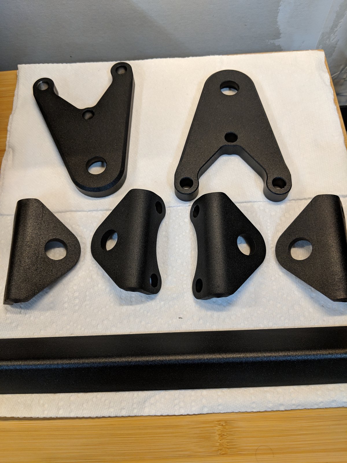

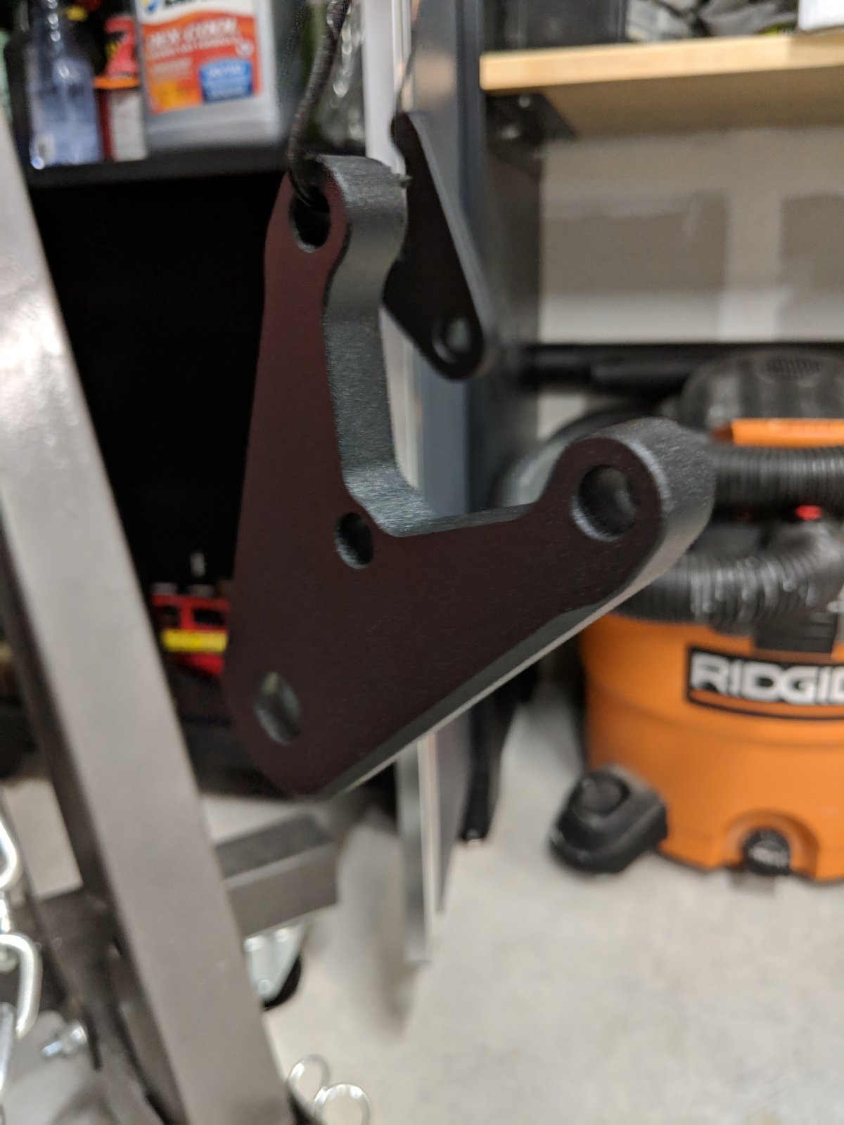

Practiced my powder coating skills tonight. It went pretty good. Easier than I thought. I powder coated the coil over top pieces, battery tie down and a couple of the front suspension pieces.
Here is the finished product. The powder is called "black diamond". It has a slightly textured look. I also bought some the same color as my frame to use on some other parts.

I used a toaster oven right now. So I am limited to smaller items. I may get a super cheap old electric oven to use to do the valve cover, supercharger and seat brackets eventually. I still need to figure out if I want to purchase a larger compressor so I can blast items. Or at least find someone that could blast it for me.

Looks good. My new shop already had an oven that was used for PC, I just need to buy a gun. You using the Eastwood setup or HF?
