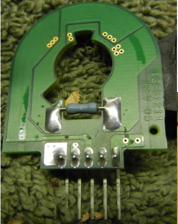

Inside that black unit, is this circuit board with this theft deterrent resistor on it. Again, I'm not going so far to say this is your problem, but something to keep in the back of your mind before you go crazy over it. There has been some question on the value of the resistor. The diagram says 1.3K while I measured 1.8K on mine. It may not even make a difference, but I can't help but to wonder if it worked before and doesn't work now.
