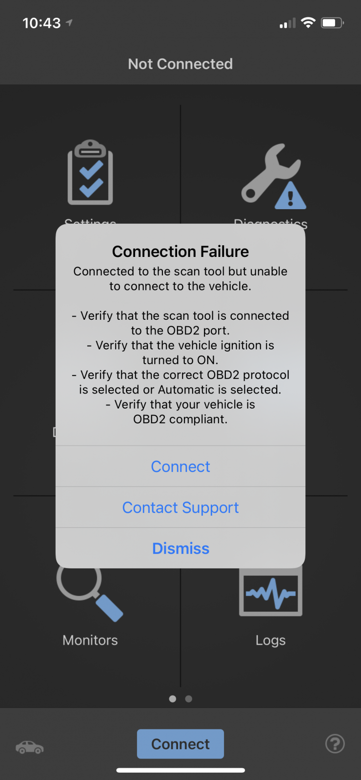

I tried using my OBDLink adapter on the OBDII and it can’t connect. It worked before tear down though.

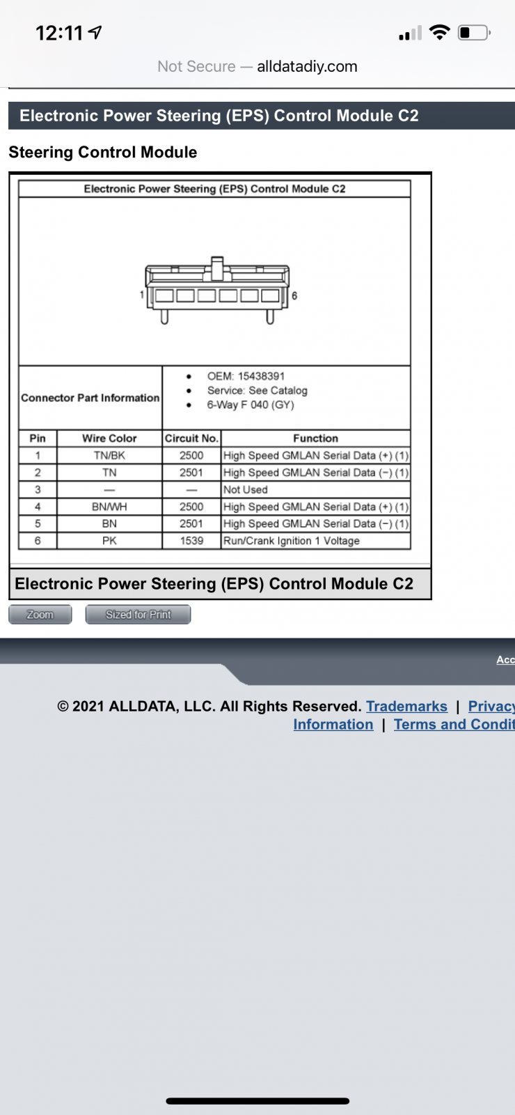

I made sure I had all of the wires plugged into the power steering module (including the 2 large connectors for the electric motor) when I did this. Even connected the turn signal switch, ambient light, etc. so I wasn’t causing a break anywhere (besides headlights and tail lights). If I connect a multi meter to pins 6 and 14 on the OBD, I should be able to tell if there’s a break somewhere in the system before having to strip my harness again, right? Or should I just go end to end on each individual wire (OBD pin 6 to EPS C2 Pin 1, etc.)?
I would go end to end on each wire, before stripping your harness. That way you know if you flipped the wires accidentally.

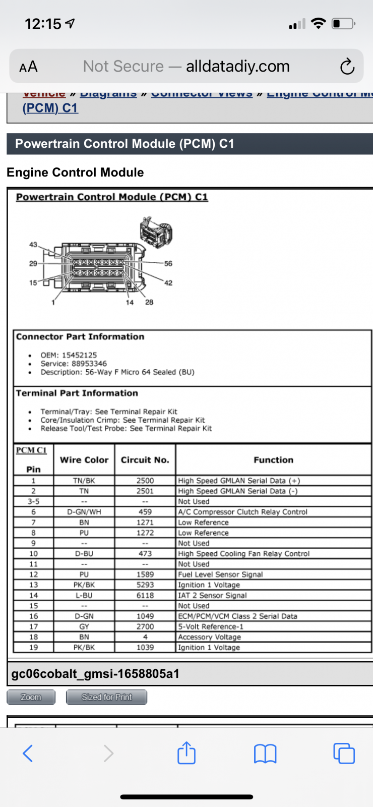

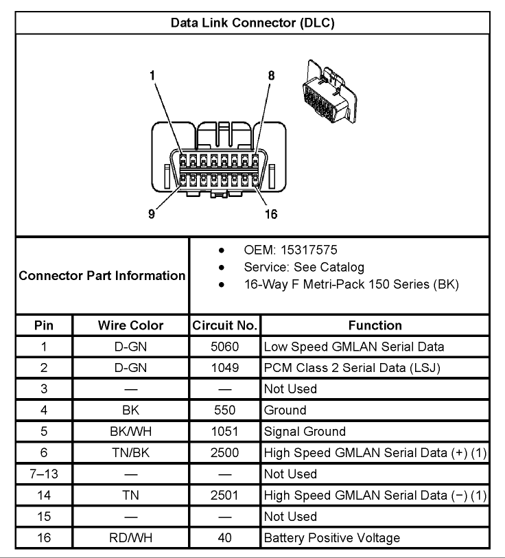

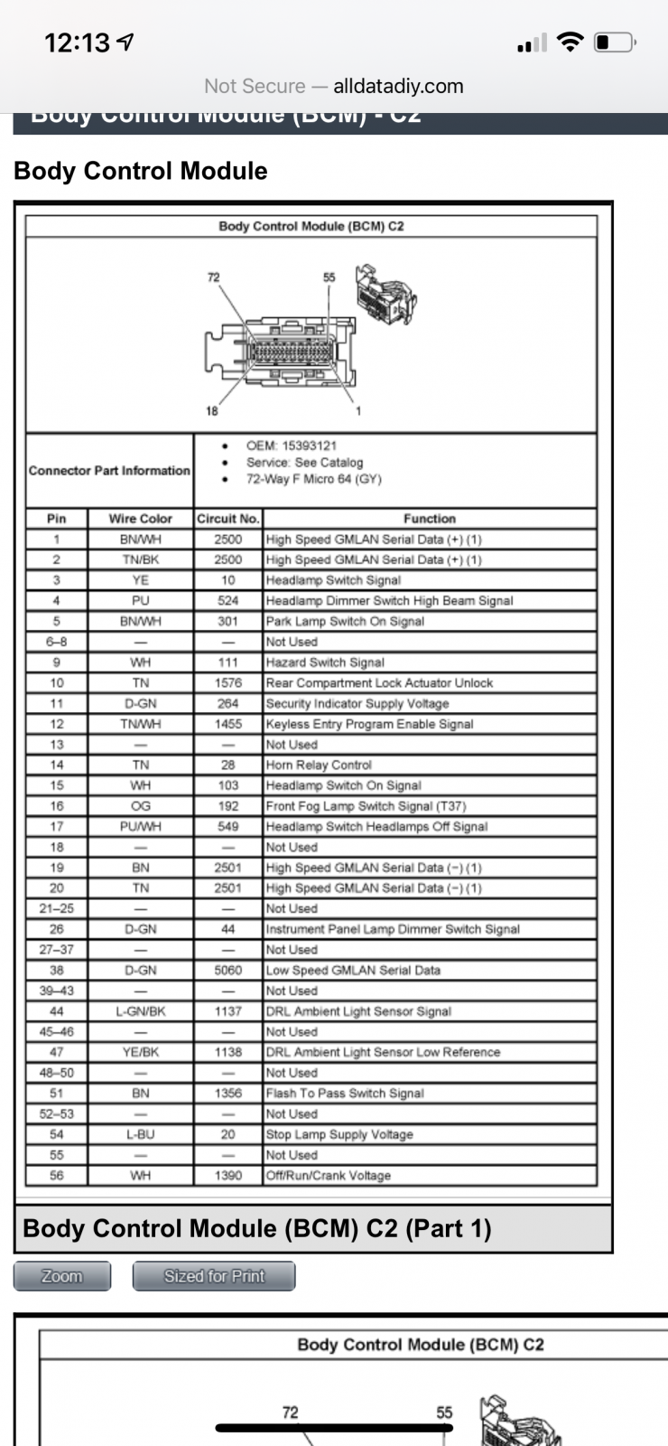

Using your chart linked above, and the attached diagrams, all wires have continuity accordingly.

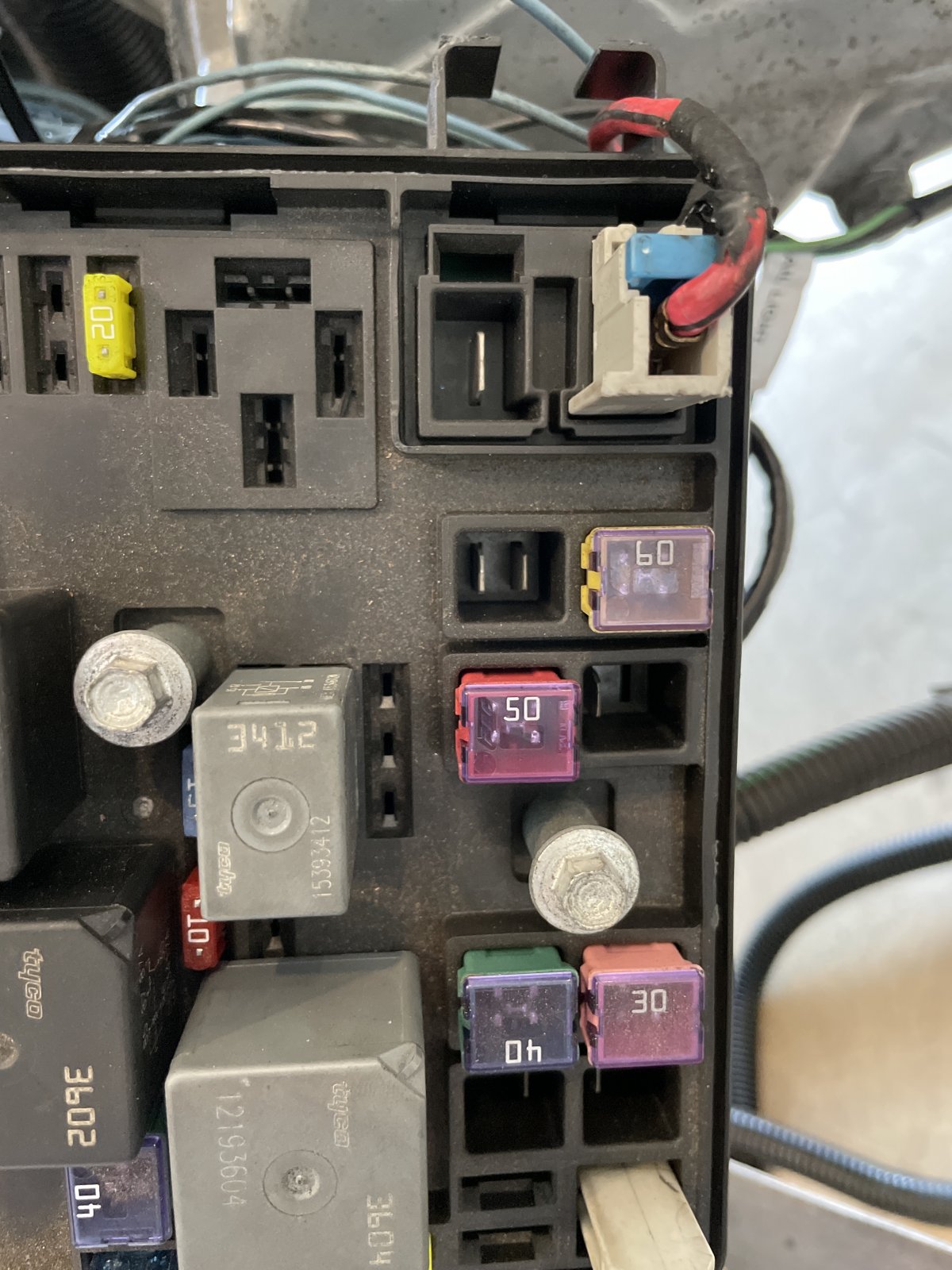

Just checked the continuity on all my fuses as well and don’t have any blown fuses. Also checked the large power steering plug was receiving the 12v with the battery connected. Out of curiosity, do I have the red power cord in the correct slot in the fuse box? Also my blocks are in the correct place?
Just to eliminate the possibility of a missed ground, I have 3 at the engine side of the harness (starter, 1 on harness, 1 from fuse block), 3 in the middle, and then the 1 at the front for the battery terminal.

Checked the terminals where the blue EPS plugs in and I’m getting nothing there with the key in the run position. I don’t think the EPS module is bad because it appears the high speed GMLAN is working since the engine will try to crank. I also hear the BCM click when I switch the ignition to start (not holding the clutch so starter doesn’t kick on). Checked power to the red BCM plug, the red power at the fuse block in the above picture, also at the + post in the fuse box. Gauge cluster just cycles “low fuel” and “low coolant” with the CEL, BRAKE, Airbag, and ABS lights on.
The red power cord only fits in the correct hole... so you are good.
Your BCM is talking to your gauge cluster on the low speed LAN, as it is saying: low fuel, low coolant, etc.
So I think your BCM isn't able to talk to the ECM.

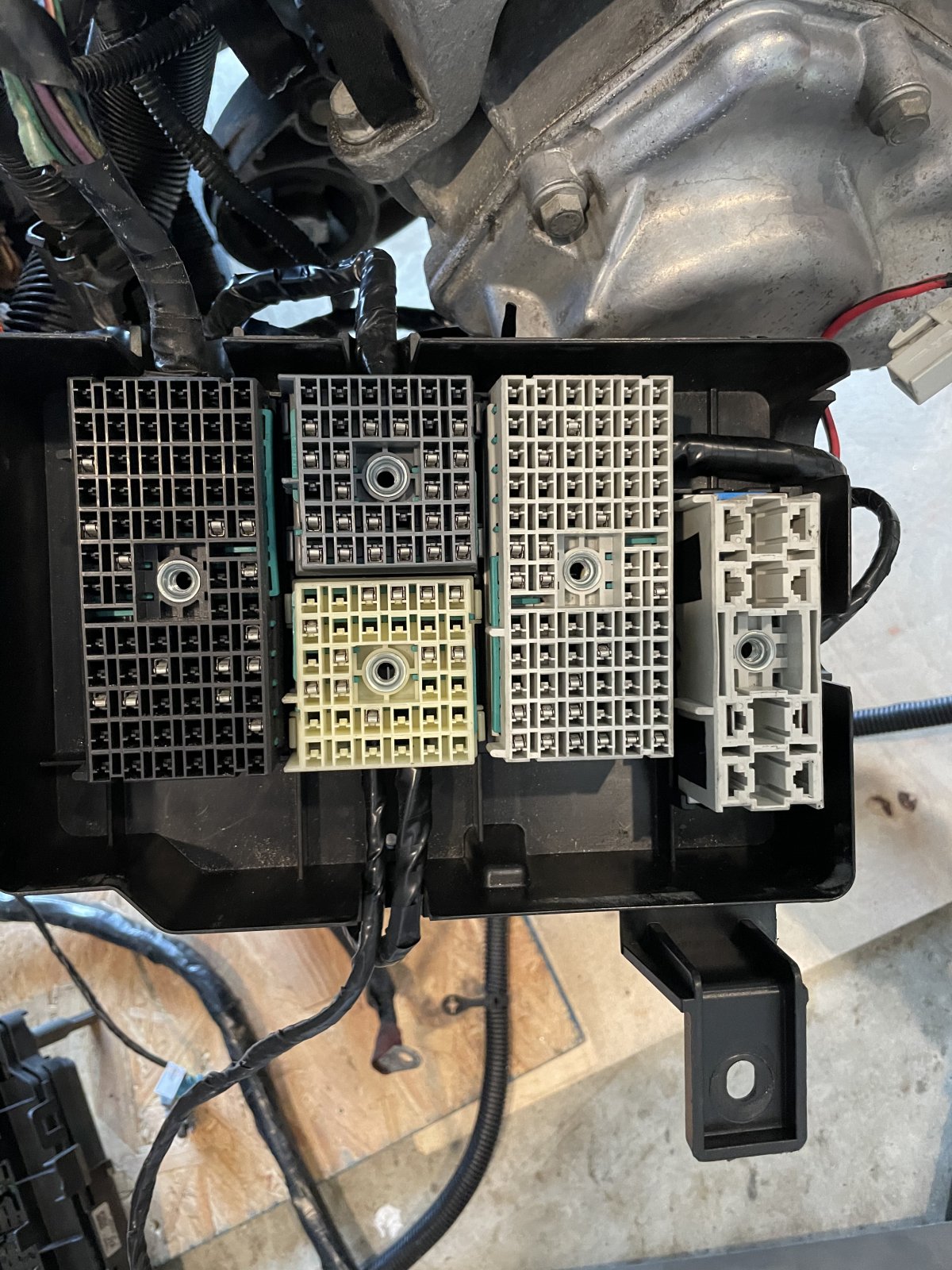

You have the 7mm fuse box blocks snugged up tight? Maybe loosen them, and tighten them up again.
Same with the grounds, loosen, clean, tighten.

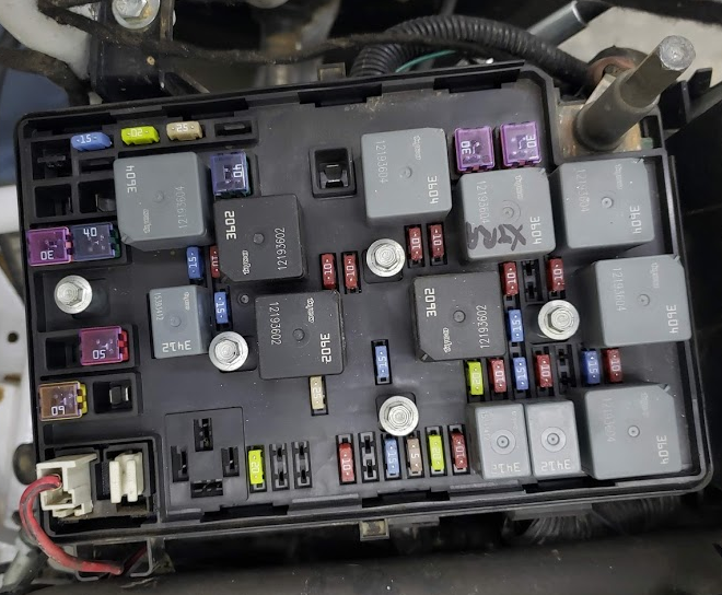

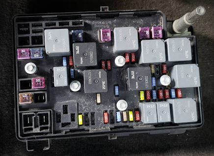

I can take a picture of my fuse box, just to check the relay blocks.
I pulled this out of my 2nd donor yesterday, so it is completely stock:
22947
This is out of my Goblin:
22948
