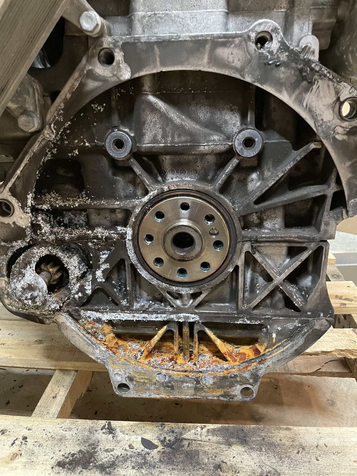

BCM is perfectly fine. All electronics worked on the car before tear down and during my engine test so I’m not worried there. I only worry about the block because even a slight oil leak at the oil pan will allow water in (although I didn’t notice any oil leak on the floor during the time it was parked.
R

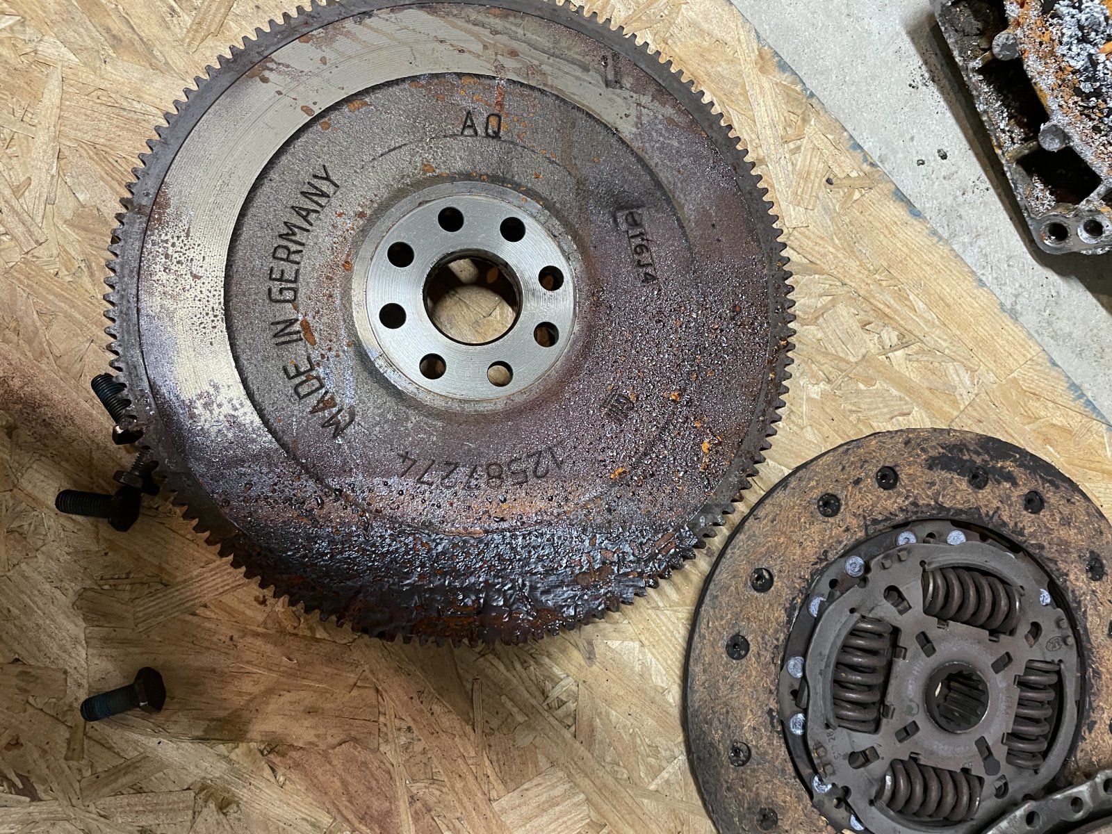

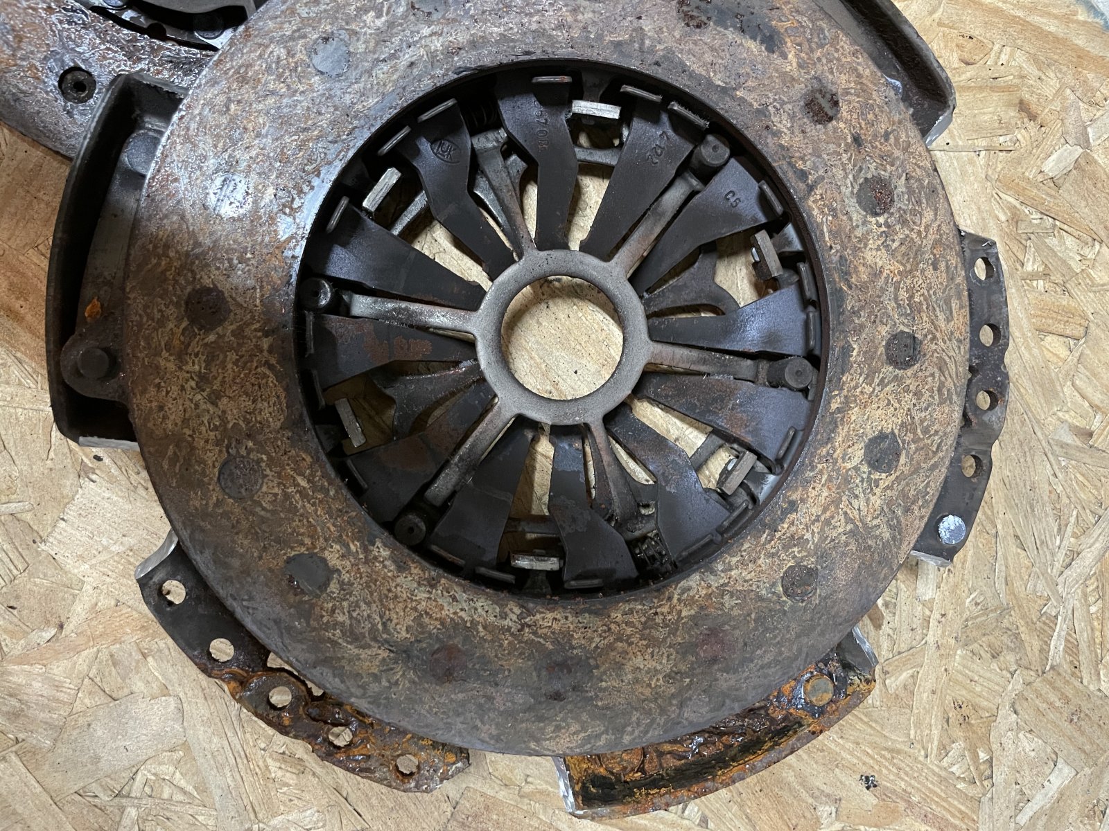

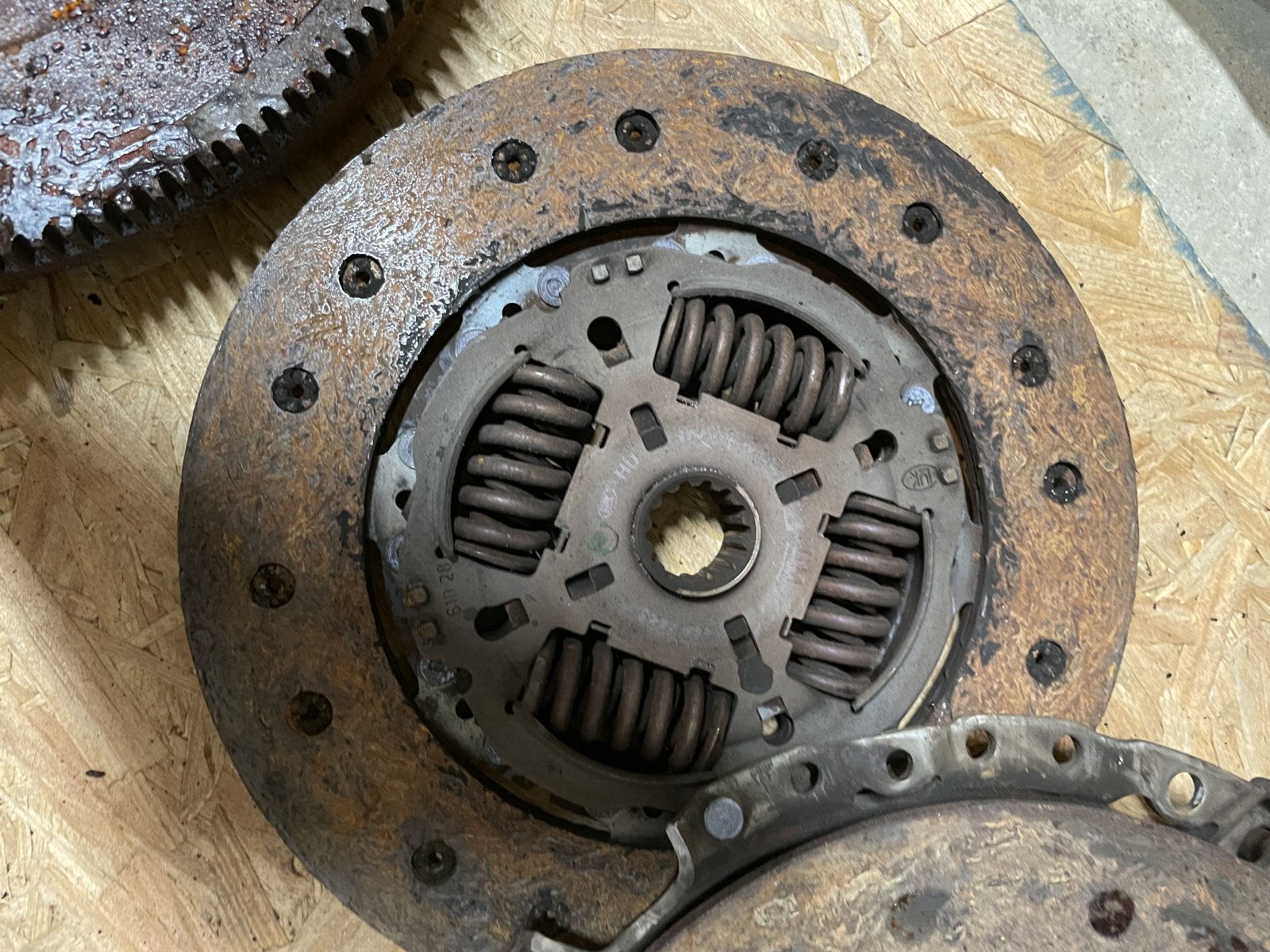

The pressure plate bolts were so corroded that they stripped instantly. Had to use a bunch of cut off wheels for my Dremel to cut the pressure plate at the bolts so I could get to the flywheel bolts to remove that as well. Good thing I planned on replacing all of that stuff anyways. Corrosion on the block and starter (of course) so will get the block hot tanked and cleaned by a local shop as well as honed so I can start assembly with the new parts.
The transmission fluid wasn’t milky looking and looked like normal gear oil so I don’t believe any water got in there. The drain bolt has a built in magnet and it had a decent amount of shavings on it. I’m not holding my breath for this transmission to last much longer. I’ll get it cleaned up (probably soda blast it to remove the corrosion) and mounted back up after the rebuild.
New starter, intermediate shaft bearing (busted mine trying to hammer out the passenger cv axle), new drive shafts, steering shaft, and a Haynes manual on the way.

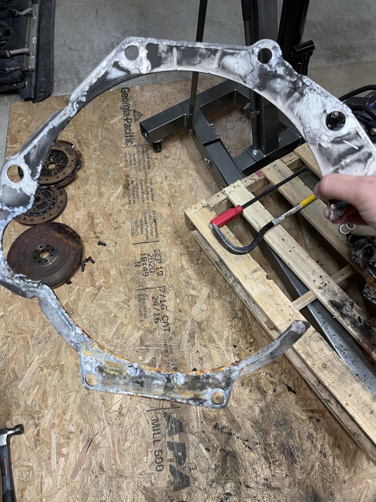

Be certain to keep the spacer in the second photo, it will be needed. Those are becoming very hard to locate.

Might be beneficial to have it traced or drawn up in CAD for future reference for other who need it on here. With their new fancy CNC machine, DF might be able to make these for customers @Lonny

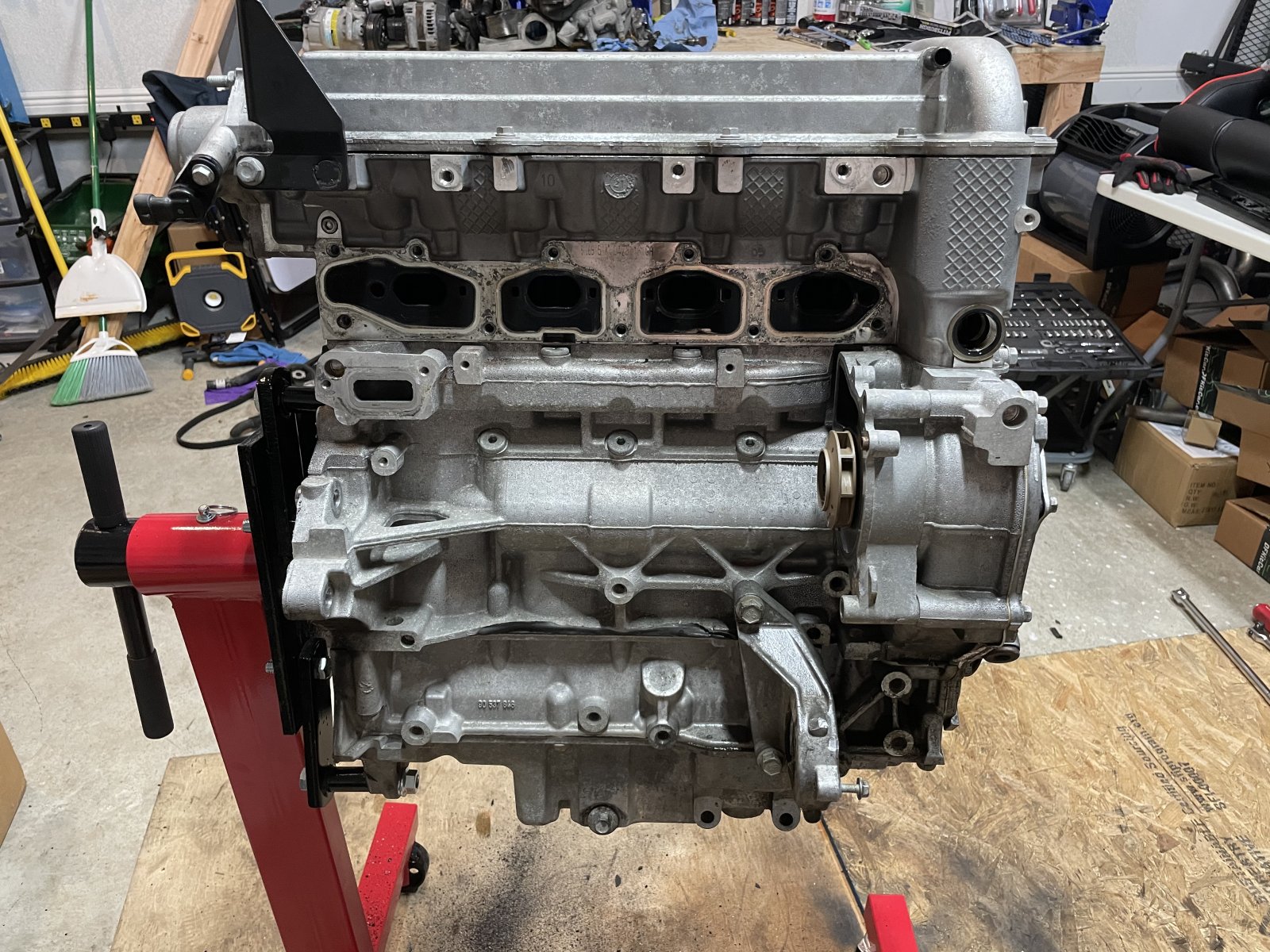

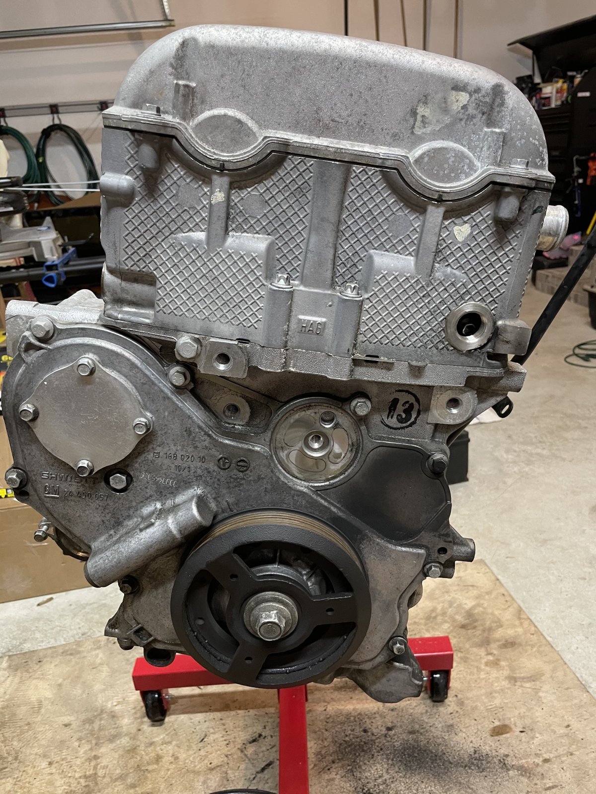

Got the engine moved to the engine stand. Although I wasn’t thinking and mounted the lower bolts to the lower oil pan >.< so I’ll have to dismount it with the hoist and readjust, but I’ll do that once I have the top side stripped down.
Drained the oil out of the pan and it didn’t appear to have water in it. Staying hopeful for the inside of the engine so far. I’ll get it stripped throughout the week so I can send the block, oil pan, and valve cover to the cleaners.

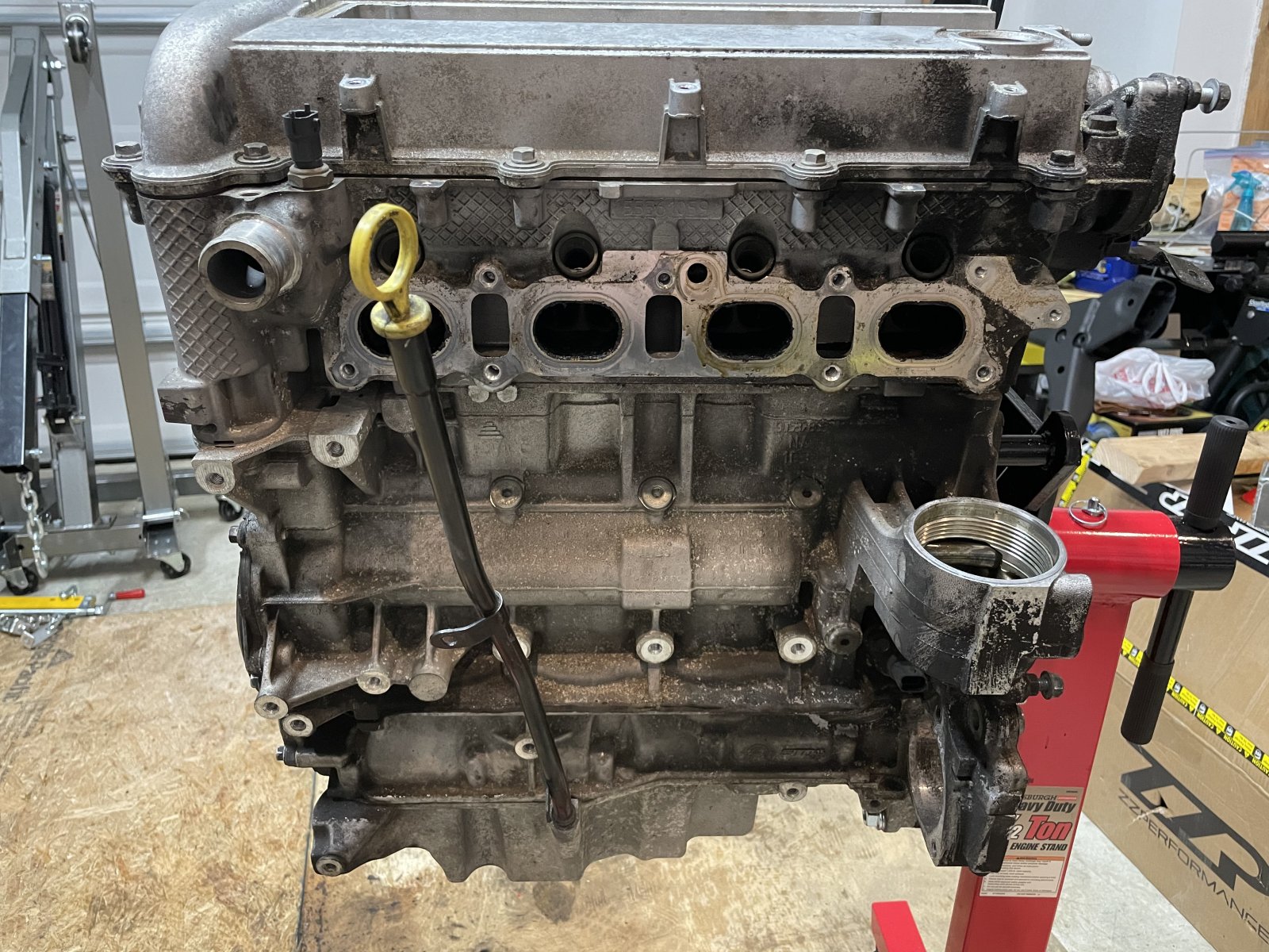

Anyone know how to remove the dip stick tube? I hear they are unobtainium so I don’t want to break mine.

Dip stick tube has 2 seals that hold it in. You can usually twist a little and pull it out. Be really careful as it is thin metal that can be twisted off. I broke mine that way and had to drop the oil pan to get it out. But I did not have a hard time sourcing a new tube for a 2010 LS that is.

Thanks @Lokian. Since I'm stripping the block anyways, I'll try to get it out from the bottom side. I was spinning the tube in circles on the block at first thinking it was screwed in, then tried pulling on it and it wouldn't come out.

It has a lip on the tube so you have to pull it out. The lip should be visible from the outside and sit against the outside. I was able to get the broken piece by taking off the oil pan after snapping the tube.

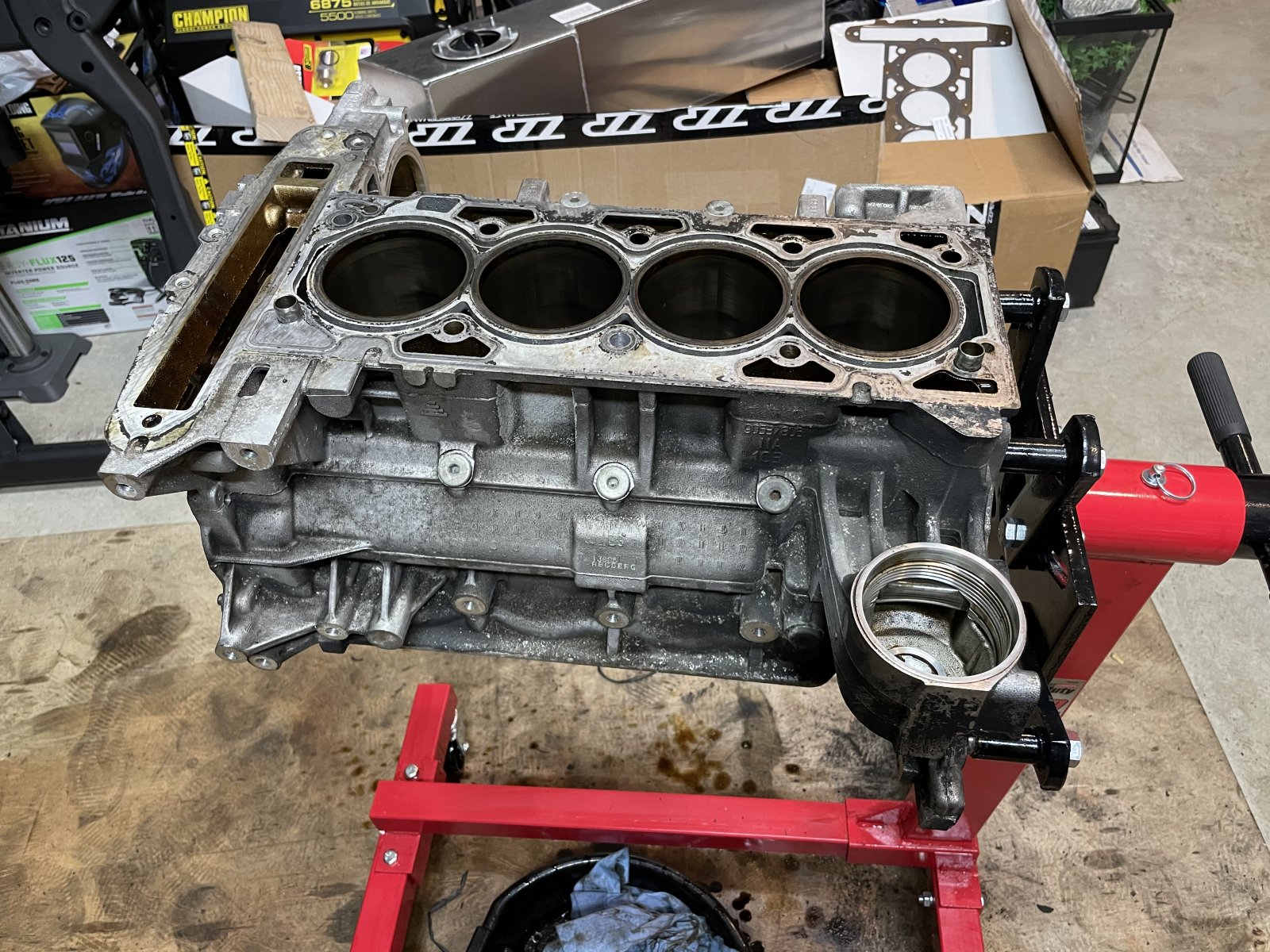

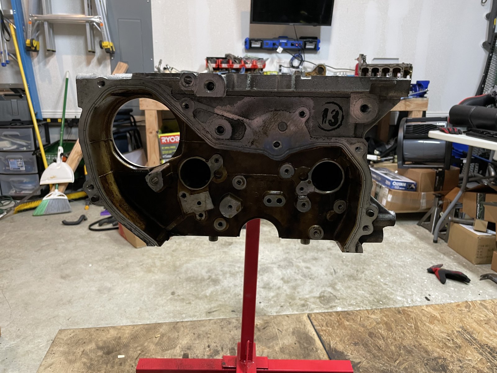

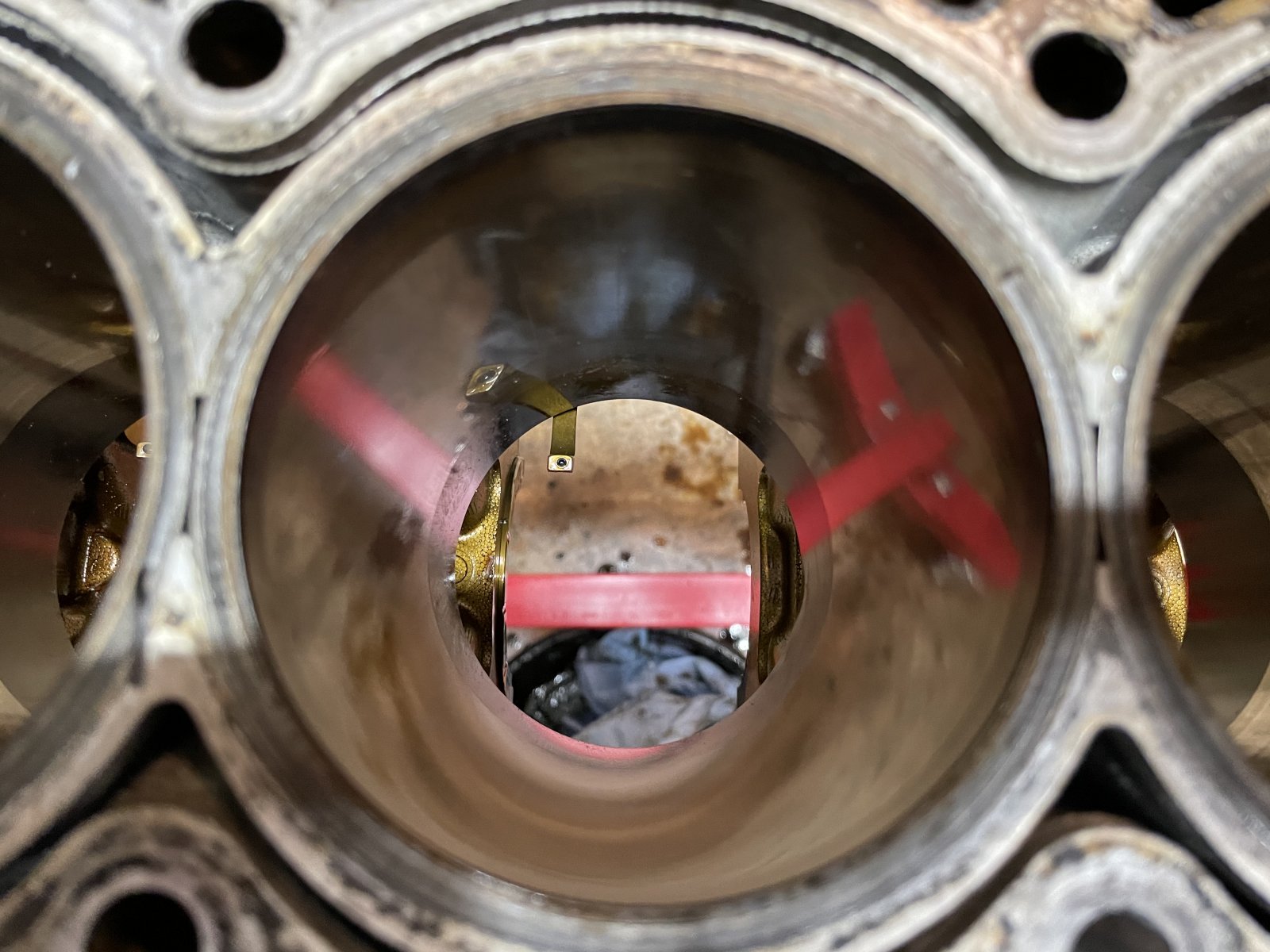

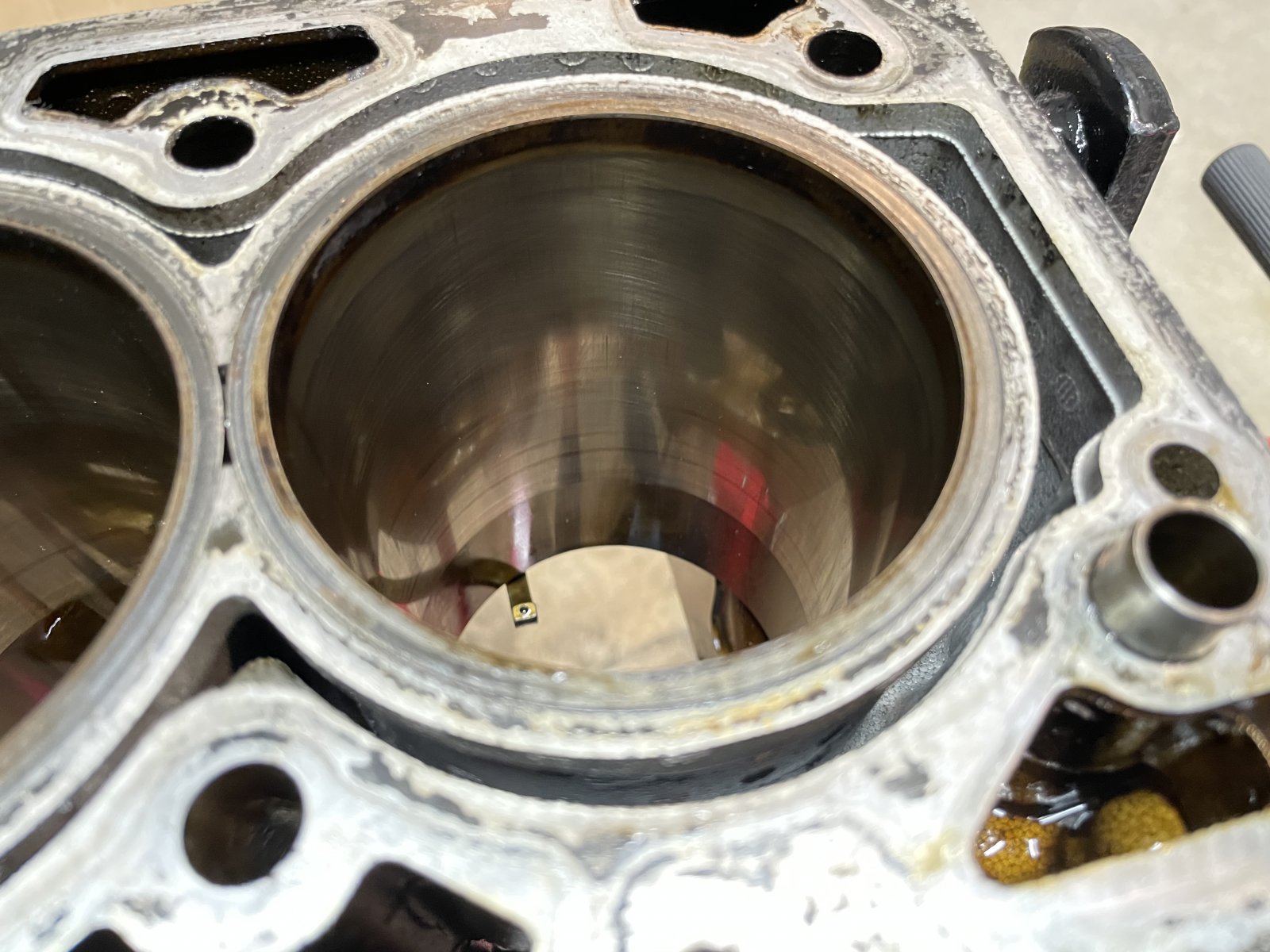

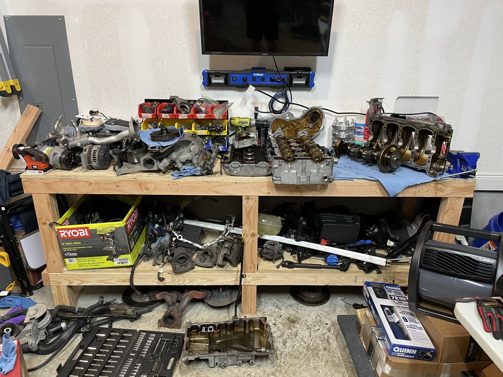

Block is completely stripped. Thankfully everything inside the engine looks good. No cracks in the cylinders, all pistons in good shape, the only issue was the timing chain guide bolt did in fact break like it’s known to do, so the guide was loose and caused the bolt to stay in the head and gouge a divot into the side wall. The head is being replaced with a ported head from zzp (whenever they ship it that is, it’s been 2 weeks now) so not worried about the minor damage.
