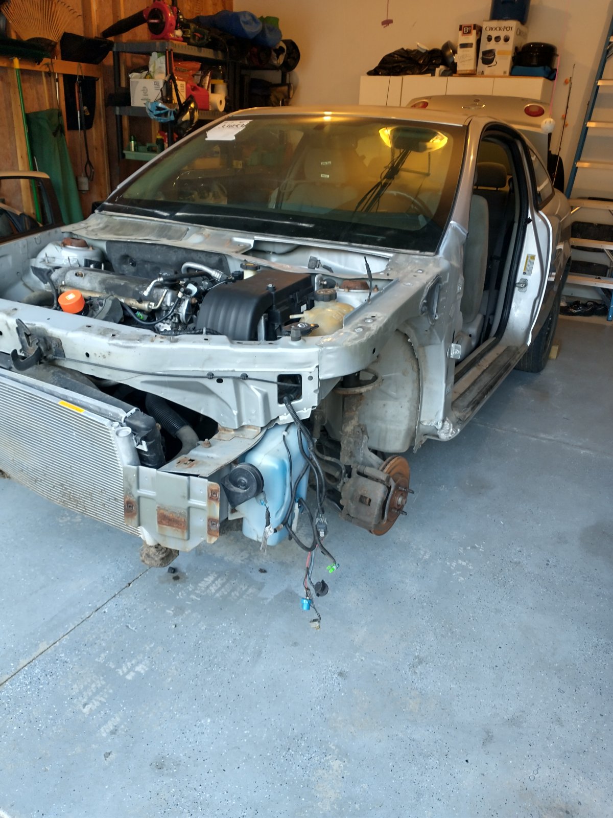

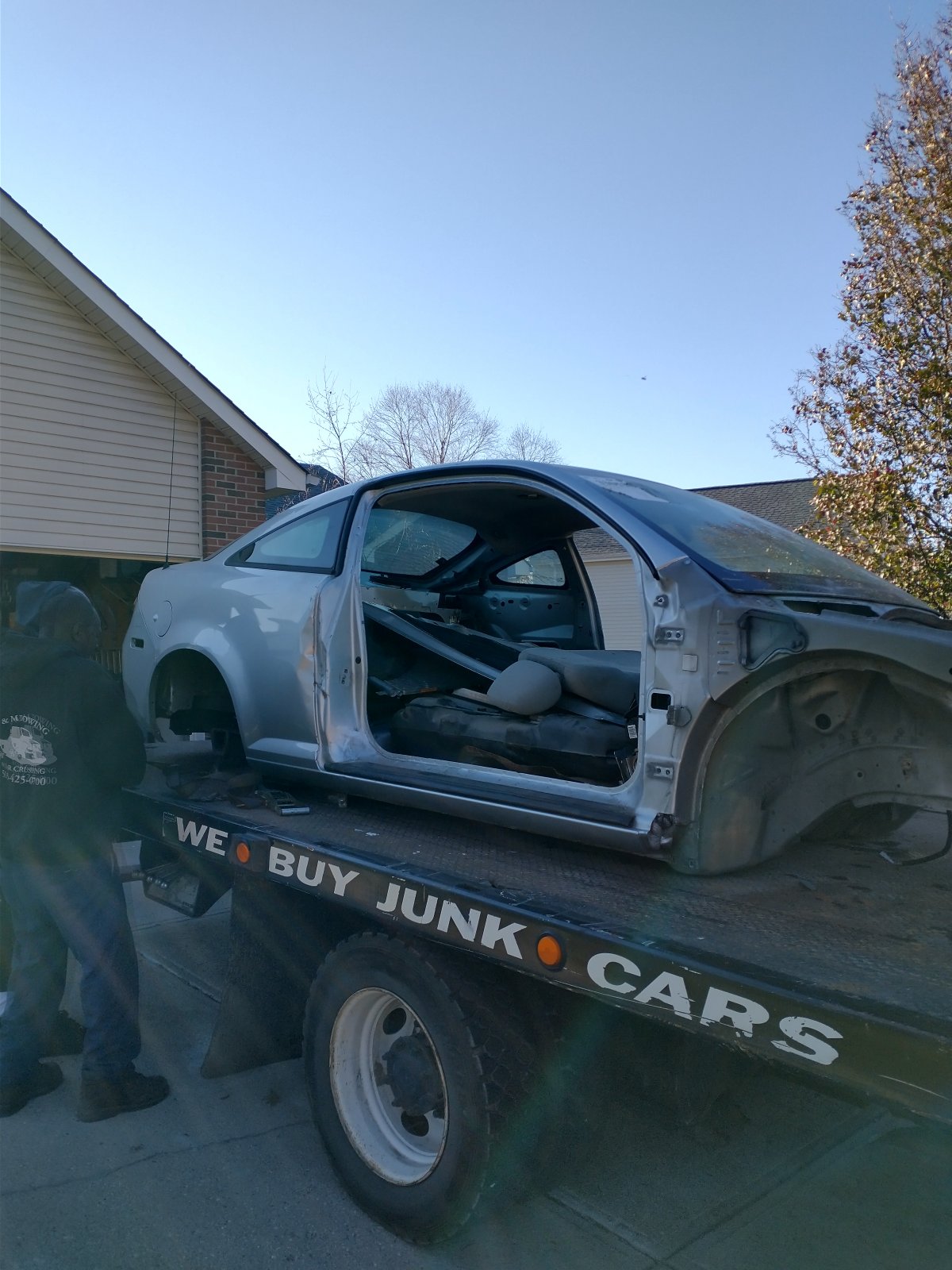

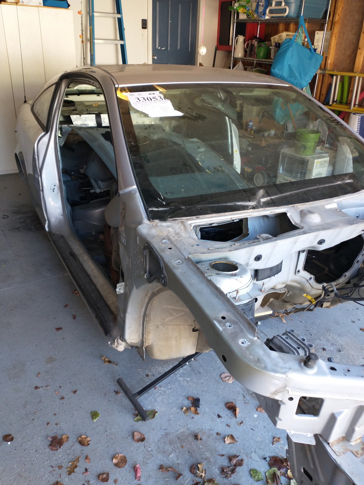

Bought a 2006 manual LS donor with 168k miles from the IAAI auction. It had a minor front-end collision, but I was actually able to drive it into the garage. Discovered later there was no water in the radiator, but no additional damage done. Had the same problems with rust and frozen nuts & bolts that other builders have reported. No insurmountable problems with the teardown. I had a local scrapyard come pick up the carcass with no problems. They gave me $85 bucks for it!

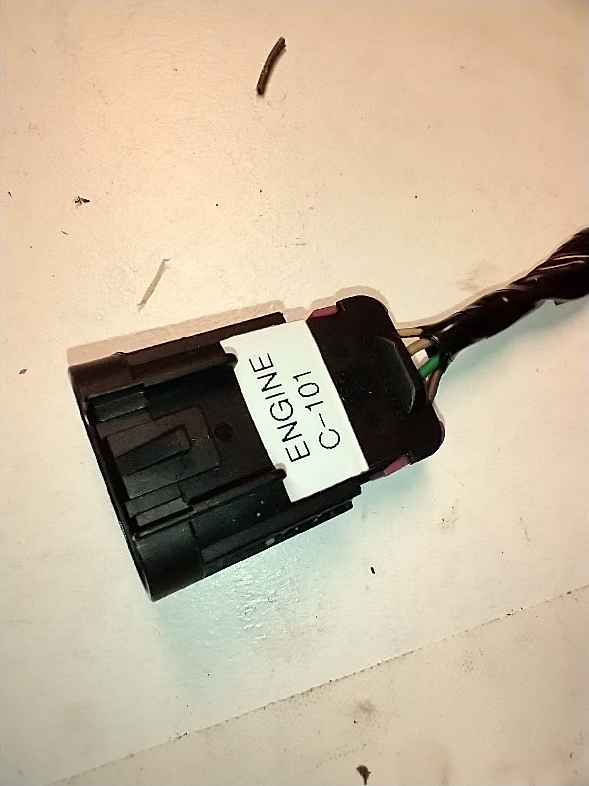

- When the videos have you cut out all of the wires attached to the ABS connector, you end up cutting out this connector
but this is the pathway for a basic LS manual to get the data wires from the BCM to the engine bay, and then into the ECM. It's also the pathway from the reverse sensor to the backup lights. There's a 4th brown wire that has no mate on the mating connector in the engine bay, at least on my donor.

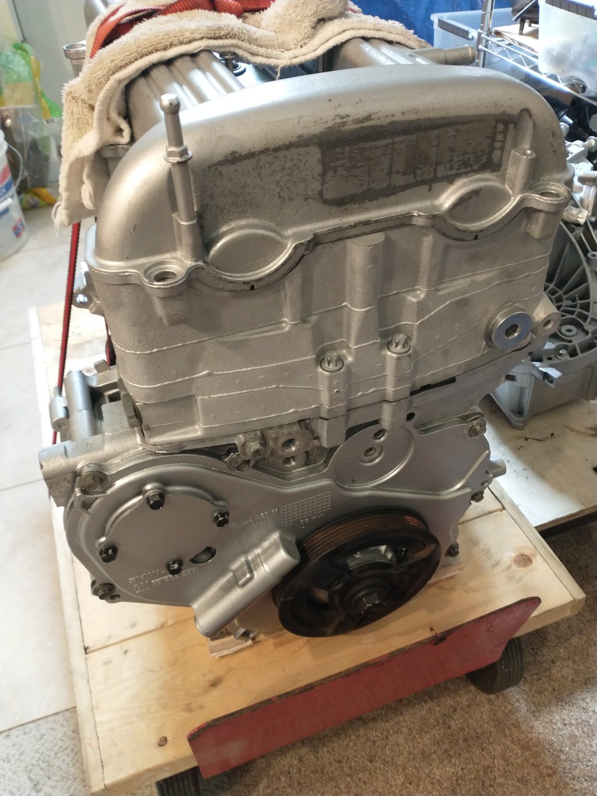

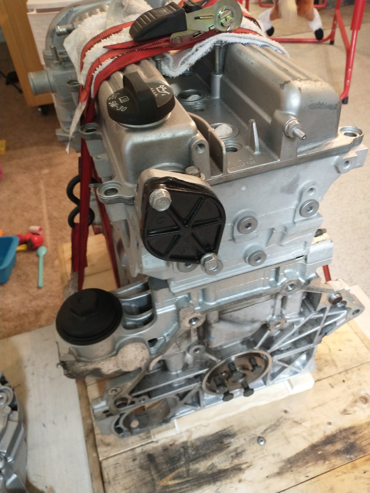

Spent most of April rebuilding the engine. New rings, main and rod bearings, valve job, clutch and flywheel, and new timing chain kit. I was surprised how little wear there was with 190k miles. Biggest ugly surprise was how much all of the torque -to-yield bolts ended up costing. Still looking for the flywheel bolts.
That other brown wire is used on Automatic cars. This is where the body harness begins to be universal, to a certain/minor extent. They are somewhat universal within a specific year. They may be different for the SS cars, but for the base and the LT I've not noted any differences yet.

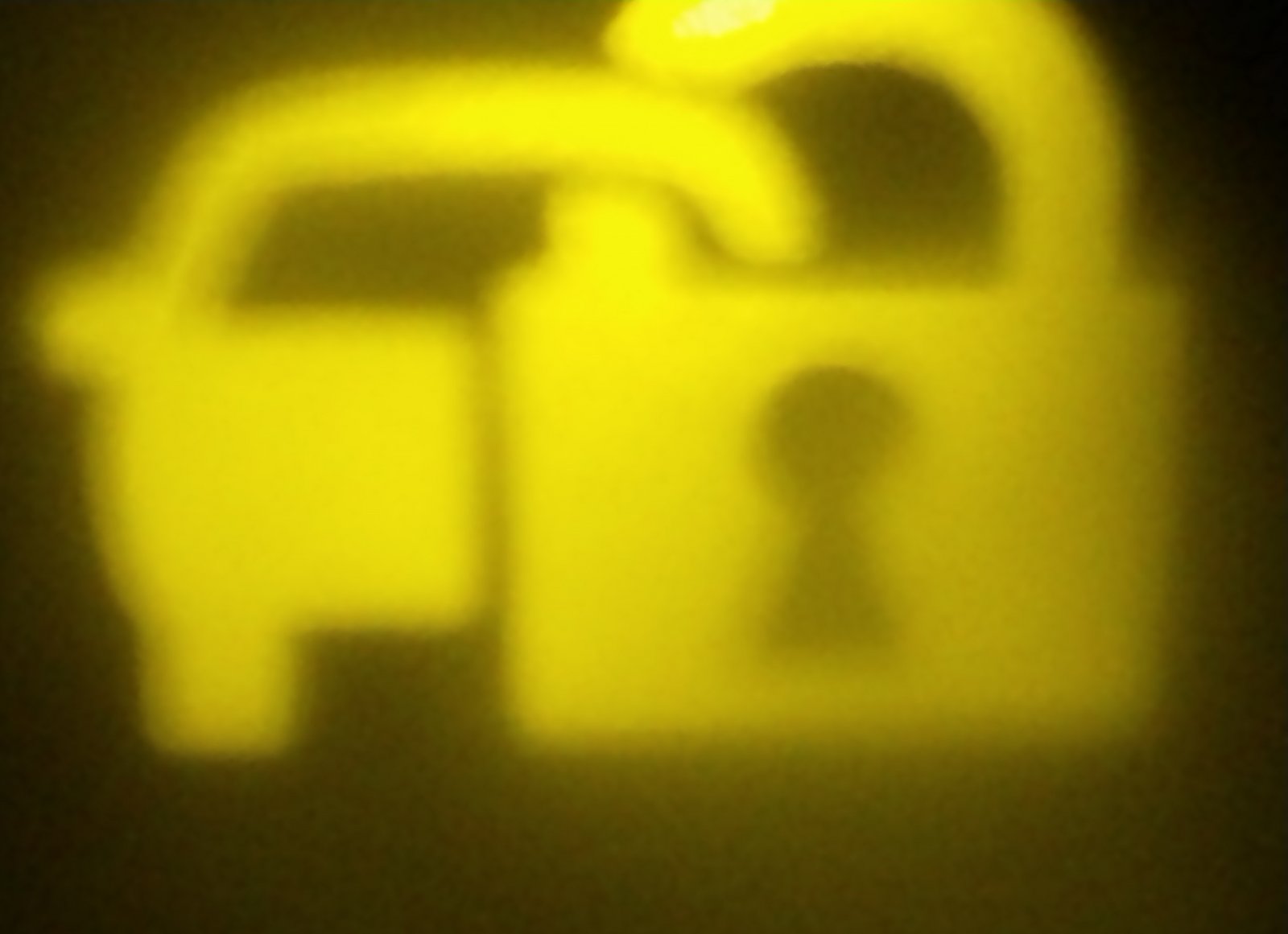

I had to replace my ignition switch because the anti theft coil got destroyed when I removed the steering wheel. The cluster is showing this symbol:
Which I think relates to the anti theft system. How do I convince the BCM that my new switch and key are OK?
It's also possible my starter is bad; it's also a replacement.
