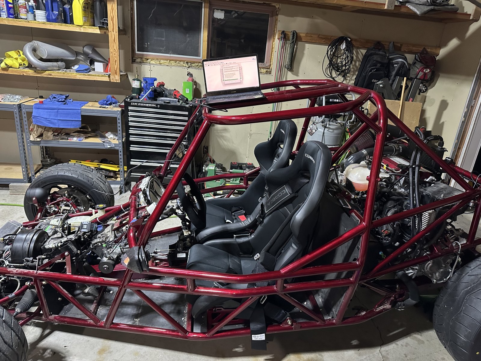

V1 Riley's Full Cage Goblin -07 SS/TC F23 #457

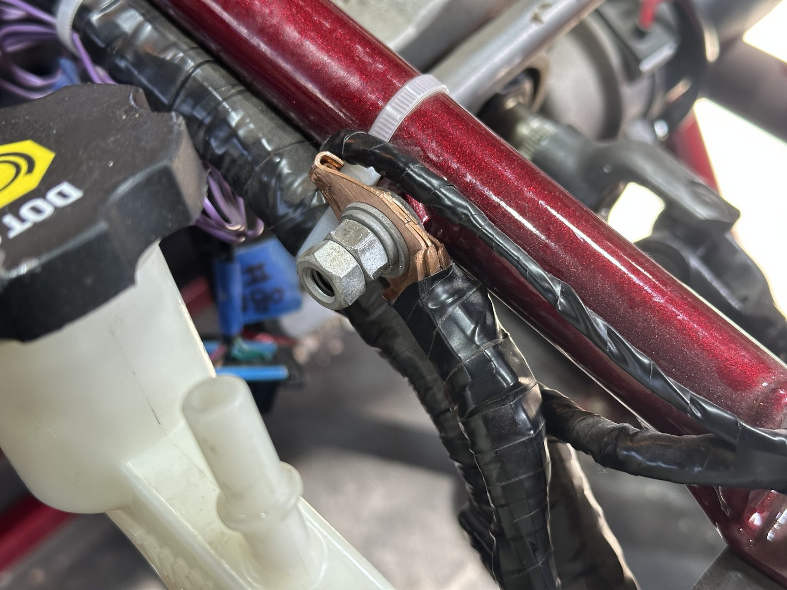

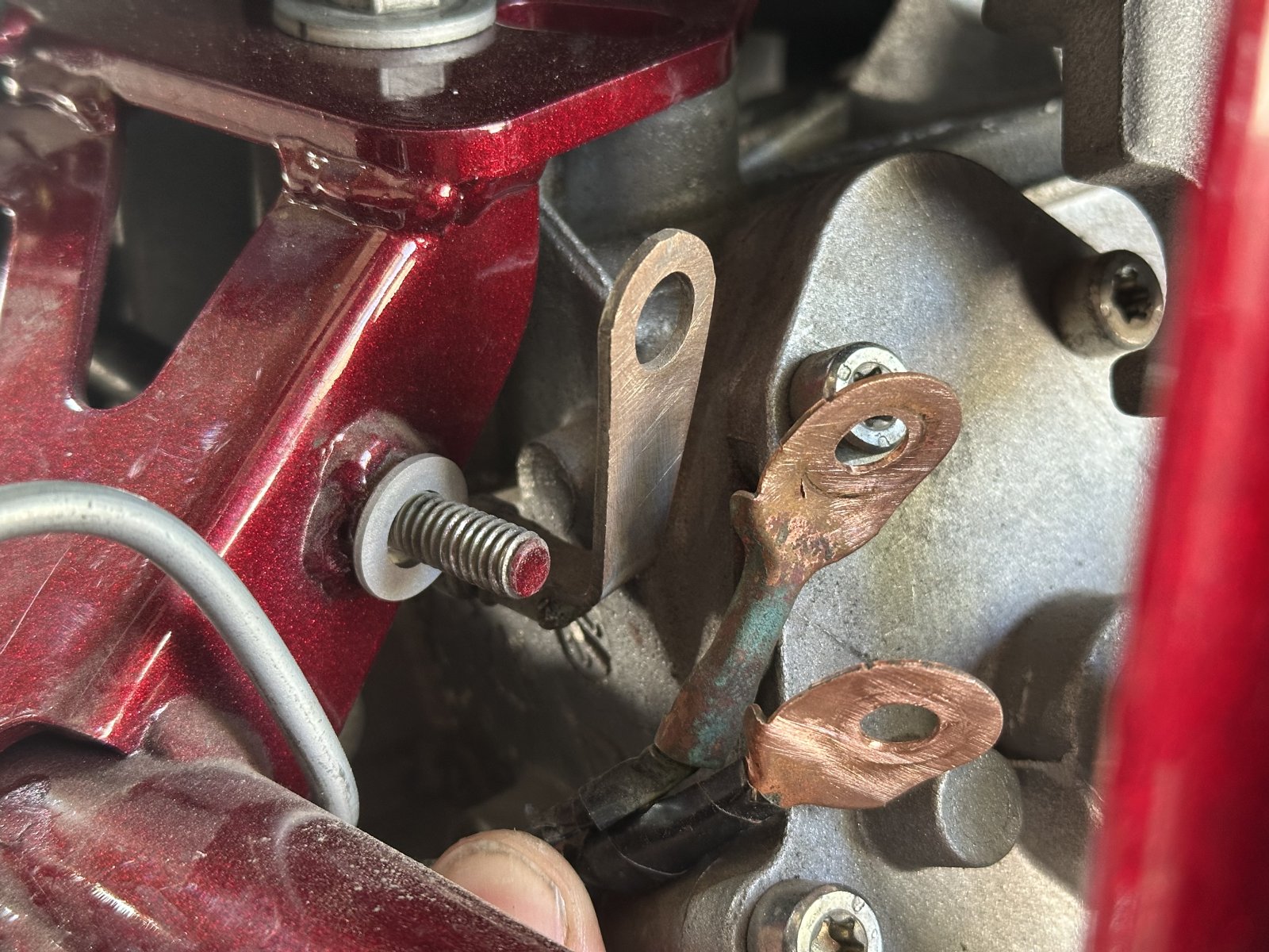

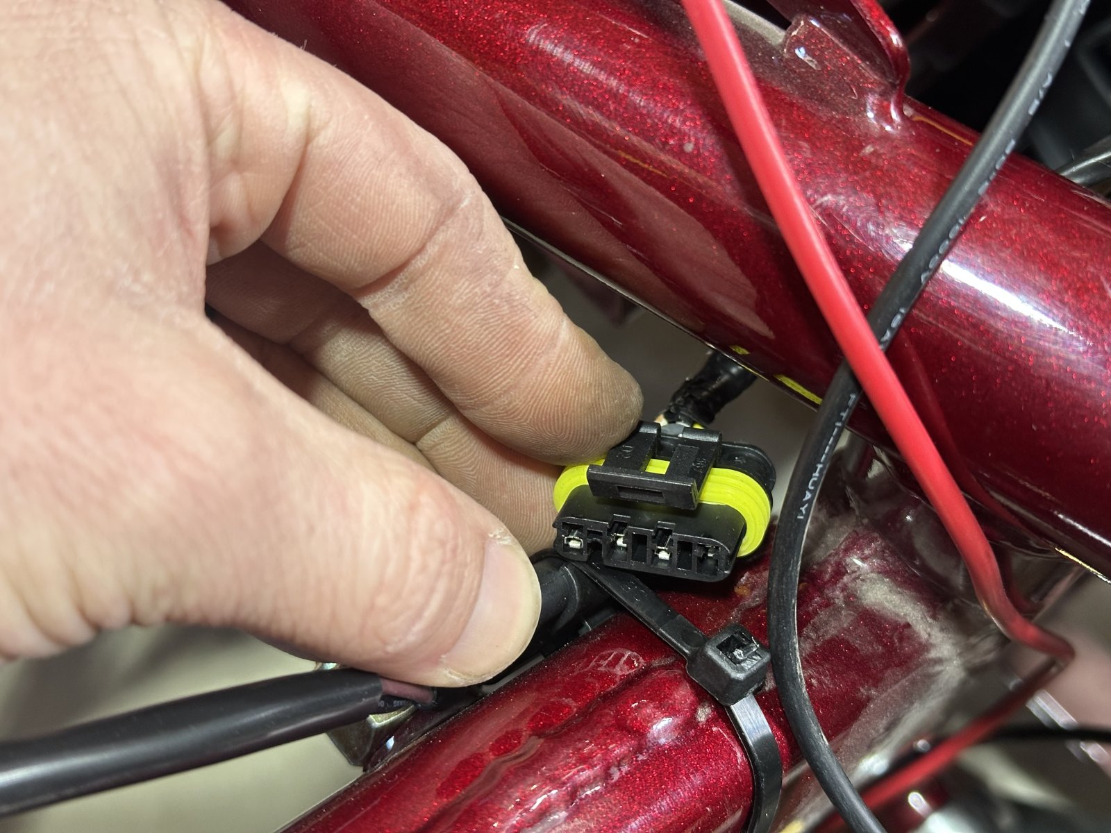

Yesterday I spent a few minutes working on the car. I solved the headlight problem; the idiot that installed the connector didn't push the pins into the connector all the way, so contact was poor. easy fix.
55887
I also went around and refreshed all of the ground spades with a piece of sandpaper. I also removed the washers and nuts from the front and rear ground post, stripped the powdercoat off of them using a tin can and some leftover Strippex from my coil spring powdercoating adventure. Now there is a very clean ground connection.
55888

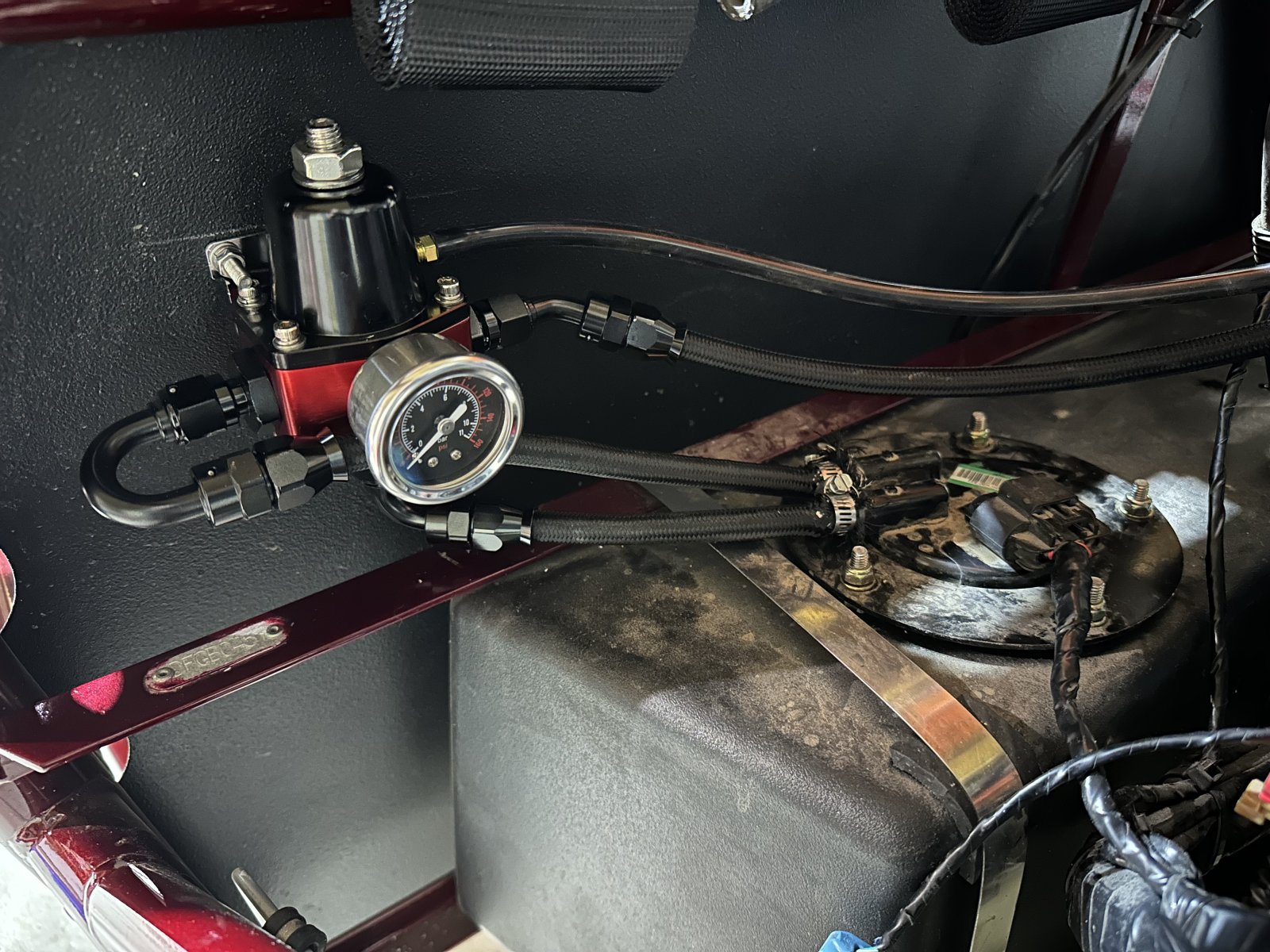

Finally, I ordered a BRFPR, some PTFE AN6 hose/connectors, and a single inlet/outlet fuel filter. It is time to refresh my fuel system.

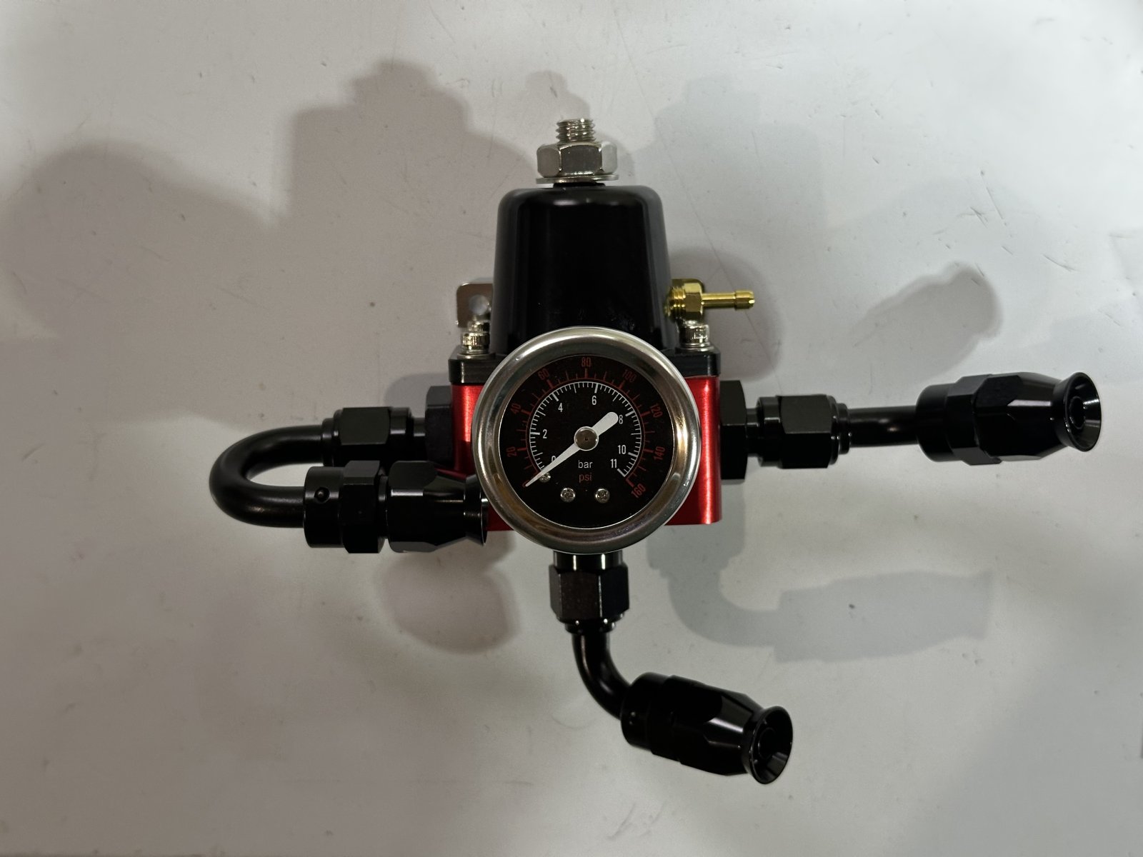

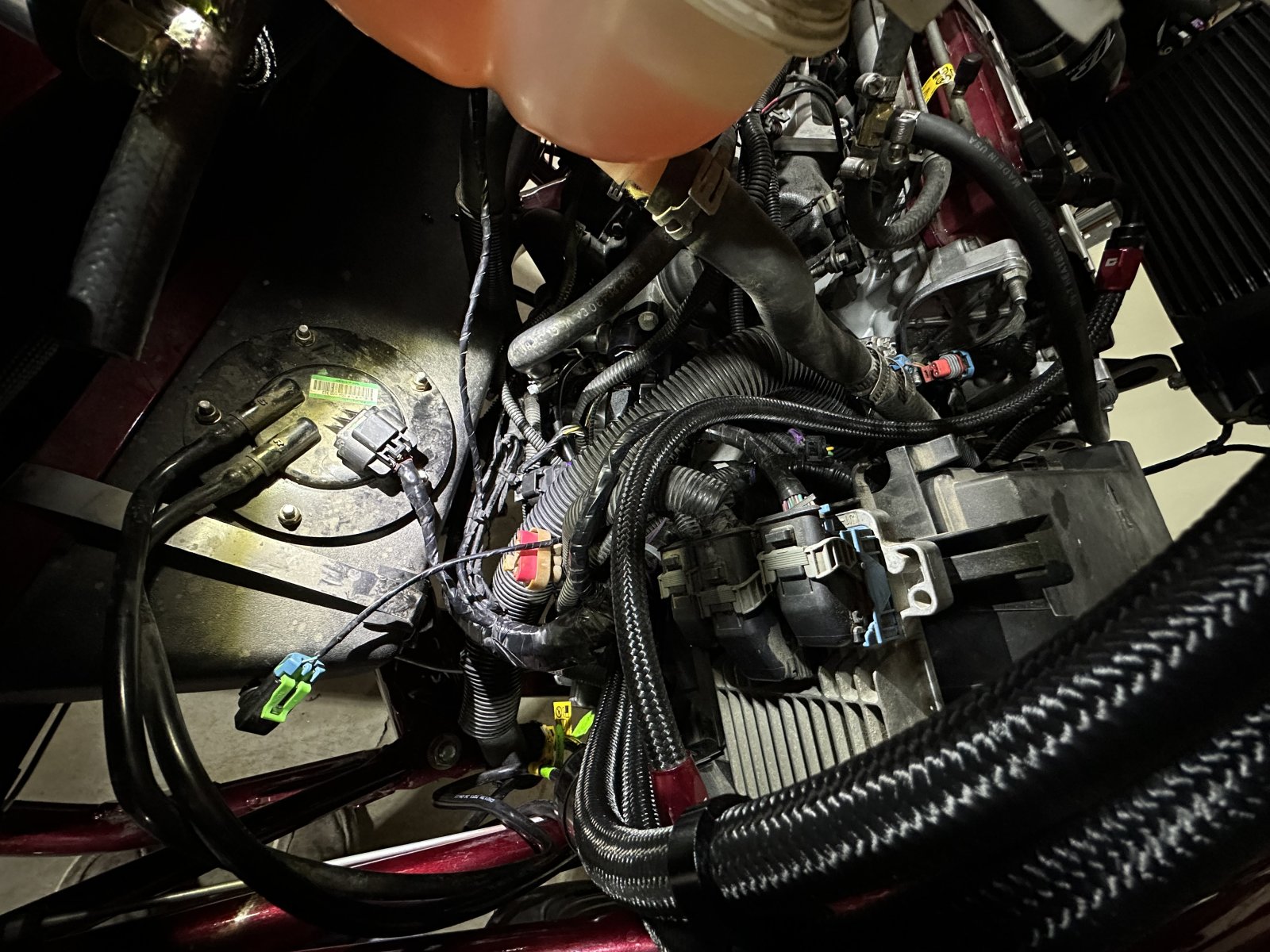

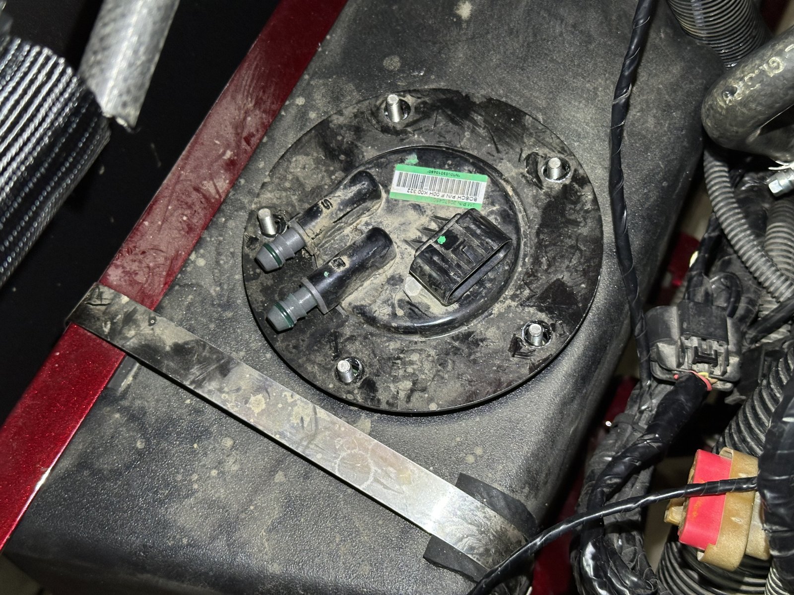

Yesterday I took the time to install the boost reference fuel pressure regulator and PTFE AN6 hose I linked in my last post. This morning I primed the system up by pulling the schrader valve off of the fuel rail, attaching a hose connected to a jug, and jumping the fuel pump relay from pin 87 to 30. I also set the BRFPR to about 3 bar (45 PSI) while vented to atmosphere, which was suggested to me by the tuner i'm working with at ZZP. I'd like to take the car out for a quick RIP and record a log to send to the tuner, but it's just pouring rain today and yesterday. Next time I get good weather, this is what i'll do.
55915
before vs after
55916
Install was pretty easy, minus PTFE AN6 hose itself... The wire weave in the hose was a major PITA to deal with, especially for the connection to the supply and return port off the top of the bulkhead. For this connection, I had to unravel the thread and wire around the hose so the PTFE liner could expand over the barbed connection point. I also installed a hose clamp to attempt to keep it secured.
55917
55918

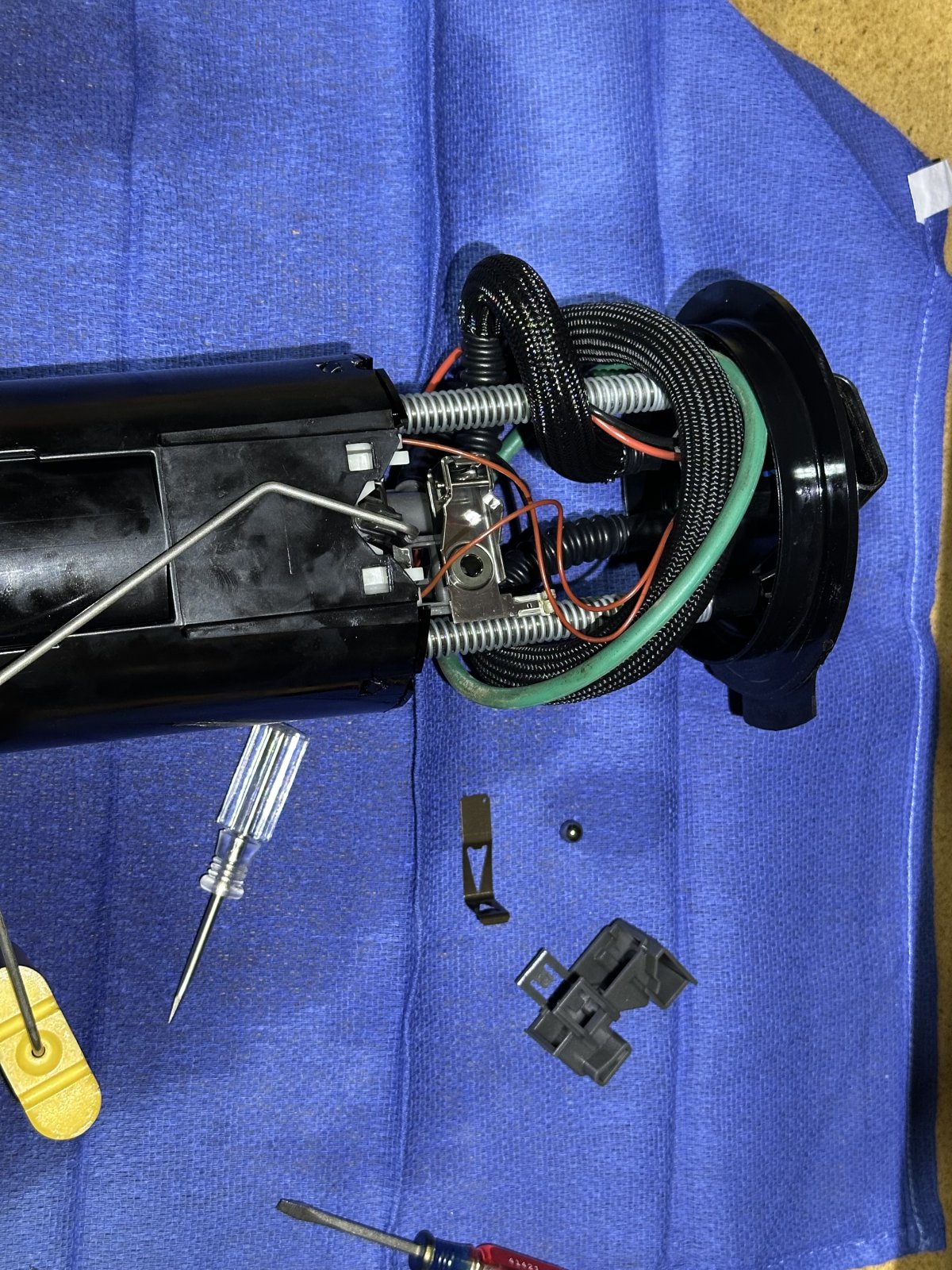

Fun fact, PTFE is a material that we use in suture that we implement in cardiac surgery. I noticed the white suture yesterday morning and connected the dots.
I'm certainly not going to tell you your install is wrong and I don't know for a fact that any other configuration is better or meaningfully different, but it is my understanding that putting the regulator on a return line from the rail is preferable compared to deadheading the supply line to the rail. The theory makes sense to me that putting the regulator on a return line from the rail keeps the fuel pressure in the rail more in line with what the regulator is commanding, but I don't know if the difference between that and deadheading the rail is worth the extra effort. It'll require an extra fitting or two on the rail and new or reworked lines compared to what you have set up, but if that's something you ever want to set up, now's probably the time to do it.
I will say that none of the big Ecotec shops recommend the conversion, but I don't know if that's because it's not worth the effort or it's not worth the effort in a Cobalt.
Otherwise, looks good!
newbtrying
This flow path is pretty much identical to stock LSJ design, but with the added benefit of boost reference regulation. I’m confident it’ll be adequate.

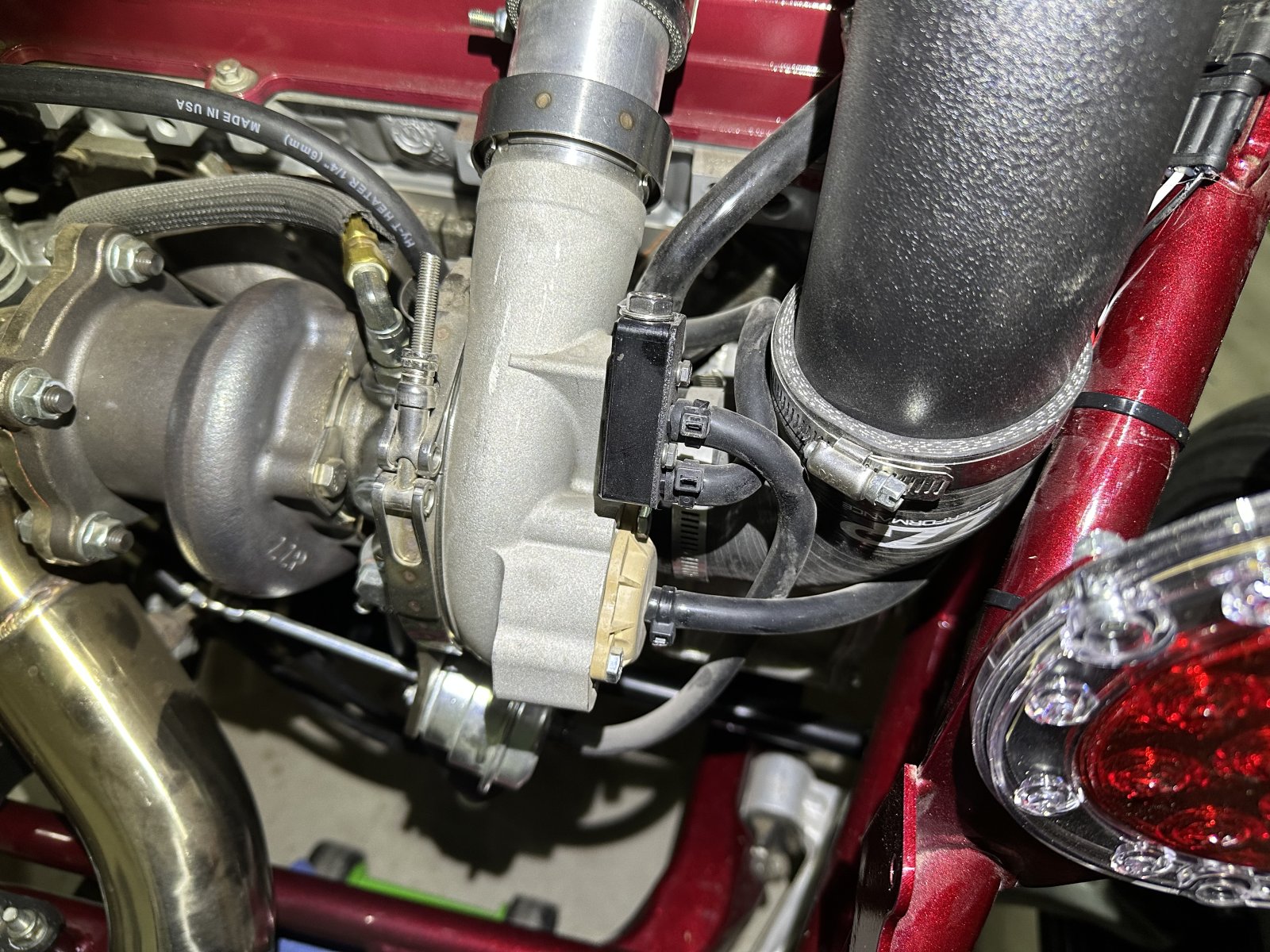

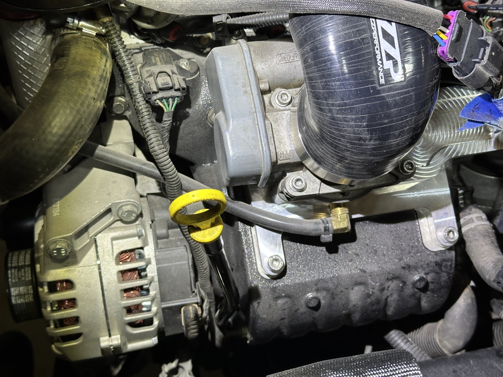

Gremlin number 2 is... I am not getting the amount of boost that I think I should. ~7 psi vs 24 psi. I have a Z57 turbo and a manual ZZP boost controller currently (will probably definitely upgrade this at some point in the future to an electronic boost controller). That said, I'm not confident that my boost controller is plumbed in correctly, considering that I don't even know what the beige/tan circular cover is on my turbo. It's currently connected to the nipple below the throttle body. does anyone have any input on this matter? I'll attach pics that show the turbo boost controller plumbing.
55966
55967
55968

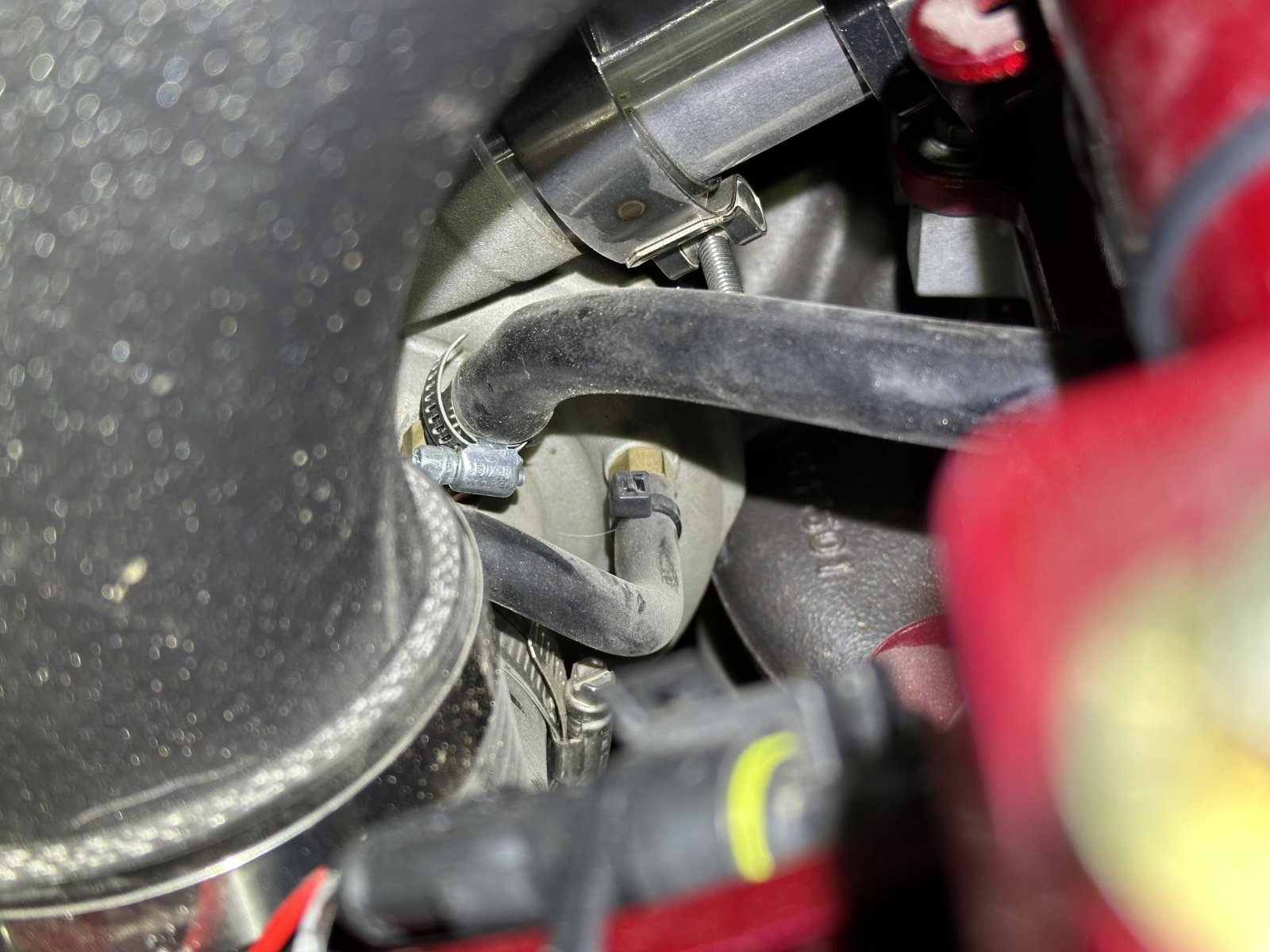

The beige/tan circular cover on the turbo is the vacuum chamber for the blow off valve, on the intake side of the turbo.
The hose for a blow-off valve (BOV) connects to a vacuum source on the intake manifold, downstream of the throttle body (after the butterfly valve).
The steel chamber at the bottom of your turbo is controlling the wastegate on the exhaust side of the turbo.
The wastegate connects to a boost pressure source, looks like you have it connected to a boost controller.
As a resident of Montana, I think you can just register it. Us, non-Montana residents, need to register in our local state. If our local state makes registering a goblin difficult or impossible, we can get a Montana LLC, sell it the goblin, and the LLC is allowed to register in Montana.
newbtrying
The steel vacuum chamber at the bottom of your turbo is controlling the wastegate on the exhaust side of the turbo.
The wastegate connects to a boost pressure source, looks like you have some sort of boost controller?
Yes, the black box is the manual boost controller.
Ok, this confirms to me that this is plumbed correctly. The next course of action is to bypass the boost controller and go from the compressor housing straight to the wastegate. According to the tuner, that should produce about 14-17 lbs of boost. If this is the result, I need a new boost controller and this one is faulty.
It could be the boost controller. Your bypass test should shed some light on this.
Otherwise:
It could be a leaky intake plumbing. I would check with soapy water is a spray bottle, and see if it makes bubbles when under turbo pressure.
It could be an exhaust leak. Check for any soot marks, or a cotton ball on a string, and see if any exhaust puffs will blow the cotton ball.
It could be leaks in the vacuum lines.

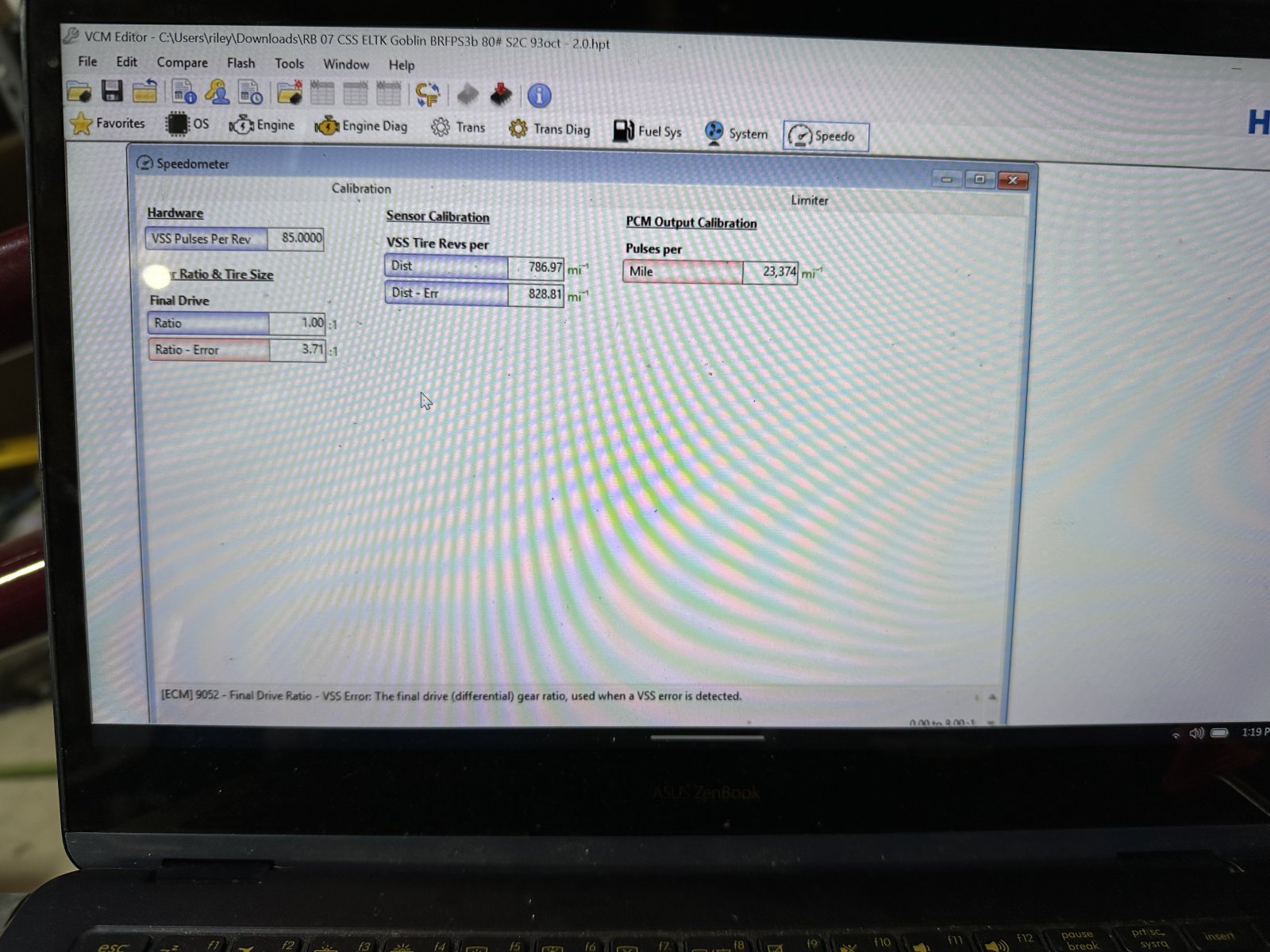

56071

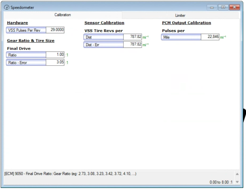

This is my speedo calibration for an LSJ with a 3.84 F23 and 245/45R17 tires. The VSS Pulses Per Rev is the first thing that has to change for the trans swap because the F23 and F35 reluctor have a different number of teeth. I recognize too now the link I sent you to only shows the settings for an LNF which has different parameters in the tune, my bad.
I don't think the trans ratio matters because the diff and tires are 1:1, but the Pulses per Mile will depend on your tire size.
newbtrying
View attachment 56071This is my speedo calibration for an LSJ with a 3.84 F23 and 245/45R17 tires. The VSS Pulses Per Rev is the first thing that has to change for the trans swap because the F23 and F35 reluctor have a different number of teeth. I recognize too now the link I sent you to only shows the settings for an LNF which has different parameters in the tune, my bad.
Ah, yes. I see I missed that detail. I read about the different tooth count on the reluctor, and had to use that for the pulses per mile calc, but failed to change the VSS pulses per rev.

On a different note, I heard back from ZZP with an updated tune. They also changed the VSS Pulse/mile on the tune so I can hopefully read speed properly from my F23 transmission. Also, to address the boost issue, I do have the boost controller hooked up properly (confirmed by tuner), but the result isn't as desired for an undetermined reason. Once I can spend more time on the road (When I get plates on the car), I'll disconnect the boost controller and just direct pipe a line from the compressor side to the wastegate, which should provide about 14-17 PSI of boost on the Z57 turbo i have. If I don't see this, I'll search for boost leaks.
