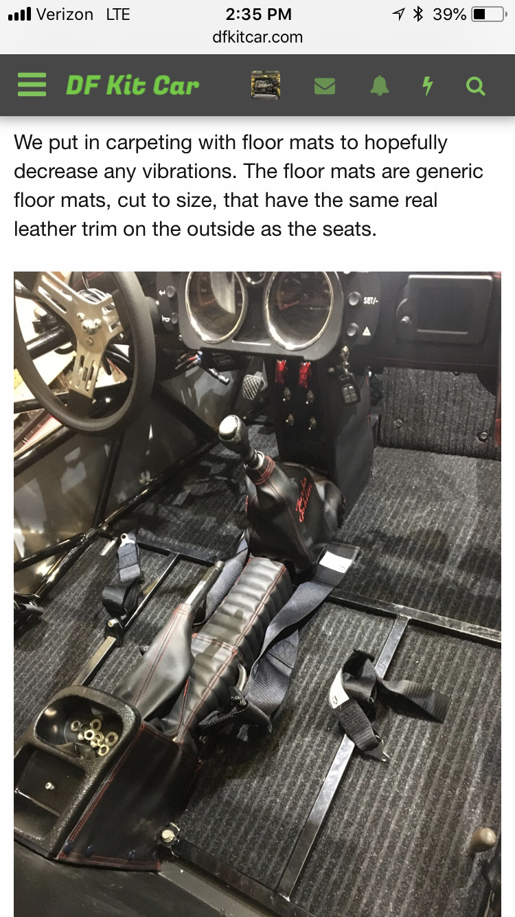

I've never used 4,5,6 point harnesses or mounted them before. Does anyone have pictures of where and how they mounted their harnesses to the chassis? So far my research says camlock is the way to go for ease of in and out but im still quite naive..... and orange camlock harness are few and far between for a decent price but i'll likely be leaning towards black for that reason.

The chassis is built for up to a 5-point harness. All of the mounting points are there, one in the seat center, two hip mounts, and the two shoulder mounts to the tube behind the seat.
As far as preference, there will be a lot of opinions here. We elected for the 4-point because Kaleb didn't like the idea of the strap bunching up his nuggets. Me, it doesn't matter anymore. I do find the lap part of the belt tends to ride up on my large frontal girth. I find the 4-point much easier to get in and out for not only me but new riders. The 5-points harness require a 30-minute tutorial for the harness virgins and which can give you that opportunity to get extra close and touch-feely with your favorite passenger friend; that can be a very good thing or a very bad thing.
Obviously, the 5-point will give you more security than the 4-point. The 4-point is easier to get in and out of. You have to decide which is more important. The camlock is very nice, especially to release all five harnesses at once. The 4-point also has only one button to release.
Seat choice can also make a difference on the type you should get.

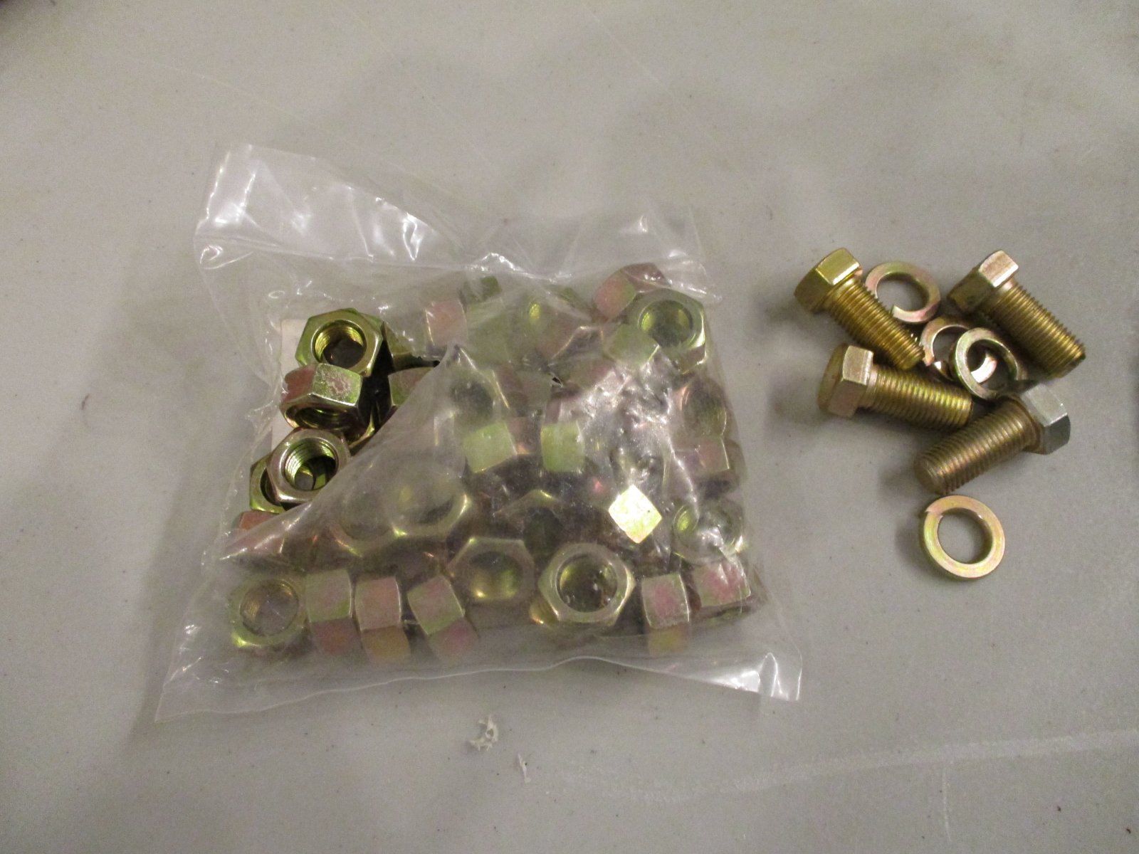

If I were to do it again, I'd get the corbeau ones. They look just a bit cooler. The seat belt bolts should be 7/16-20 or M11 x 1.25 as I've been told.
FYI on the Corbeau harnesses - they come with the 7/16-20 bolts, but not the nuts. I couldn't find the nuts here so ordered from Amazon and of course, getting 50 of them was cheaper then getting the 4 that we needed! They are 7/16-20 Grade 8 Yellow Zinc nuts and I have plenty so if anyone wants some I can get them out to you - cost of postage is all that I ask.
Corbeau bolts on right and extra nuts on left:

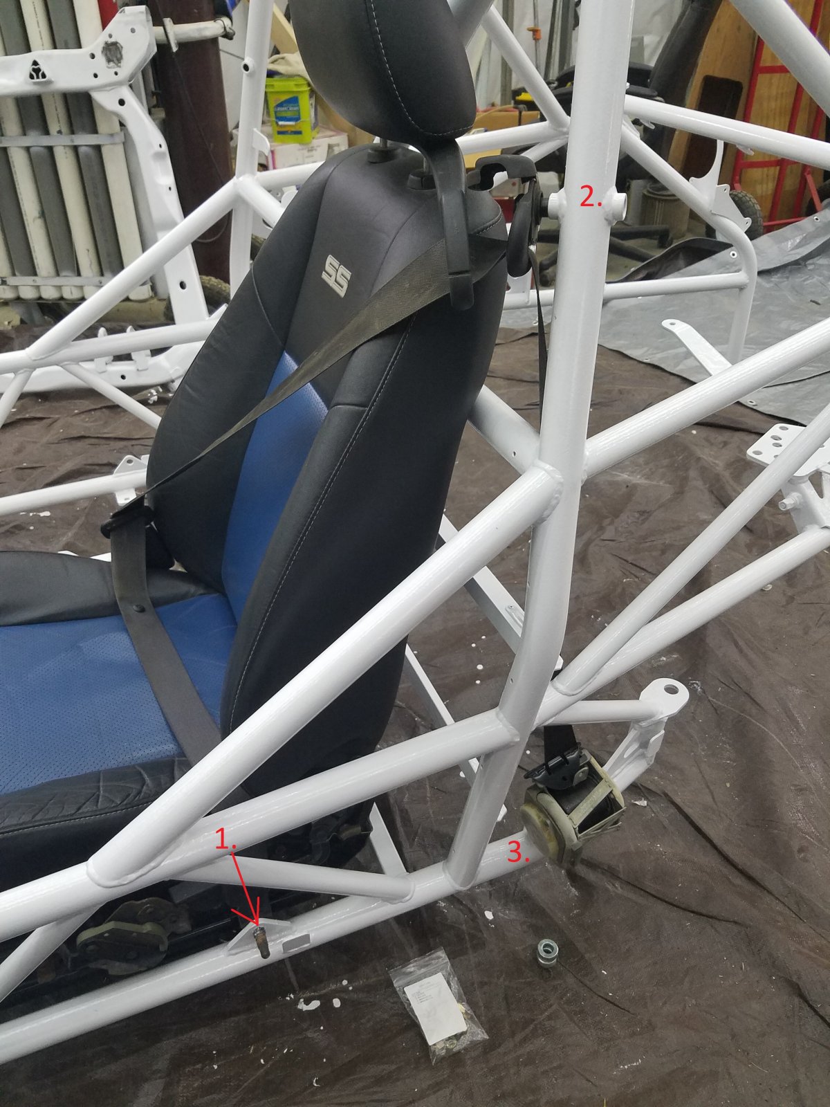

Is there hardware included for the stock seatbelts? Am I installing these correctly?
Bolt 1 came from the donor, but it needs a nut, and it doesn't have threads down to the base.
Bolt 2 was too short to make it thru the Goblin frame
Bolt 3 worked, but it seems weird that the seatbelt roller is outside the exoframe.

I don't think that is where the seat belt tensioner mounts, I wish I could tell you for sure because I am not running the stock seats but it looks like it will be occupying the same area that the side panel will be. That small tab on the back is where the side panel will rivet to. My bolts for "1" came with my 5 point harness so unfortunately I cant speak with any certainty on that. There are others on here that did run the stock seats, might be something in their build log. I will look around and let you know if I find anything
I was waiting for others to chime in because I wasn't sure of what I did was the correct method. We use the stock seat belts for inspection (only to find later he didn't care about them) and then quickly pulled them back out. For (1) use a good grade 5 or 8 bolt, washer, nut of your own. And for (2) pretty much the same thing. The bolt will need to be long enough for everything including two very thick and large washers to hold everything. (3) you can use the stock seat belt bolt there. I can't remember but can you turn it around so it will clear the side panel?
