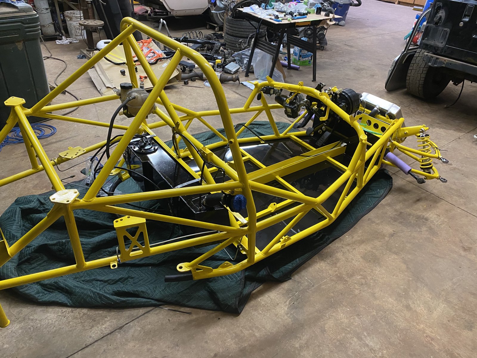

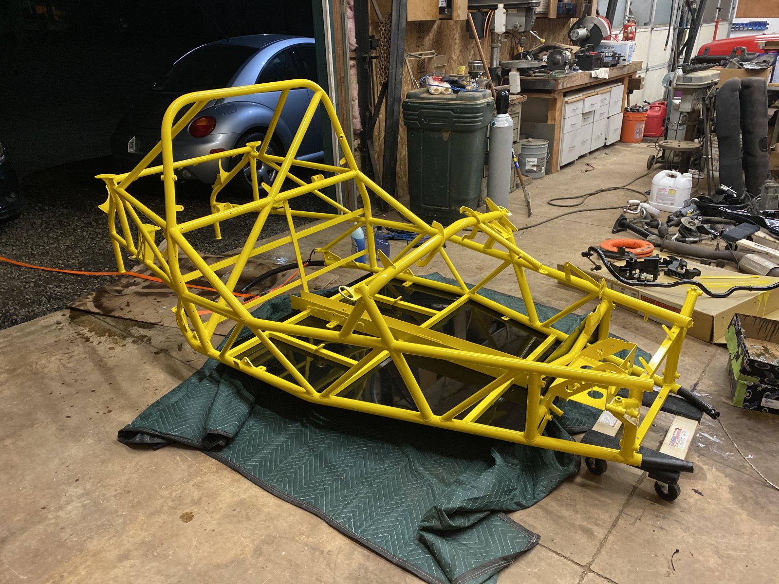

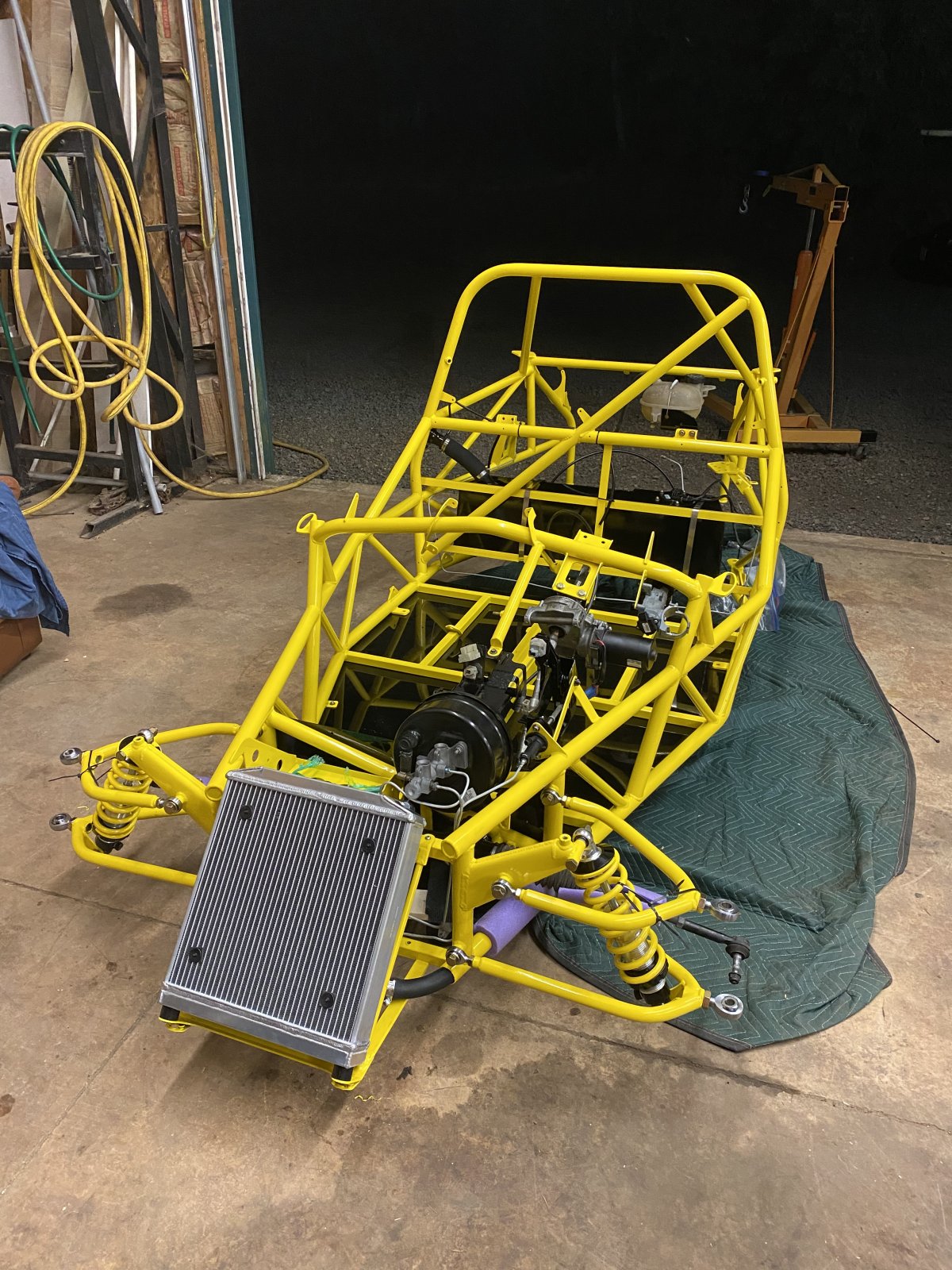

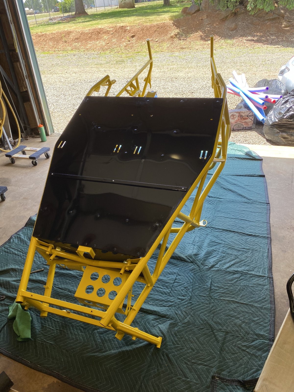

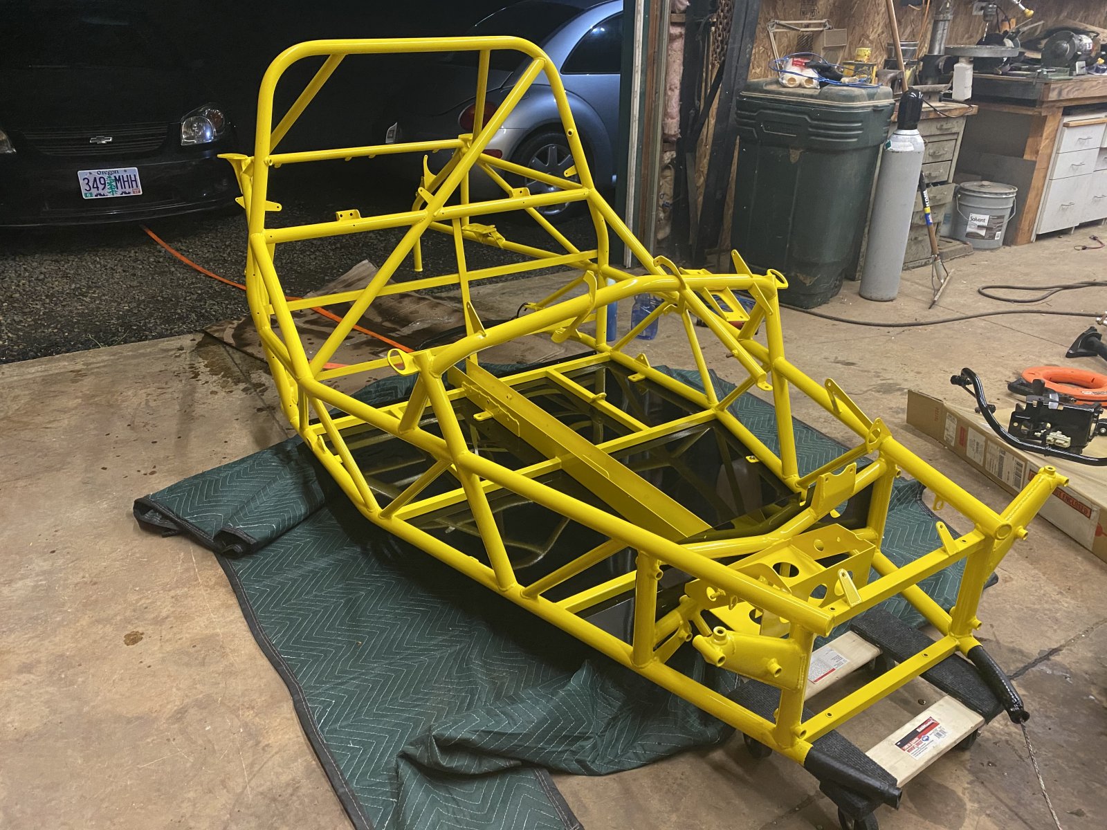

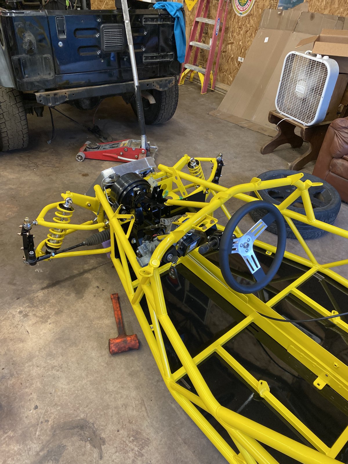

Finally putting together a build log.
my name is Justin Aguinaga. I’m located just a little east of Salem Oregon. I’m slowly putting it together at a friends shop. Using a 2006 SS/SC with LSD transmission. I picked up originally a SS/SC 2006 with LSD but, I’m about 2 grand fixing issues with it and need to sell it. So far I’m almost done with the first video.

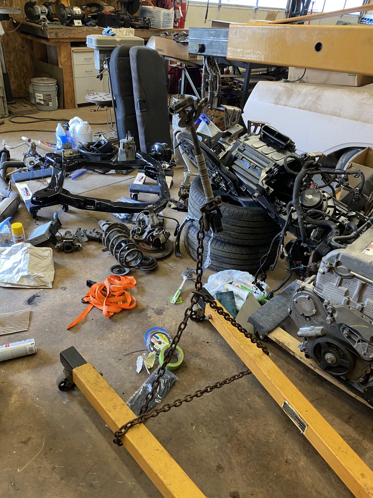

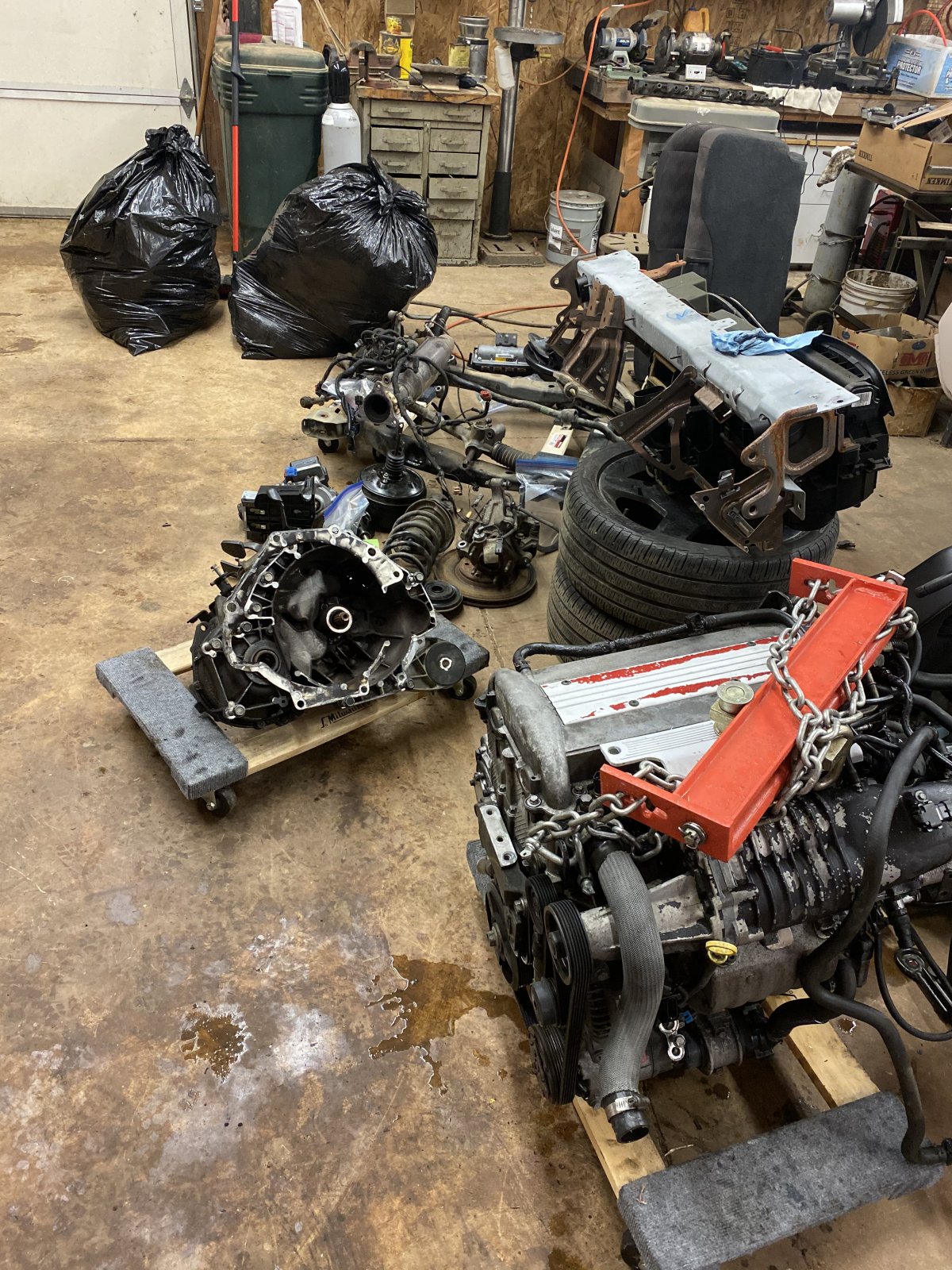

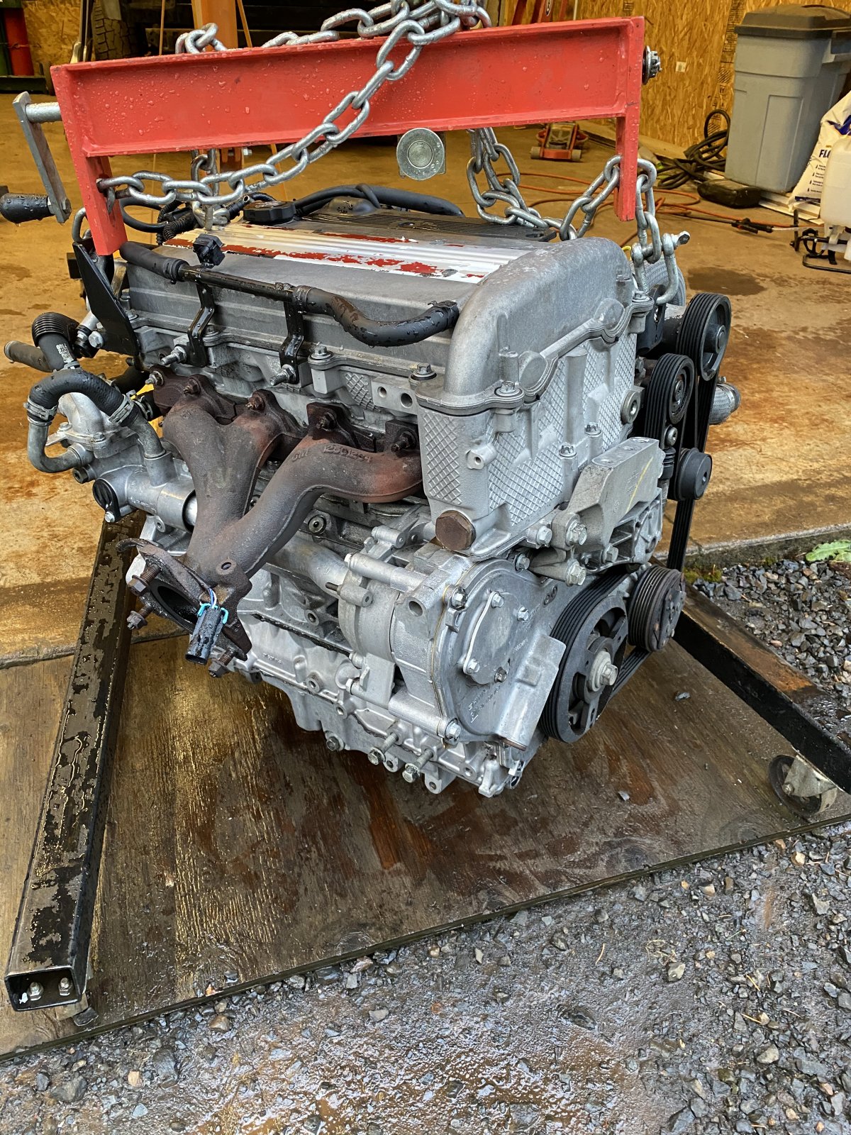

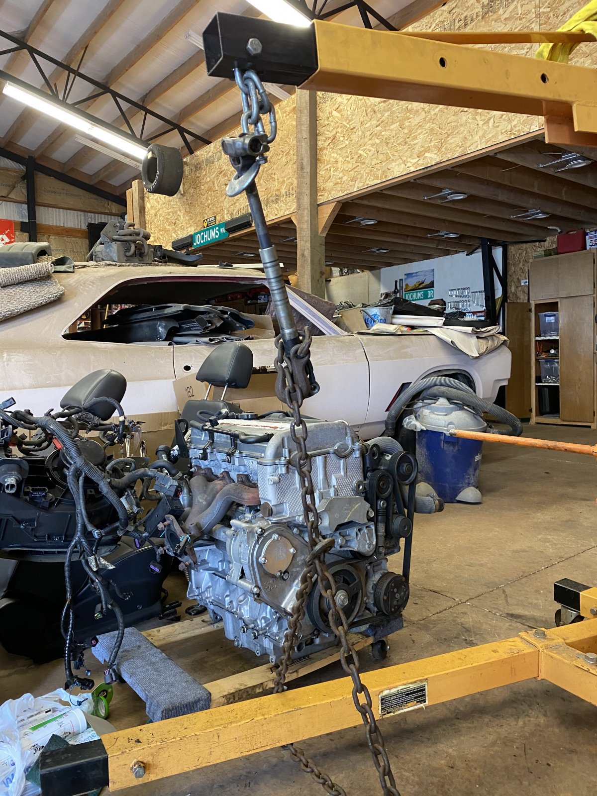

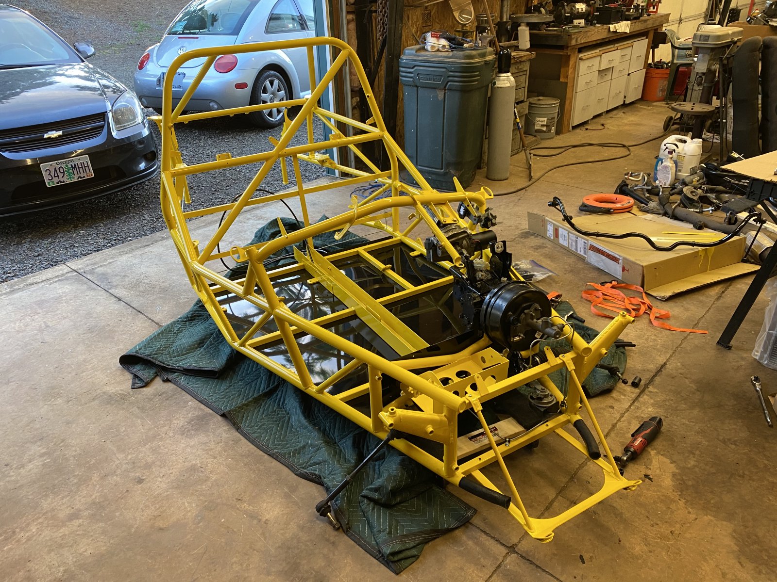

After a couple days got an update for everyone. Used the cherry picker method, after getting the pin hammered out. I highly recommend putting a safety strap on the top section. Almost took out the shop lights above me.

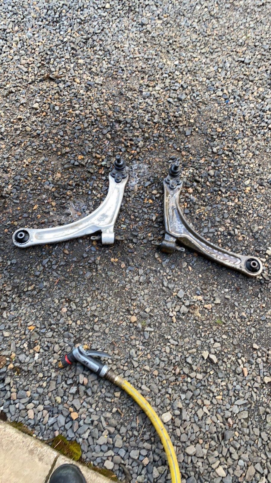

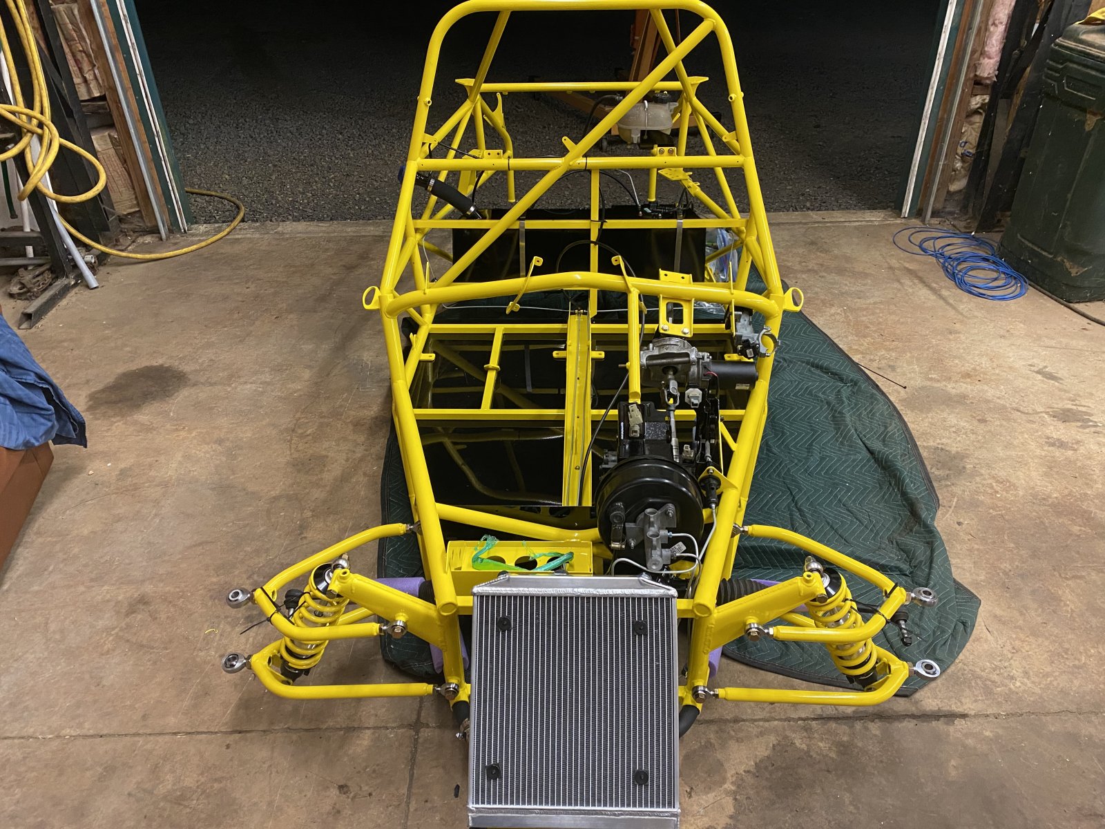

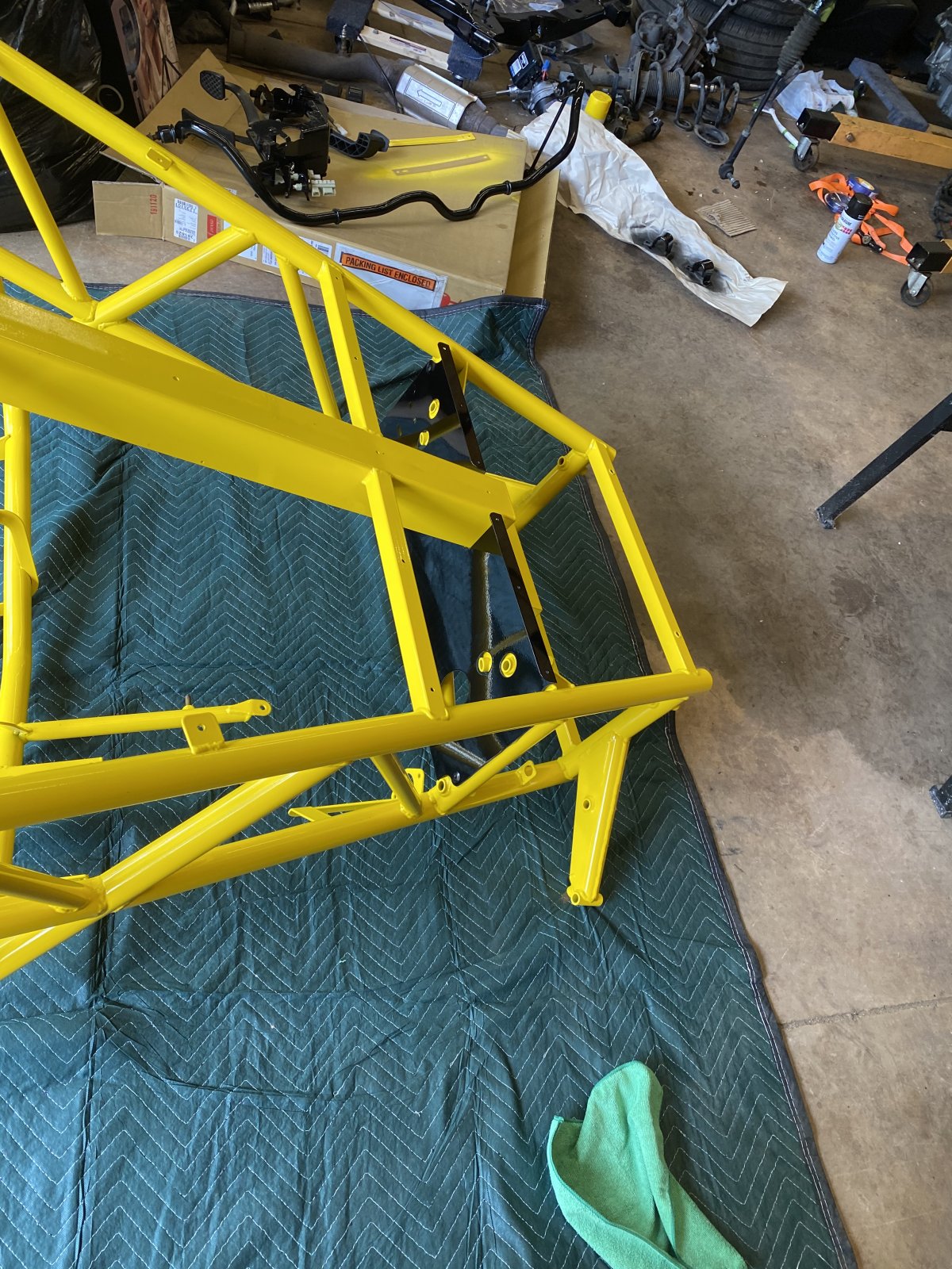

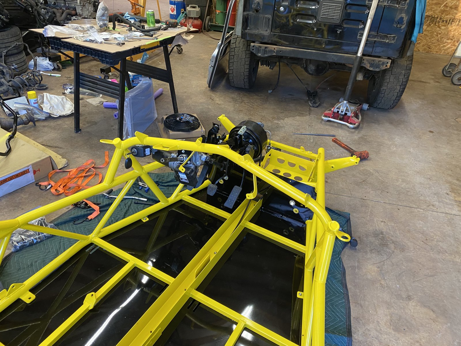

Little up date.
I have sent my wire harness in, so I’m plugging away on random things. If anyone catches something wrong please correct me.

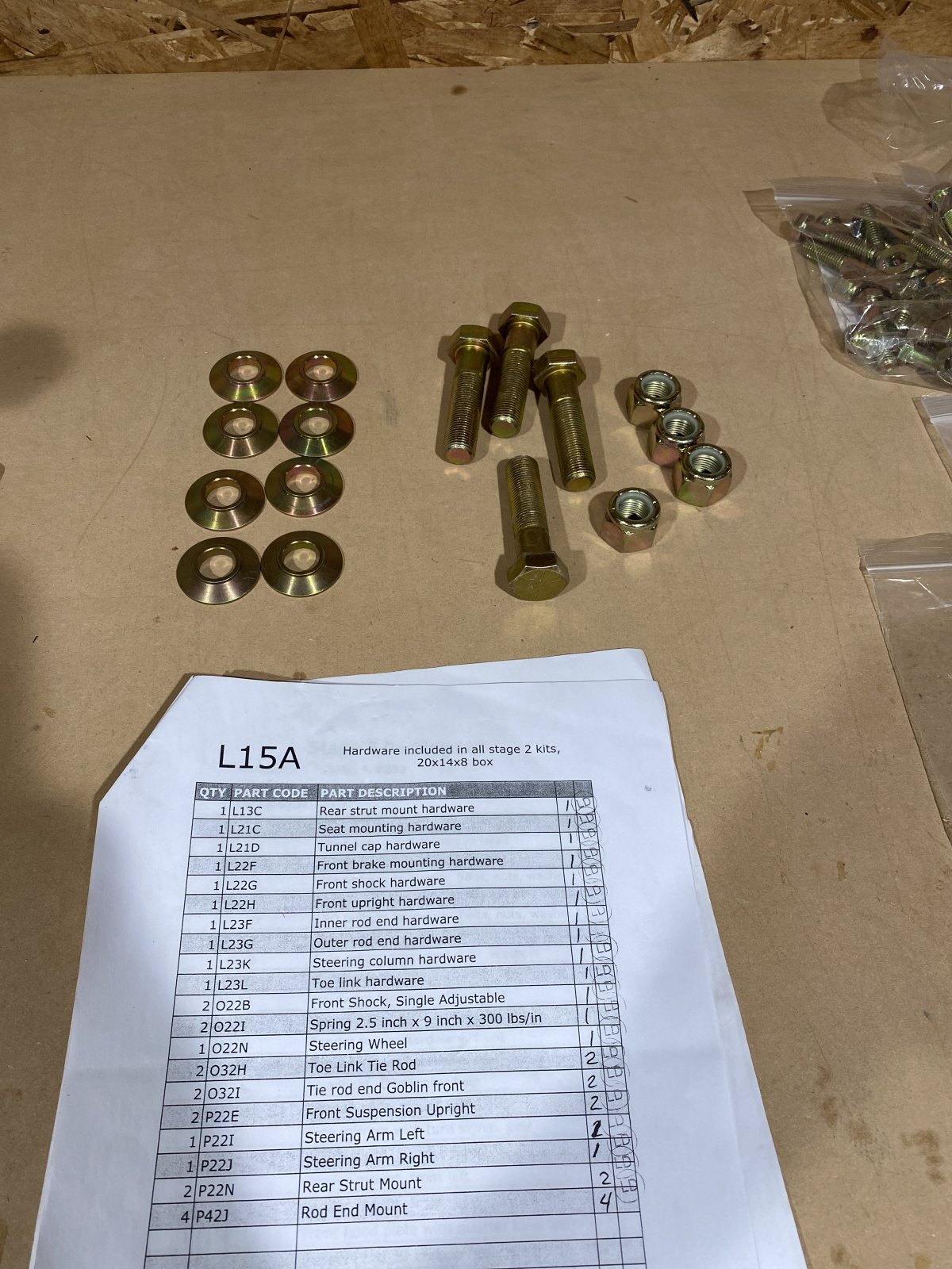

Aguinaga

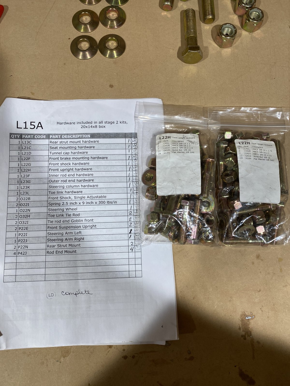

Can some body help, need to know if the parts I’m missing is called rod end mounts for sure. Needless to say I don’t have them. Need to order them

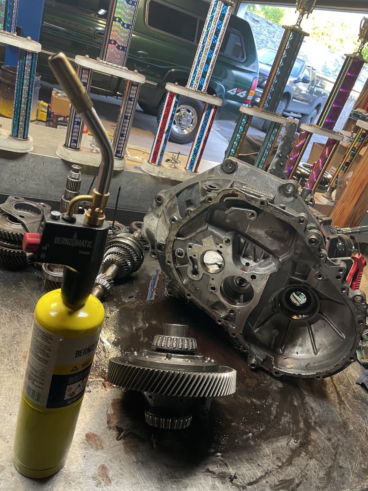

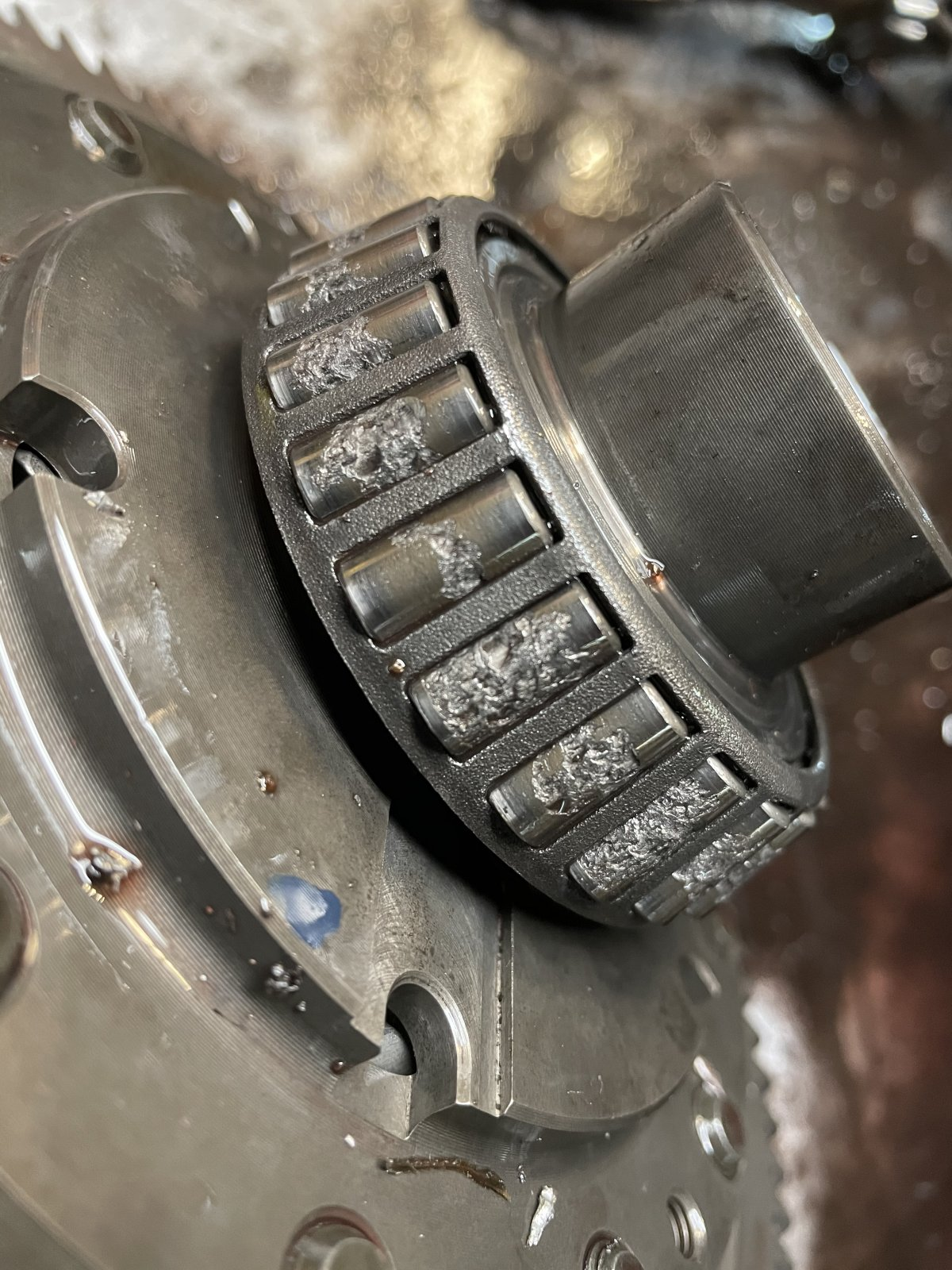

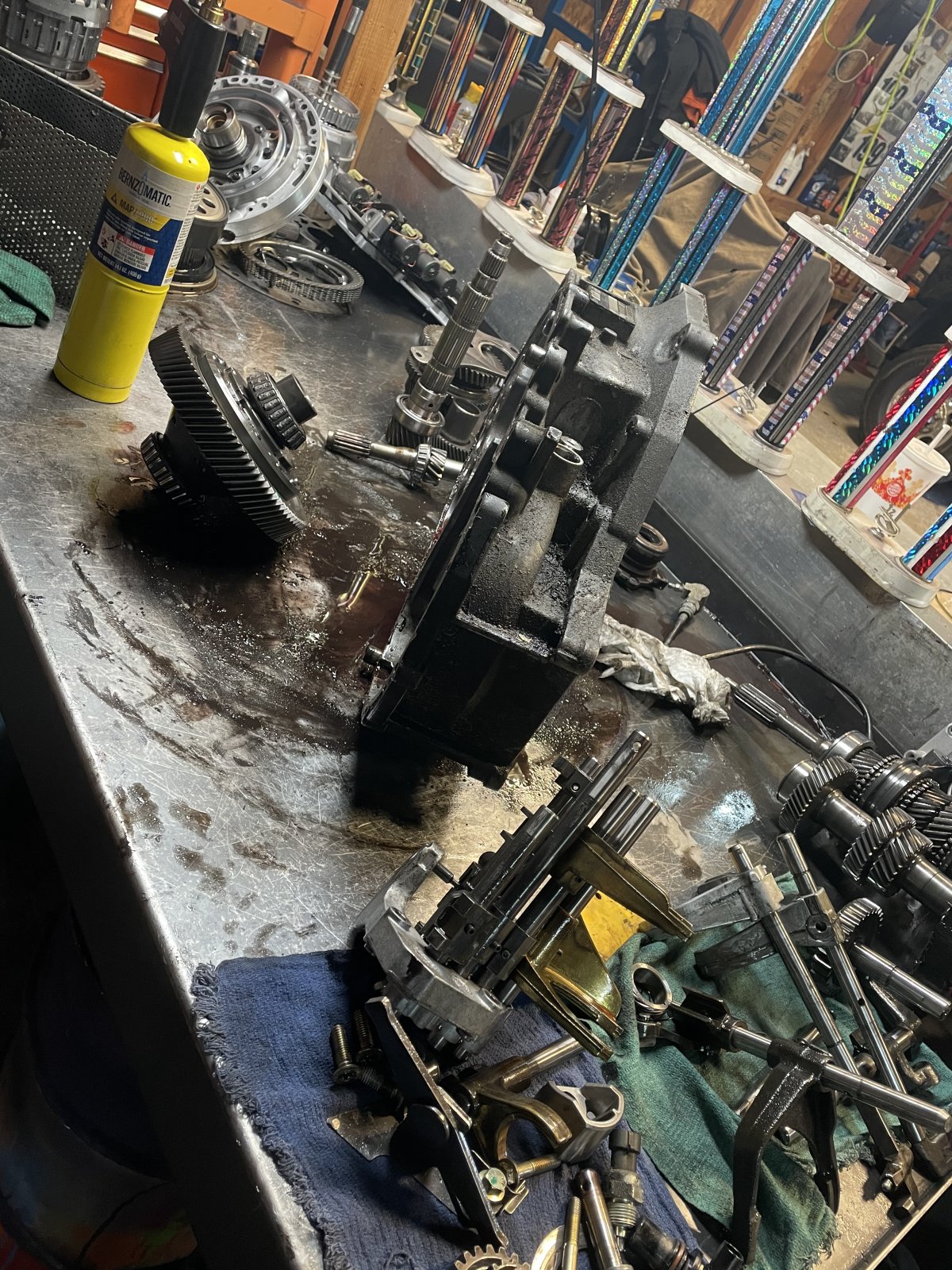

Well I knew the transmission was hurt but hey only paid 1,000 for the donor car ‍
