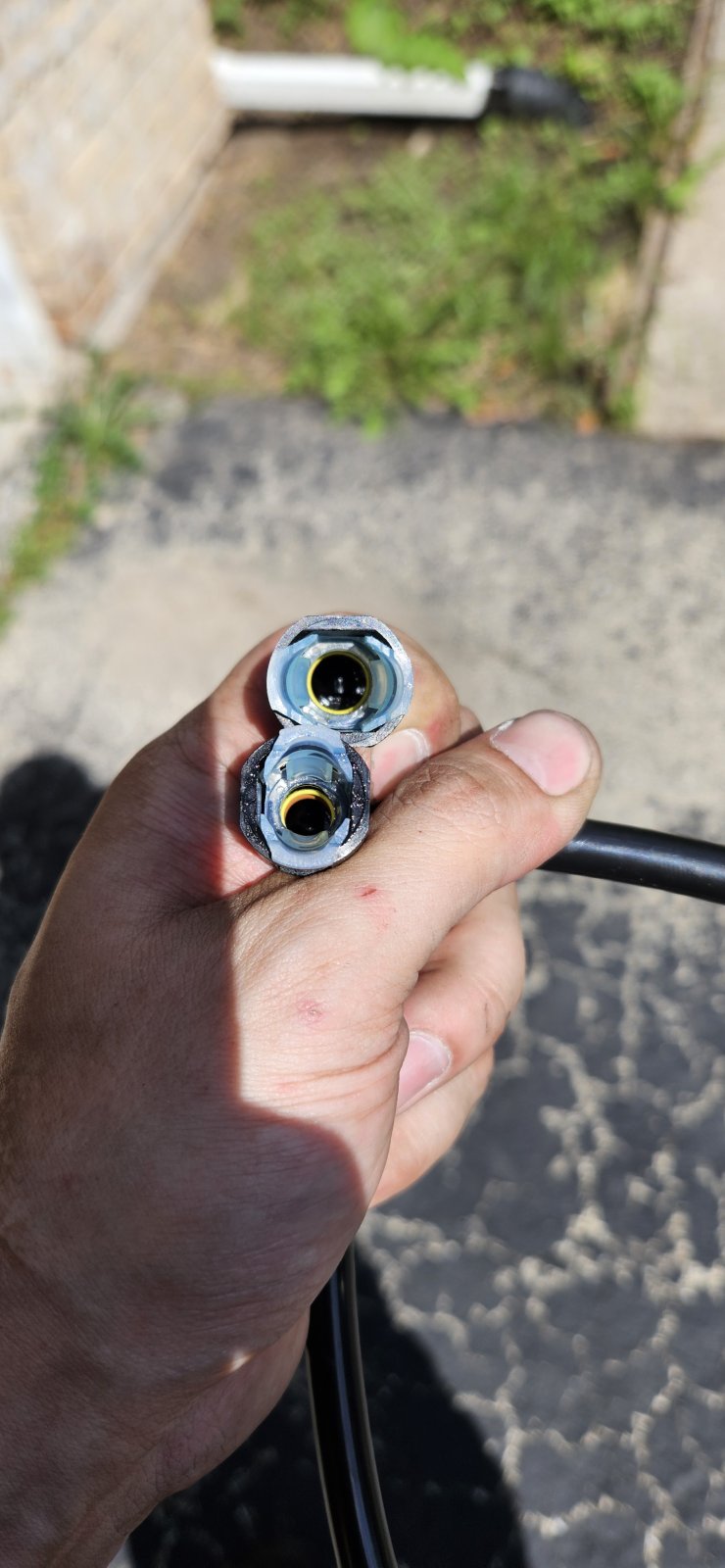

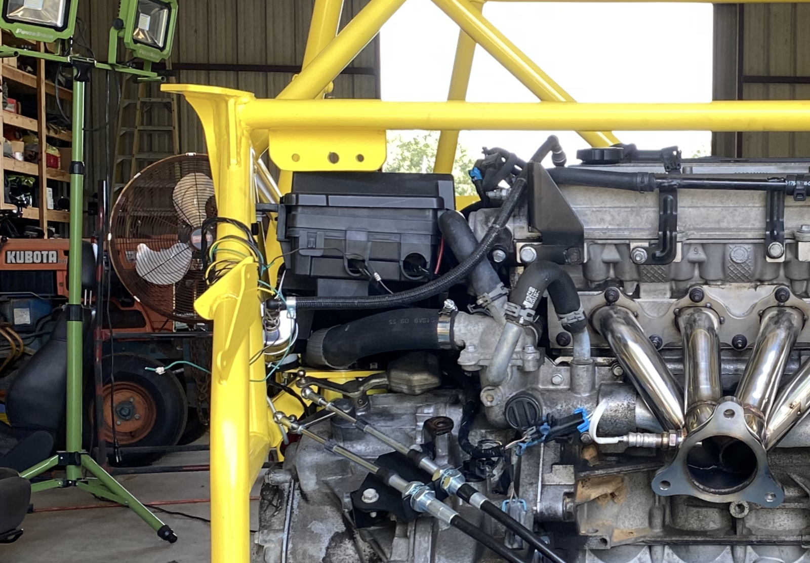

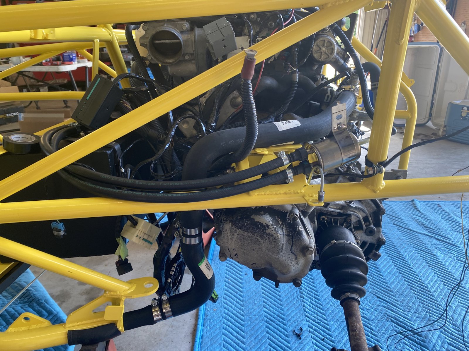

Was pushing hard to attempt a first start today, but i think I'm shutdown by the fuel line. The video (from last month) use hardware from a K007 bag. Went through everything I have, and all the pictures of the hardware from when my kit arrived, and I don't have one. I think I got a bag for a NA engine, K12A? The fittings are also different sizes, only one will fit at the fuel filter or the fuel rail. Really bummed about this, after this was going to be add fuel, connect battery, and crank.

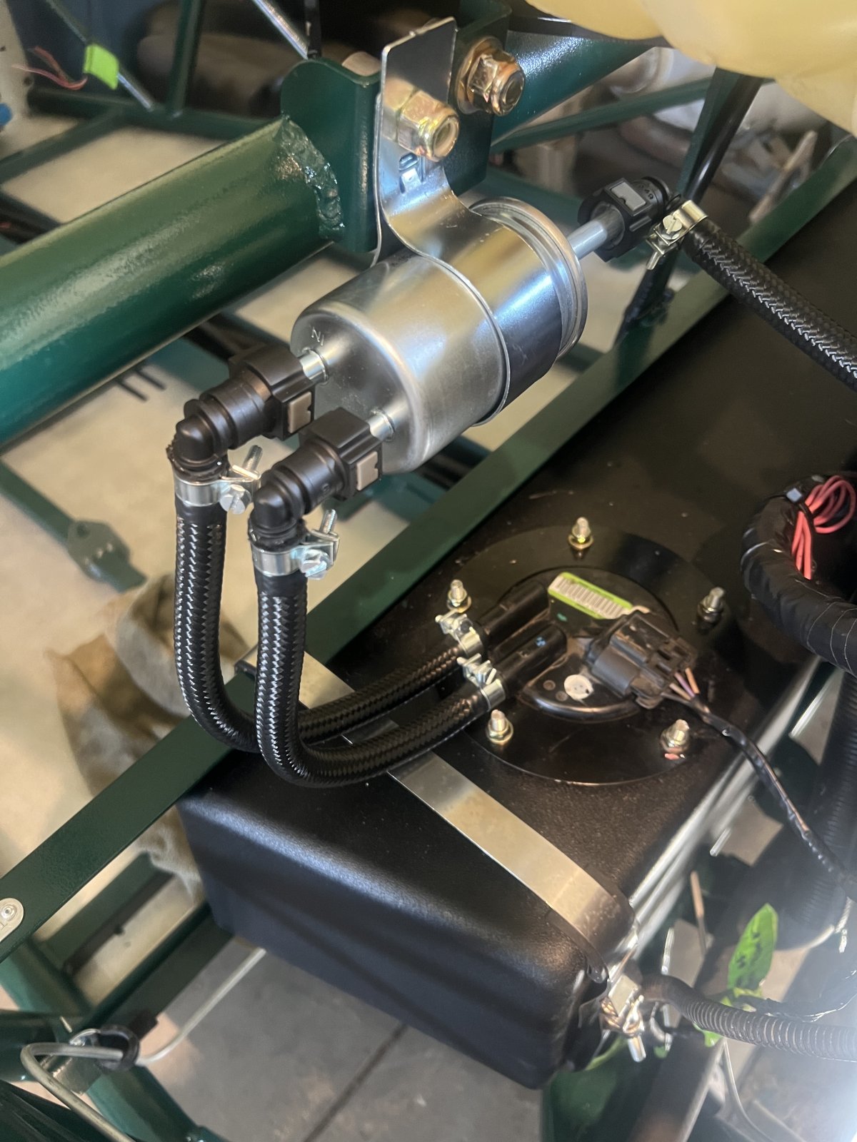

You might be able to build your own from stuff at your local auto parts. I know I cut the hard plastic fuel lines, saving the connectors and used rubber line to the filter. then find an adaptor from filer to use more fuel line (or to connect the stock line if you kept it).
Traé
I ordered some Dorman quick connects from Amazon and installed the fuel filter under the coolant tank. I think it made for a clean install and shortened the amount of fuel line I had to buy. Just an idea I saw on the forum and liked the location and look.

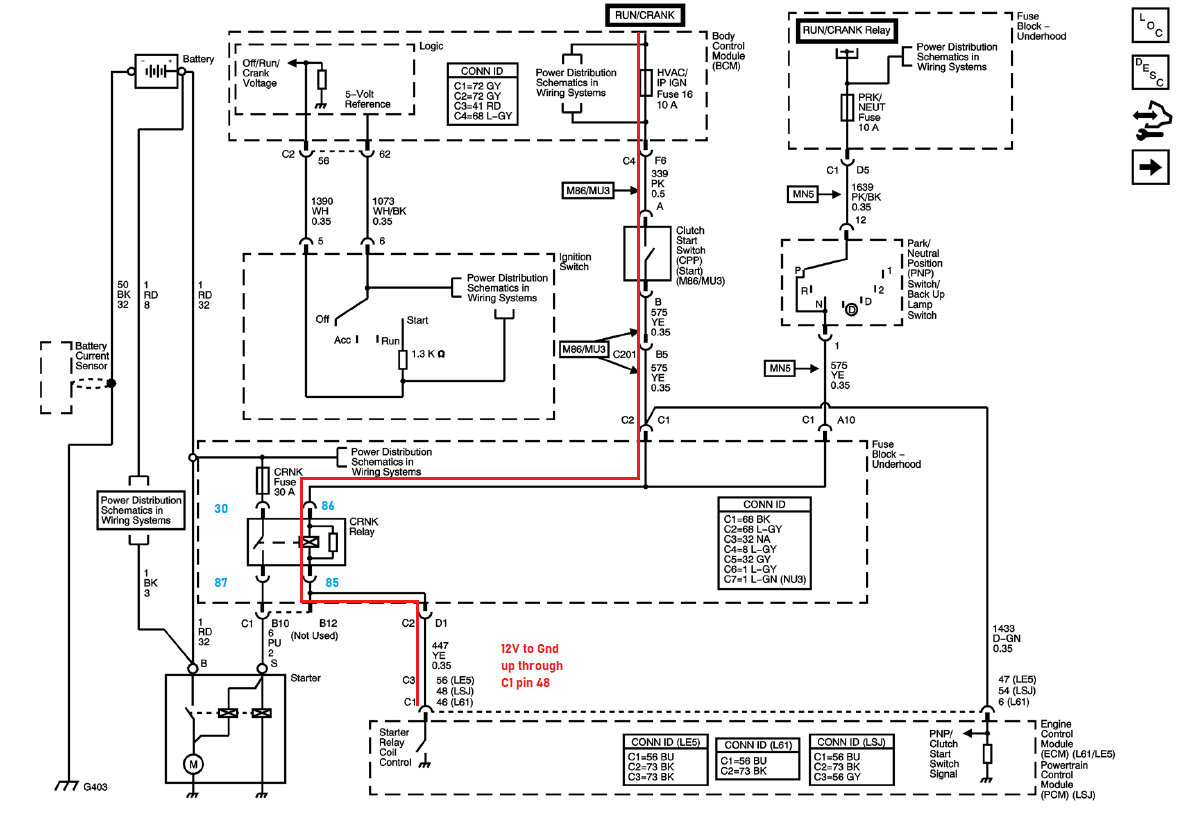

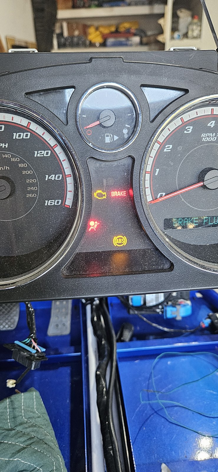

I've delayed this post long enough. I have the dreaded No Crank.
What I have:
-HX Fan Runs
-HX Pp Runs
-Fuel Pp runs
-12V in RUN and START at CRANK RELAY inputs (Pins 30 and 86)
-12V through the whole starting circuitry to the PCM C1 connector pin 48
-Car ran when I jumped the crank relay. Ran a bit rough, RPMs surging, maybe because MAF isn't hooked up yet? Exhaust sounded awesome when revving though.
-All fuses have continuity
-Clutch switches have continuity
-Ground points all have low resistance to battery.
-Crank relay does not click when key in START.
-Swapped with known working relay, same result.
My possible culprits:
-Don't have a path to ground from the output of the CRANK RELAY (pin 85). Maybe the Starter Relay Coil Control is not closing to allow current flow?
-I can't find what the starter relay coil control actually is or what wires control it. I'm thinking maybe hi speed data, based on other members' no crank discussions?
-Tried to hook up a OBDII bluetooth sensor, dang thing wouldn't download car information and kept erroring out. Related symptom, or crap product?

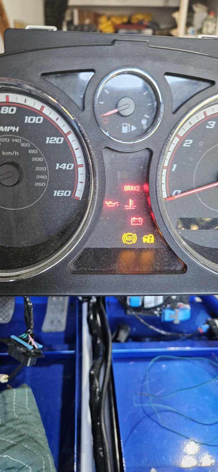

Attached are pictures of dash lights on startup and after startup.
Traé

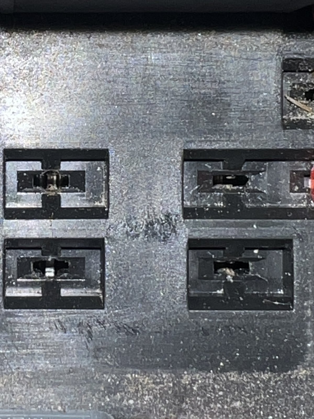

This sounds like something I experienced. the cause of my issue was that the pins on my fuse box for the crank relay were likely spread apart when I was checking power with a multimeter and jammed the test prongs into the slots.
I too was able to jump the crank relay and it would crank. Never worked with other relays. Had power everywhere I needed it.
I ended up slightly twisting my crank relay prongs and the issue went away and never returned.
Maybe worth a shot?
pic of where I jammed the multimeter in.

The PCM isn't giving ground to the starter circuit. You need to pull the OBDii codes to find out what is going on.
My goblin did this when I had a high speed LAN data issue. I could turn the key on, jump the starter, and the car ran... without most of the dash working.
Exactly. That is how the PCM controls the circuit - by proving ground.
Maybe borrow a reader from your local parts store, or a friend. Or start checking the OBDii port, and make sure you are getting 12V, 5V, grounds, etc.
View attachment 53670View attachment 53671
Are you sure the pcm provides ground to control the starter relay. The later models have the ECM providing positive voltage with a full time ground. But it’s very possible that it was changed.
Matt3458
My dad's got a basic reader in going to grab in the morning, to start with. Sounds like I have thread to follow, at least.
