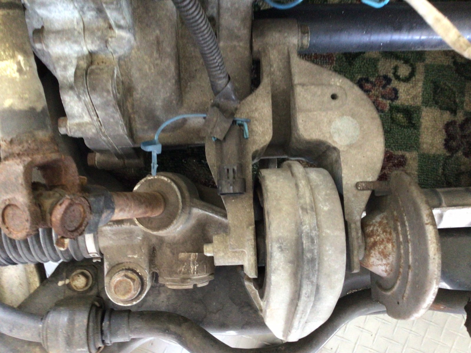

And that stupid little umbrella rubber seal thingy under the elbow, if you take that off. That thing is **** near made of unobtainium.

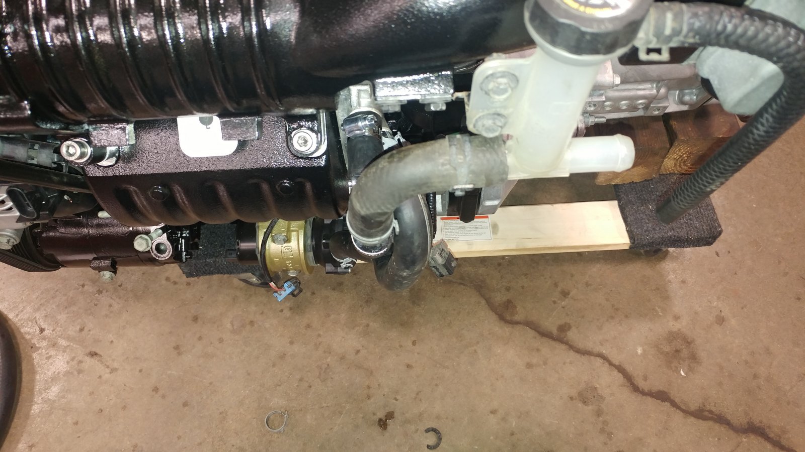

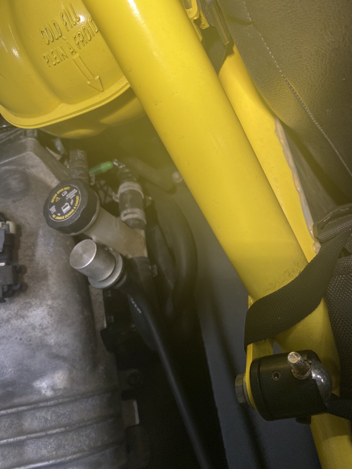

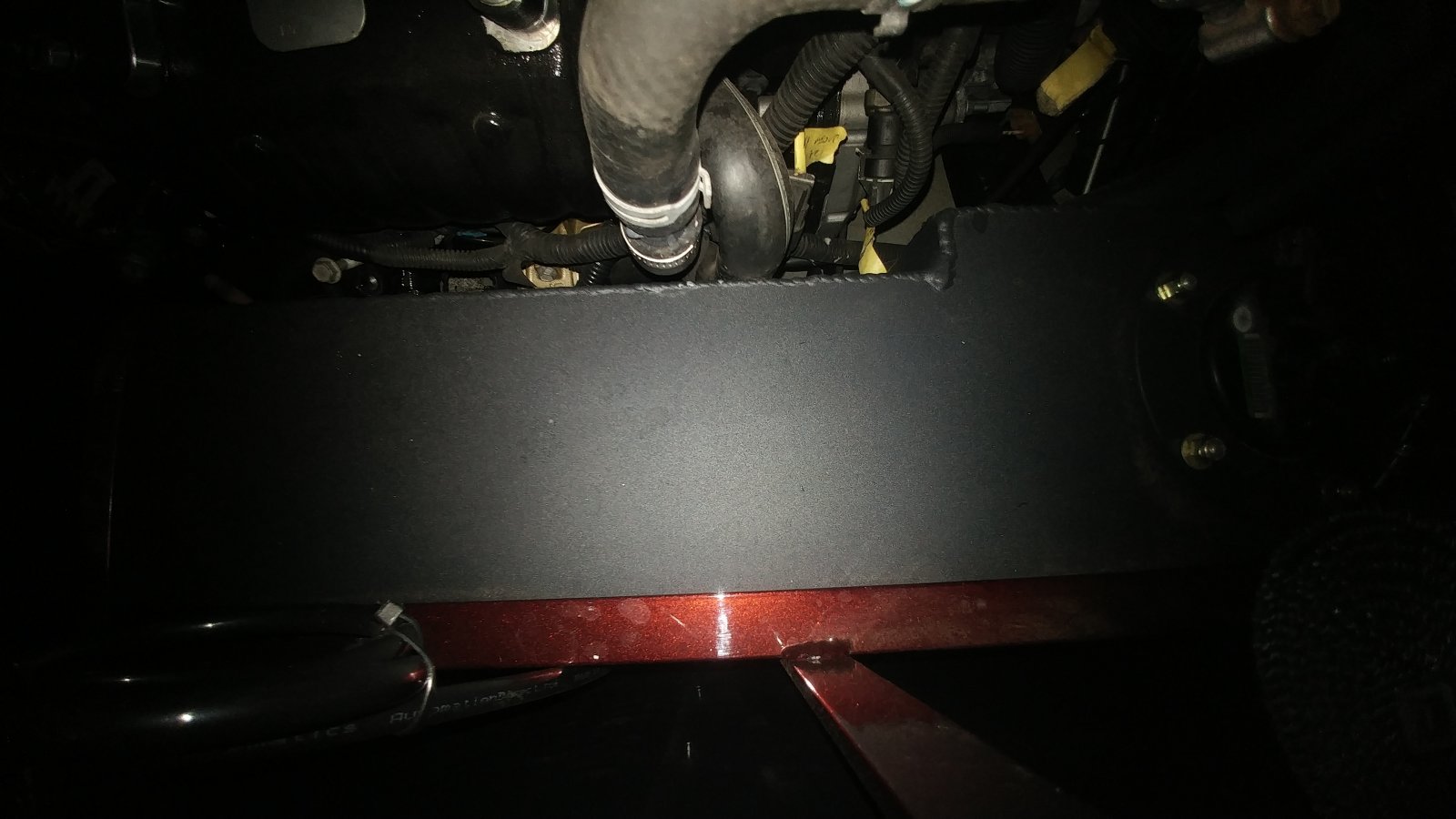

I know I have been off the radar for a minute. Anyone have trick to get this guy in without totally smashing it?
Thinking of getting elbows to help with clearing.

I'm not sure it's going to go on like that, at least not onto the bottom barb without kinking. I had to scrounge up some hoses from elsewhere off of the donor; I can't remember where it came from, but I did find a perfectly formed right-angle hose for the bottom barb. I also don't have a picture on me at the moment.
I don’t have a pic how I did mine, but I think I used a combination of new and old hoses, plus a T. I’ll have to take a pic when I get home.

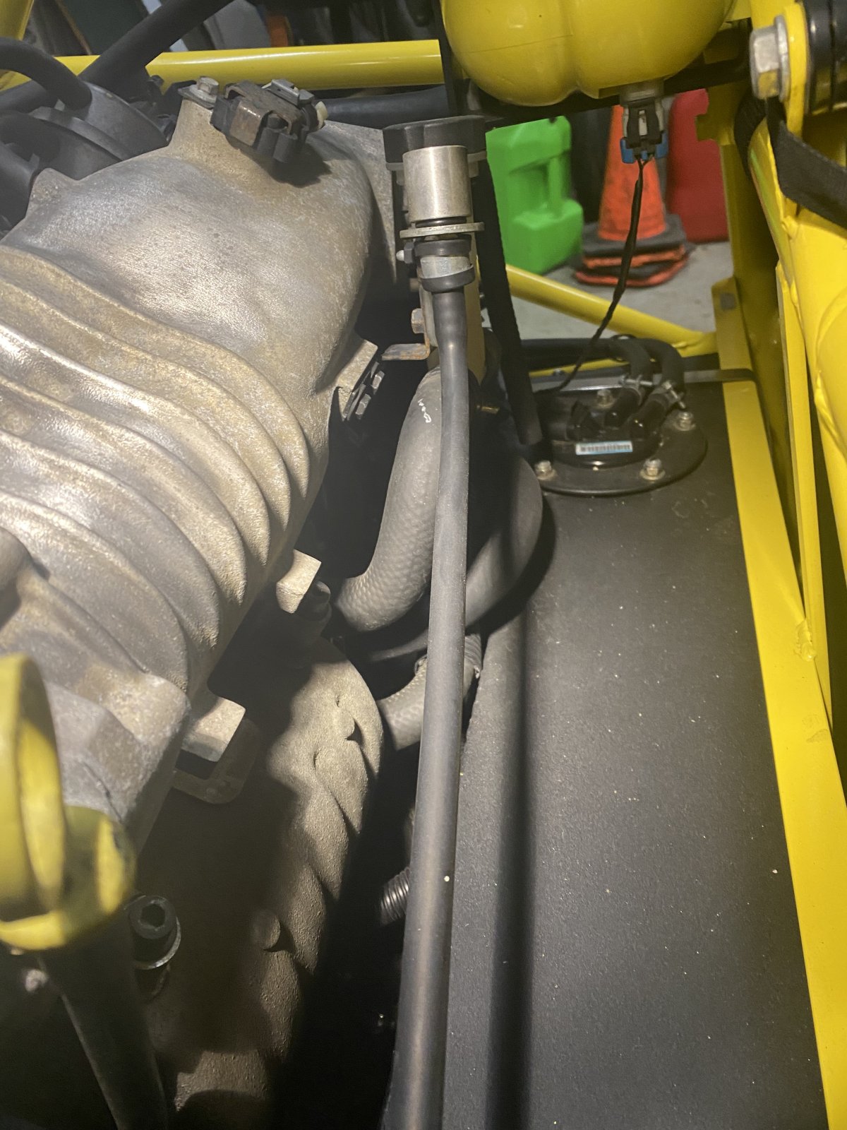

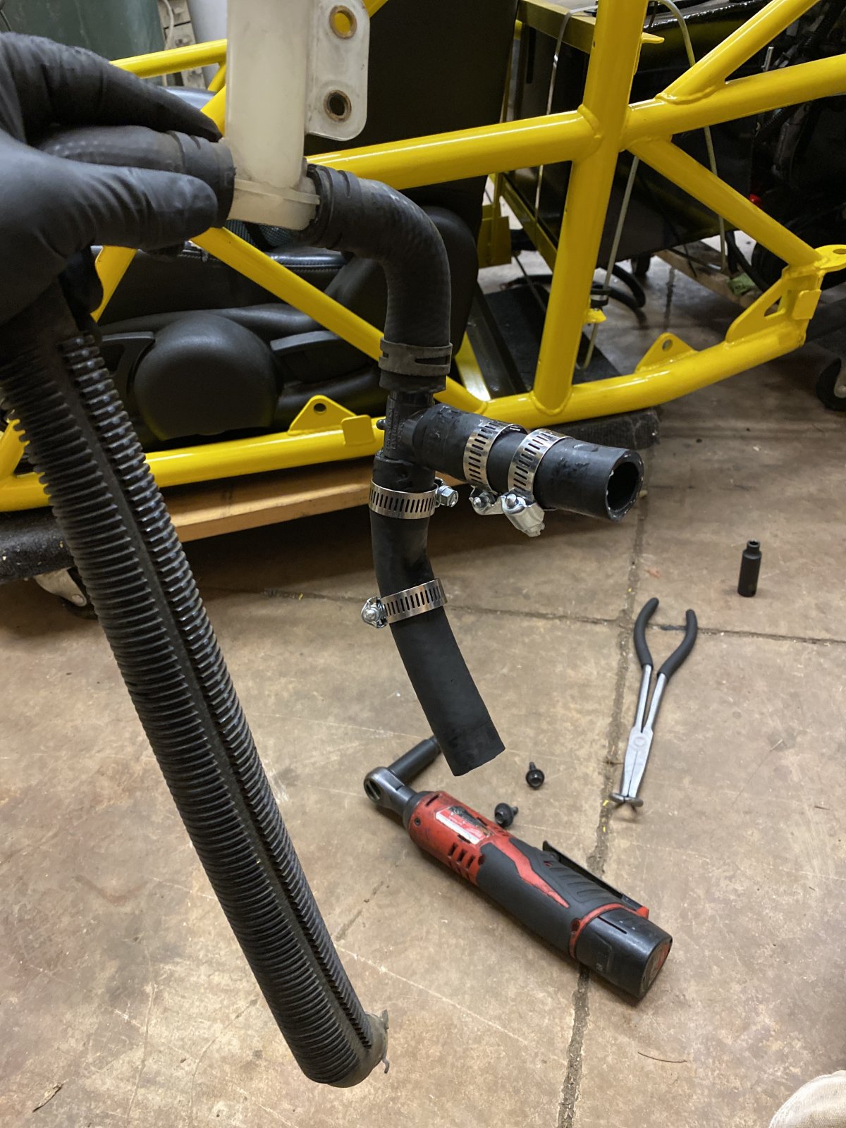

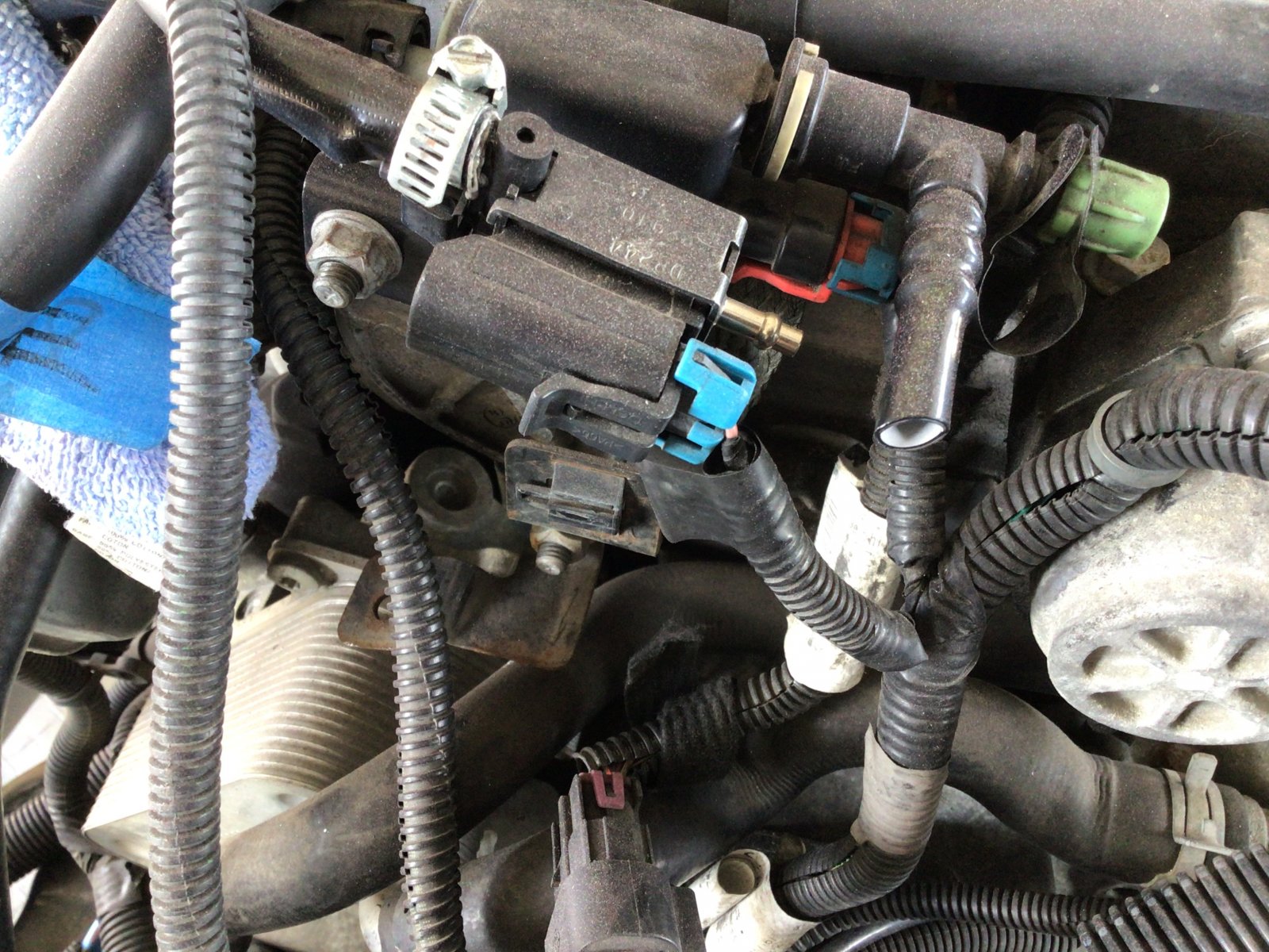

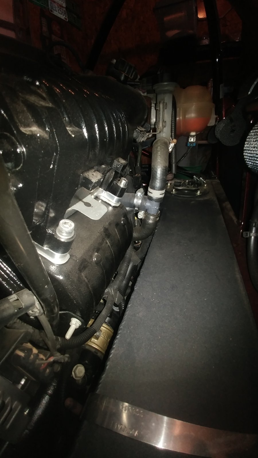

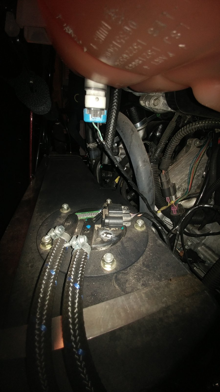

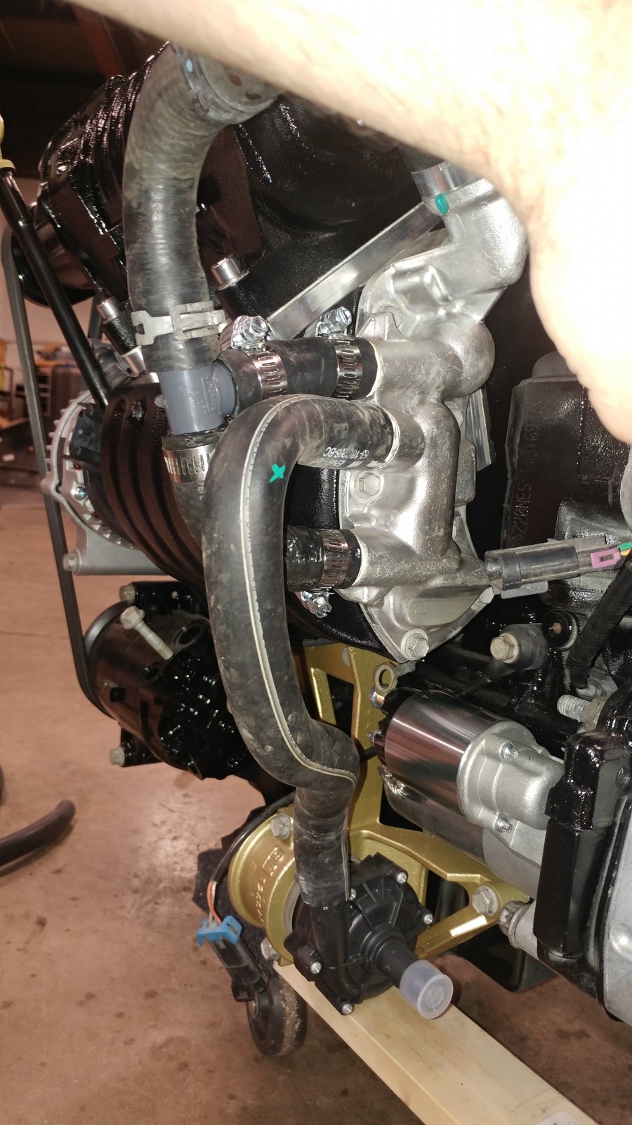

Vwsaabvt
Not the best pictures, but hopefully they help

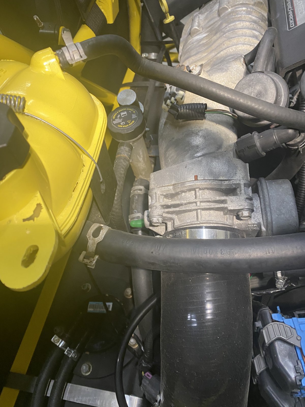

Aguinaga

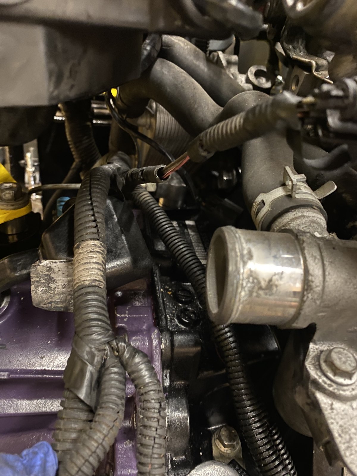

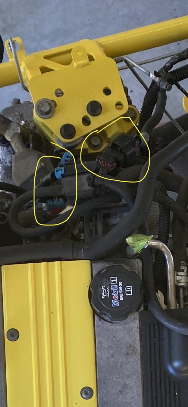

New question of the day. Can anyone please ID where these goes?

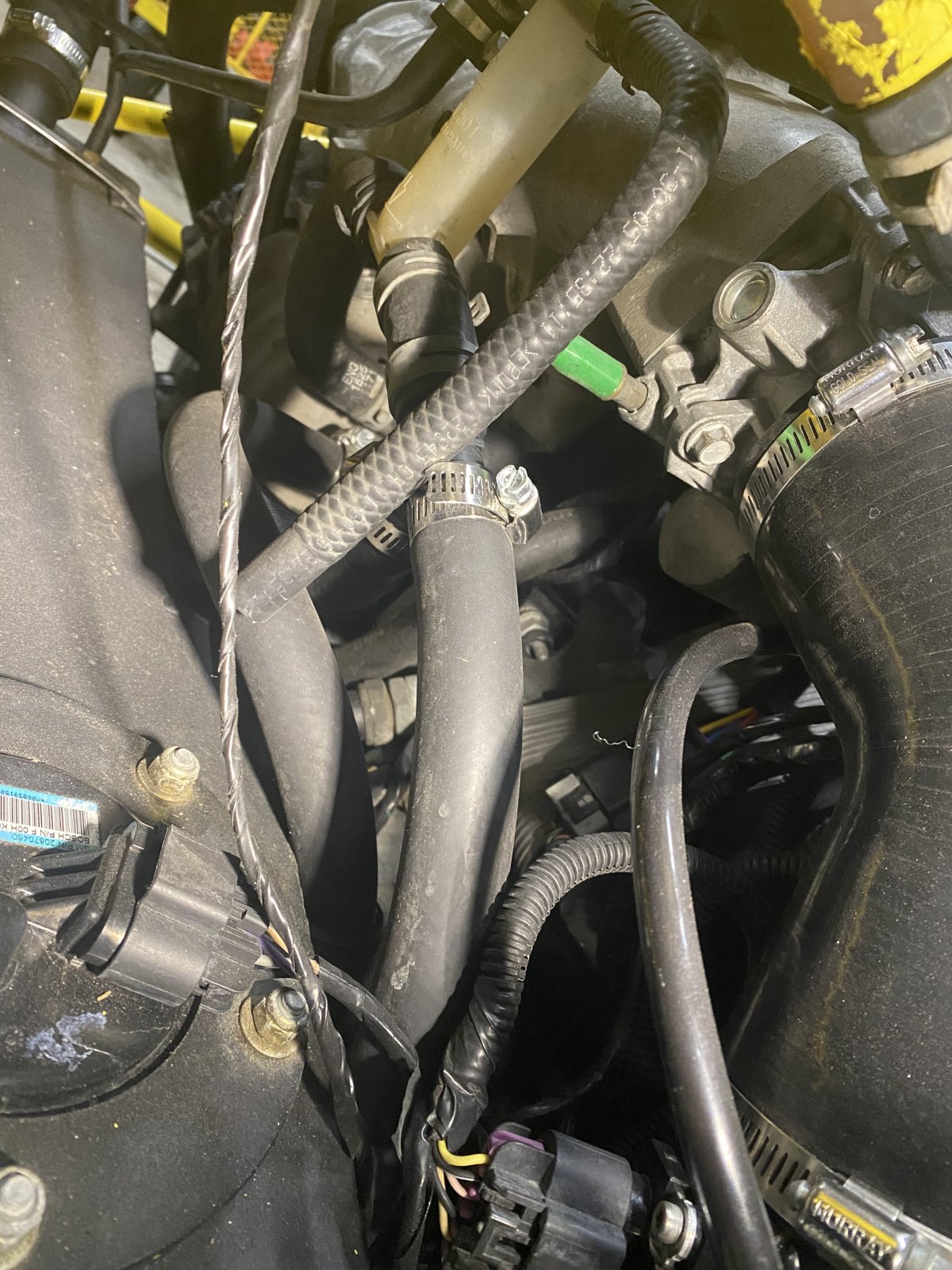

Aguinaga

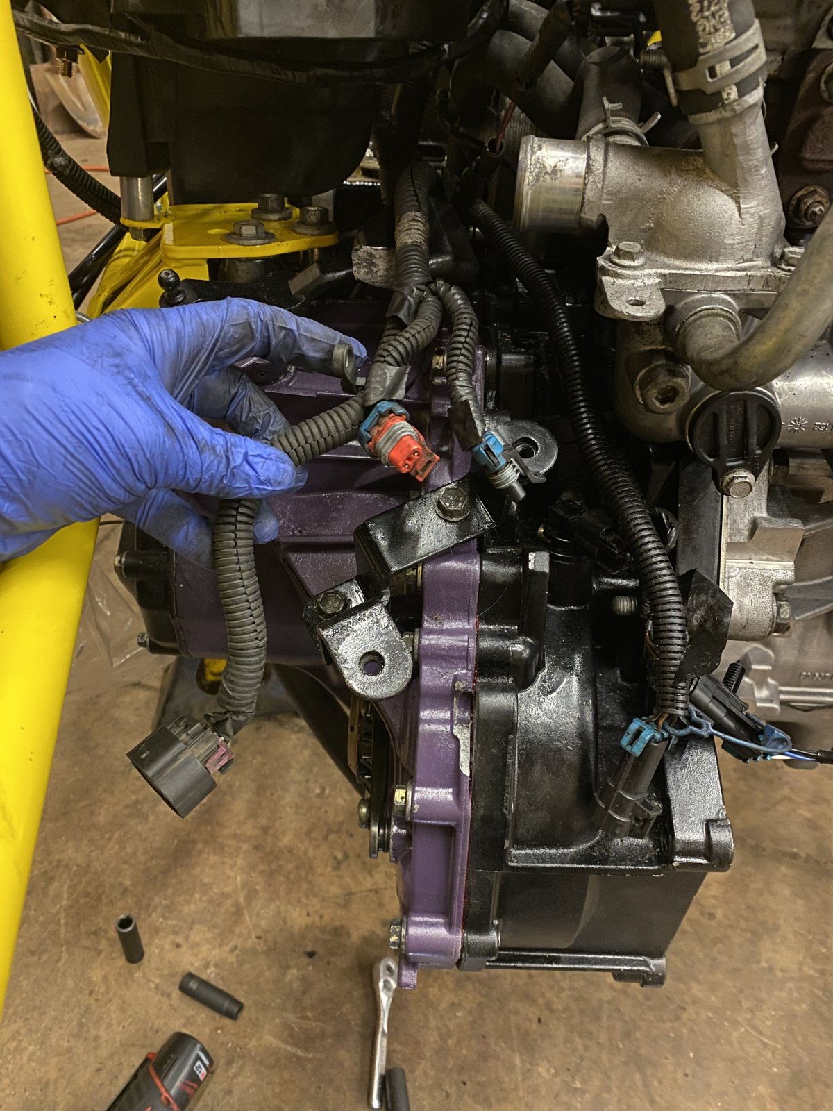

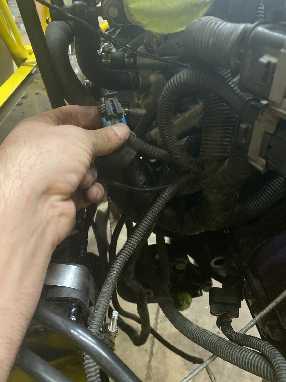

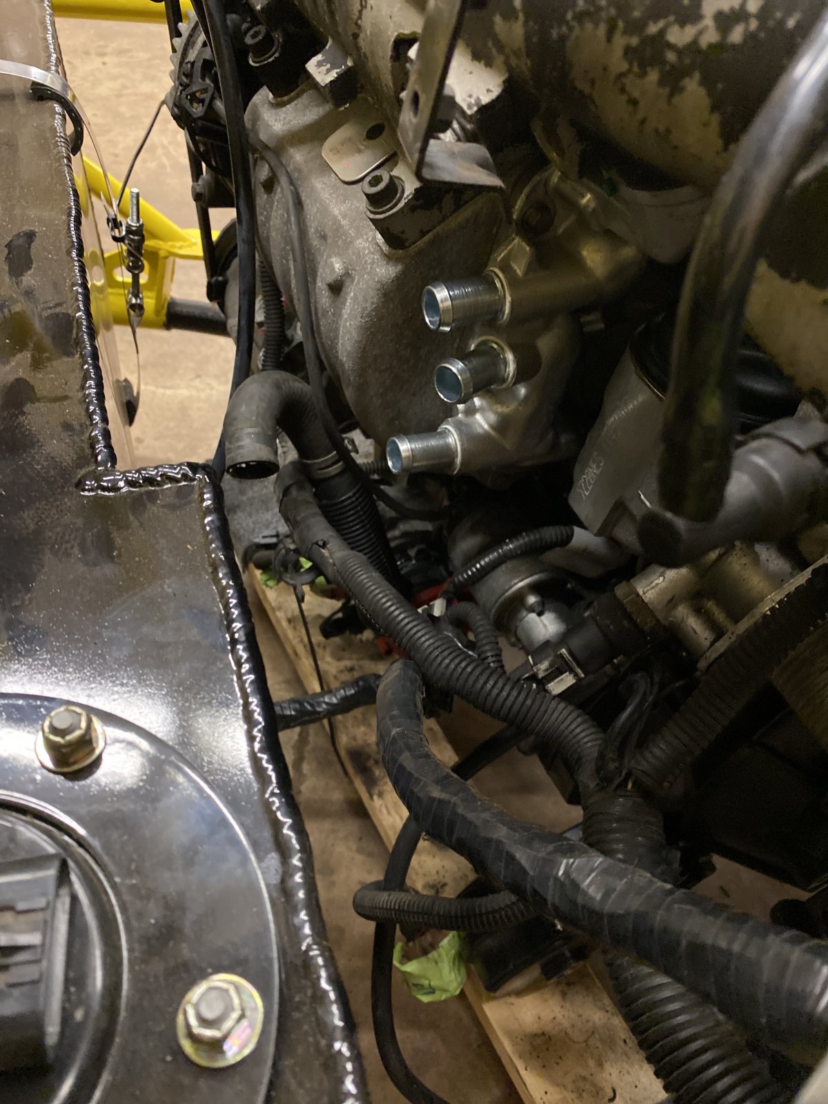

Had DF do the wire harness for me, I think I might of routes the harness wrong or it’s way short to the coolant tank. Any insight
Not sure if it’s routed wrong, but I remember on mine, I had to extend that one further than it already was.
edit:
That may even be on the engine harness side and not even touched by DF. I’m trying to find a pic to verify, but looking at the dust and wire loom, it looks untouched.

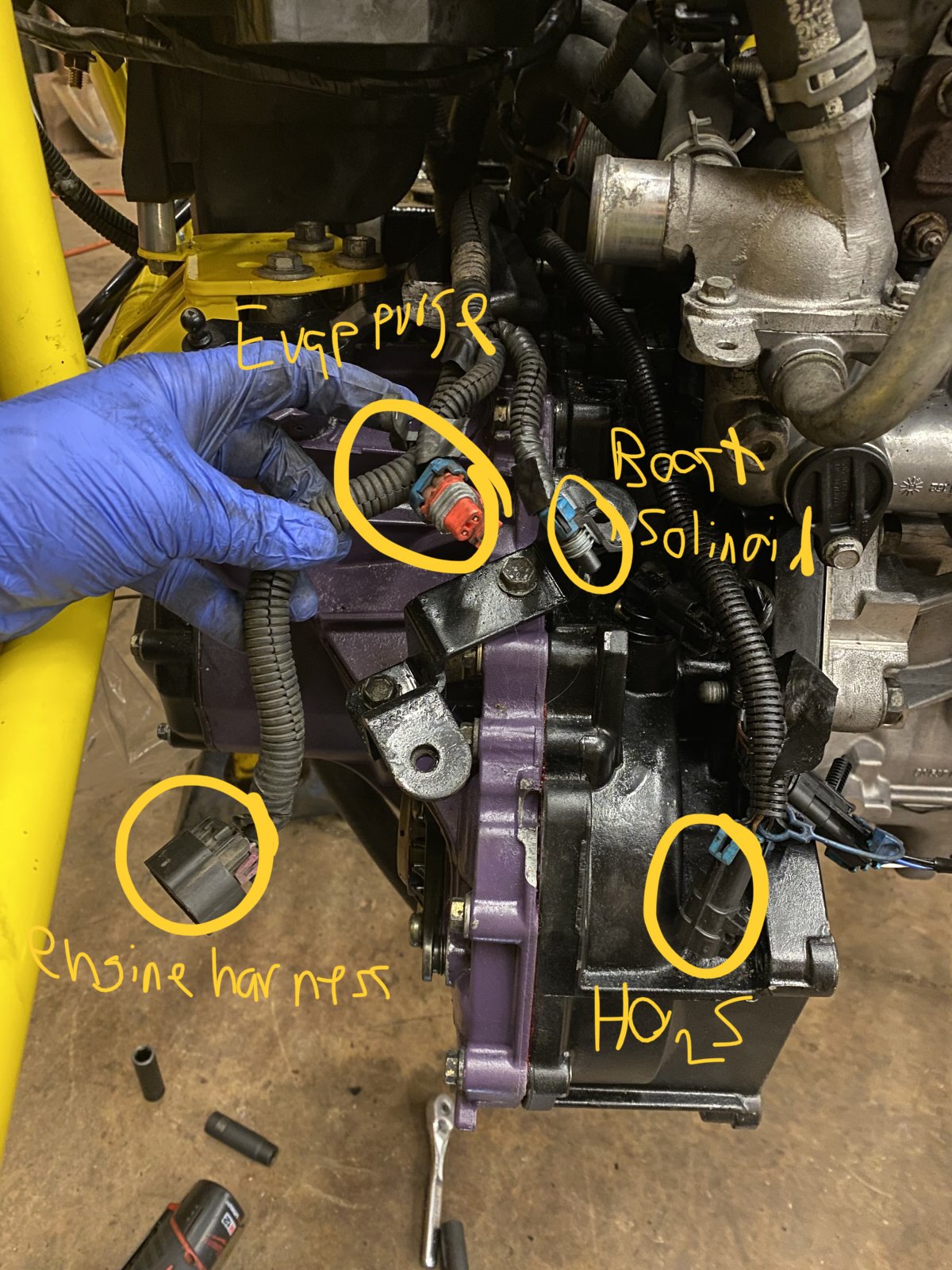

Engine harness connector,
Coolant sensor, MAF, and MAP will likely all need some slight modification to fit properly. I unwrapped the engine harness and rewrapped it with the engine on a stand and was able to lengthen and shorted the main engine harness so everything came out in the correct location without cutting any of the wires then rewrap to give it a more finished appearance. There is a considerable amount of extra wire in the engine harness at least on my 09 ss sedan.
