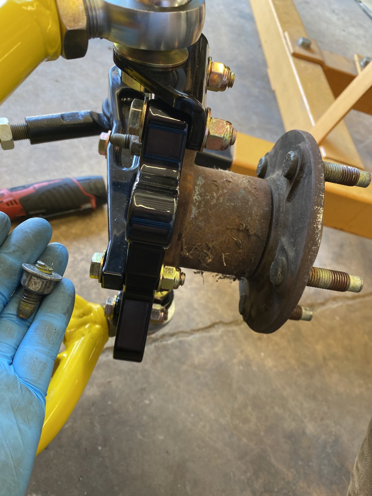

First huge shout out to Kimberly Coker for taking care of my UPS issues.
So, what is people’s favorite brand/hub for the front….. smh.

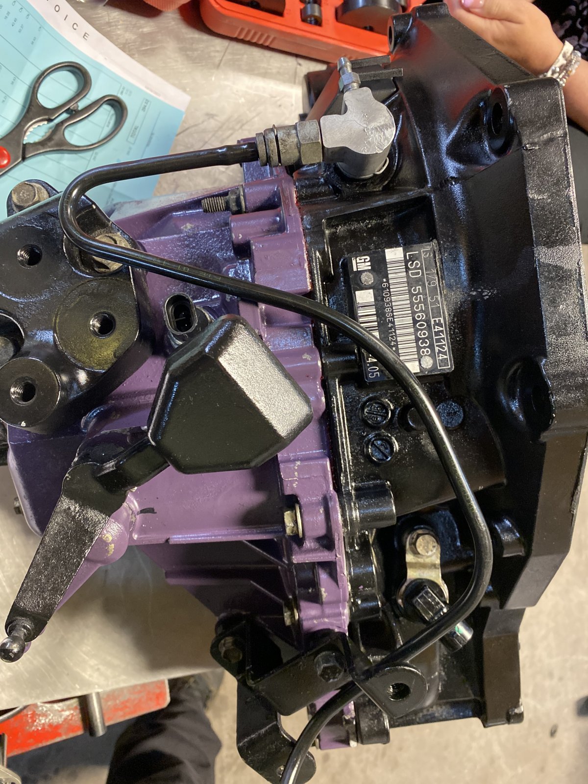

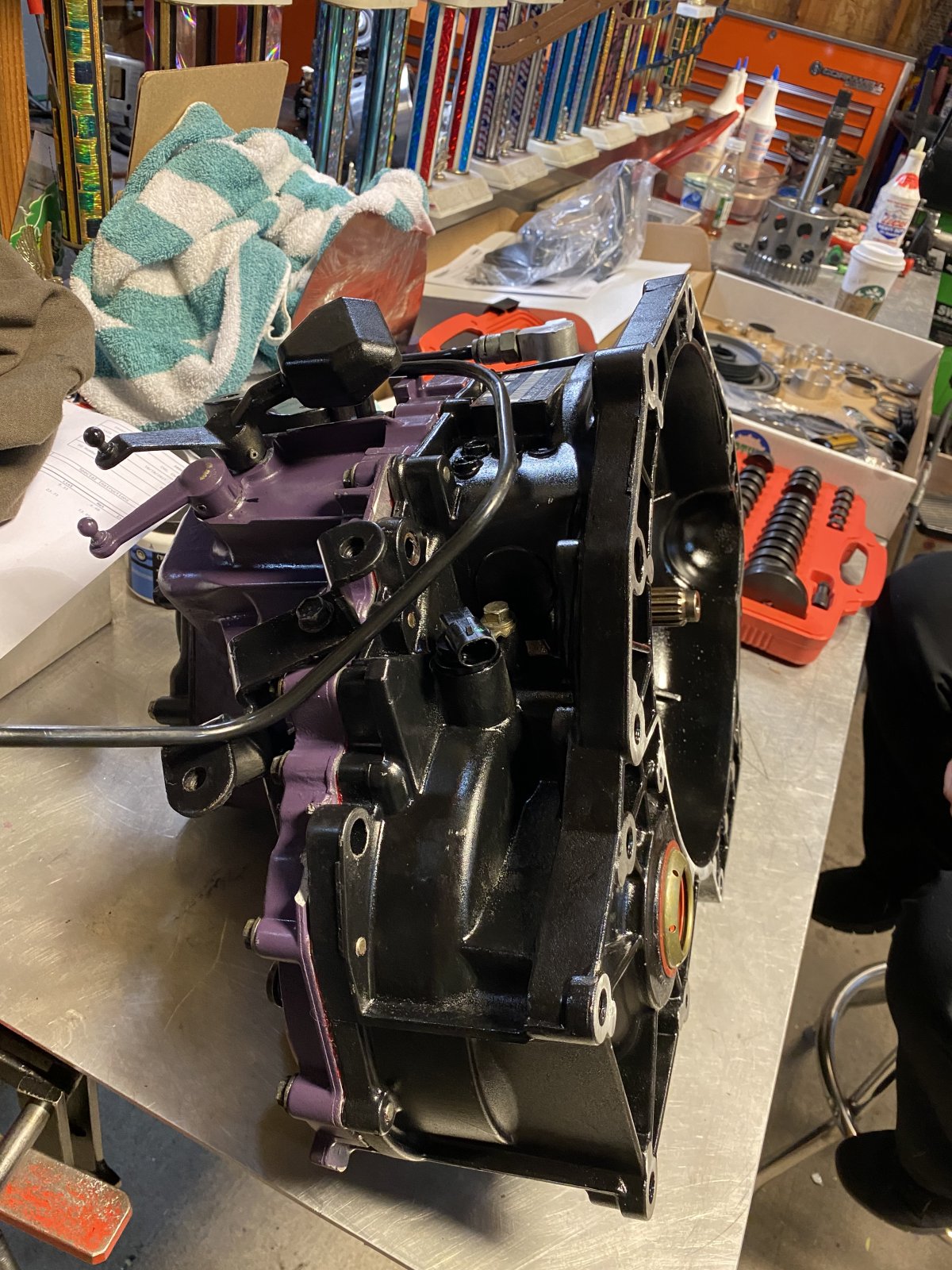

Aguinaga
When the F35 gets all put back together. They do not make it easy to rebuild these.

Where were you able to source parts. The searching I did was resulting in close to $500 for the crush sleeve, main nut, gasket set and 2nd gear synchronizer. Being that mine does not have quafie I was planning on going f23 due to cost and parts availability.

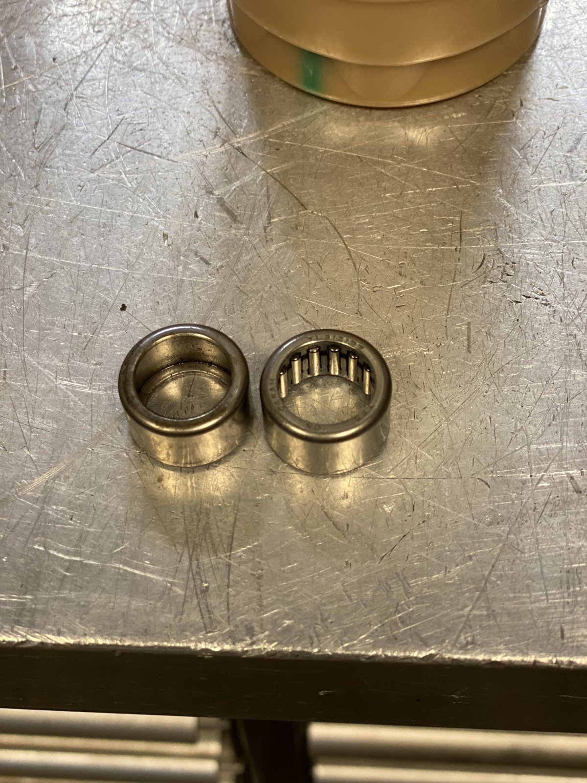

Aguinaga
Honestly my uncle rebuild it for me. He has been working on transmissions for 30 years. The bearings were the pain because they are pressed into case so not on your typical rebuild blueprints. A local bearing shop measured them and went looking.
