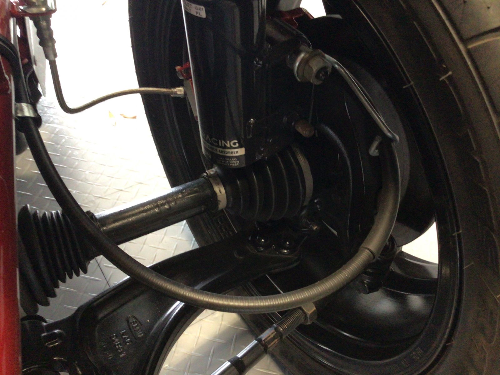

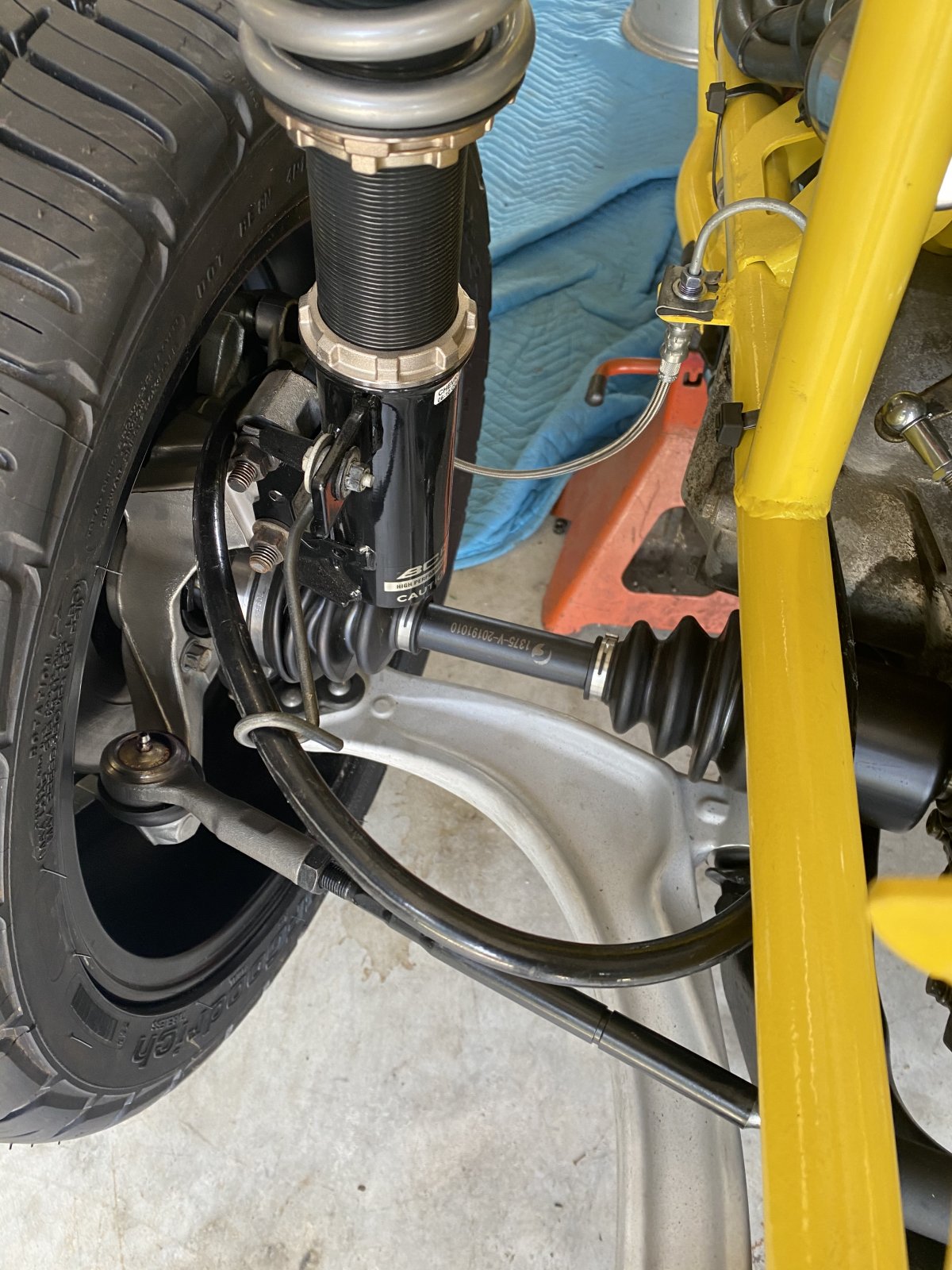

Route the cables above the shafts and such, so they are far less likely to interfere with the axles. Plus, it should make a smoother transition.
Zoom Zoom

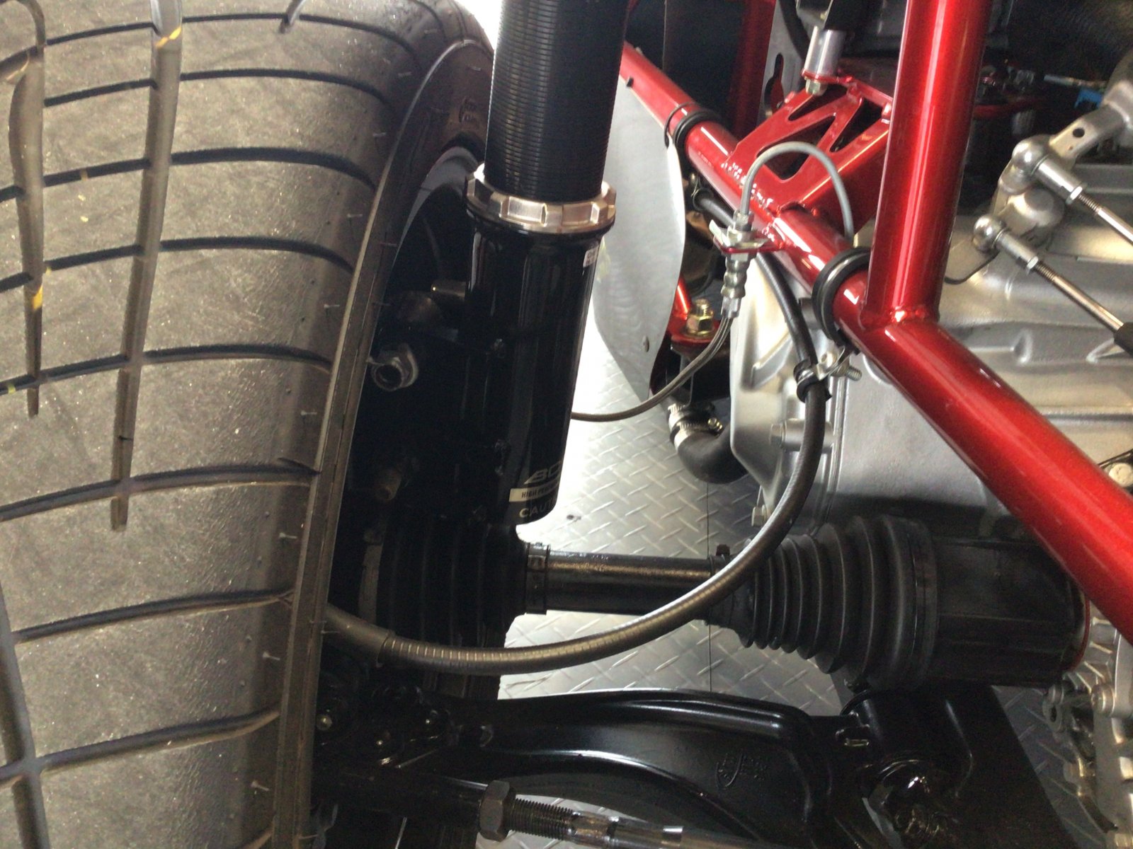

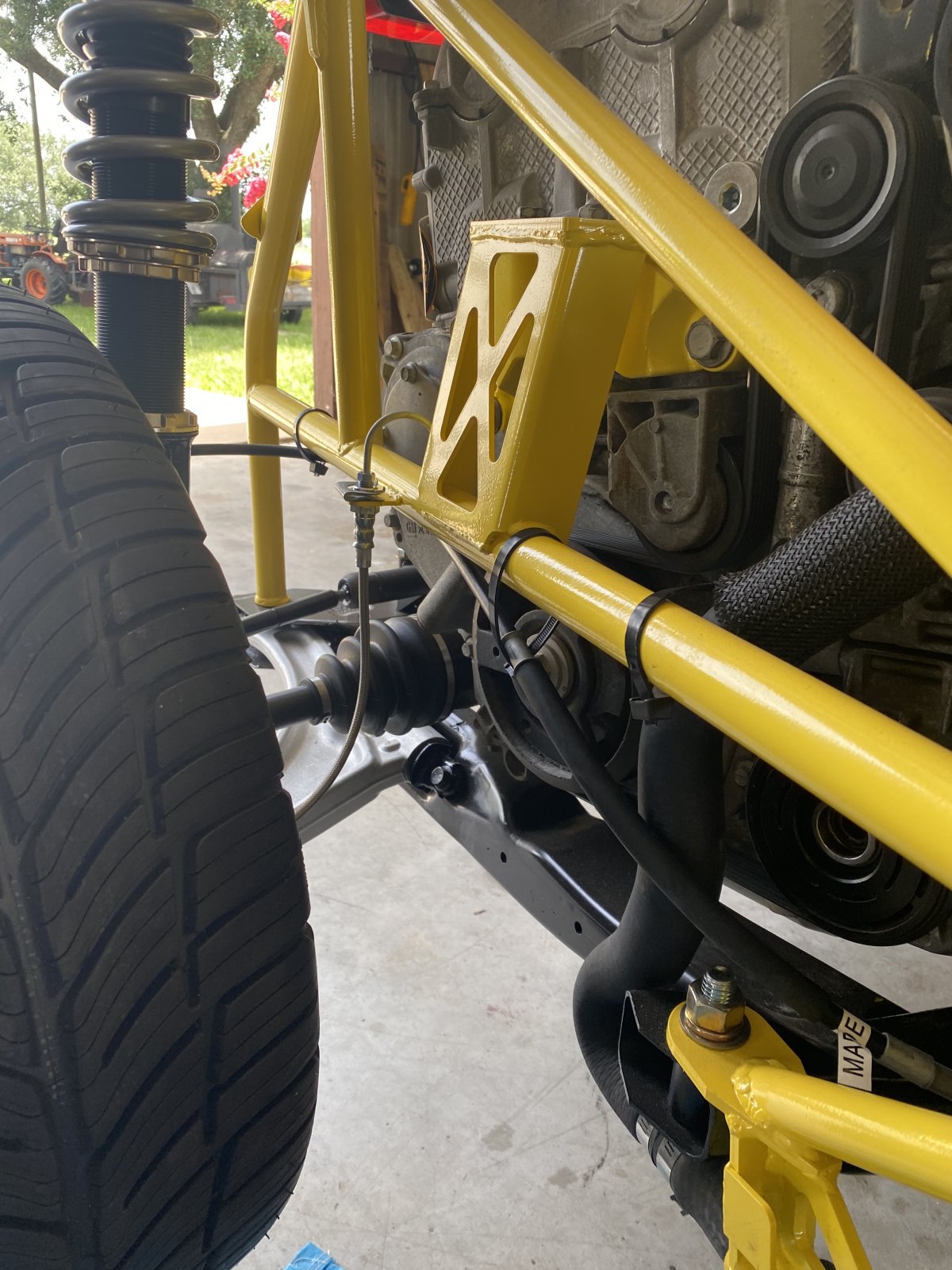

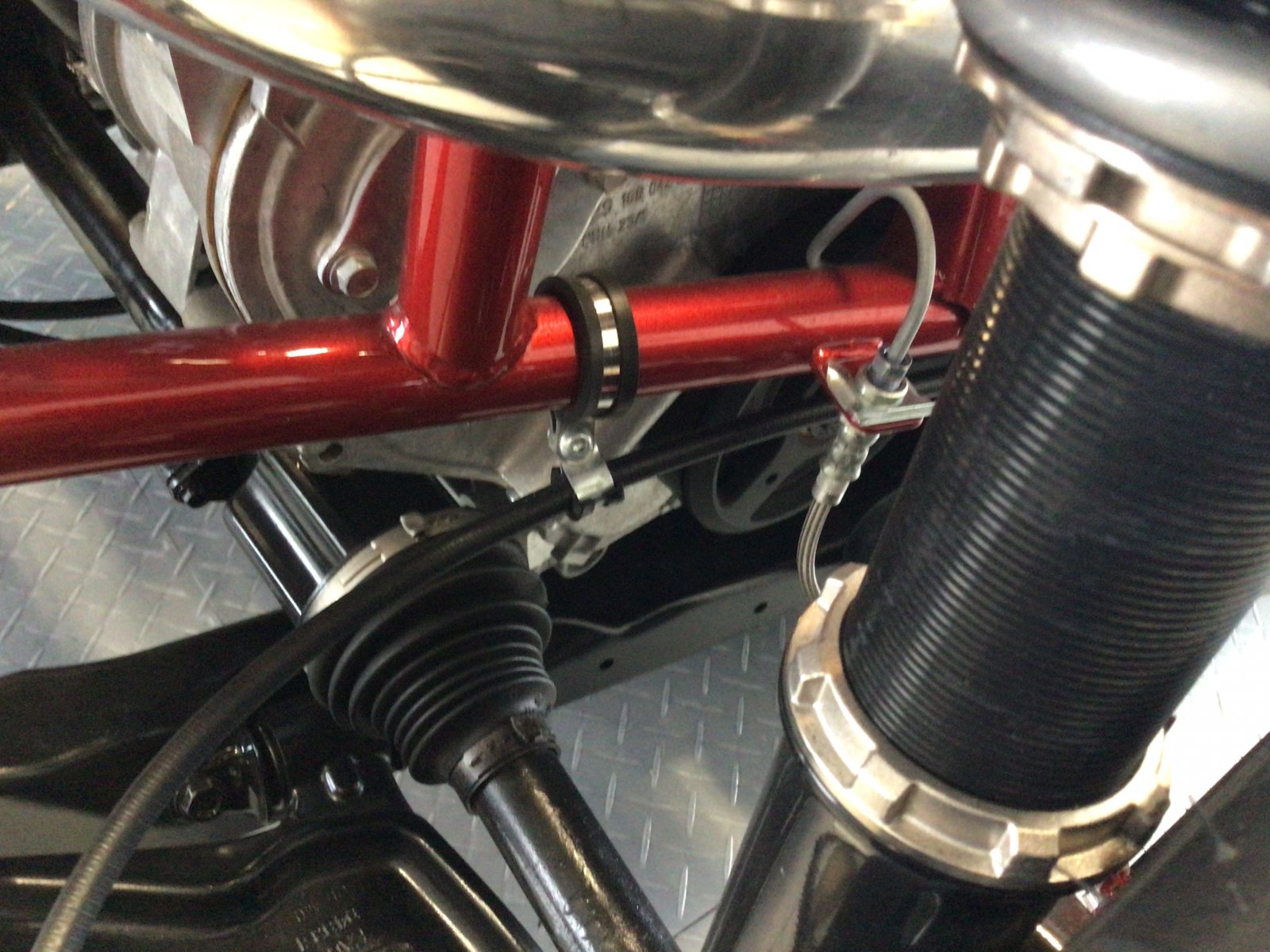

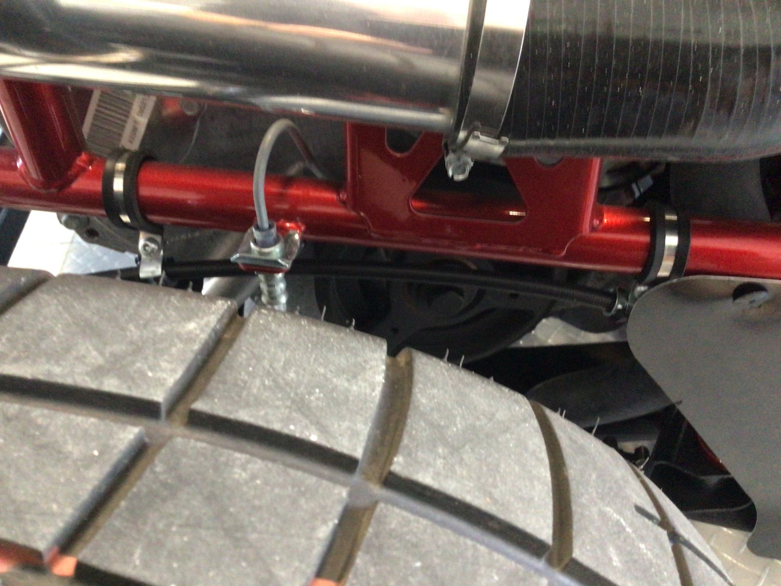

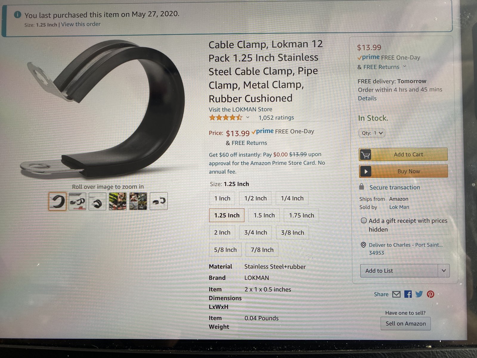

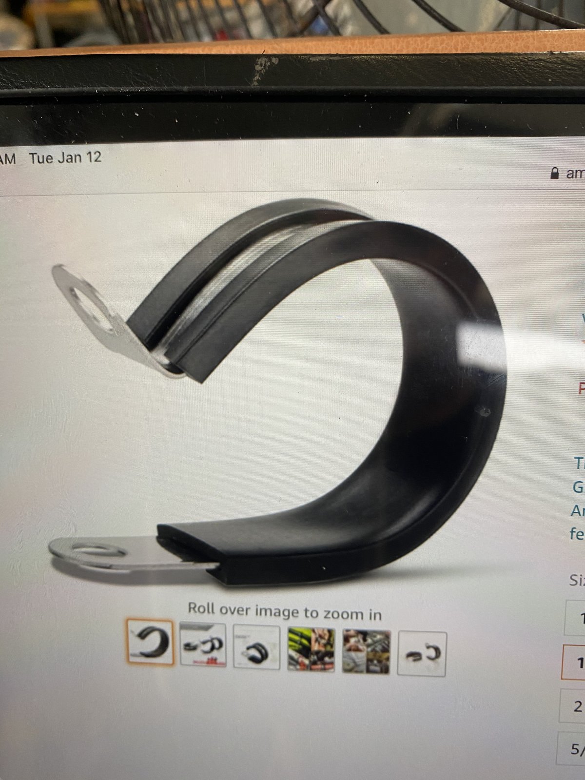

Took better pictures for you this morning, see how cable is mounted to rear strut bolt for mounting.
Use hose clamps to secure to 1” pipe and brake cable

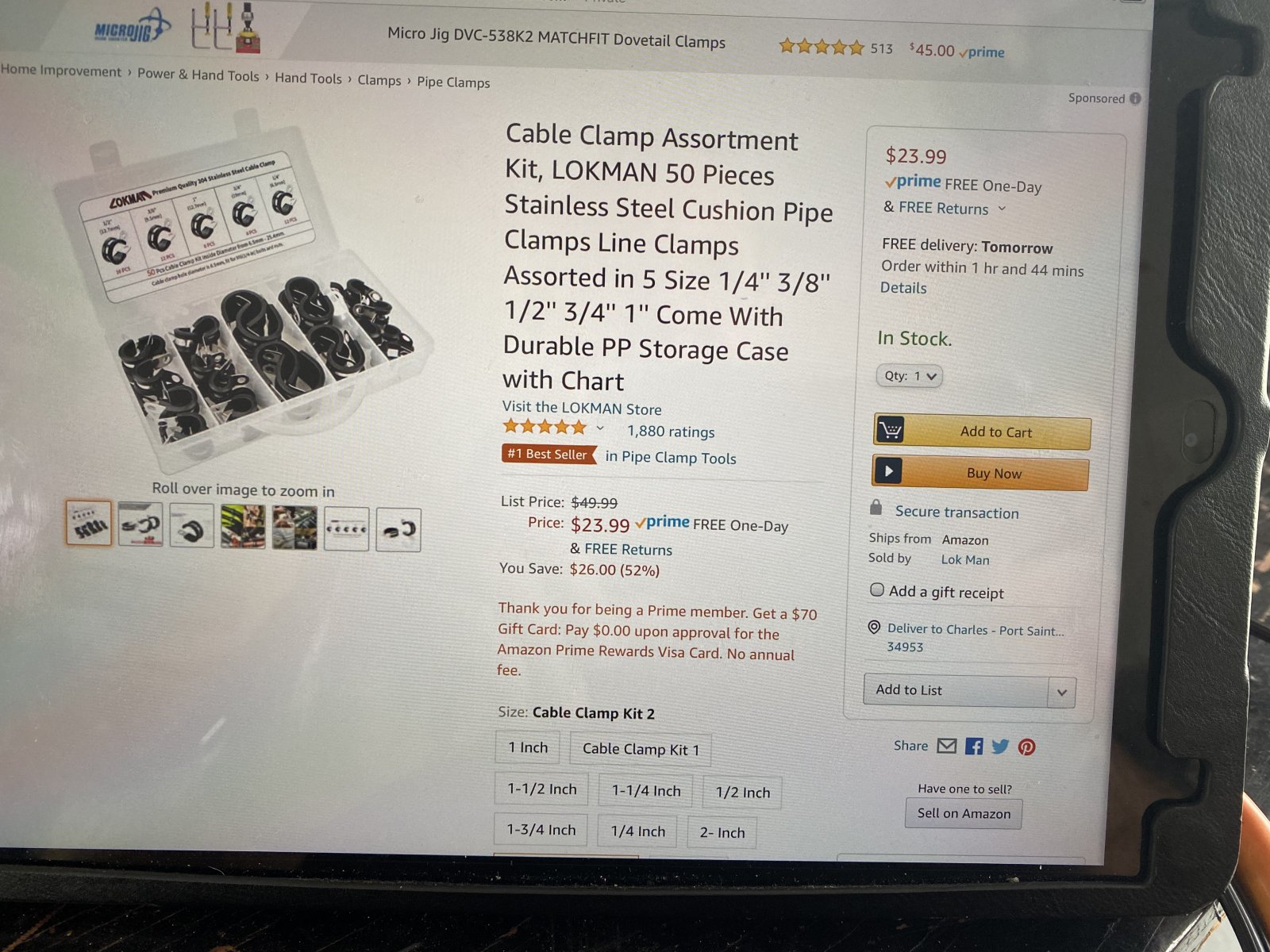

Can you post a link of part# for the clamps please?
Only because you said please! LOL
SORRY THIS IS ONLY WAY I KNOW HOW TO DO IT, TAKE PICTURE AND POST THAT. As long as it gets done!
1 1/4 clamps =4 and then some small for brake cables I bought mixed box
Save money just go to home depot and get 4 - 1 1/4 clamps and 4 small for brake cable
